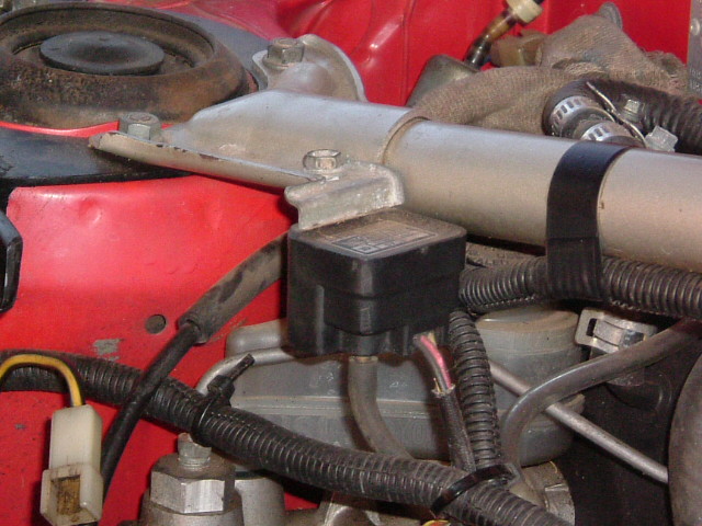

Could be an air leak between the turbo and head somewhere. I'd also be having a look at the hose to the map sensor. My old 4age had something similar and it was a hole in the hose to the map sensor. Idling was fine but when i gave it a bit it'd run rough etc
Where is the map sensor? i don't have a workshop manual yet. sounds possible but, i thought it may possibly be a vaccume leak or something.
What it looks like
Usually bolted to the firewall close to the manifold.
cheers for the pic bro, just checked it out seems to be in good condition, is there a fuse inside it? maybe that has gone. does that go to the ecu?
