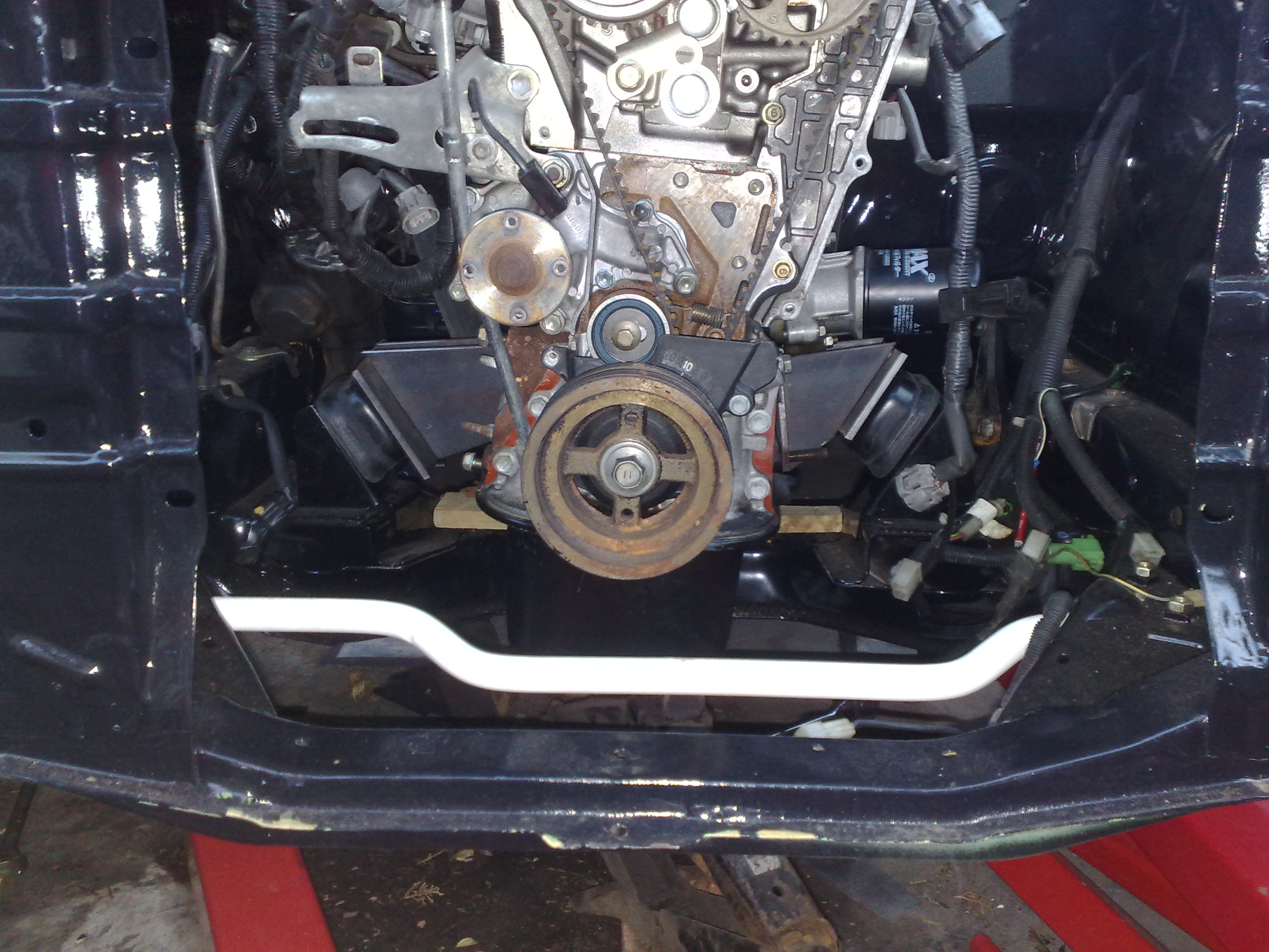

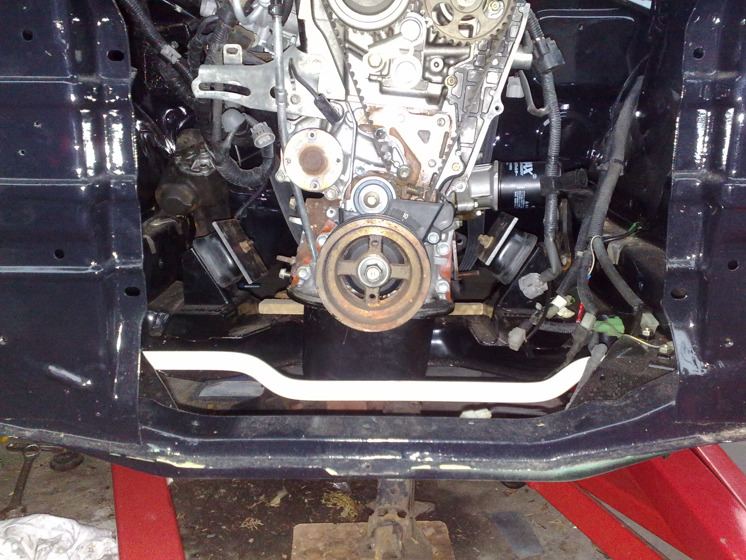

how close it sits
from the front
Edited by blackrolla80

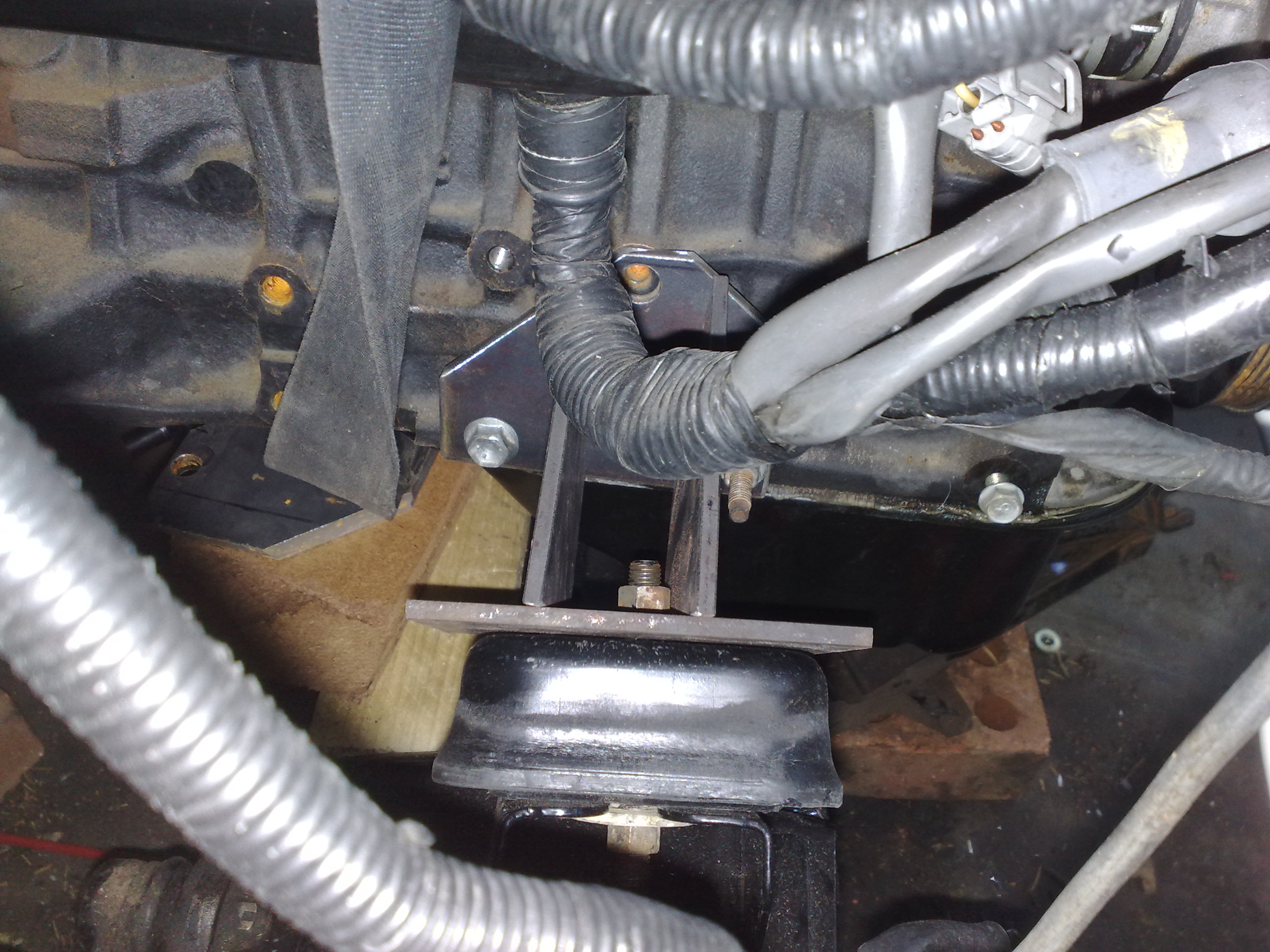

ok made the side plates.

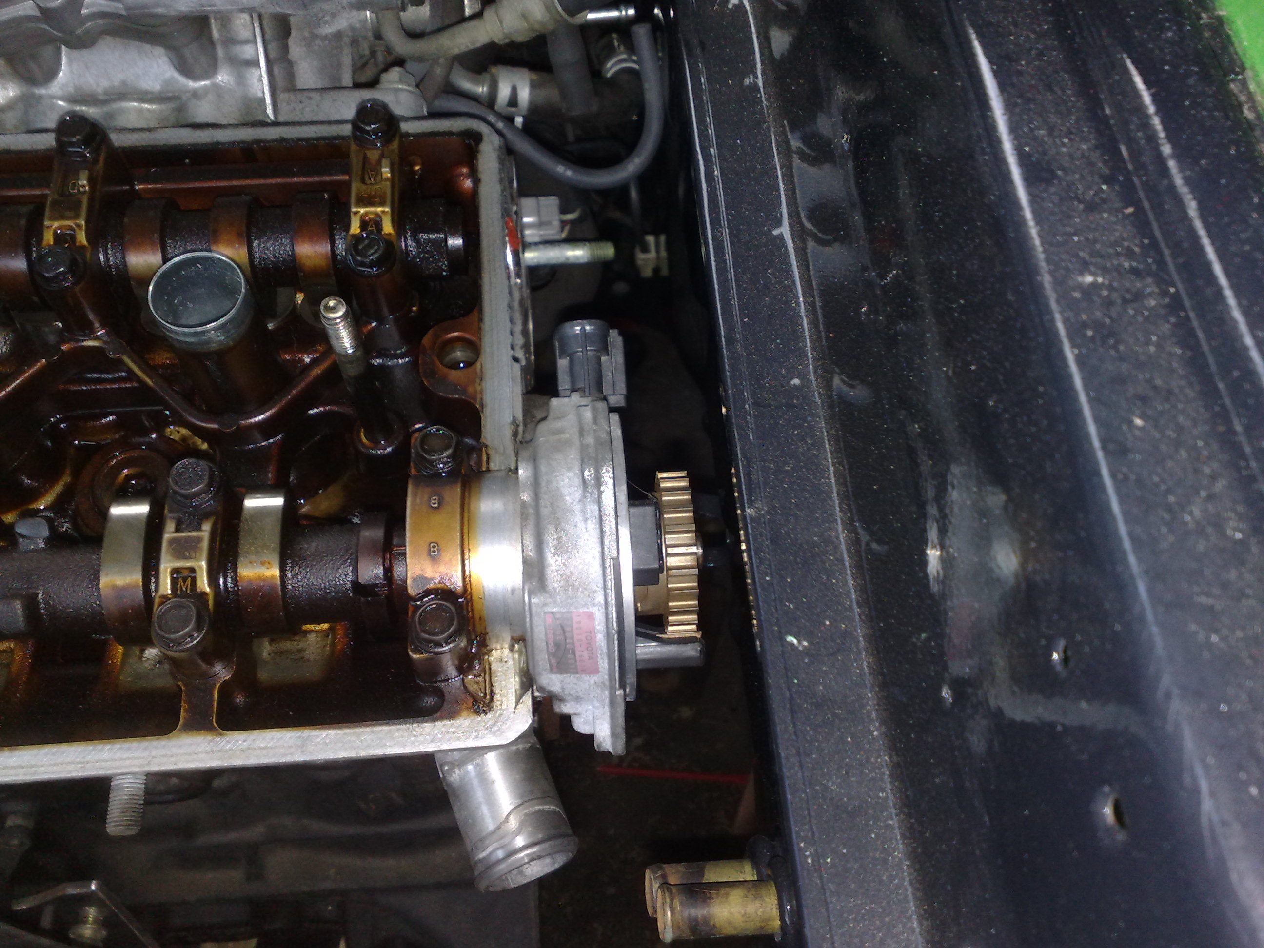

found that for you 16v guys i'm gonna have to design the drivers side one a little different. but won't be any harder.

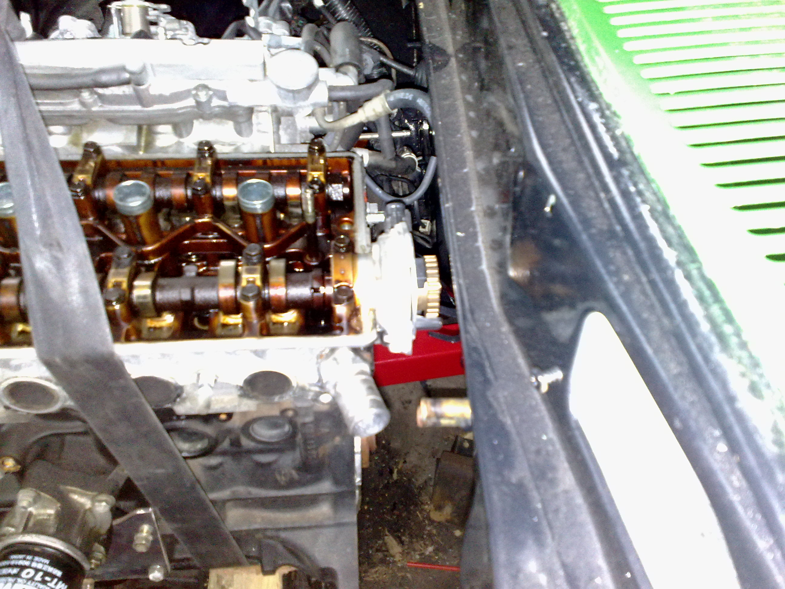

ok for the 20valvers i left 20 mm from the end of the dizzy.(to allow engine movement plus the extra distance the dizzy cover takes up.)
for you 16valvers i can leave the mounts as is but the distance is 70mm from head to firewall.

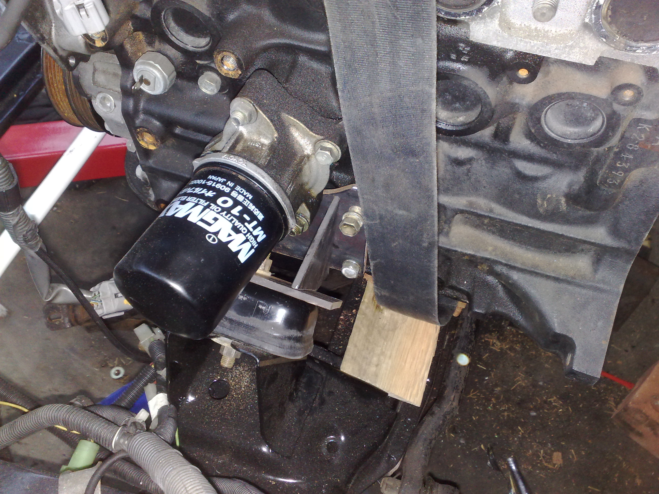

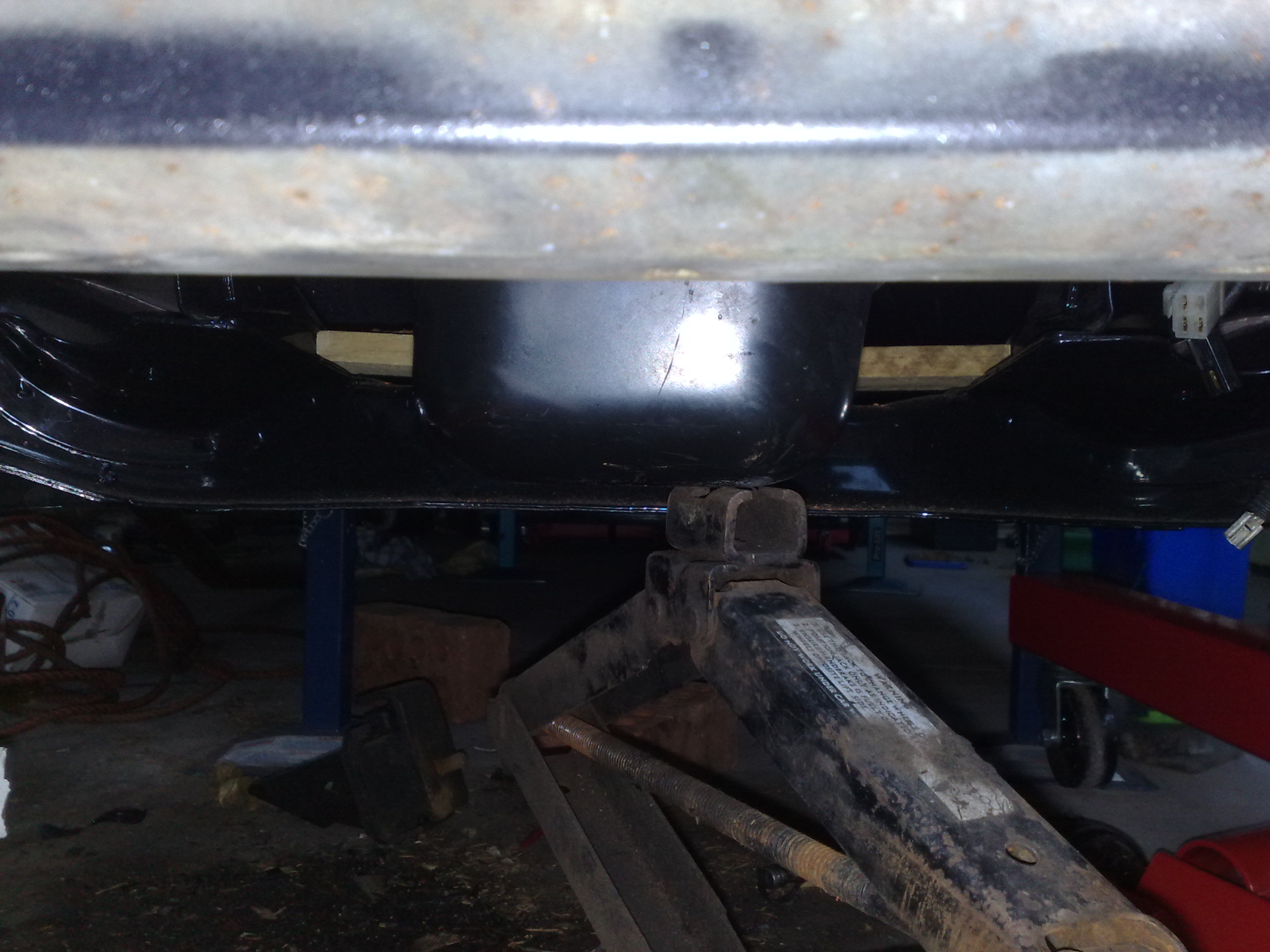

sump
hard to see but it is flat
and height
mounts aren't welded just test fitted before duplicating the sections

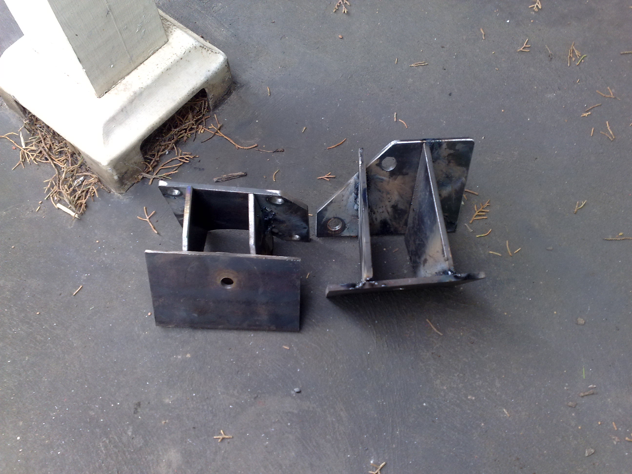

ok engine mounts tacked together.
a little messy... i aint no welder.
getting our boiler maker to clean em up and weld them properly!
then powder coat!
then make more sets!
