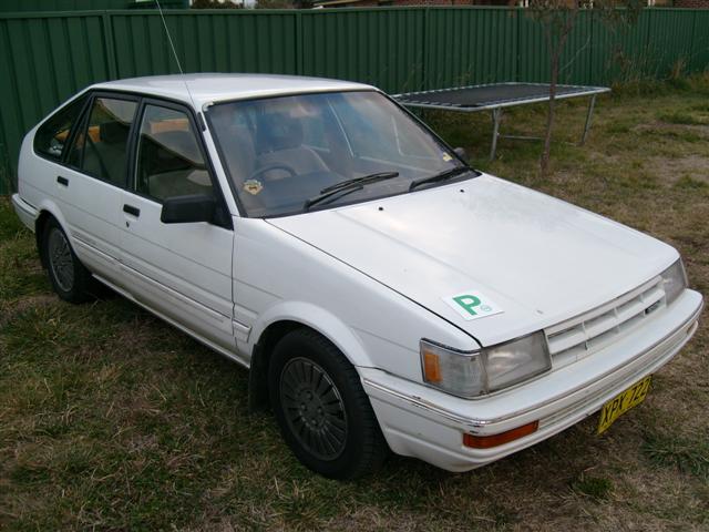

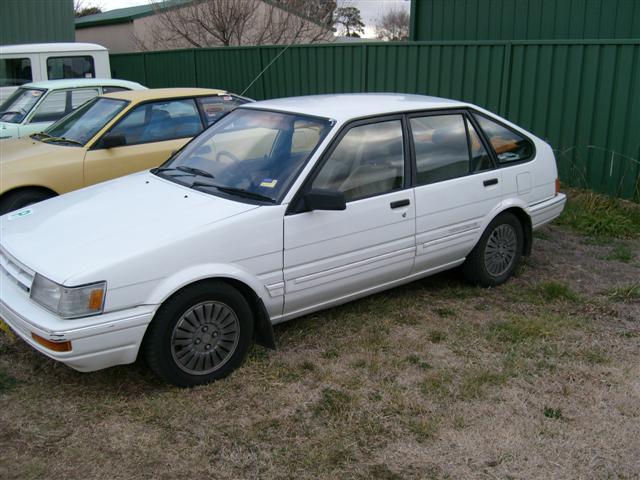

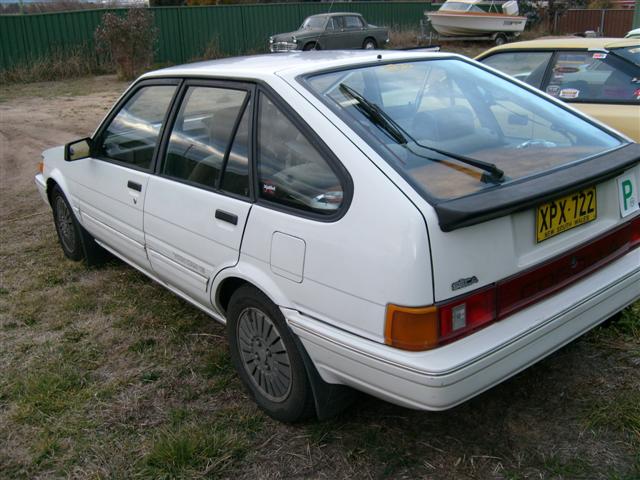

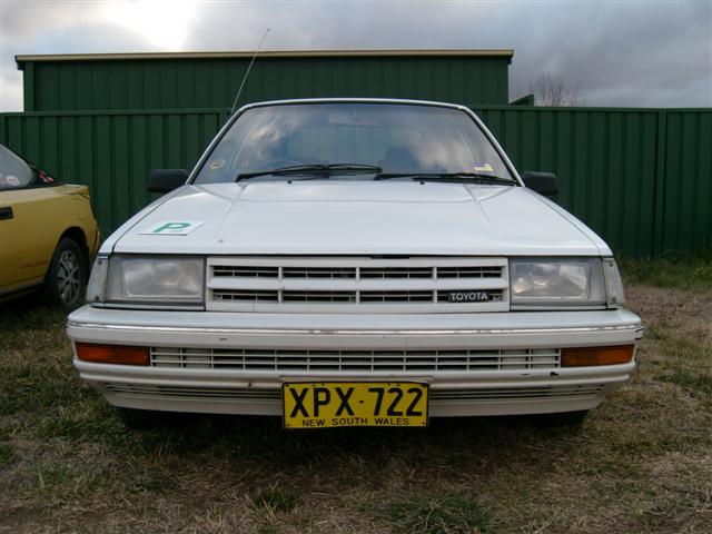

After my KE25 rego ran out, i registered a celica to drive around. Got sick of that fairly quick, so i was searching again. Saw an ae82 twinky for sale (In Town, So much more appealing) so i just had to have a look.
Went and had a look, and a drive. Was very happy with it, after a quick rust check and general look over decided to buy it. He was asking 1600, but i just asked what would he be willing to take. So i ended up paying $1000.

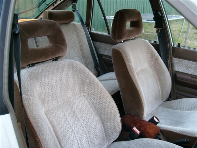

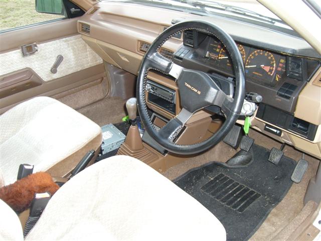

Original good condition, hasnt been Molested for wheels, stereo etc. Interior is still in nice condition. White Paint (had a 50% chance of getting this colour anyway ;))

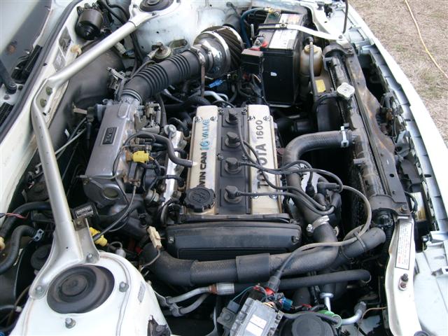

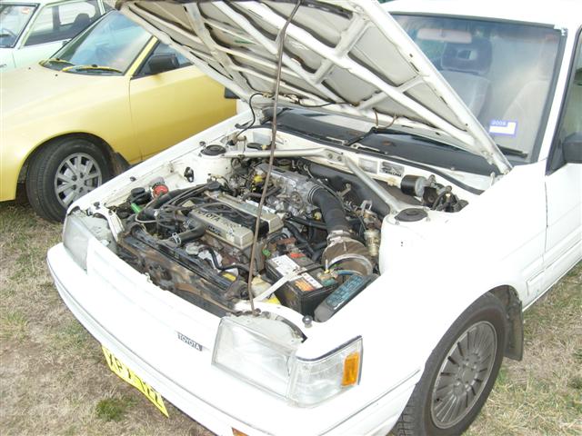

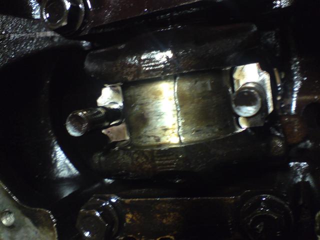

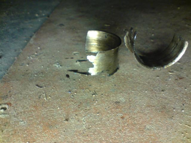

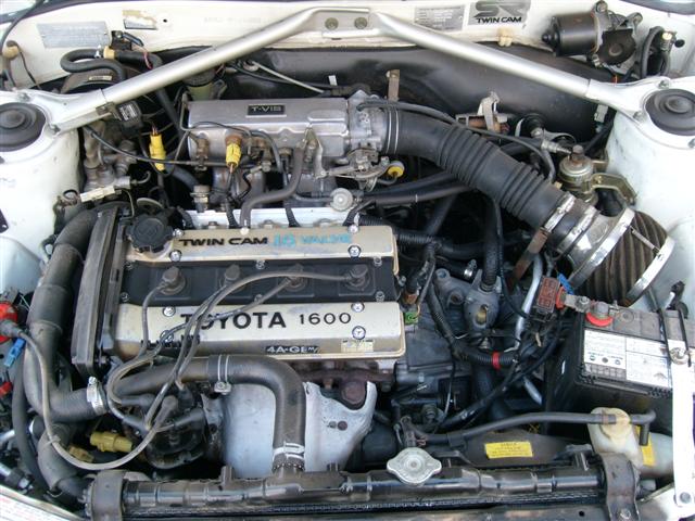

....................................currently parked in the middle of an outback village busted. Engine spun a bearing. Parked up came home. Might be parting it out if its worth my while.
Keeping engine, loom and computer for myself if i do

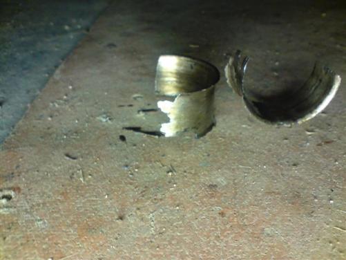

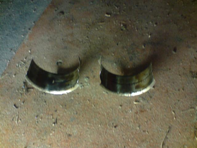

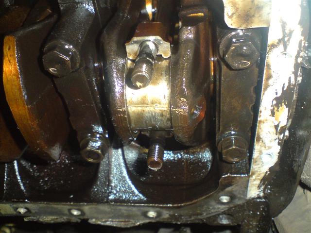

Got it home last night and pulled the sump off. Having a look at the bearings and got through them all and found out it was #4 bigend bearing that went.
There was enough room beween the conrod and the bearing itself for us to move the piston up and down about 3mm or so in total.
