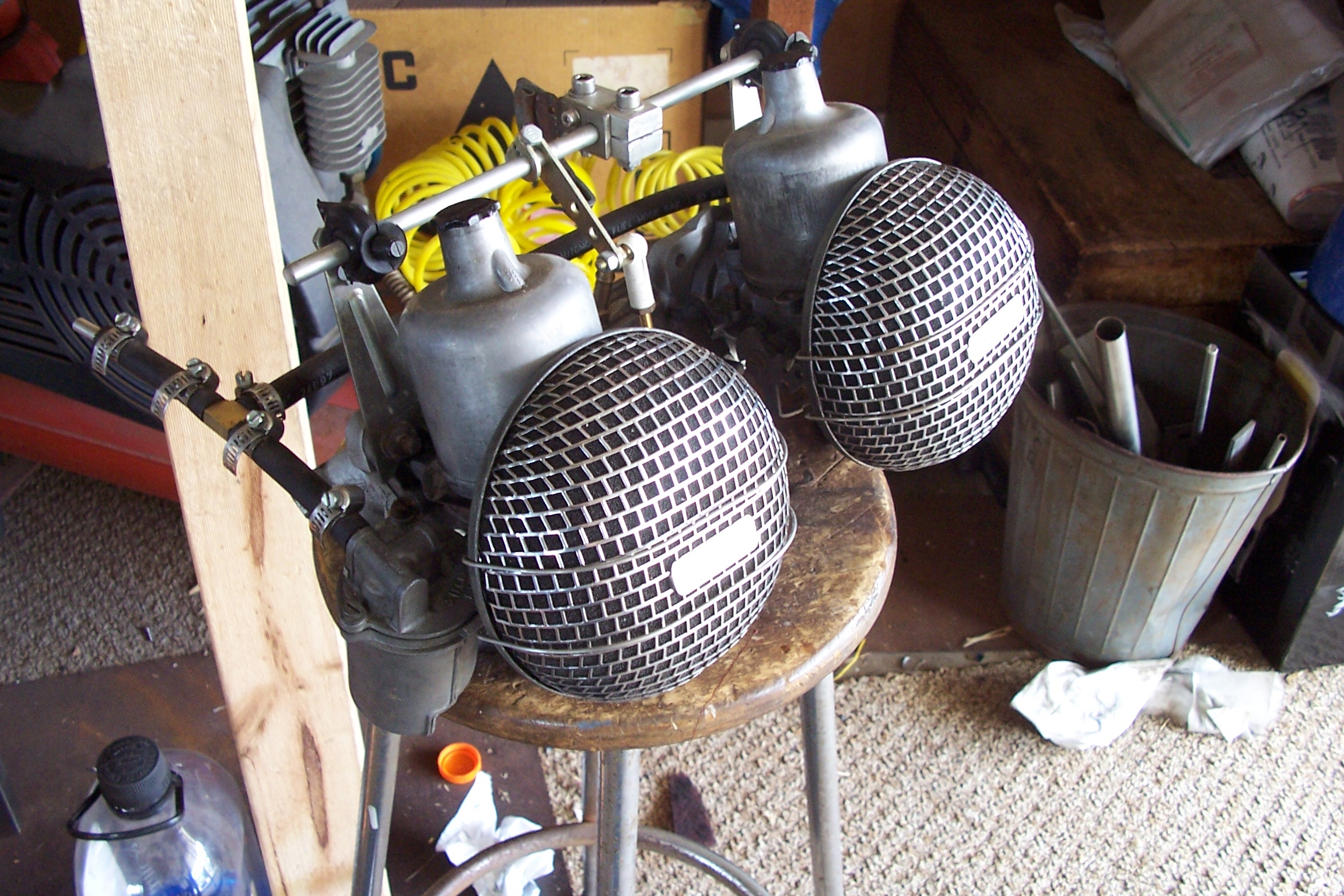

October 19, 200818 yr comment_282716 hey can u take some pics of the back of ur SU's i need to see something thnks Report

October 20, 200818 yr Author comment_282982 oh and myles most of my su linkage setup is custom but i am going to redo it becuse it has to much flex. you have to make linkages like the ones i have so that the accelertor cable doesnt hit on the rocker cover. Report

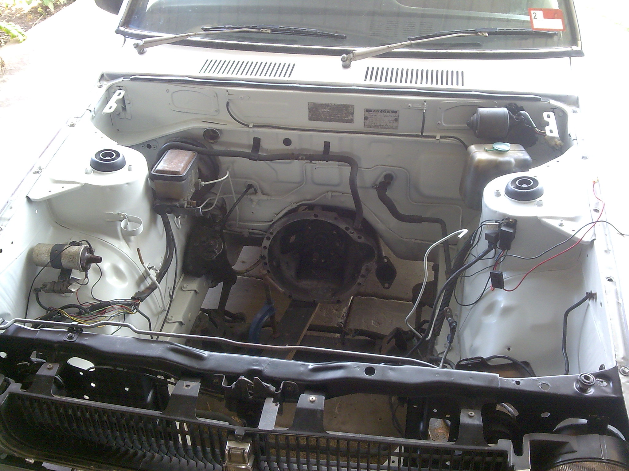

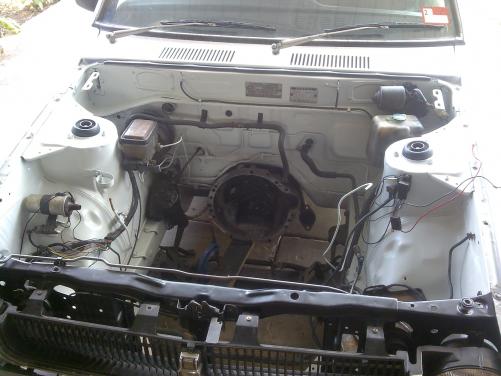

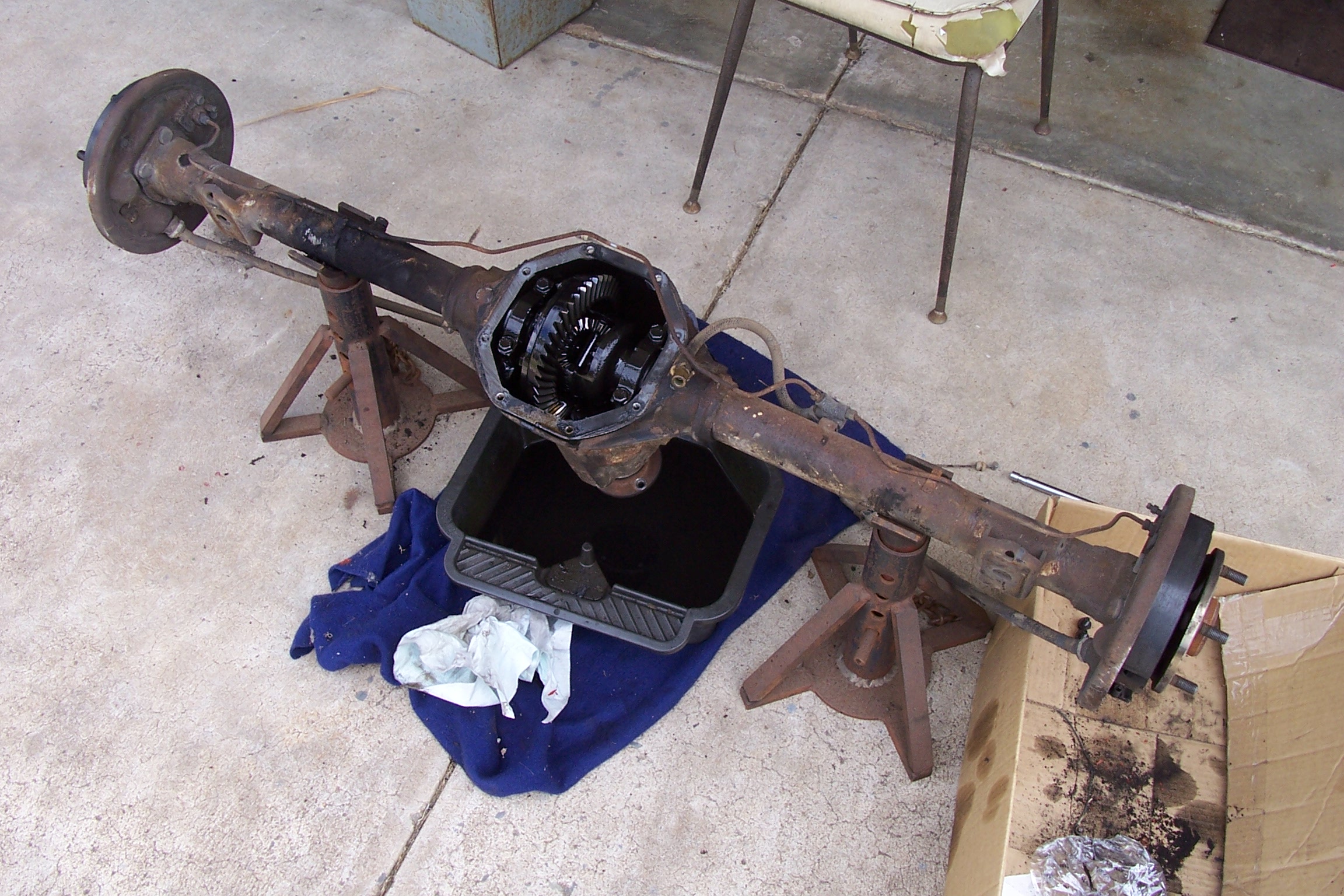

December 5, 200817 yr Author comment_295406 Bit of an update. Got the new rear end in the car and made the leaf springs look a bit nicer. (i put the clamps back around the spring packs so they look nicer) Still have a horrible noise coming from the rear end. Could be wheel bearings, pinion bearing(i *** hope not) or posibly tailshaft. Finally got the flywheel and new clutch on the motor so it is now officially ready to go in. THe clutch i got is a heavy duty exedy jobbie which should hopefully take the the abuse. And as of this afternoon the car has no motor. Me and my bro ripped out the 4k-you that has been running on 3 pots (still got a bit of grunt on 3) so that we can pait the engine bay white before the motor go's in. Oh yeah look at the twin 4k powered wheelbarrows..... Report
December 7, 200817 yr Author comment_295860 Manifold is a lynx jobbie. I got the whole lot of ebay a while back. Got new carpet for the car now (upullit special) and a new steering wheel, so the interior is starting to become liveable. I'm after a new front bar, so if anyone has one in adelaide please let me know. Report

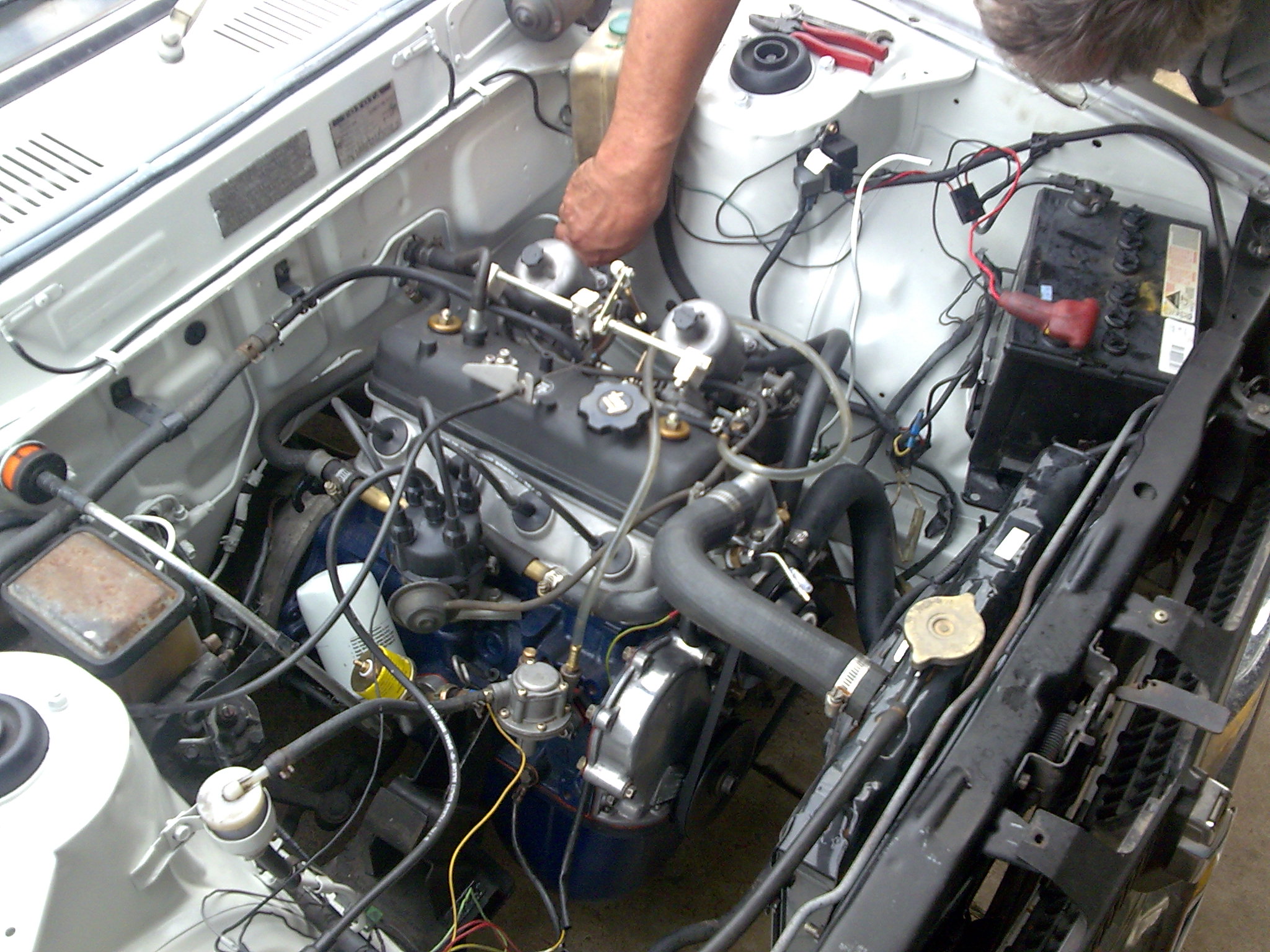

February 19, 200917 yr Author comment_320230 ok, after a long absence i finally have an update on the progress of the wagz... since my last post i fixed the noise coming from my new rear end, it turned out to be the wheel bearings were stuffed, had to use the oxy set to heat up the housing to free them but its all good now. i have also painted the engine bay white instead of matte black so everything stands out a bit more and i have fitted the new donk. so far i have done 500km's in it so i think that its just about run in now, motor seems to be fairly strong, got a nice lumpy idle and revs nice and free, cam starts to do its thing at around 4000 rpm but the SU's need some different profile needles because its lacking fuel at the top end. so far ive had it out to 7000 rpm and it sounds awsome. i have also removed the coilover suspension and r31 skyline brakes from the front of the car. the main reason why i did it was because i didnt like how low it sat (i hate going through regency) and i bought some rims that wouldnt fit over the brakes so they had to go. i currently have some stock ke55 struts in the front with new pads and rotors (brembo ftw) but it needs some lowered springs to get the car level again. at the moment in needs a new sump gasket because the f@$ker is leaking and as of last week it also needs a new manifold gasket because that shat itself. i think the manifold gasket blew because the face of the extractors isnt flat, i have a new single peice jobbie here but i think that i may machine the face before i fit it. the sump is leaking because the gasket seemed to be to big when i put it on, i use sealant on both sides but its rooted so I'm pulling the motor out to fix it. anywho here are som pics of the motor in the car and the new wheels i fixed up for the car Report
