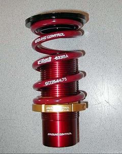

ok thanks. the site i saw them on is Ground control suspension systems . Can u tell me if i can get the ones they have in melb anywhere
Given that you were looking at SR5 ones in the States, (I'm a bit rusty here) I believe it should be for a TE Corolla, which to my understanding has different struts to our Au ones. I can also tell you that in 20 odd years I've never seen off the shelf ones for a 2x series in Australia.
this is what I'm chasing
they even have adjustable top hats which look exactly like ones guys on this site have made. They even look the same as the aus ones. I have been to europe and checked out rollas there . They run the same struts as we do. And seeing the sr5 is the same shape i presumed they would be the same as the body shape is the same. and the strut tops look very similar
