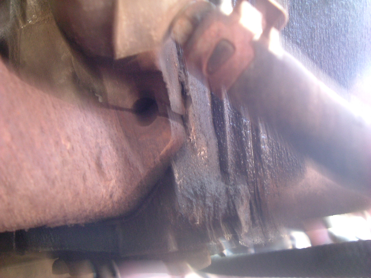

That's exactly what my front brake pads were like. All of them relatively fine except for one. Which was rooted.

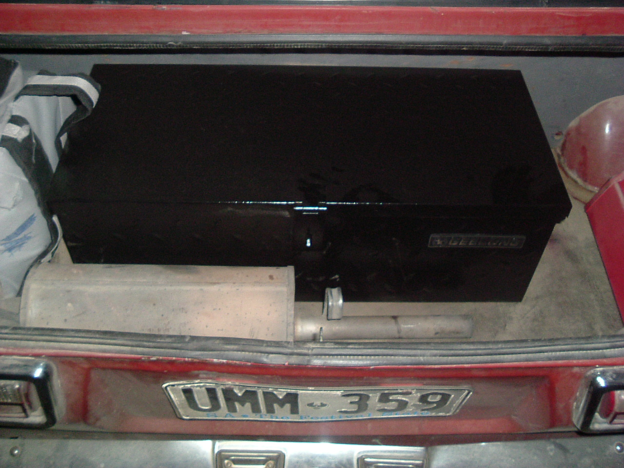

Today I purchased a black tool chest for the boot of my car to store the things that I always have with me in. Ie the car emergency kit, first aid kit, sleeping bag and spare change of clothes.
Am going to have to make a bracket to screw into so I can still get access to the spare Tyre, as otherwise the chest will slide around.
Would have taken a photo but camera is being stupid and won't turn on, so I'll borrow sis's later.
Mmmm....I like it. Nice new black chest.
wow your even carrying a spare muffler. :D
Hahahahahaaha
MMM i don't think it could get any more coats of dust on it :D
Travis
Muffler is getting put on this friday at a shop, would do it myself but don't have access to materials and equipment so its easier.
Trav, yeah thats kind of the point of the chest to make sure that everything inside it isn't coated in dust for the time being and eventually just kept tidy away from anything else that ever gets put in for a short amount of time. Ie shopping or peoples gear.

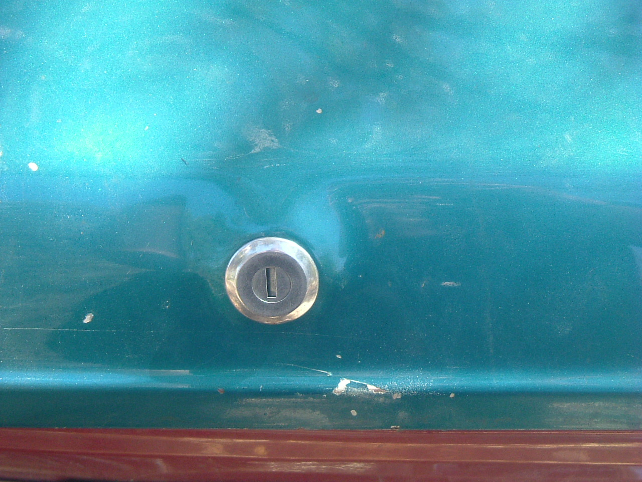

Got the boot lock re-keyed so that I can use it and have the car booked in tomorrow to get new tyres chucked on as I'm not a big fan of sliding. While its in getting that sorted I'm hoping to borrow my dad's car and go grab the gear needed to start removing rust and priming it. Car won't be painted for a while yet, just wanting to get the rust out asap. Might also go to upi and grab the boot release so I don't need to always use the key.

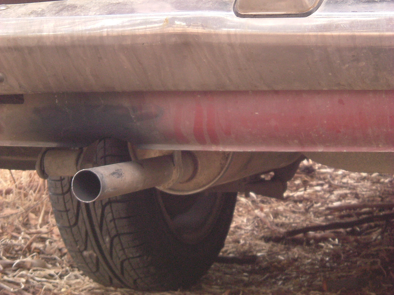

On friday I got the muffler welded on and it sounds a lot better being whisper quiet. I could finally hear the motor and that it didn't sound right at all.
