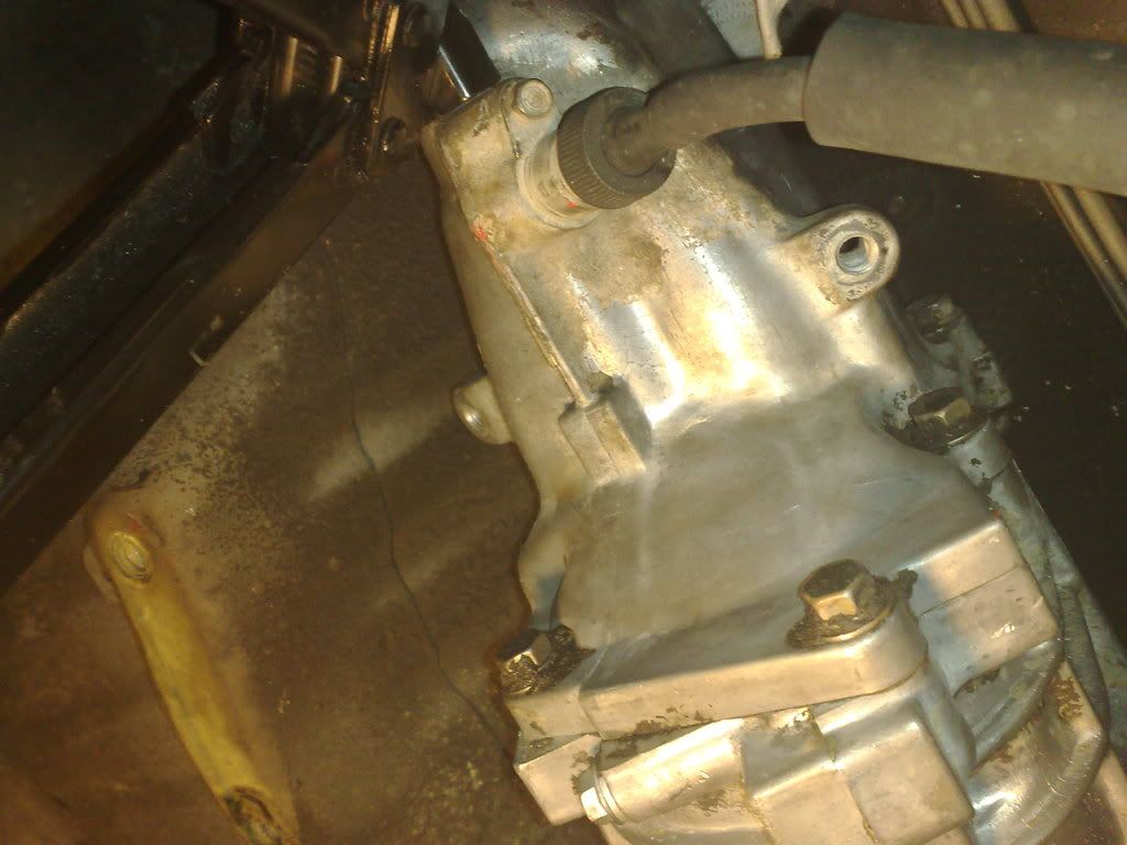

gday fellow rwd toyota loving enthusiasts.
right quick question for you guys who have purchased a new gearbox crossmember rubber mount for your T50 box (either in a ae71 or 86)
well first off the problem...my t50 didnt come with one!
so i figured order on through repco
i got a "kelpro" branded one for like 30$, code MT8019.
it looks like this
yep totally wrong part since i have to bolt it to this
now the problem is
the kelpro website lists this part number for both the ae71 and the ae86. both 4ac engines.

i would be taking it back to them and letting them know that its the wrong part,
i can get you the toyota part number, but the thing is the part might not be available from toyota :D
problem is, they are using the same catalogue that I'm using....and the part number is listed wrong.
so I'm wondering if anyone has the right part number. if you have a toyota part number that woudl be handy, as the website has a cross reference section :)

ae86 part no.
12371 INSULATOR, ENGINE MOUNTING, REAR NO.1
12371‑16030 4AGEU..AE86..MTM
12371‑33010 4AGEU..AE86
if you have a look at the link the below it shows you both mounts, but just taking a guess, it looks like you got the auto gearbox mount :jamie:

Go to Repco, they have them in the book, however like the OP you will get the wrong one, their part No is incorrect, get the AE86 one off the book, it is correct.
