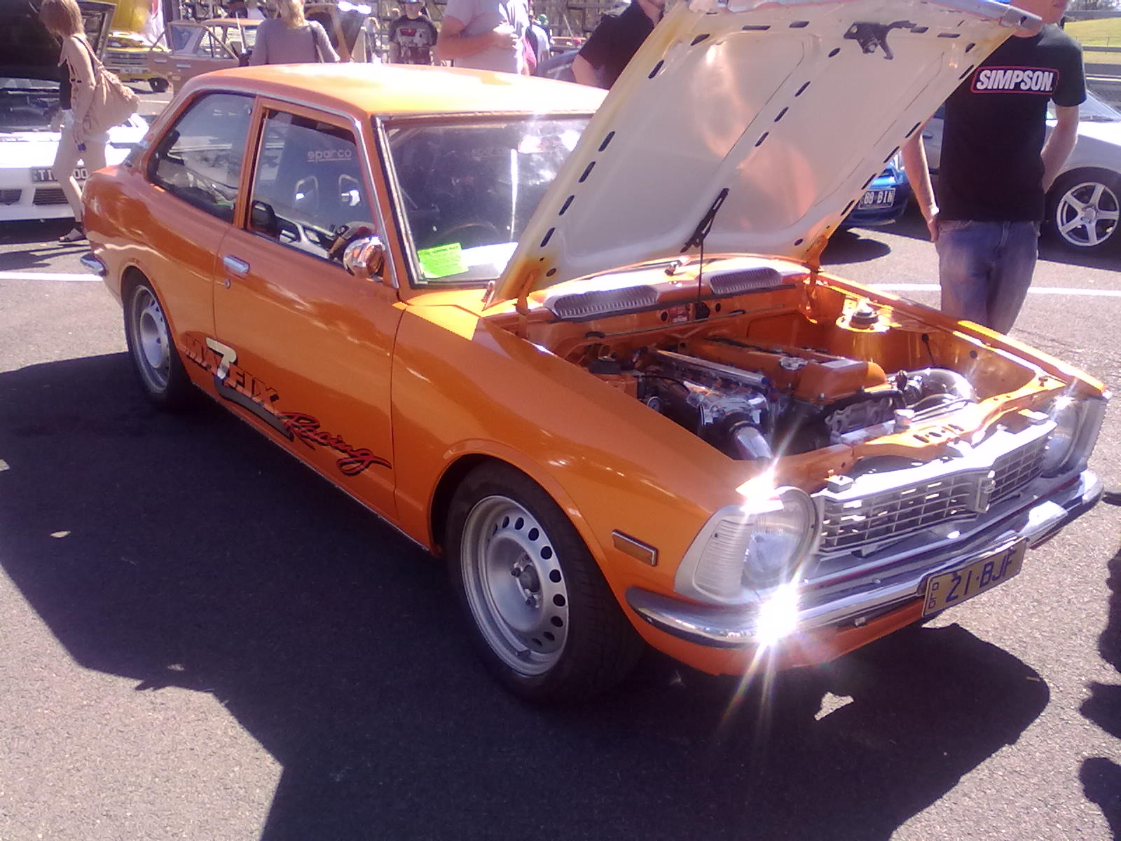

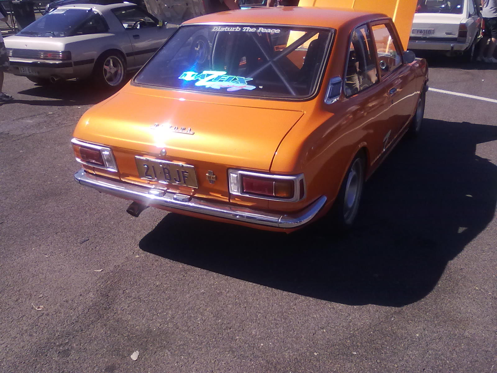

21-BJF Posted August 25, 2010 Author Report Share Posted August 25, 2010 Just some pics from jamboree. had a blast driving out there and back, feels sooo good on the street, can't wait to turn the power up. Quote Link to comment Share on other sites More sharing options...
13bke26 Posted August 25, 2010 Report Share Posted August 25, 2010 did you run it down the track at all? Quote Link to comment Share on other sites More sharing options...

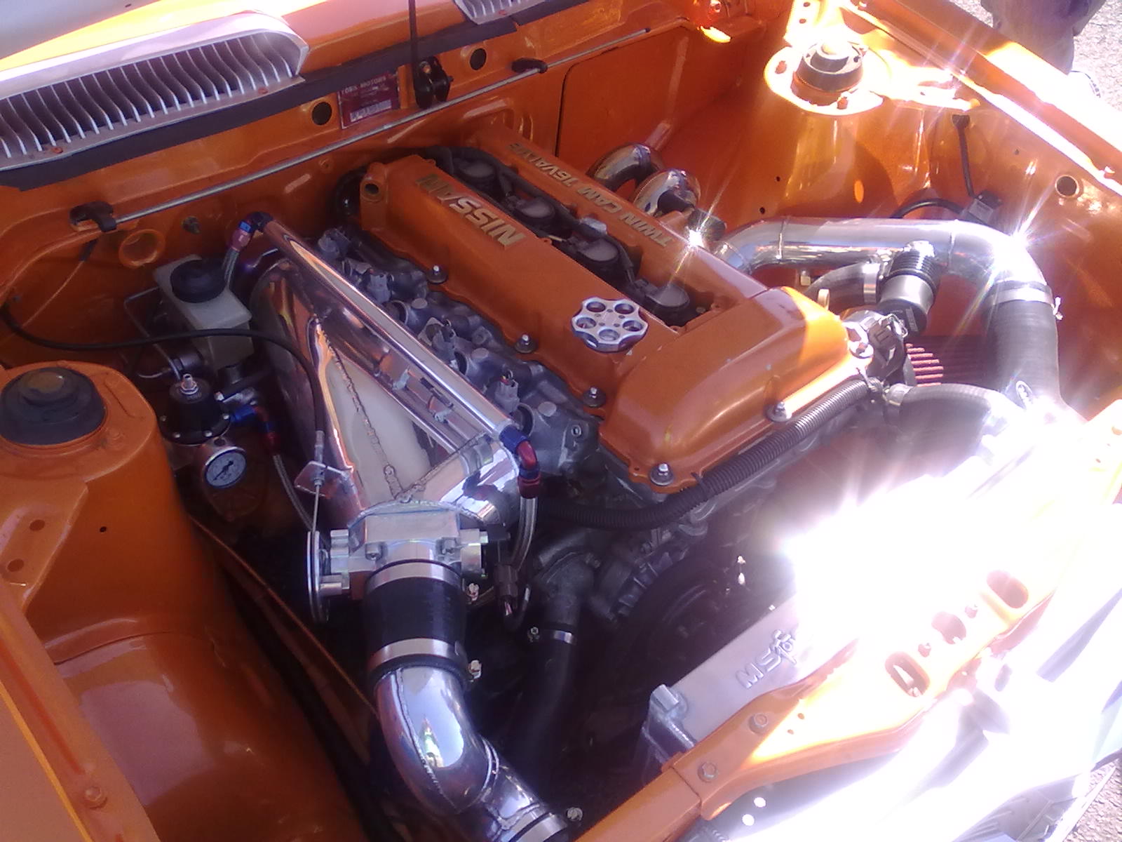

oh what a nissan feeling! Posted August 25, 2010 Report Share Posted August 25, 2010 saw this there, plenty of time spent on the engine bay, nice and tidy. Quote Link to comment Share on other sites More sharing options...
LXY-642 Posted August 25, 2010 Report Share Posted August 25, 2010 Gotta paint the underside of that bay I reckon. Car looks awesome though man good work Quote Link to comment Share on other sites More sharing options...
GJM85 Posted August 26, 2010 Report Share Posted August 26, 2010 Had a real good look at this... Quote Link to comment Share on other sites More sharing options...
vuk0003 Posted September 29, 2010 Report Share Posted September 29, 2010 He mate is it hard to get the sr2o engine in the ke20, this is also what I'm thinking of attempting next Nov of next year, so I am doing my research prior. Quote Link to comment Share on other sites More sharing options...

vuk0003 Posted October 5, 2010 Report Share Posted October 5, 2010 mate that is perfect, no other words i can use to describe it! Only thing i plan to do differently is no roll cage, and different rims, which i think you already know is very difficult to find that fit. I have a lot of questions for you however. Where did you find a good engine I'm a bit cautious not to get a good price but a shit engine. Was it hard to get the engine in there? and I'm looking at either an SS diff or one out of a Hilux apparnetly theyre pretty strong and get someone to shorten it? Or is there a better option as far as diffs go? Ye again mate you've done it up beautiful! love the colour to i think ill keep it yellow but make it special hehe, I have my cousin to do that for me has his pannel beating shop so Ill defiantly be saving some coin there! they are the rims i would like to get or one with 6 spokes in black Quote Link to comment Share on other sites More sharing options...

21-BJF Posted October 5, 2010 Author Report Share Posted October 5, 2010 Cheers mate. I went the hilux option purely for the strength it offers. I also now have skyline brakes set upon the rear aswell. Fitting the sr in was kkinda easy if u are skilled with a fbh, a f$&kin big hammer. We fabricated custom engine mounts using s6 rx7 ones as I had some left from my last car. We didn't find it too hard but we were in a fully stocked and decked out performance workshop. It could be done at home but u would need more paients then I have. More then happy to offer any help I can along the way if u get stuck, just give me a holla. Cheers b. Quote Link to comment Share on other sites More sharing options...
Ical Posted October 8, 2010 Report Share Posted October 8, 2010 Mate that is an awesome build.Very nice. Just one question(for now). So it is legal to put an SR20 turbo in an KE20 in QLD. Was there anything special to be done? I have the same car and wanted to do this a few years ago but was told not allowed. Any info would be great Cheers Ian. Quote Link to comment Share on other sites More sharing options...
21-BJF Posted October 9, 2010 Author Report Share Posted October 9, 2010 100% legal. mine is all blue plated and everyone is happy. thats the thing, legally i couldnt put a 12a carby motor in, but can put a turbod sr20. go figure . . . . Quote Link to comment Share on other sites More sharing options...
