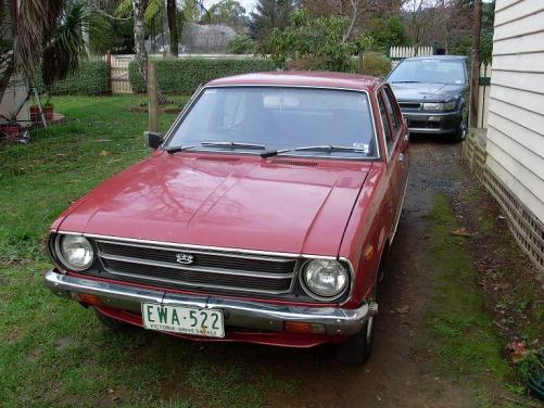

Pics?? Sounds awesome!!
just then, sorry bout the wait
OMG OMG OMG
Another rolla the same colour as mine YAYA!!.......there arnt many
mmmm 2T sounds good :bash:
keep us posted

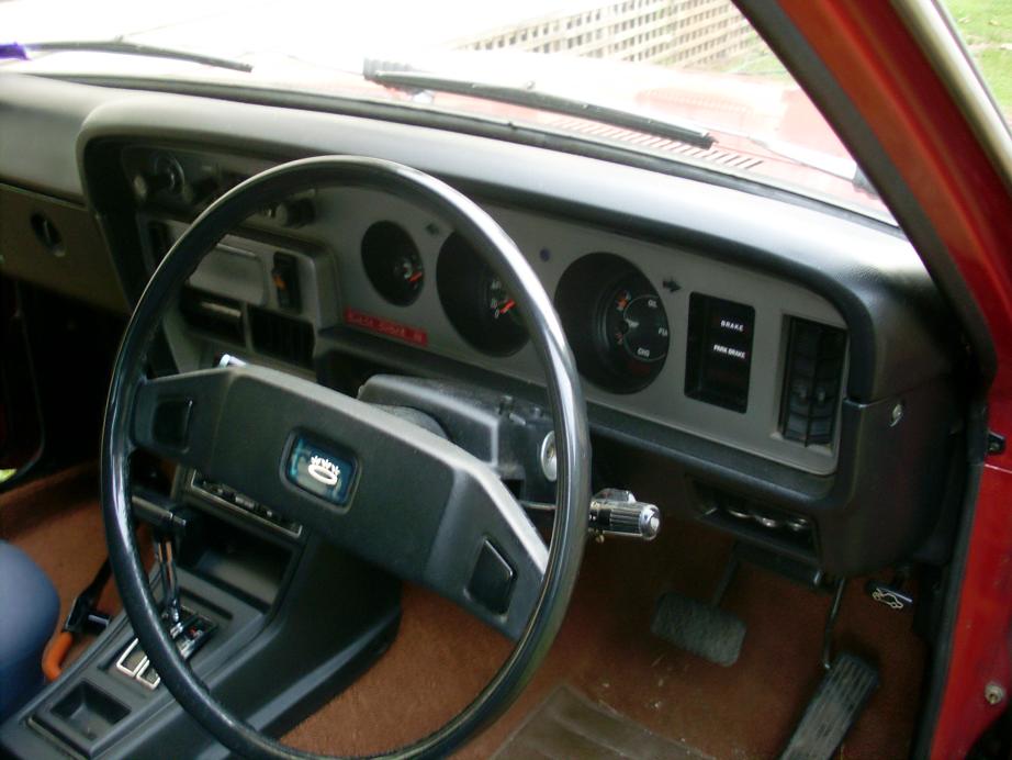

More pics of interia?
Cheers
Doug
cool how hard was it to get the 2t and t50 in there bud!!!
oh extremely..... nah , it only took a day.
customised the engine mounts , the t50 crossmember nearly bolted straight up , just had to elongate the holes a tad.
got a manual pedal box off of jip ( ta mate) and clutch master from the ta22. oh and shortened tail shaft.
hardest part was setting up the throttle linkage for the twin carbs from a 2tb.
even the exhaust bolted up . but thats not staying for long.
ill get some pics up soon

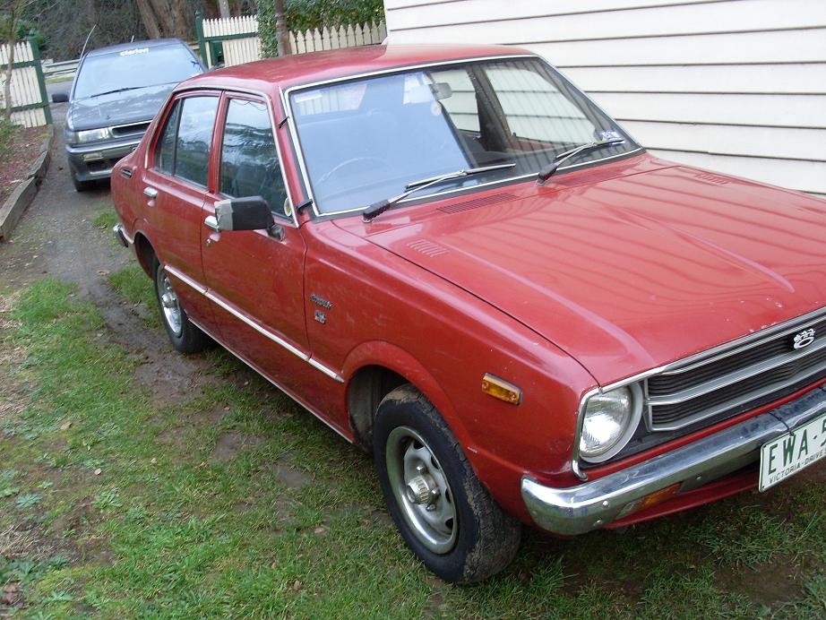

Yeah it's asham the interiour isnt the same
The car looks good. Are you going to keep the KEsev mirror on it or change it back to a KE30 mirror??
keep that mirror, the original was knackered.
