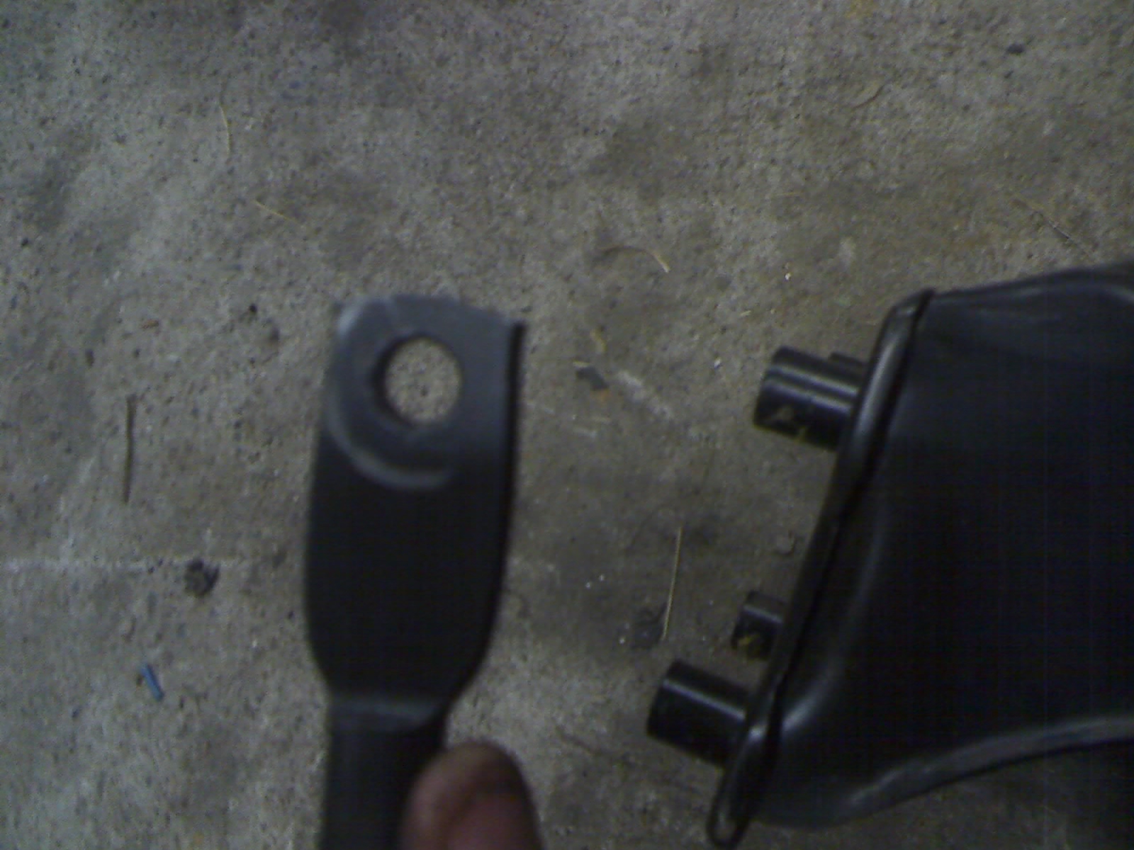

as stated in theory this should work aye

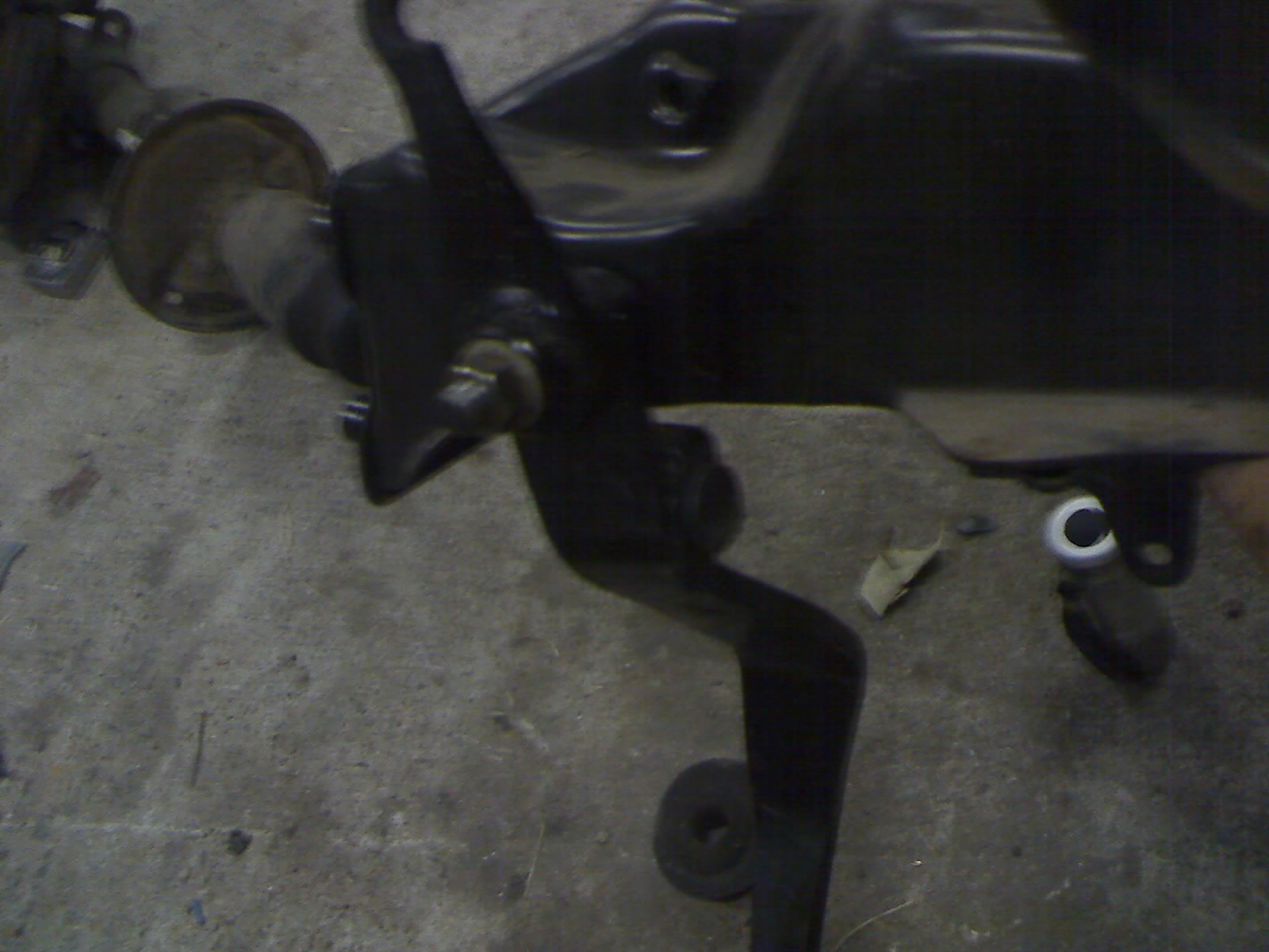

pedal box
supposed pushrod end!

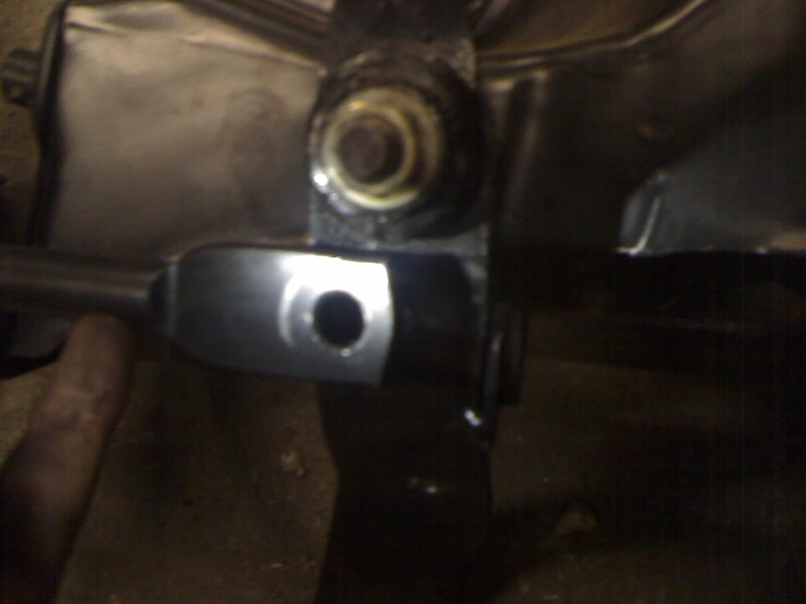

were supposed push rod end will bolt up
so theoretically this should work if i drill a hole around this^^^ area and space out the said pushrod part to clear the brake booster???
nobody has any ideas or opinions on this???

My Ke35 runs a hydraulic clutch and is done basically as you have stated - the master cylinder is mounted on the firewall and the pushrod is connected to the pedal through a hole drilled in the pedal.
Check that there is enough throw through the range of the pedal to actuate the hydraulics. You might need a custom pushrod if there isn't.
I also would have though the push rod would be better mounted to the top of the pedal, above the pivot, but I don't really know why I think that. Probably just a leverage thing.
Also make sure that you don't bottom out the clutch master cylinder - if the rod has more travel than the cylinder has, you'll bend the rod. Make sure you put a stop under the clutch pedal or something ...

i welded the bolt to the pedal and braced it with some small bits of angle.
very strong and suprisingly still quite easy to remove etc
