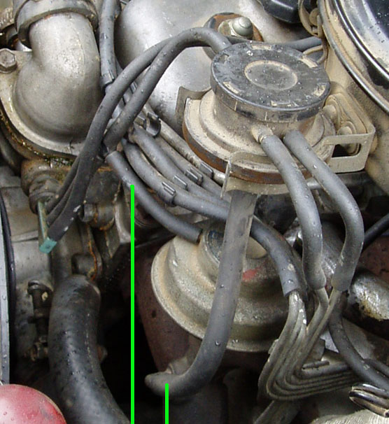

The only hoses off the exhuast I think are these two.
But you will need to make sure you kill those circuits as they go to the carb rather than at the manifold end.
So carb is running fine, manifolds are sealing properly, hoses are sealed.... I can't think of anything else...
yeah i plugged both these hoses
