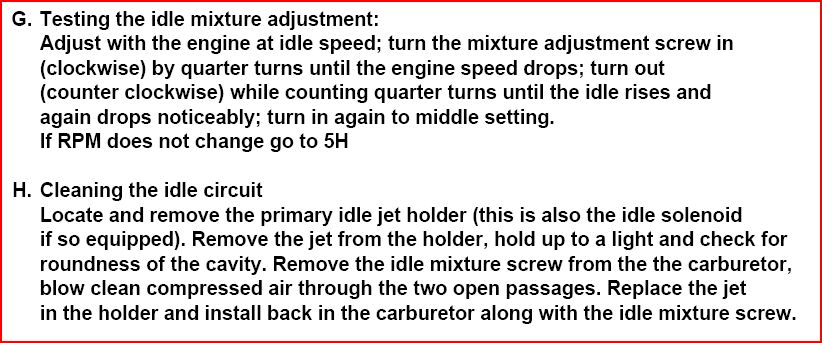

if all else fails go through here http://www.webercarbsdirect.com/v/vspfiles...ing%20Guide.pdf
or try getting a pdf manual on how to tune the carby properly
heres what you need from the guide:
