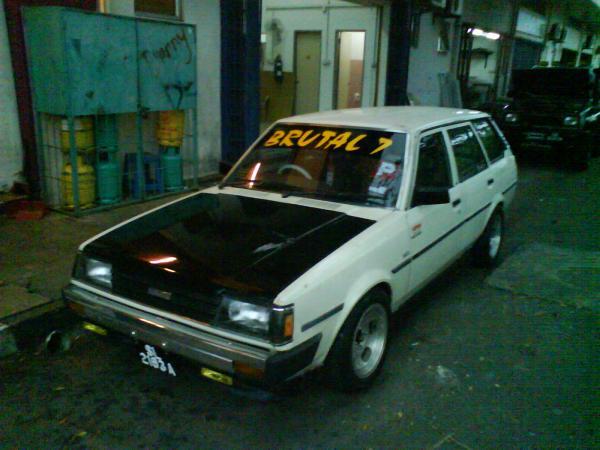

July 23, 200917 yr comment_360940 i also got a wagon like yours...also 4k turbo converted... i now using a tco-5 turbine and two 4ag fuel pump and stock carb can go 1.2 bar easily... :y: here is the pic but the intercooler is not true... :lolcry: Edited July 25, 200917 yr by wagon 2163 Report

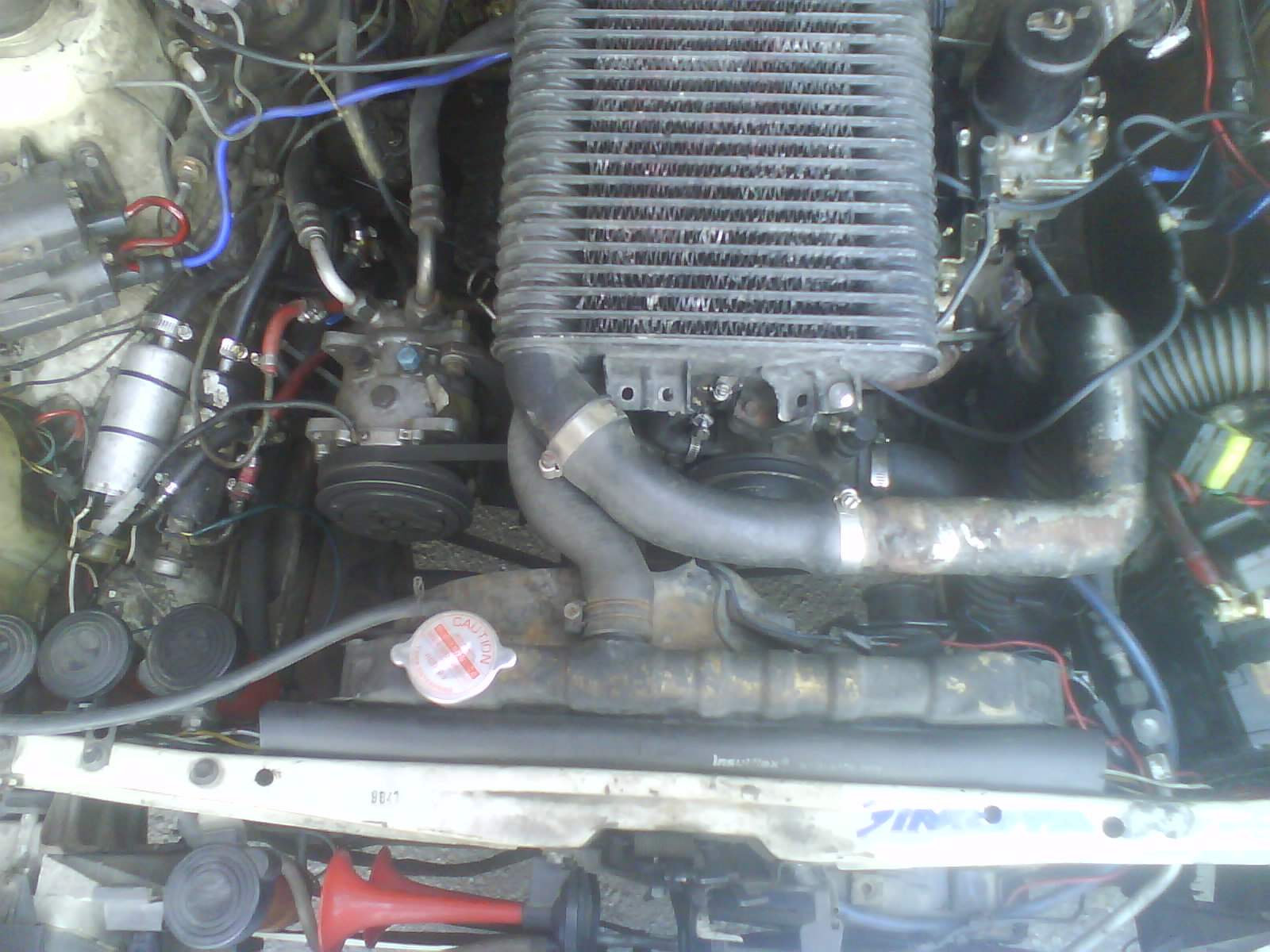

July 25, 200917 yr Author comment_361229 Engine bay pics? engine not tidy lo... Edited July 25, 200917 yr by wagon 2163 Report
August 4, 200917 yr Author comment_363633 your stock carburetor wont leak when boosting??? won ar...coz i already modified the cold start pump...and all the carb cap screw i already change to 8mm bolt...very tight... Report
August 5, 200917 yr comment_363672 won ar...coz i already modified the cold start pump...and all the carb cap screw i already change to 8mm bolt...very tight... And what have you done about your fuel system? How many PSI of fuel pressure? RRFPR? :hmm: Report
August 8, 200917 yr comment_364490 1.2 bar on a 4k shes gonna blow Edited August 8, 200917 yr by ae174agze Report
August 10, 200917 yr comment_364731 1.2 bar on a 4k shes gonna blow fark off, I and many others have run 20+psi on stock 4k's. :lolcry: Report
October 3, 200917 yr Author comment_378771 And what have you done about your fuel system? How many PSI of fuel pressure? RRFPR? :) i just install a sard fuel fegulator and the fuel regulator spring already change to soft one...when engine idle fuel press is 0.9bar and max fuel pressure is at 1.9 bar... Edited October 3, 200917 yr by wagon 2163 Report
