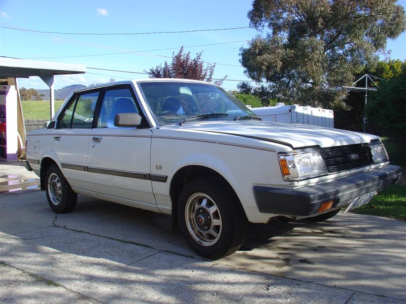

Ke70 Rally Car
Some pics. Interior out and seats in.
