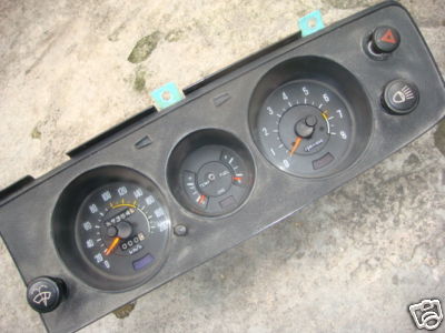

hi, I'm thinking of buying the instrument cluster off ebay for a ke25 / te27, its the one with the speedo and a separate tacho, with the other gauges inbetween .
Question is, will this just plug into my ke20 or is there different plugs on the back. If anyone has fitted one of these, your help would be much appreciated .
the one is pictured is the one i want to fit to my ke20

If it is the same as the one I had it will bolt in and the plugs are the same.......BUT...... you will need to swap a couple of wires around to make it work.
looky here to see how

You will have to wire up either an oil preassure guage or light aswell because the cluster does not come with one.
coln, i didn't need to swap any of the wires/pins around. my te27 cluster was plug and play.
thank you to all who posted for me. I am still thinking about buying one. I'm sure i will when one is re advertised. I have bought off gira before and he was gr8 with what i received. couldn't complain at all . The one for sale now, looks as though the face of it has be brush with steel wool . This is why i did not bid on it . Who knows maybe its just the pic
