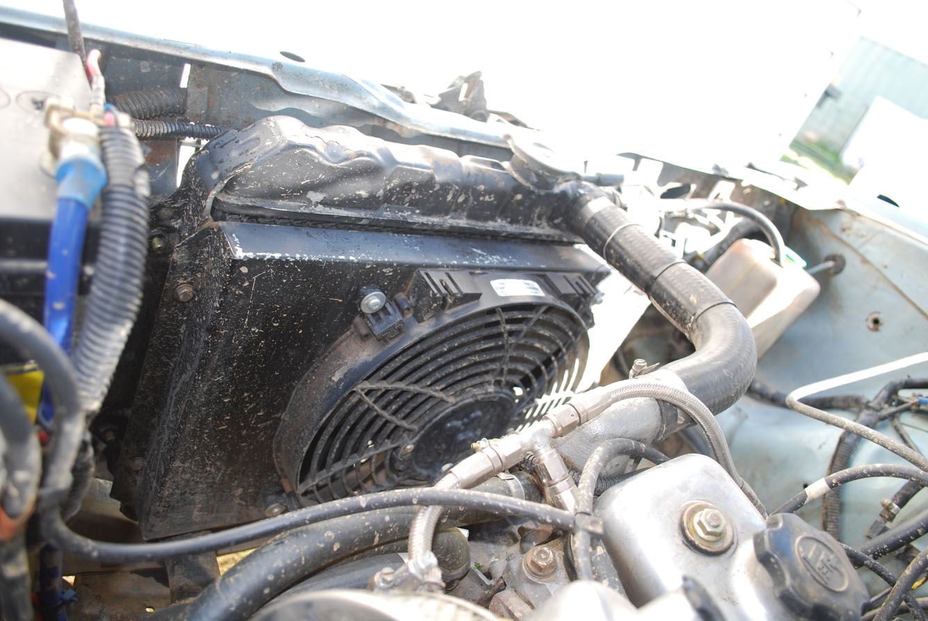

we had a shroud made up for my thermo by an air conditioning place and got it powdercoated black, the thermo is bolted onto the shroud and it's mounted on the radiator, not through the fins. works really well and looks neat too!

What material did the shop use to make the shroud? Got any pics?

it's made of some sort of sheet metal... lol
here are some pics, doesn't look as good as it did new but you get the idea :)
yeah thats similar to what I was imagining. That is a VERY good setup for an aftermarket thermofan.
thats a nice setup there corolla_nut
certainly some nice engineering gone into that setup.
i do have one question though.
when the fan isn't in use i'm just wondering how much that shroud would be restricting the natural air flow when driving along normally.
since you only really need the fan when the car is stationary or going up a hill under full load or something.
i know in my car i rarely ever turn on my fan (i have an override switch, since my little temperature circuit is being a pain) only in car parks or traffic.
