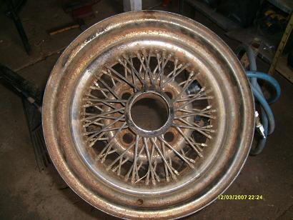

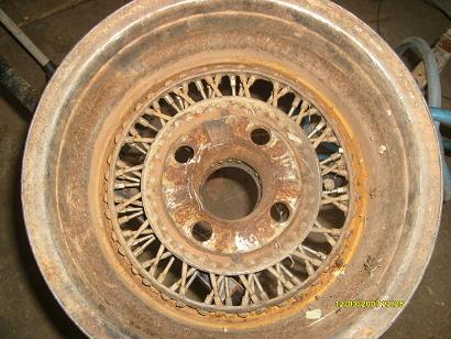

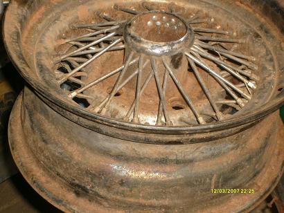

Hey All,
Picked up some wire wheels the other day for the right price(FREE!!) but I am having some trouble identifiying their fitment vehicle. Just wondering if anyone can give me a hand or point me to someone that can.
Specs:
Chrome Finish
14X7-72 Spoke
4X120mm(4.75") pcd
75mm(3.00") B/S
-12.5(0.50") O/S
Stamped W.R. Grace & Co. 1974
I looked them up and only found reference to an US Chemicial company that was being sued and bankrupted.
Thanks for any help. Cheers, Peter.
only car i heard of having 4 x 120 pcd, was mazda 121/rx5 and the 929 of the same era, very hard to find wheels to suit as nothing was the same
:S rx5 wheels are near impossible to find. Hence you wouldn't have much trouble selling these on Ausrotary.com
i just did a bit of internet searching and found that the 4x120 pcd avail on rx5's as above and mid to late 70's hondas.
i want looking at stuff like jags, mgs, triumphs ect but coudn't find anything in 4x120 that would suit these wheels.
I came up with the same infomation but it took some effort. I found through a contact in the US that the chemicial company W.R Grace & Co also made automotive rubber products and rims. They are no longer in existance.
Thanks for all your effort, I really appreciate it.
Cheers.
seen these exact wheels on a mg roadster sportster thingy today
Hey All,
Specs:
Chrome Finish
14X7-72 Spoke
4X120mm(4.75") pcd
75mm(3.00") B/S
-12.5(0.50") O/S
G`day mate, I had a quick look around and came up with a bit of info on the manufacturer of the wheels. Check out the website attached http://www.freepatentsonline.com/4275931.html It appears the W.R.Grace and Co. came up with a wire spoke wheel that is suitable for use with tubeless tyres. Good stuff because the old wire laced directly to the rim used to chew up tubes like mad. Rim bands only slowed the process a bit.
A guy that I worged with many years back had a set of these on a Corona mk11 and they looked pretty schmick, but were a pain in the proverbial to keep clean. I tried to fit them on my Mazda 121 coupe( same as RX5) when he eventually crached his car but they were obviousle the wrong pcd. Dam shame coz they would have looked great. I dare say that they will be worth some good bucks to someone in the "chook cooker" circle, so don`t give them away.
Anyway, cheers.
