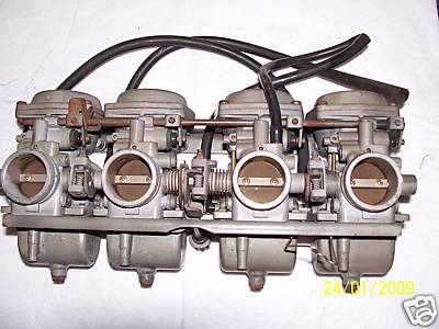

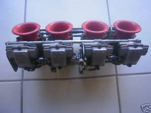

Currently doing this to my 3tg, I'm using Keihin FCR41's which are 41mm. I had plans to put a set on my 4k before it blew up, and they were 32mm i think. If your going a fairly worked 4k i'd go for maybe 38mm carbies but that would consist of, big-ish cam, high compression and flowing exhaust. If you're keeping it relatively standard don't go anymore that 35mm in size.
Also you would have to make up your own manifold or adapt them to a twin side draught manifold some how. Wouldnt say its the easiest option, but its something different and it works wonders if its done right.
Carbies with all the black hoses were the ones I was going to use on my 4k, ones with red ram tubes are going on my 3tg.

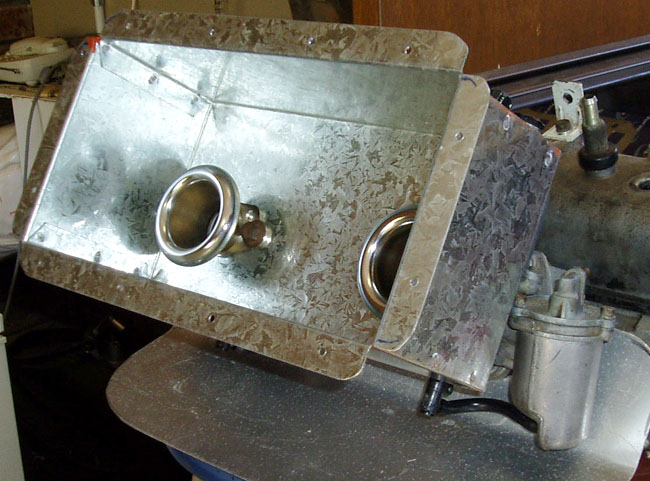

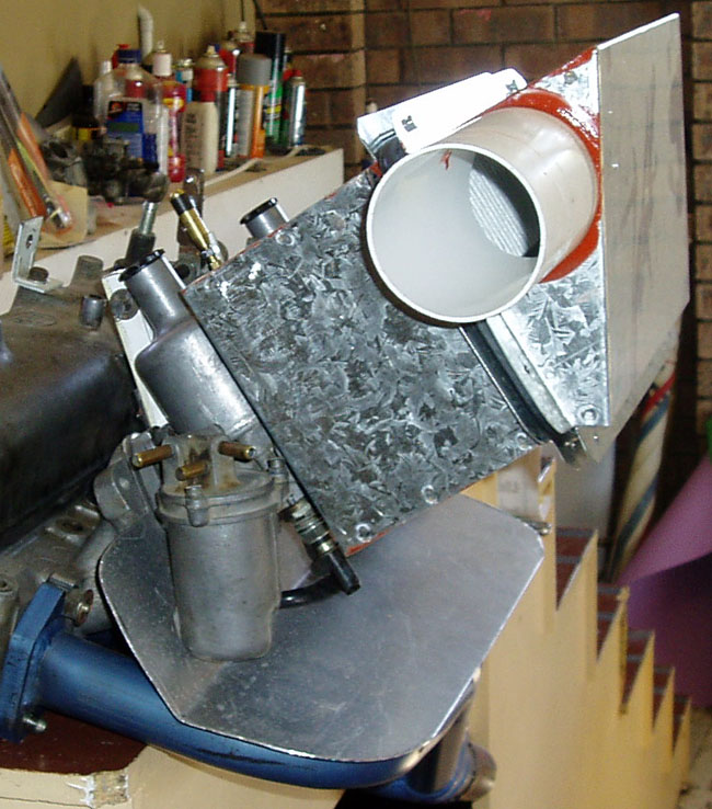

It crossed my mind for the KE70, but I haven't got the gear to weld my own manifold up out of steel pipe anymore. SUs will have to do for me.
If you're keen you can airbox them with a cold air intake and run a recent-model Corolla filter.
