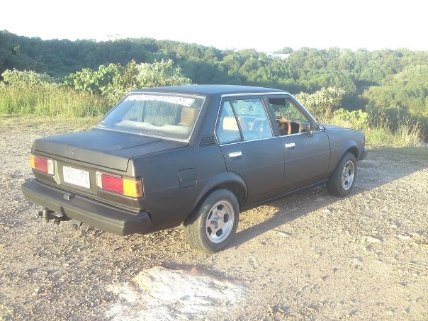

B.L.Z.BUB
Cop Bait Ke70
Sold but still in my heart.

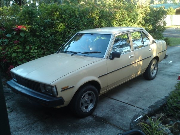

when bought

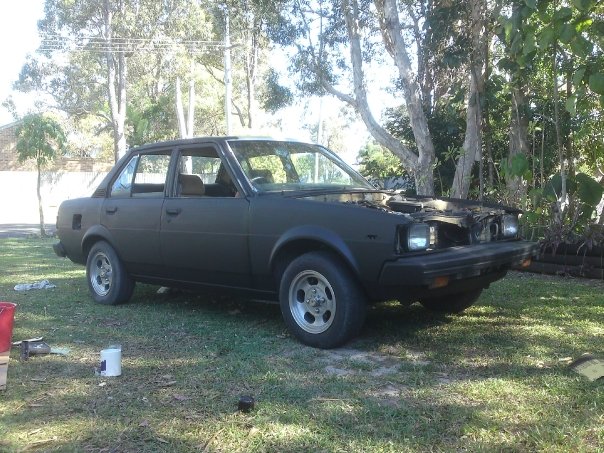

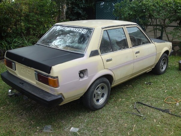

fixing rust

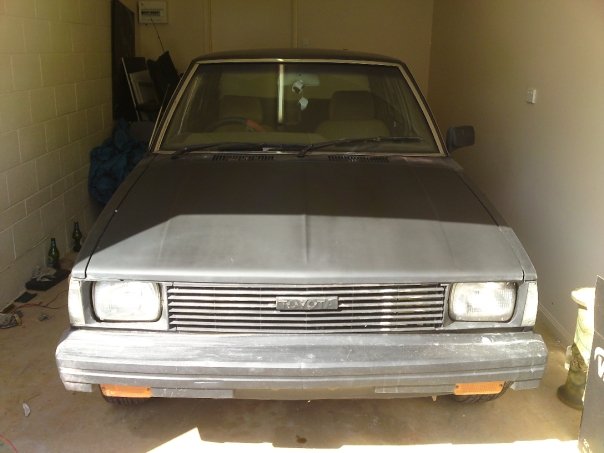

quick coat of black spray cans

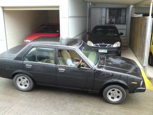

a beauty shot

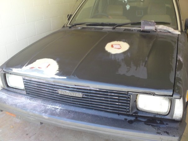

fixing those bonnet dents *shakes fist*
slowly turning into more parts than car as i get kinda anal about doing it up. One thing leads to another.

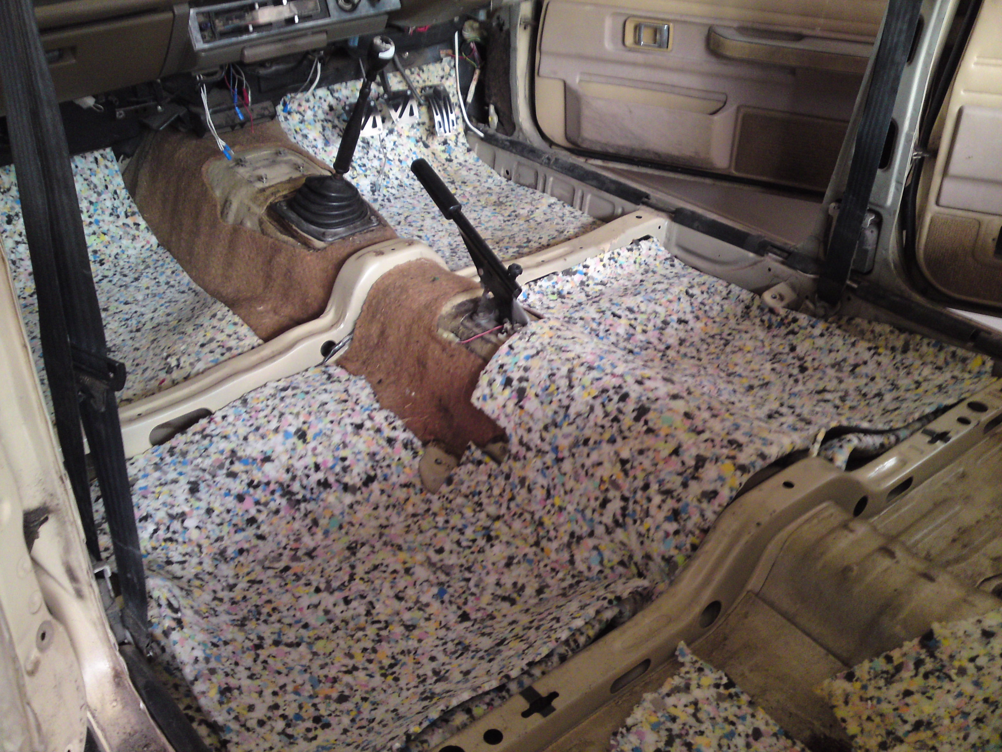

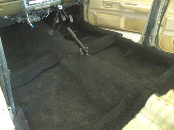

fitting new carpet which ended up in stripping all the trim so I could paint it. God knows what ill do to the seats now they are out..

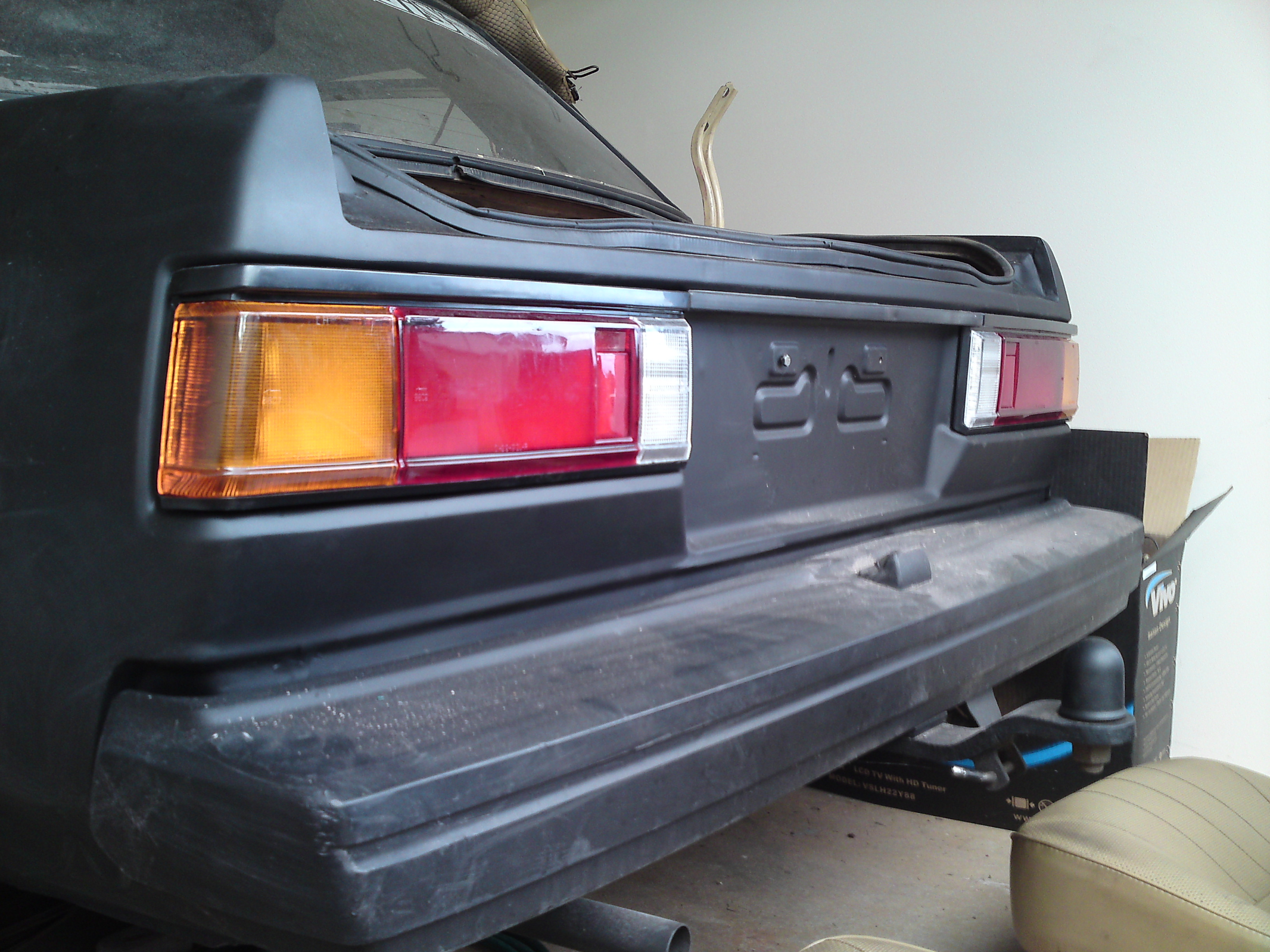

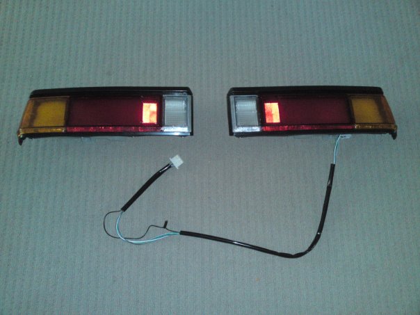

brand new shmick tail lights. Imported from Malaysia i think. Repco only had left ones! These came with bulb holders and everything. Was awesome deal and, as the proverbial budgie says, Cheep.
Yeah so thats a few of the many pics so far. Didnt wanna overload my first post. Hope ya like it as much as I do so far!

Carpet was dirt cheap too! Fron Knoxautocarpets.com i think. Fully moulded brand new with the drivers foot pad. Nothing was cut out tho but i had the old shit, put it on top of the new shit, and chalked out the holes. Good opportunity to clean out 27 years of crap under the carpet as well. Plus I scored a bunch of brand new carpet underlay from a building site (job perks) to replace whatever the hell they put under the old carpet.

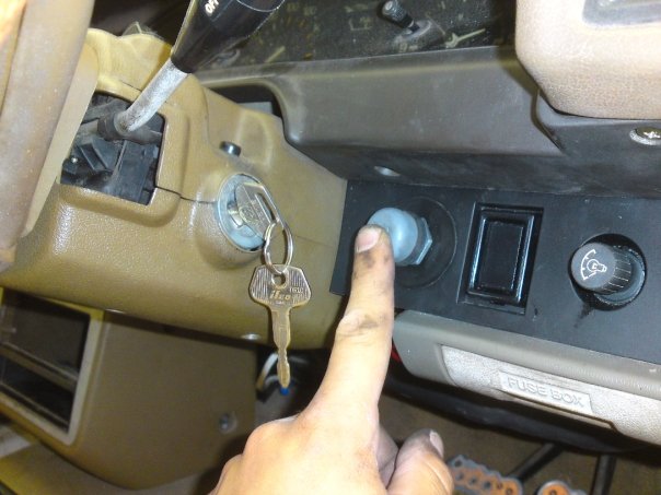

previous owner had a pust start button, i remounted it in the doorlight space as it(doorlight) didnt work

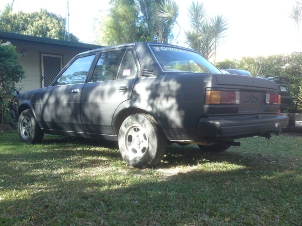

there is something about matt black cars in the wet that make me feels a bit tingly in the pants...
and just another generic glamour shot.

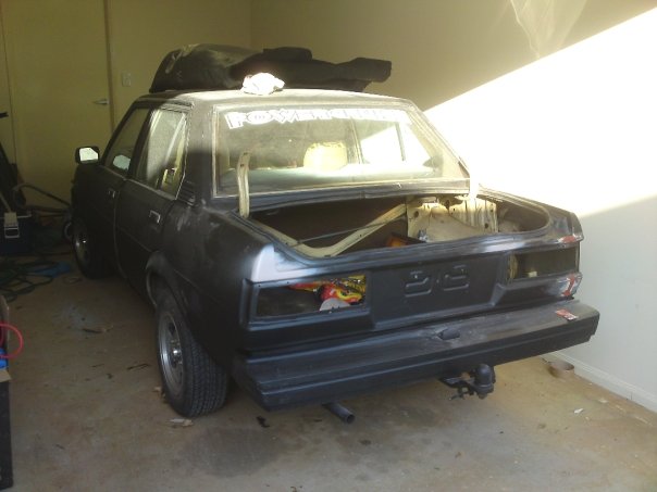

today i stuck the tail lights in and put some underlay down. Stripped two door cards down ready to remake them and scrubbed 28 years worth of crap off all the plastic trim ready for paint. I hope its my almost flat battery cos the tail lights are doing weird things, brake light flashing when indicator on, gonna have to check my grounding methinks.
thats it for now spent more time cleaning the garage than anything else, at least i found most of my tools!

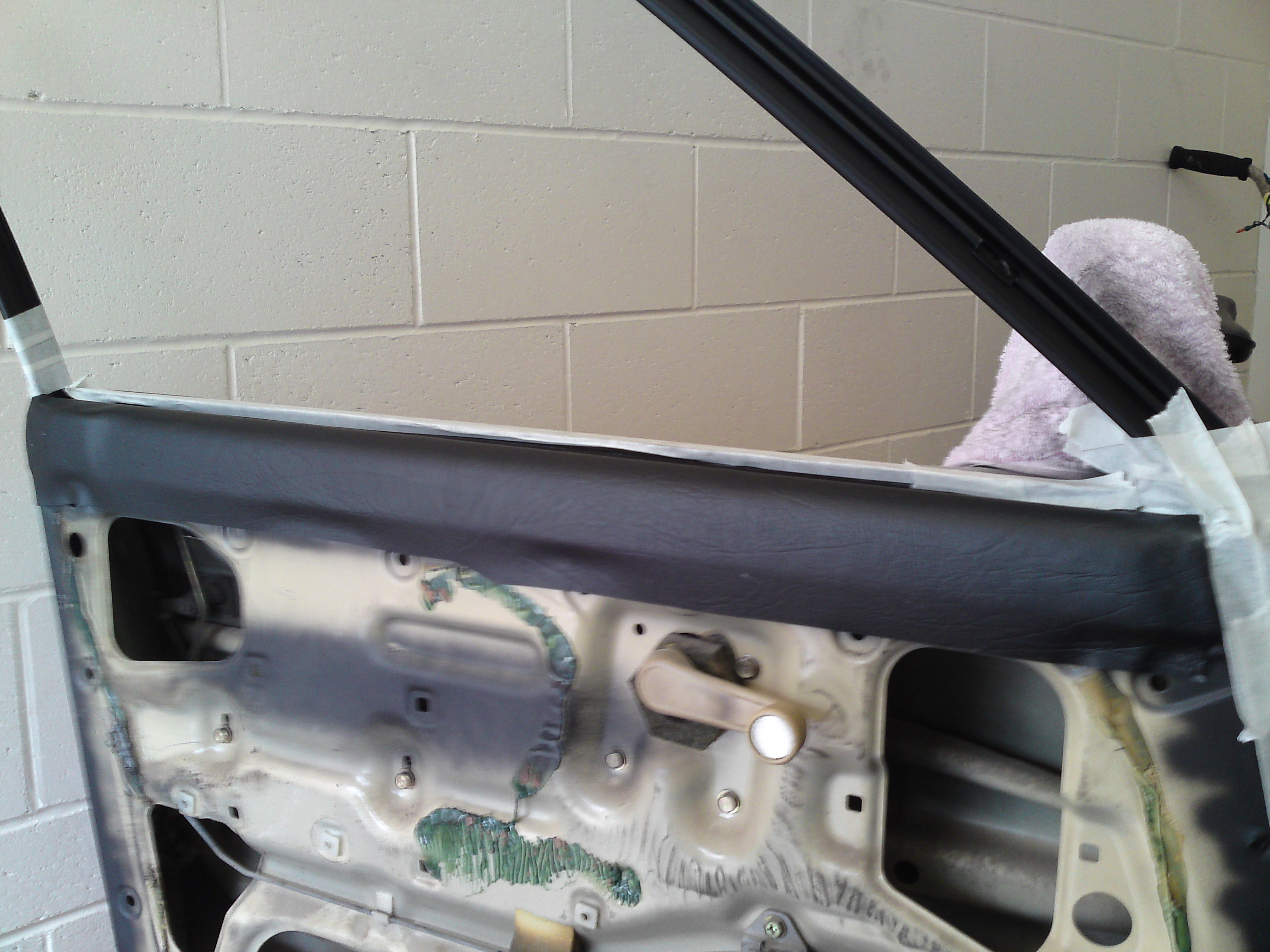

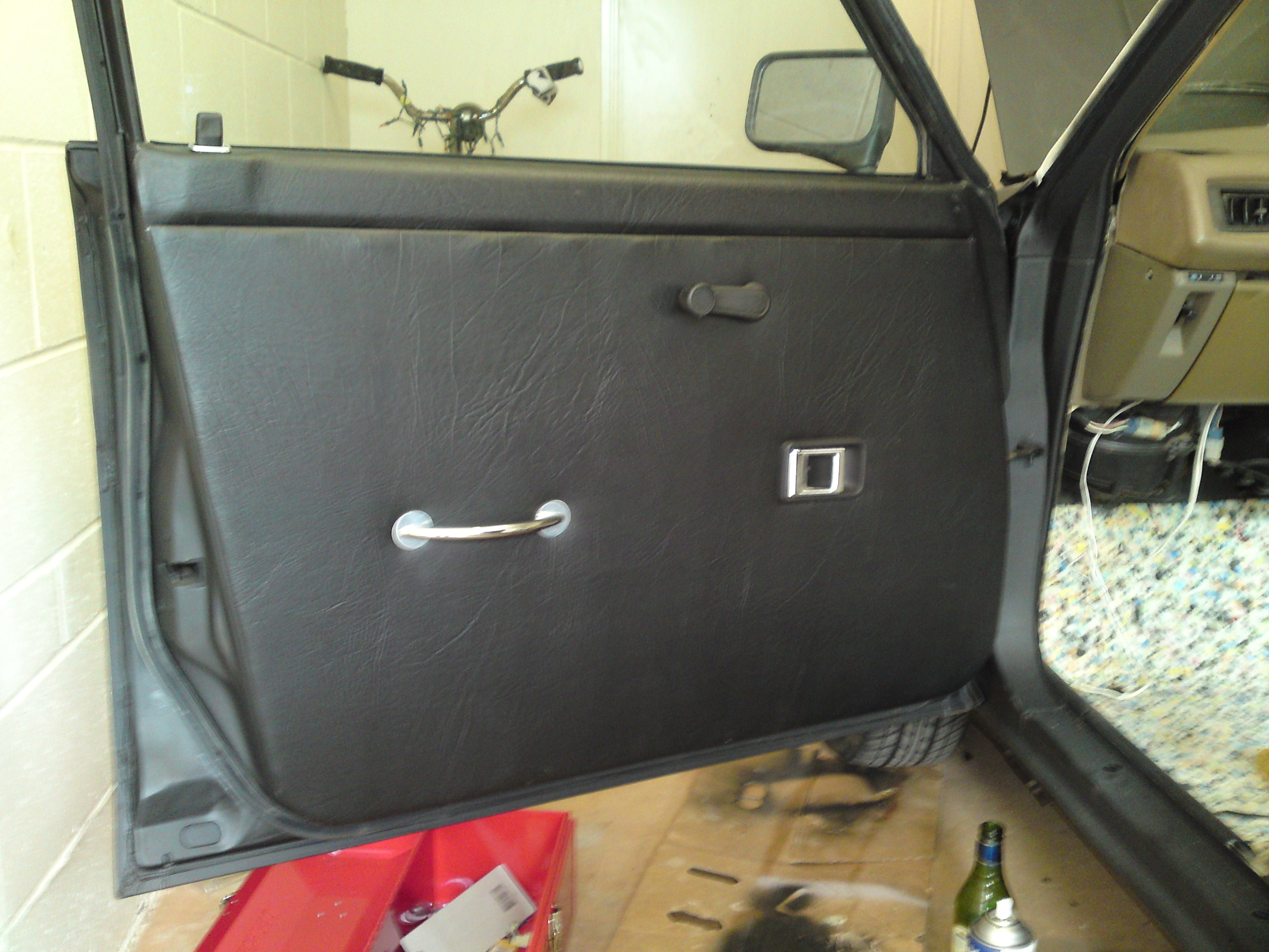

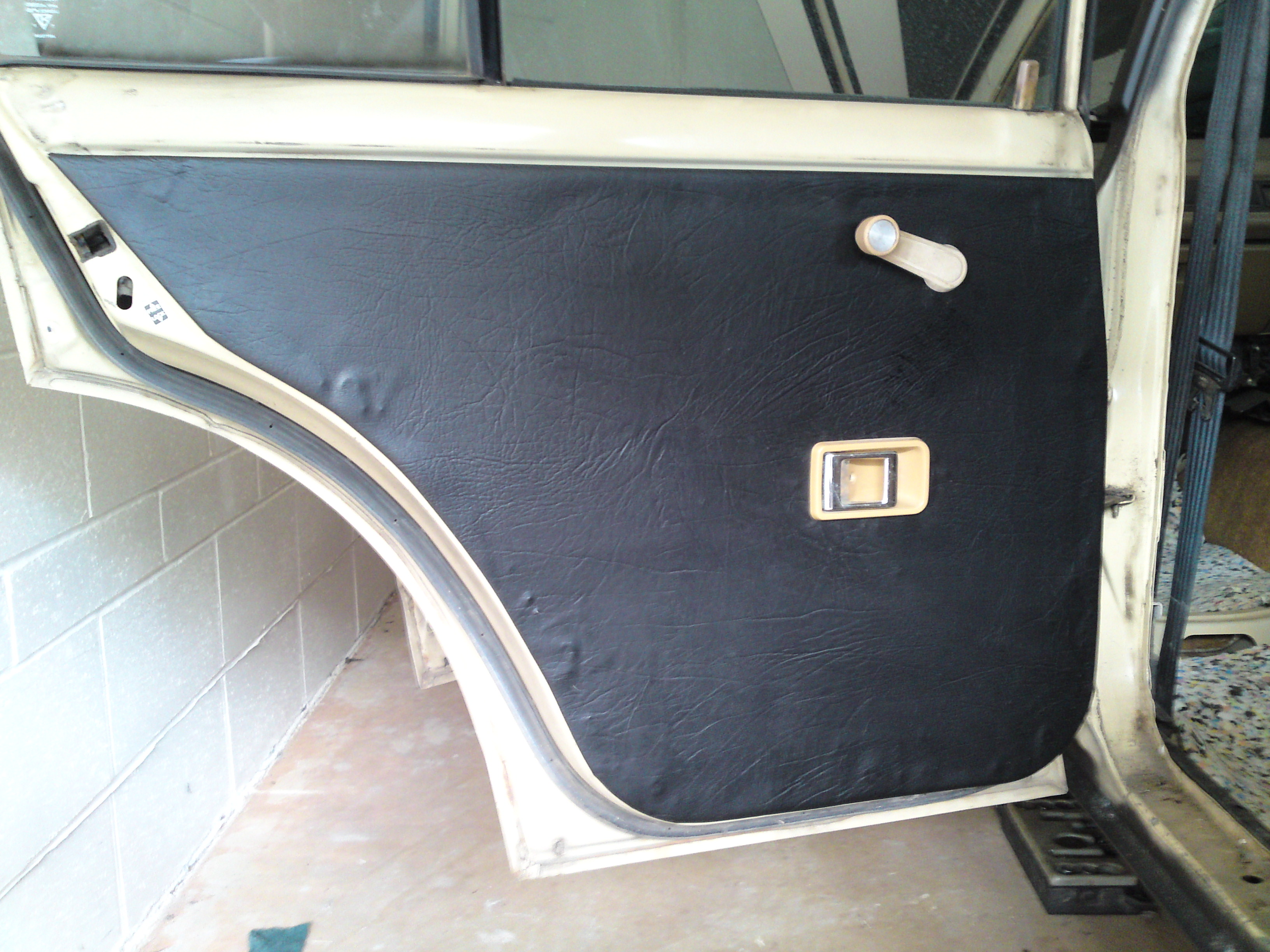

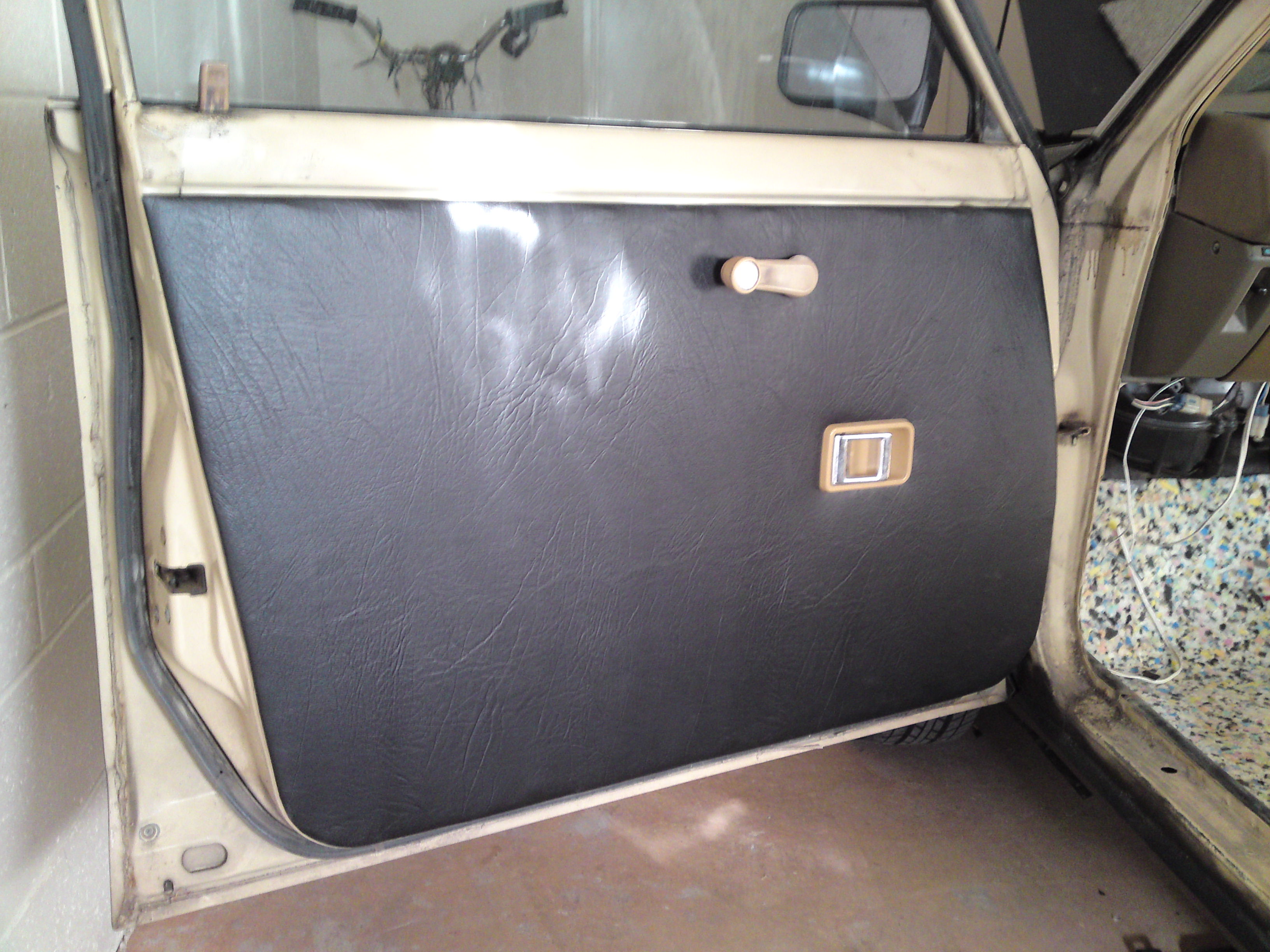

made a few door cards today, first attempt was terrible, 2nd one turned out pretty sweet
first attempt without padding, looked like dogs balls.
second attempt, chrome door handle still to go on. Doors will be painted black too.
i used an old towel for padding, worked sweet, ha ha :) Each door card cost me under $10 to make.

one down 3 to go, gonna have to sort those bumps out tho.

great to see ur getting stuck into it mate, i love the door cards i had the same sort of idea for my car just easyer to buy a decent pair of door cards and fit it for me haha :)
good work.

i considered doing the same thing but can't find them in black. Plus i prefer a nice flat look. Plus a decent set would cost more than 10 bucks a door. Need to find chrome window winders tho, and some nice chrome wing mirrors.

i got my carpet from http://www.knoxautocarpets.com.au/
tho i didnt get it through the website i found it on ebay. It cost 150 including postage I think, maybe less. For that price only budget weave (but who wants shag pile?) and only 3 colour choices, black, dark grey and a lighter grey. And had no holes cut out so keep your old carpet as a template. And yeah I'm looking for dashmat too. Think these dudes do them too. Or repco.
And dude honestly a sheet of 3mm MDF 2.4m x 1.2m $7.20, 3m of vinly from spotlight $44.85, contact adhesive $10, and then all ya need is a jigsaw, drill, staple gun and a few hours, (plus an old door card as a template and a few old towels!!!). Maybe I should make a thread how to do it...
