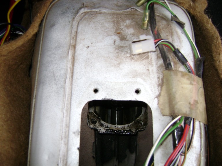

Hey everyone,
Now ive had a look but can't find a straight answer.. I have a 76 Ke30 sedan.. and i got a ke38 4 speed gearbox and have got it all in.. now the problem is the shifter hole.. sits further forward then my shifter hole in the 30 originally auto.. is the only way i can get around this is to cut the floor or what..?
I think it is but i want to check and also do i just pop rivit some steel over the old shifter hole?
Cheers Josh
2 options:
1, Do what you've suggested and cut the tunnel. Yes pop rivet or screw some steel plate over the other hole.
2, get a KE70 K40 or K50 as they have the shifter further back in the right spot.
Angle grinder or jigsaw with a metal blade for the win, and then use some ally sheet to cover up the hole.
Make sure you cover the gear stick hole first so no swarf gets in there.
Butchers, all of you.
Cut the opening, complete with the nuts out, cut a rectangle of steel out from forward of the shifter hole, swap the two around and reweld the lot in.
riveting bits in.... pffft. Butchers.
Butcher yes.. cos I can't weld :)
Yep, KE70 gearboxes line up nicely with the hole for the auto in a ke3x/5x.
Mine was orig auto, then floor cut for ke30 4spd then I put in a KE70 5spd. I just sikaflexed a steel plate over the hole. No heat, no swarf :lol:
