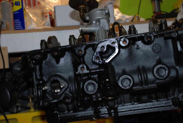

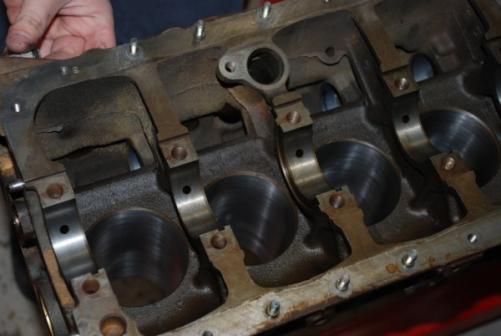

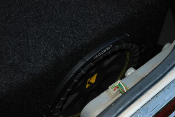

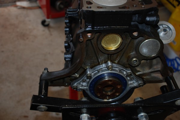

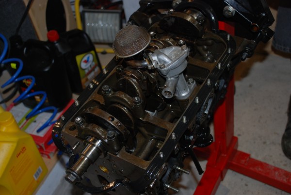

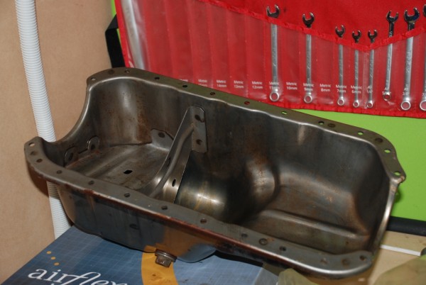

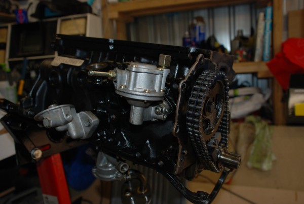

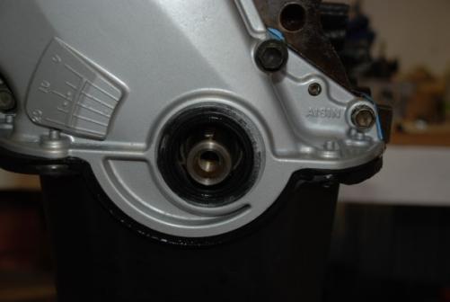

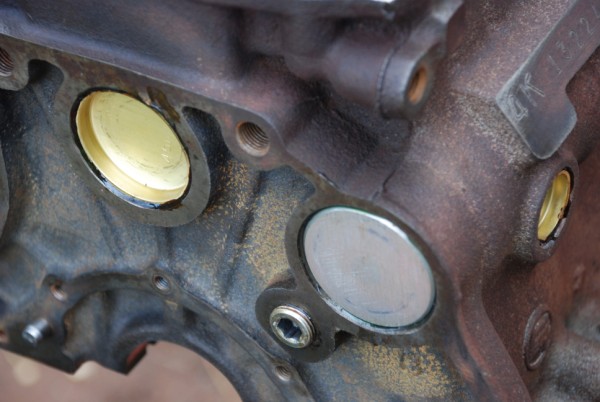

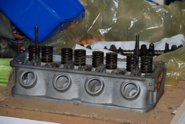

  7. big ass fire ball came out the exhaust.. timing way out lol

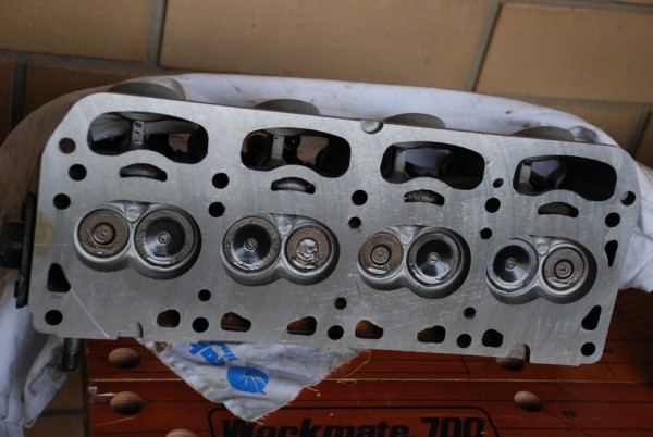

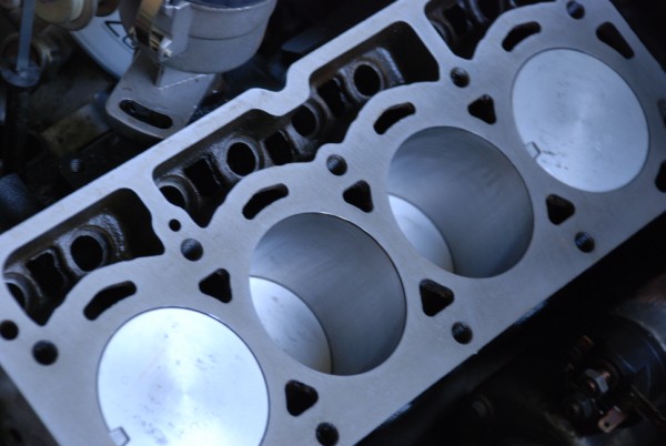

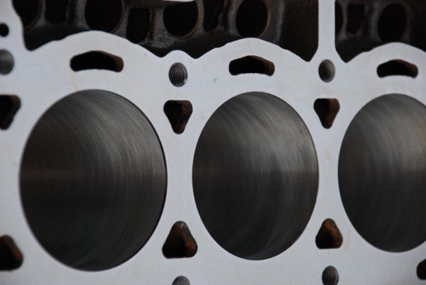

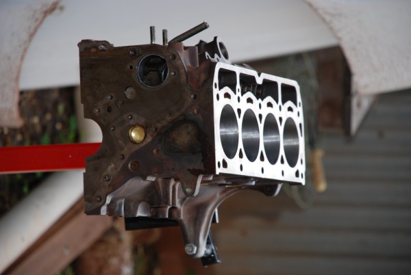

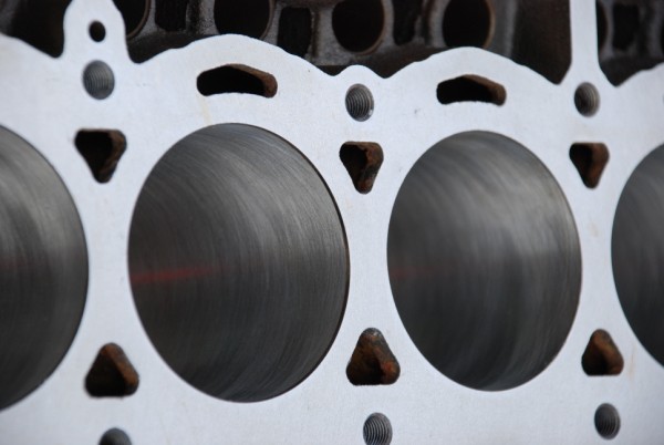

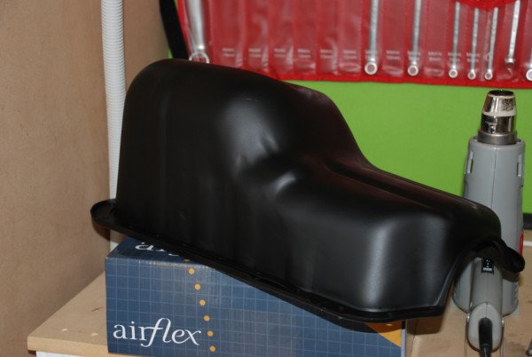

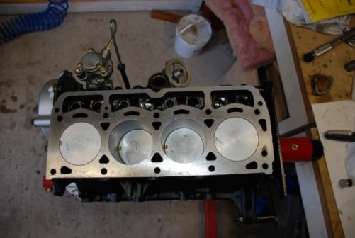

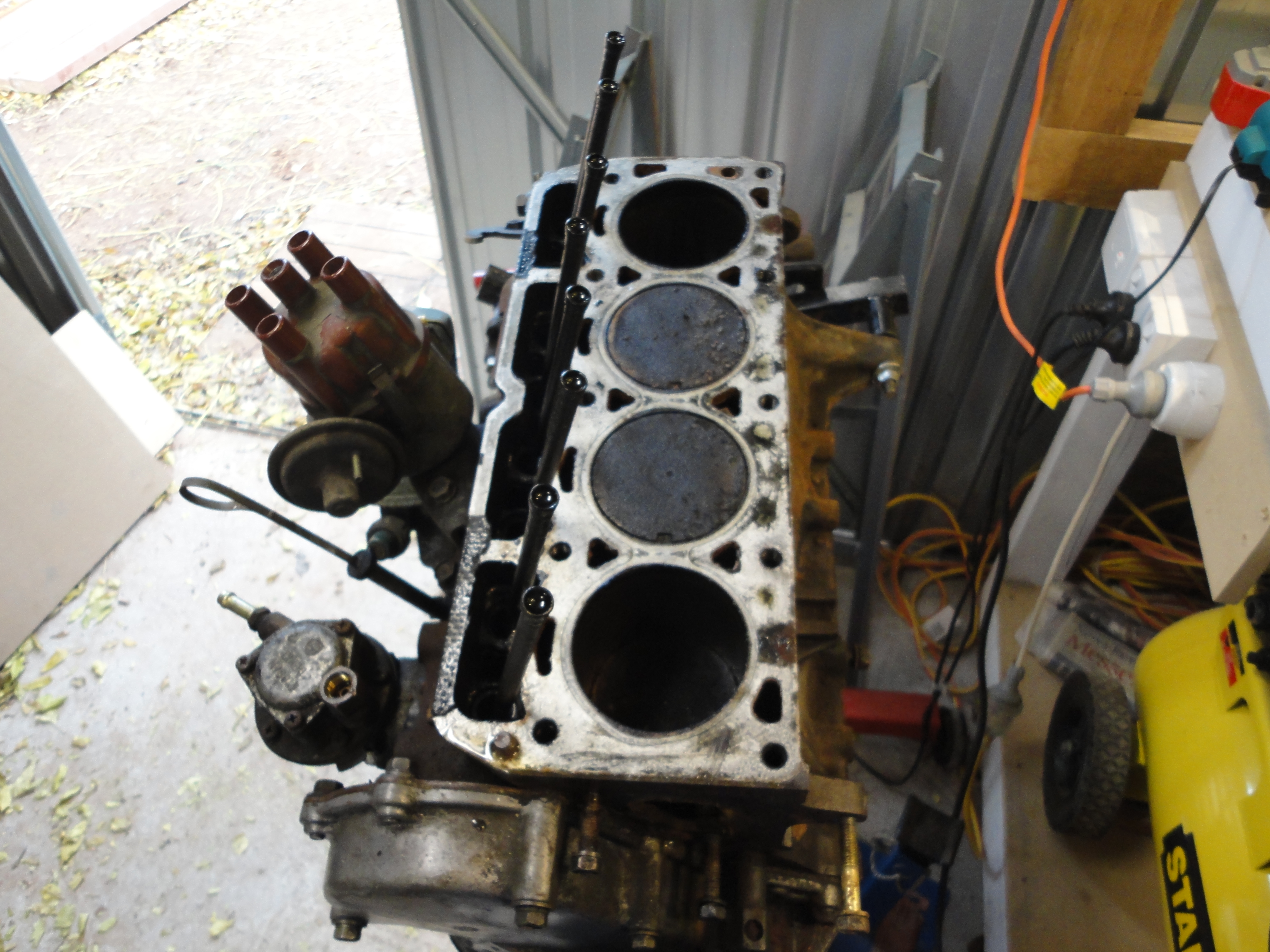

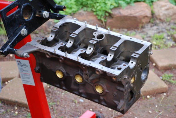

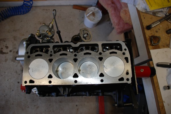

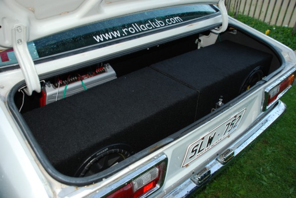

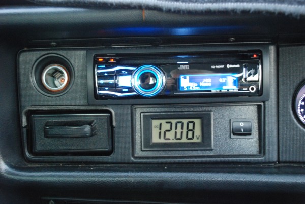

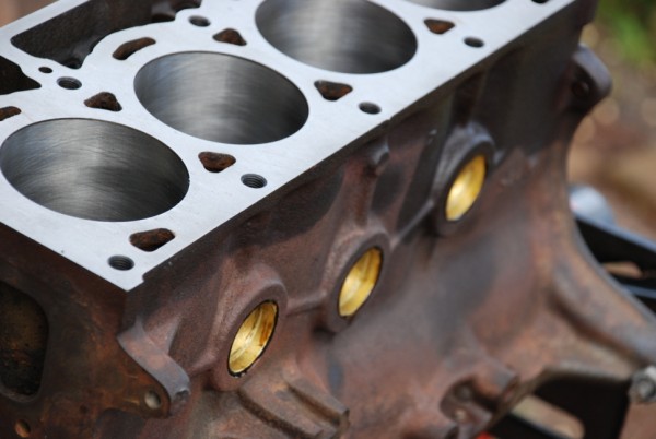

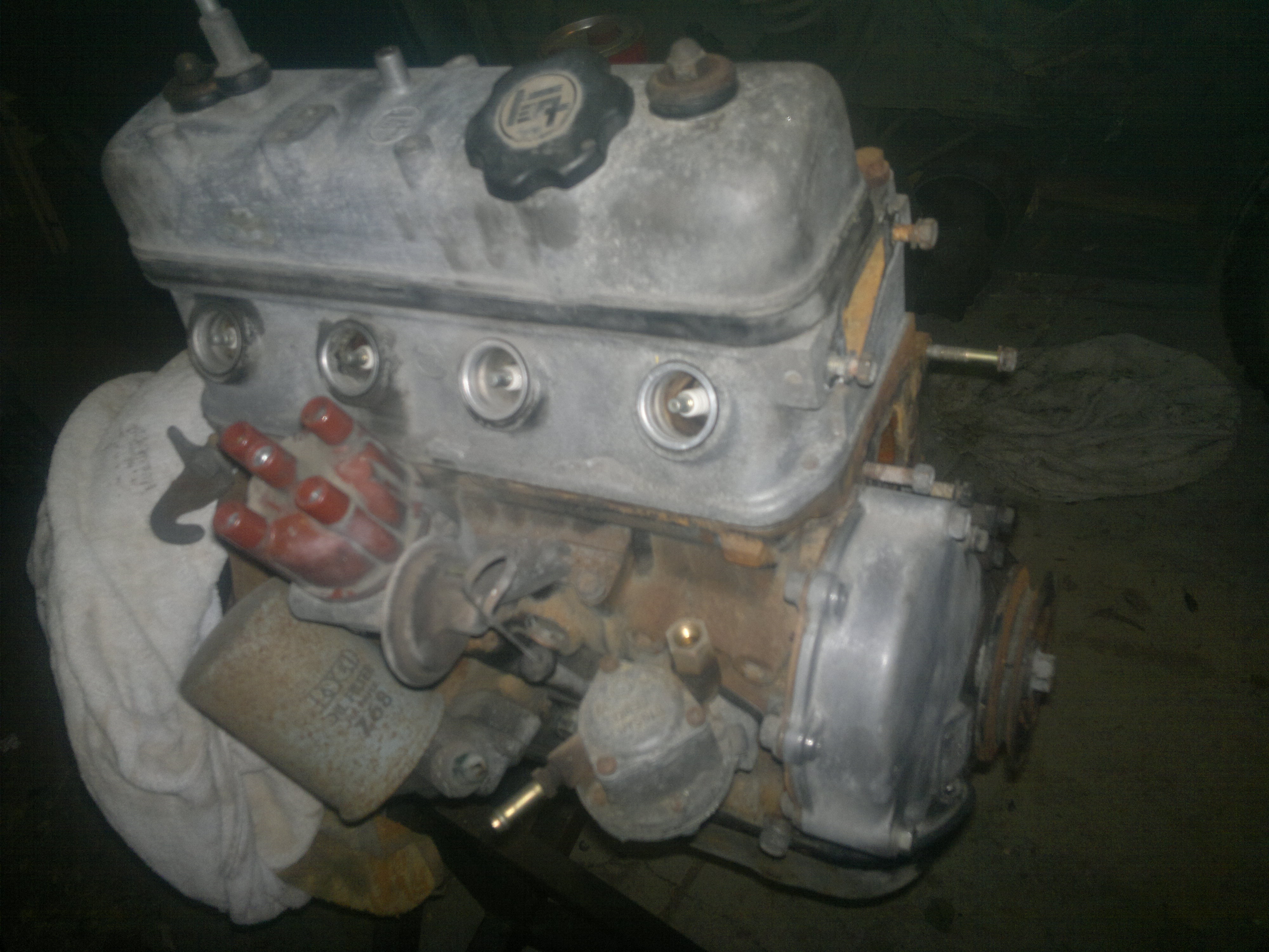

  8. Recently been spending lots of time and money on this car since last update new masercylinder and rear brake shoes and rear cylinders the stock carb was jetted and tuned by the guys at Adelaide carb service :y: top job have replaced inner and outer tie rods pitman arm idler arm put a 620cca battery in her with a HEC716 bosch coil to drive the elec dizzy 2x 10" subbies in custom box 6x9 on parcel shelf 6.5's in doors jvc headunit and a 4 channel 600watt amp to power this badboy also just rebuilt my 4k specs as followed head work-full rebuild new valves, guides, shaved block was dipped, honed, faced. It now reps 0.30" oversize pistons with ACL rings all parts were pulled down, measured, sand blasted and put back together with all new parts cam regrind, crank regrind, rebuilt oil pump, double row timing chains, re fabed welsh plugs, new clutch,machined flywheel, new bearings throughout the entire engine thermostat was also replaced with an aftermarket radiator. still running the 4 speed for now but soon to be 5. will post some pics over the next few days of the engine build and the car as it stands now :cool: atm drivin her everyday and lovin it cheers Josh

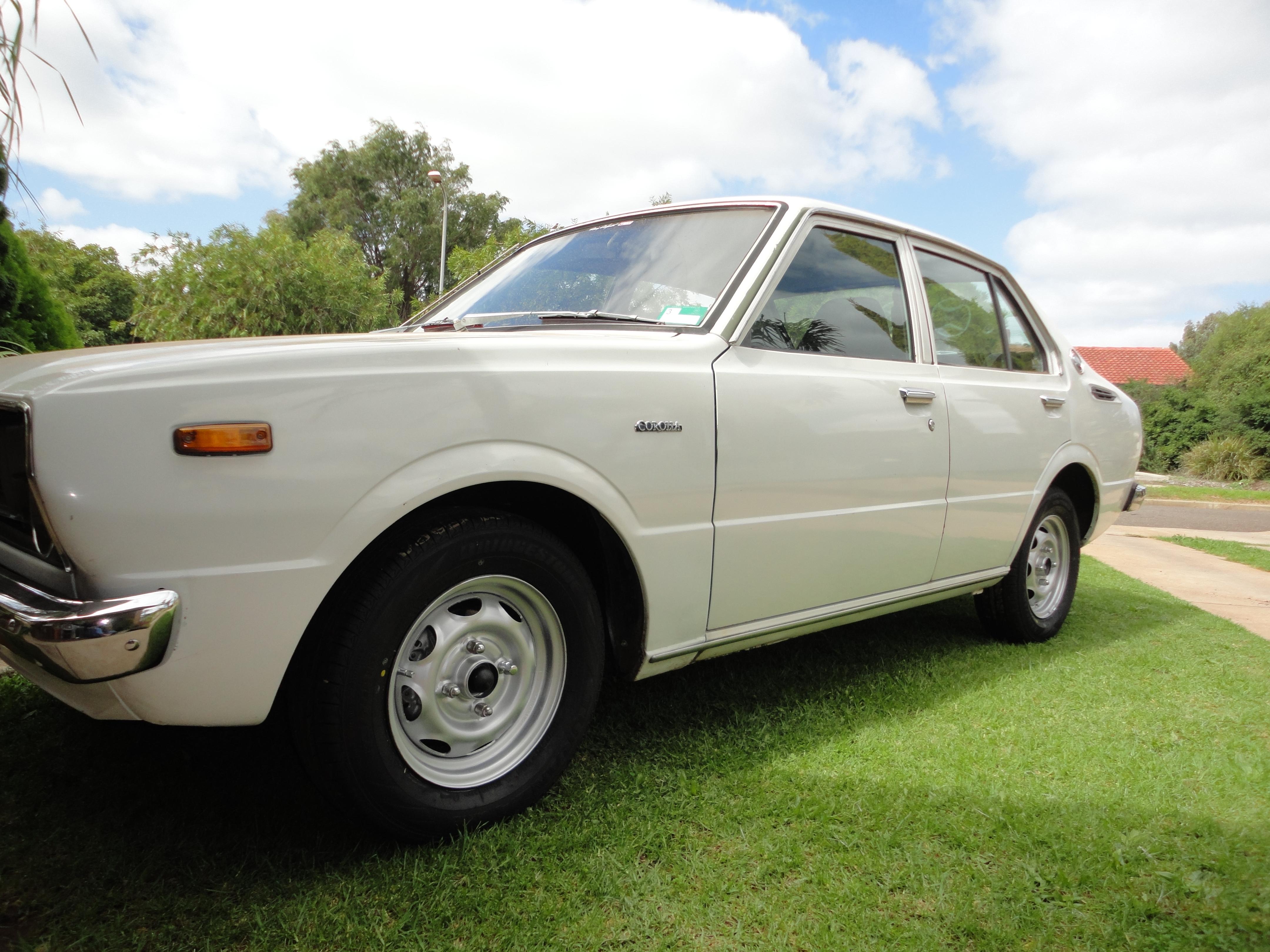

  11. Thanks guys. Yeah Chris its close to been on the road for good. Can't wait :P

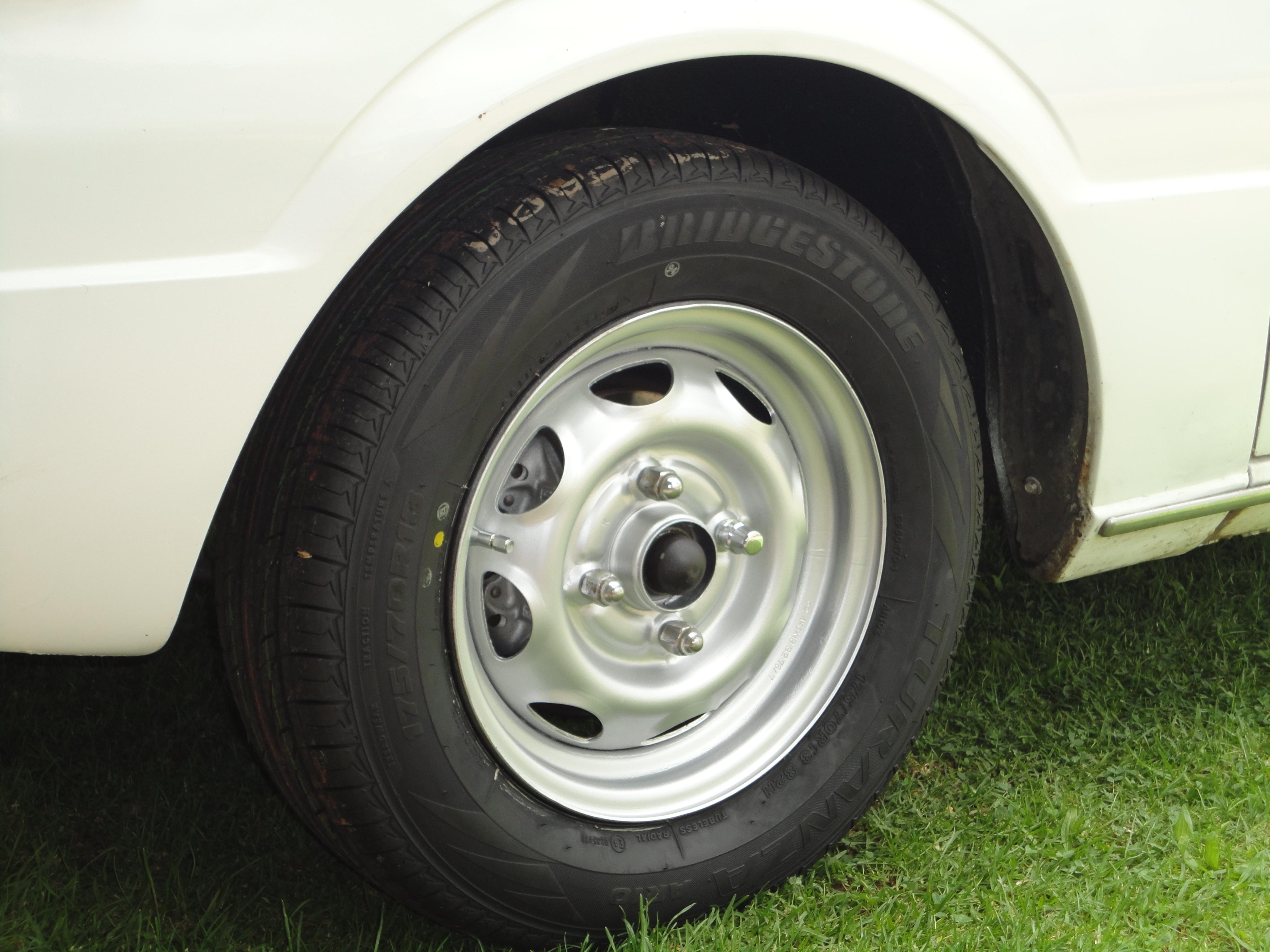

  12. since last update have been very busy, unfortunately not alot of it was with rolla but I have done a bit. I put Monroe GT gas shocks in the rear so gas shocks front and back big improvement. I put in an electric dizzy from kemotorsport also i 3/4 exhaust from extractors back, extractors have been flanged with a tri-chamber muffler and a 2" crome dumpy tip. sounds sexy ^_^ I got bridge-stone turanza AR10's yesterday so good so far rear breaks will be my next focus as there isn't much left of them lol cheers
