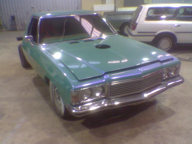

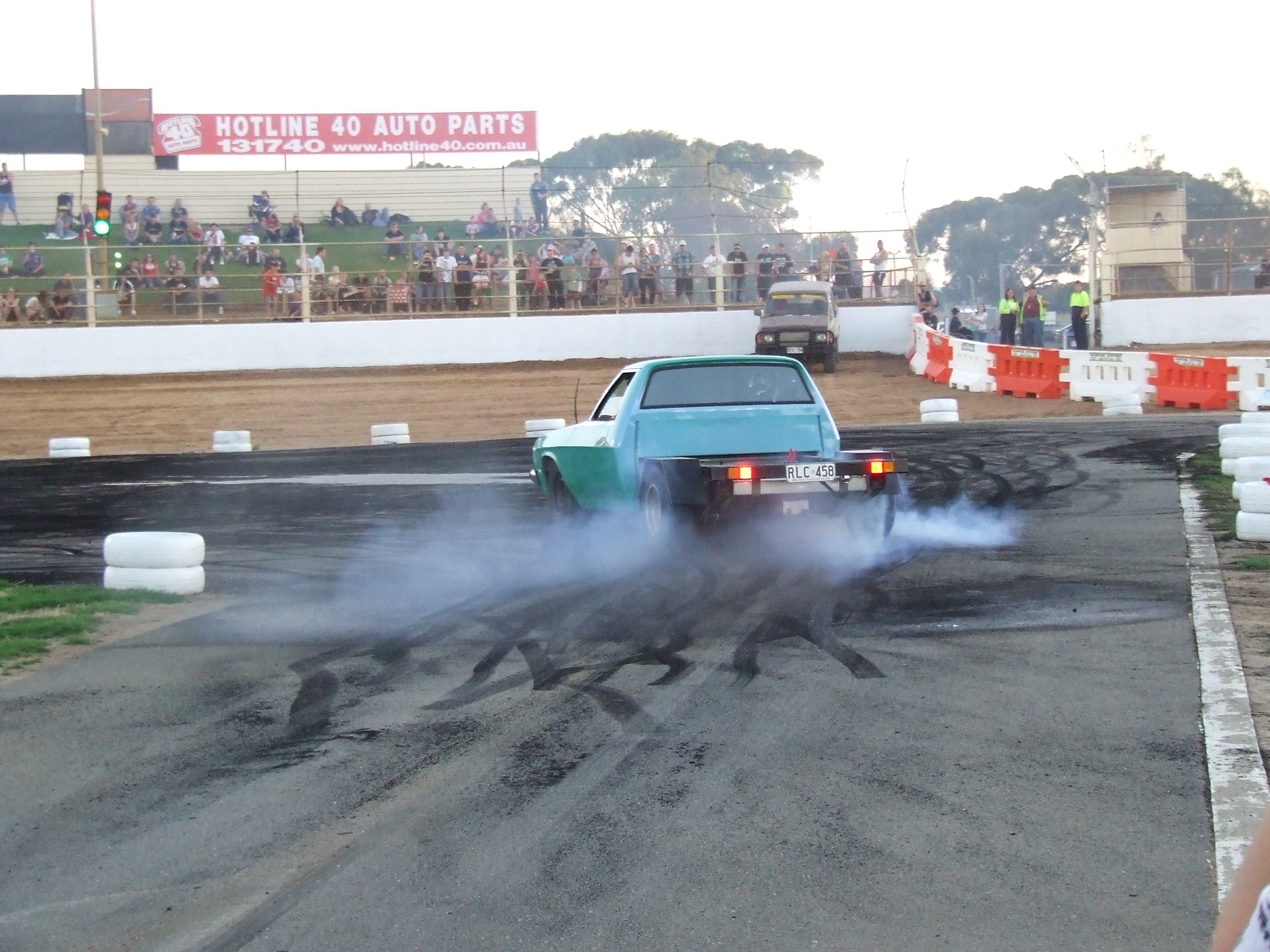

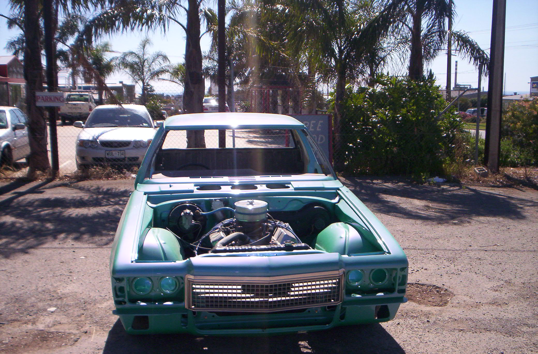

I thought it was about time i put my own car up on here its fun to drive if you can keep it in a straight line :lolcry:

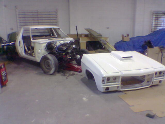

And it all started with a quick cheap paint job lol

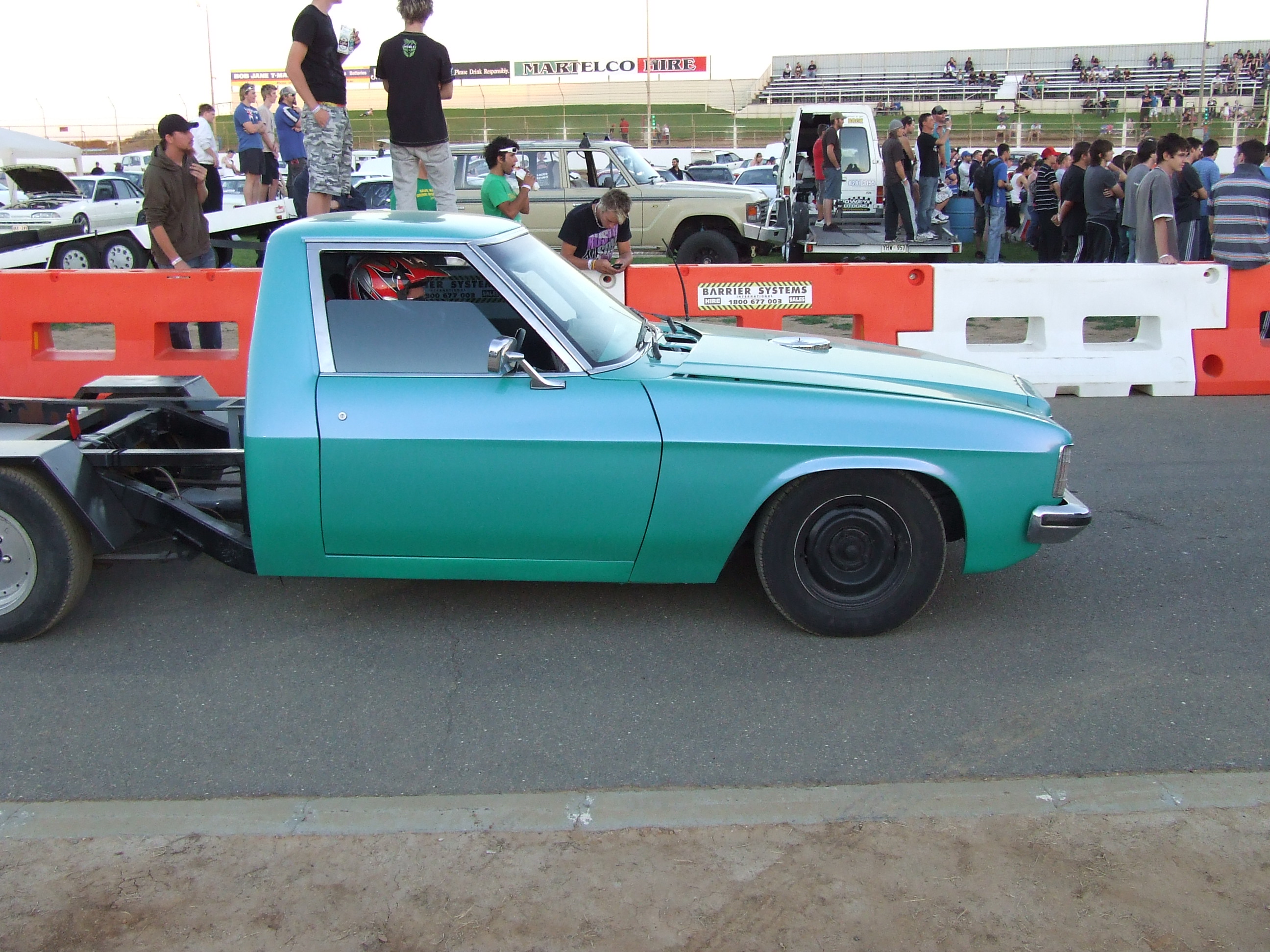

yeah the color is 1 of the first flip paints it go's green/purple/blue $900 a liter and there's 6 liters on the car so much for a cheap paint job lol i plan on putting tray on just haven't built 1 yet too busy building cars for my mates lol oh and its soon to have a big blow through turbo set up on it once i finish the 1jz rolla :lolcry:

yeah looks like it came up good :lolcry:
i was lucky enough to use my mates crash shop and his painter for nothing just had to pay for what ever i used primers,clear etc
where you from ?
if ya gonna build something you gotta use it lol
you wouldn't believe this car started out as a old white wb ute blue 202 3 on the tree that was written off it was hit really hard in the front left payed $500 for it

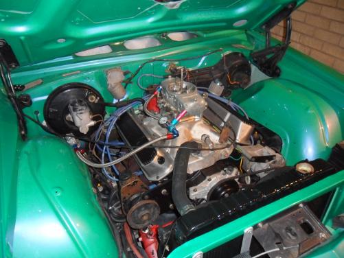

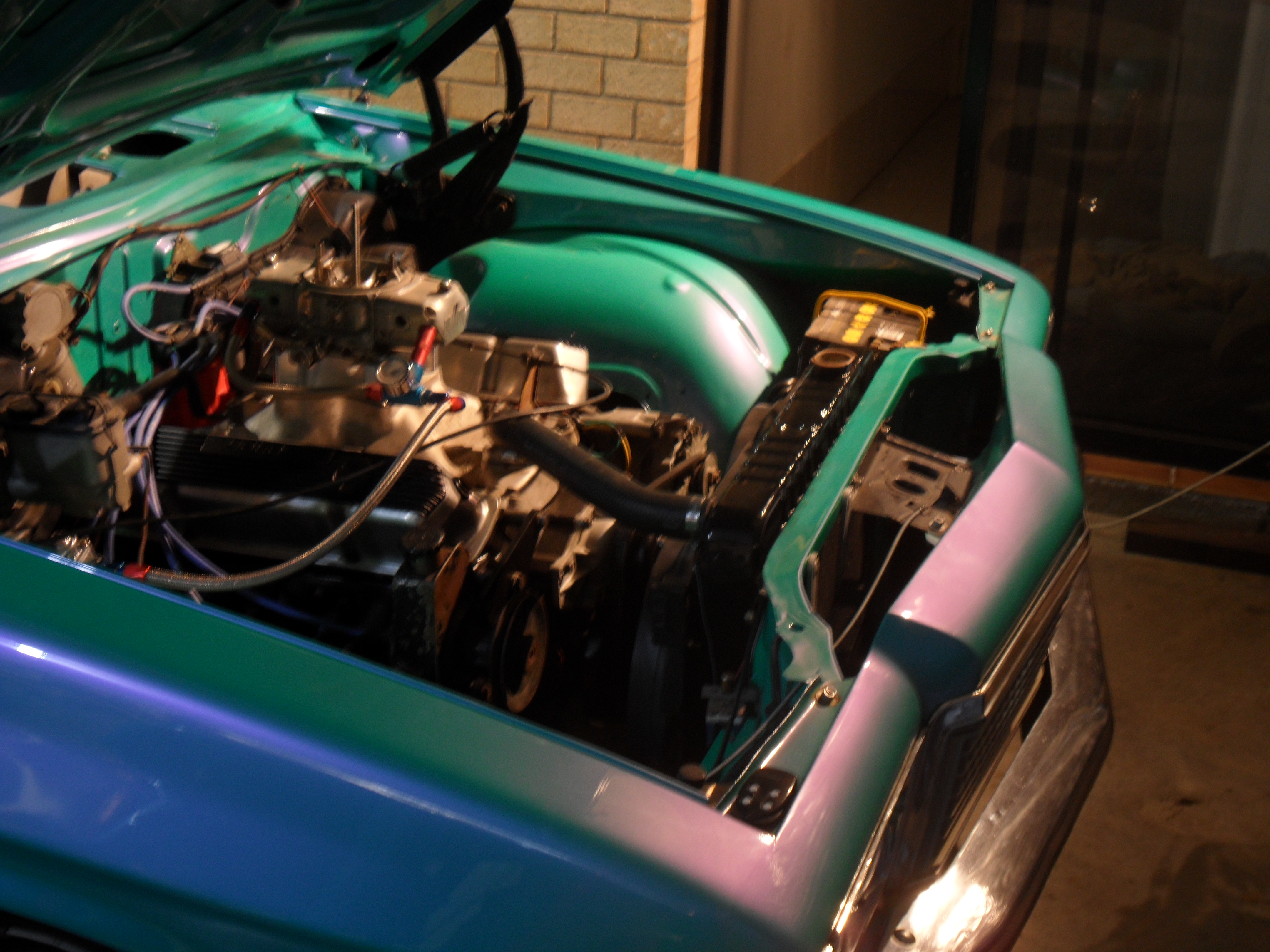

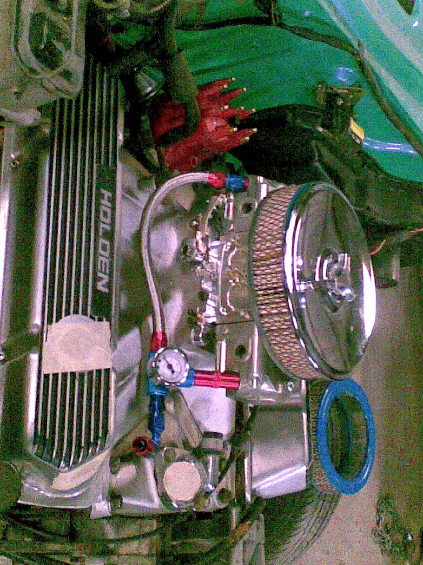

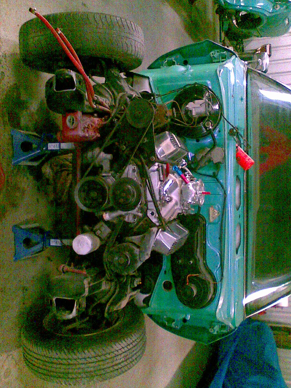

just some spec's on what i have done to it the list go's on and on

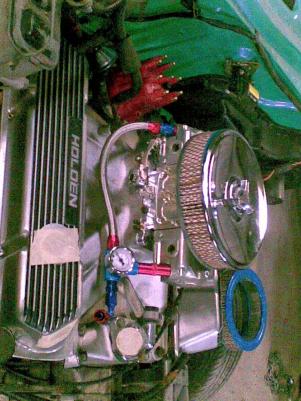

Engine
308 turbo pattern bored 30tho balanced and blueprinted
Brock G cast heads with L34 valves
crane 310 hyd cam
8inch high rise single plane manifold
Barry grant 750dp demon with all the goodies
tricked up t400 stage 2
3000 stall
locked up 4.44
custom made 140L drop tank
3 core triple flow desert cooler radiator with AU Thermos yes i know its a ford part but it work really well doesn't even get hot doing burnouts :jamie:

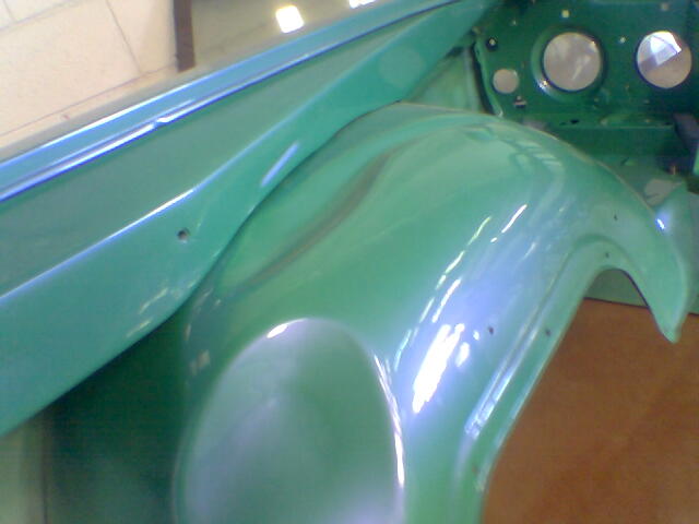

Body
shaved door handles
1 piece front
all body the seems have been taken out of the whole car and not with bog lol

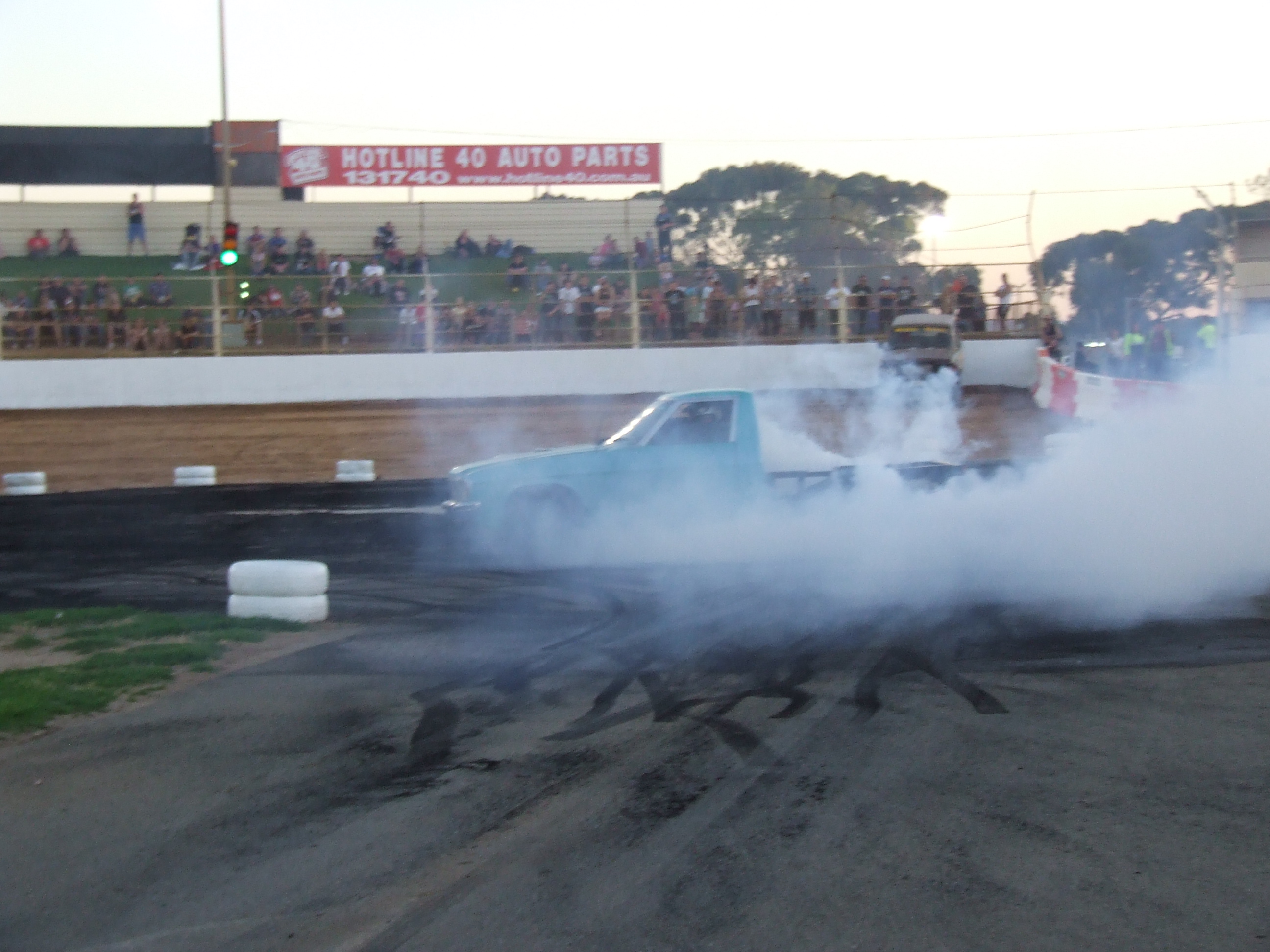

about 6months ago i got pulled over for a R.B.T as you see in the last photo no tray just some shity wheel arches on it two race seats in it no carpet my Gtech tach on the steering column 13in steering wheel on it the air cleaner way out the bonnet and its lumping over like you wouldn't believe 1200 1500 idle and all the cop said that i really should have my tach mounted in the dash i just about pissed my self laughing i was sure i was gonna get defected :jamie:
