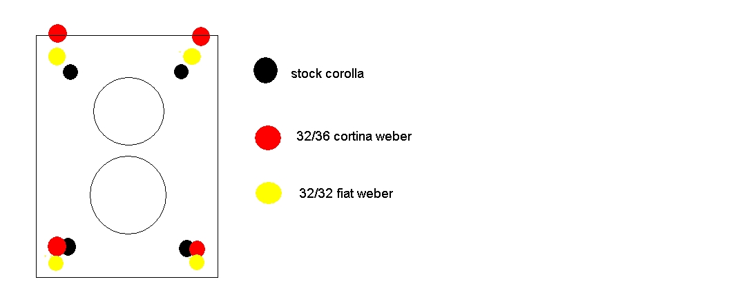

If so you have 2x options to fit it on a K series manifold as they ARE DIFFERENT bolt flanges to a 32/36.
1, Get the 32/36 adapter plate. Bolt it onto the K series mani as per normal. Then after sitting the carby on top of it you'll notice that (motor side) 2x bolts don't line up. They'll be right on the edge of the carby. Cut the holes into open slots and the carb will then fit on. Make sure to use a couple of decent sized washers to hold it down as 1/4 of the bolt will hang over the carby. I have done this on "Dirt" and can take a picture of it for you if you want?
2, Little bit bush mechanic, but still works fine. This was done to the above pictured carb which was later boosted and still loved it. Anyway, sit the carb on top of the manifold (with no adapter plate) and you notice that the stock asian bolt pattern is VERY close to the weber one. You then need to grind out the bolt holes (ideally with a sideways cutting drill bit) on the weber outwards about 10mm each and it'll then actually fit straight on the stock manifold.
Here's a panit picture I did a while ago for somebody else. Shows how close the K and 32/32 (fiat) weber bolts are and also how the 32/36 (cortina etc) bolts will come out right on the edge of the 32/32 carb.

Thanks for the pic and description Taz, but unfortunately my Weber is a tad different to that, but good for future reference!!
