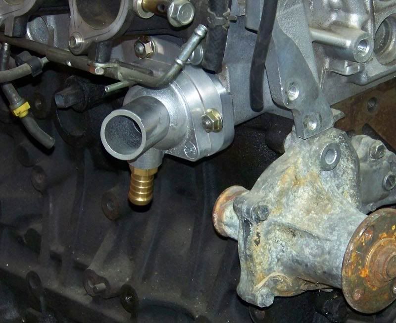

I'm not too fussed on that brass barb outlet on the top pipe either, looks like it'll be a mission to link it neatly to the pump, similar to the setup like Niz's car. I see that pic also has a thermostat housing on the top and the bottom, slightly confusing, because the advantage of a Yager style top outlet is you can leave the bottom half standard.

With the top outlet you mean this?
I just can't see it as a copy of any kind. I am just using an adapter plate to use an existing water outlet pipe (albeit modified) to be a new outlet. The yager is an all in one solution to an a top outlet and thermostat with no bypass pipe, something I don't plan to really do under normal circimstances. This one above is just an outlet, no thermostat and has a bypass line which is designed to be used with an external thermostat. I went this way because it saved me making something from scratch as my fabricated effort really sucked. I also just can't see how I was undignified with that debate over the rear plates, that was more of a misunderstanding than anything anyway. Now that I think about it I want to put a pic of that Yager outlet on my guide as well if it isn't there already, it deserves more credit than it gets.
Heres a pic of that outlet on the head:
as you can see it's very much not intended to be hooked up to 4ac rear pump. I from the start had in mind for people to use an external thermostat as it's the easiest option. I at this stage am not really keen on making another fabricated outlet that does suit these pumps as there isn't much demand for it vs the time needed and personal cost on my end. Oh yeah and the whole not enough time to scratch myself thing, hence why I had to wait till a Sunday to answer this post. It's one of the many things that in the future I will consider.
On Niz's car it should of been a simple 90 degree bend in the hose, probably using the hose off a VN. Either way that outlet is not as good as it should be and just for the record he is getting something new or his money back.
