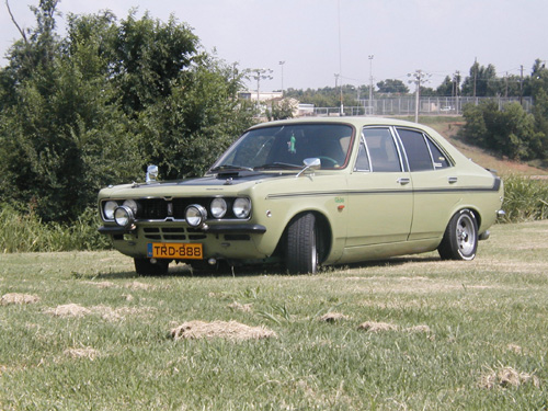

this is my beloved cricket of whom i have owned since i was 5!!
it took me at least 5 years to restore her back before the days of ebay

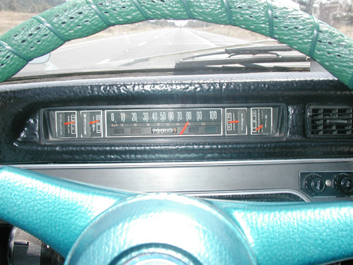

ok pulled all the dash out....why?
'cause the original Cricket heater was toast, none of the doors worked and then it started leaking, not to mention all the leaves that jammed up the fan......
