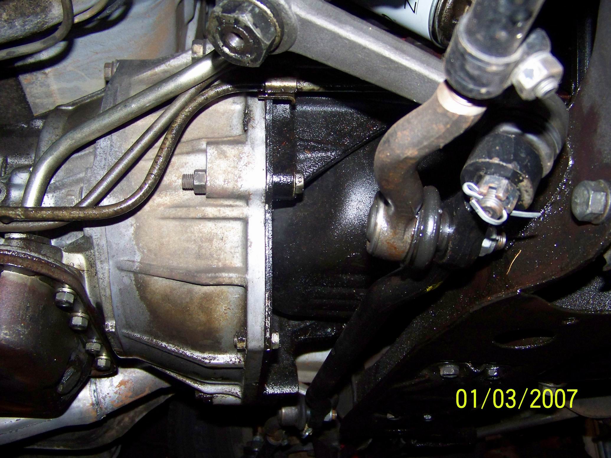

How do you mean by "offset" ? I'm guessing you'll be meaning the kink in the rod.
I'd say the picture in the manual was just done to keep it simple.
This is a '55 rod in my '30. Its the same as the '30's rod.
I'd say you've mixed things up and replaced the rod the wrong way round. The kink or offset goes towards the gearbox.
Or do you mean the drag-link between the steering box arm and the pitman arm :happy:

haha i mean the rod that connects the steering box and the idler arm together and has the tie rods coming off it ,
pretty sure i havnt put in on the wrong way as its the same as my other 55 and realy will only fitt one way ,
could be right about the manual trying to keep it basic, i was hoping i could find a straight one tho would help
alot with clearance issues, maybe ill have to try some other toyotas ???????
