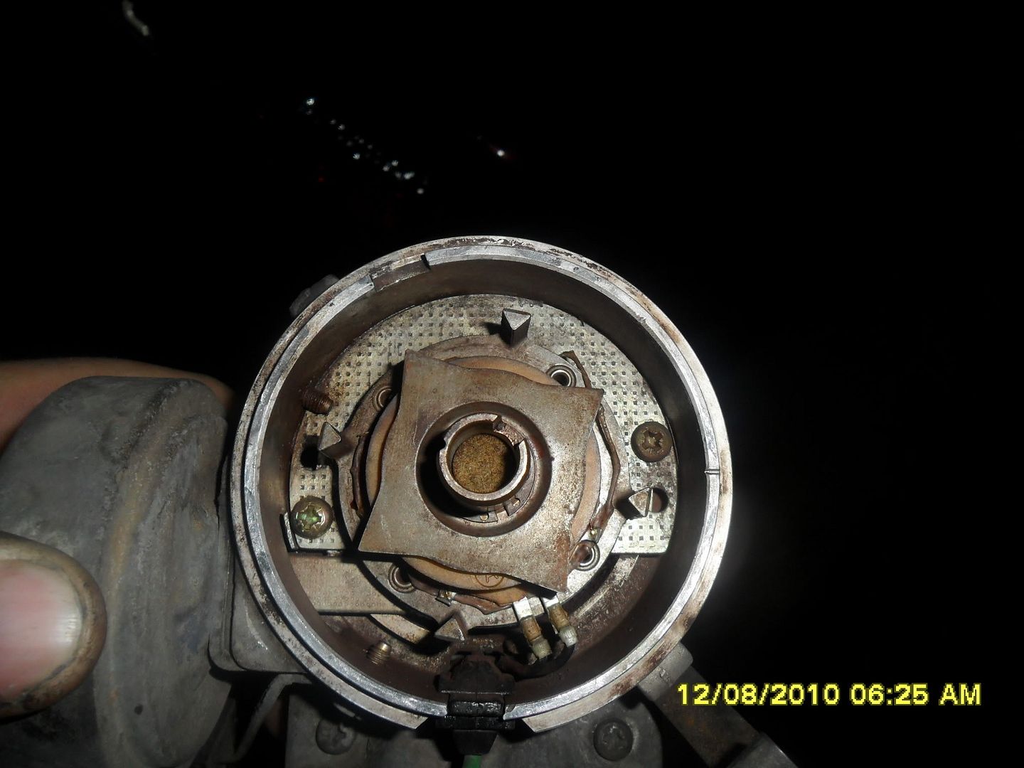

my car would be sh!t when it was cold and when u put your foot down it would just die and splutter? tryed everything was about to buy a new carby and turns out it was just the points in my dizzy,10 bucks and its fixed,don't know if it would be the same for yous,but anyway good luck!
82 is electronic.
thanks to trev giving me some crucial parts i found it was the dizzy, loose wire had been touching and most probably causing my miss/stammer around 3000rpm
