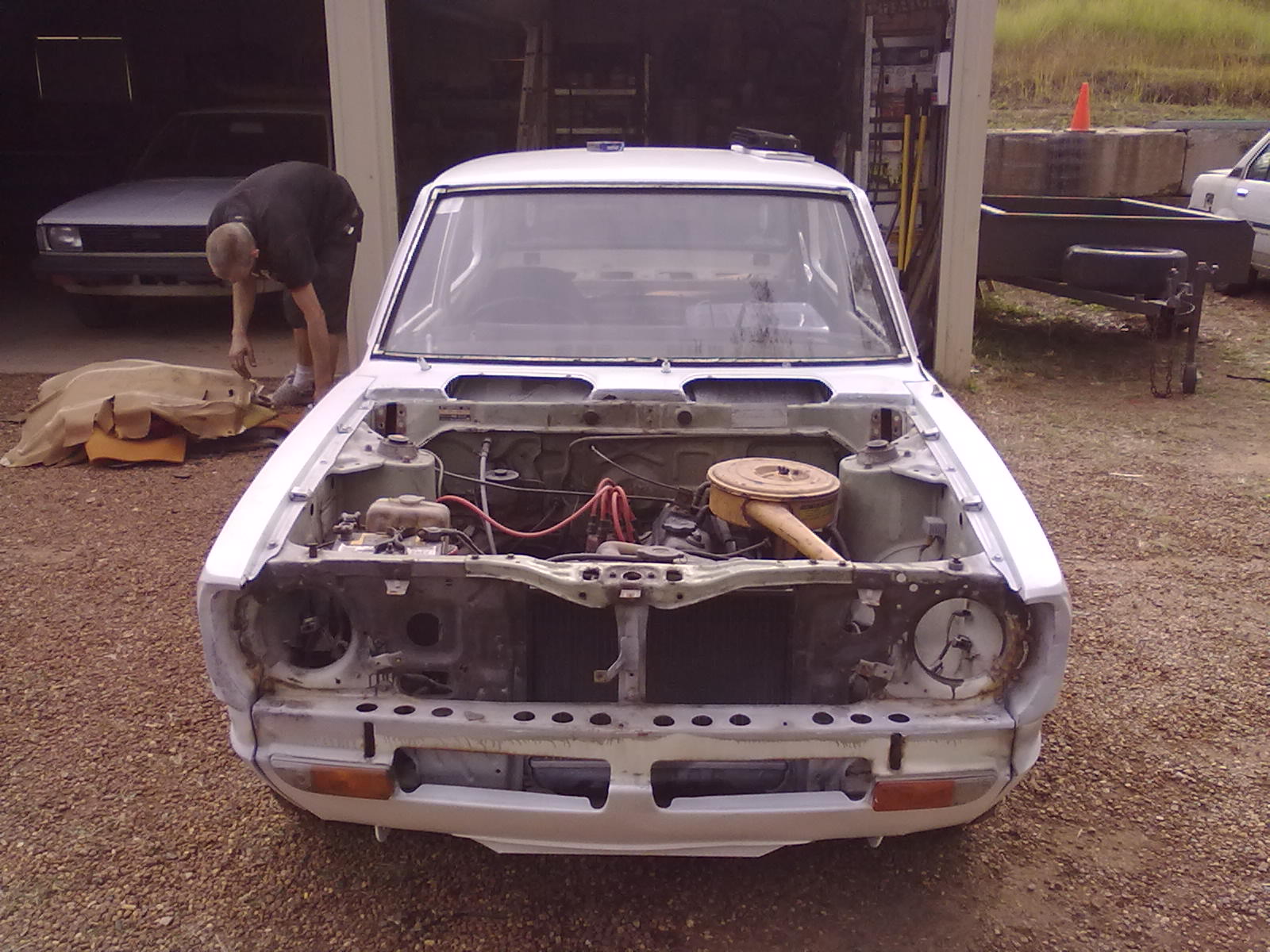

I didn't go to work today. My back is killing me from lifting doors and timber. Plus some indiviuals are being right c*#ts to me so they get f*#ked and tomorrows my birthday, not that i'll be able to touch the car till Sunday.... :D
Stripped the interior. Apart from the dash, drivers seat and steering column.
Removed:
-the OMG handle from the rear window, cabin vent, roof lining, parcel shelf(which was a piece of cardboard over the horribly corroded original.
-quarter windows, door windows, all seals, door trims, internal door handles and locks
-rear bumber, tail lights, tail light finishers, boot, lining, spare and boot wall.
-front bumper, grill & finisher, headlights and finishers and fender indicators.
-wipers, mirrors and trims
-plus shitloads more.
:fuzz: :)
Still need to do windscreens, front and rear. front indicators under the pumper,engine, gearbox, wiring lume, and everything under the hood.
Tagged and bagged everything. when i'm done it'll be a rolling shell.
Found some ugly things today though. :argh: Most of the lower sill up to the rear wheel arch has been cut and shut. Both sides. Same with behind the rear wheel arch to the boot. Shudder to think what they've done with the weather channels. Also the rear valence panel is rusted to the date hole and it appears its been arse ended because the join between rear quarter and valence is cracked.
Few positives though. The whole thing is original down to the rear speakers and wiring. Still in pretty good nick. I bet they still work. >SALE< pa ching!
Forgot my digital camera so i'll get some photos on the weekend. Thanks, Kez for all your help and get a job you slacker. :poke:

Got an SD card for the phone so here's some pics of todays effort.
