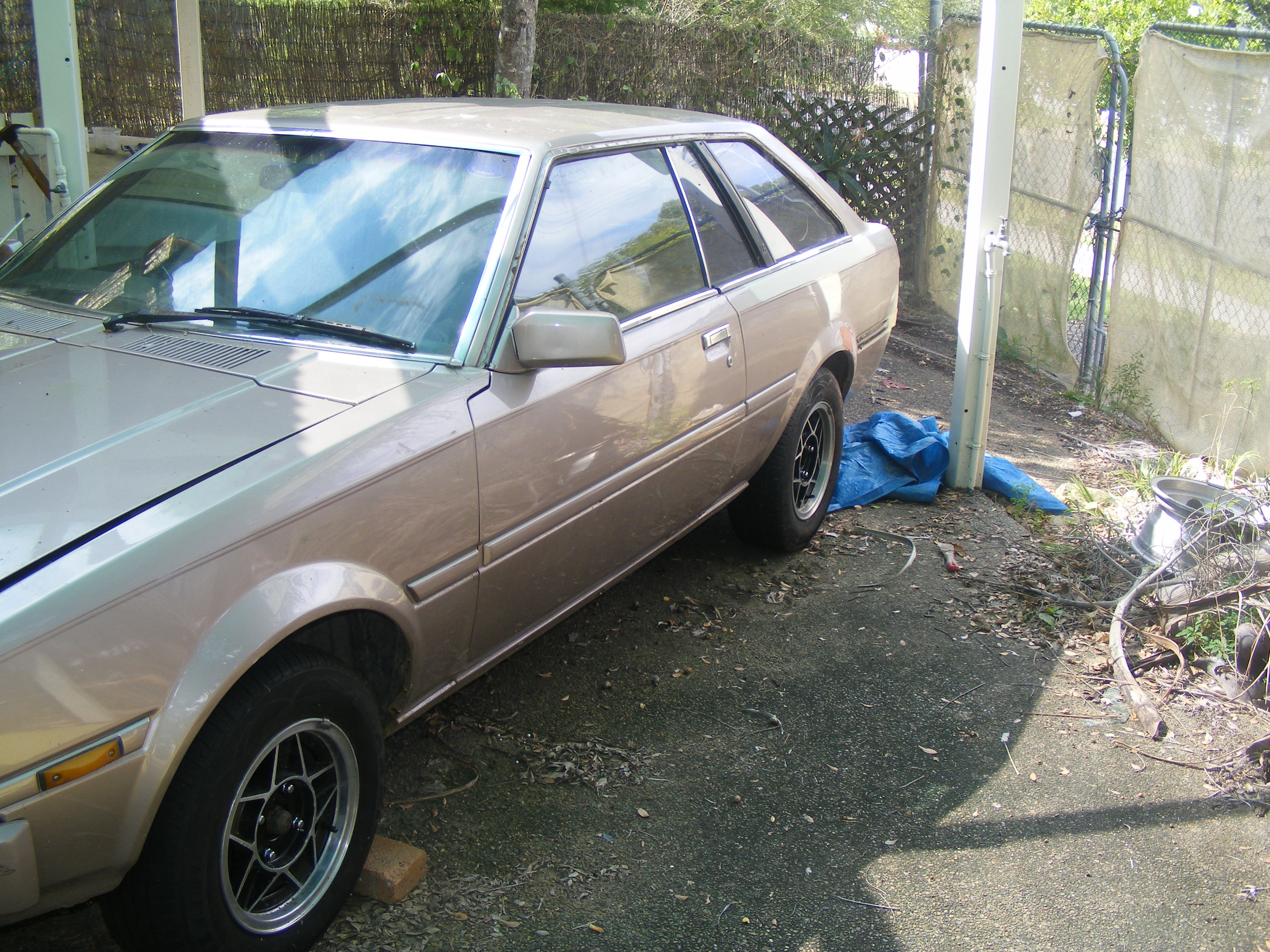

Also got a picture of your car?

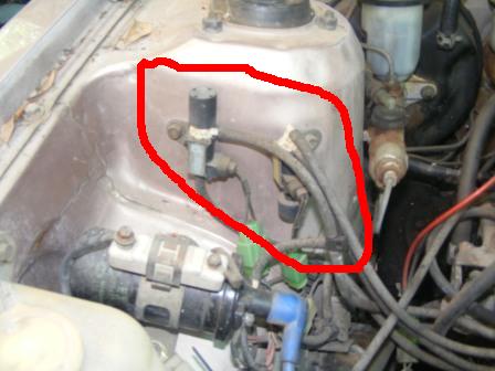

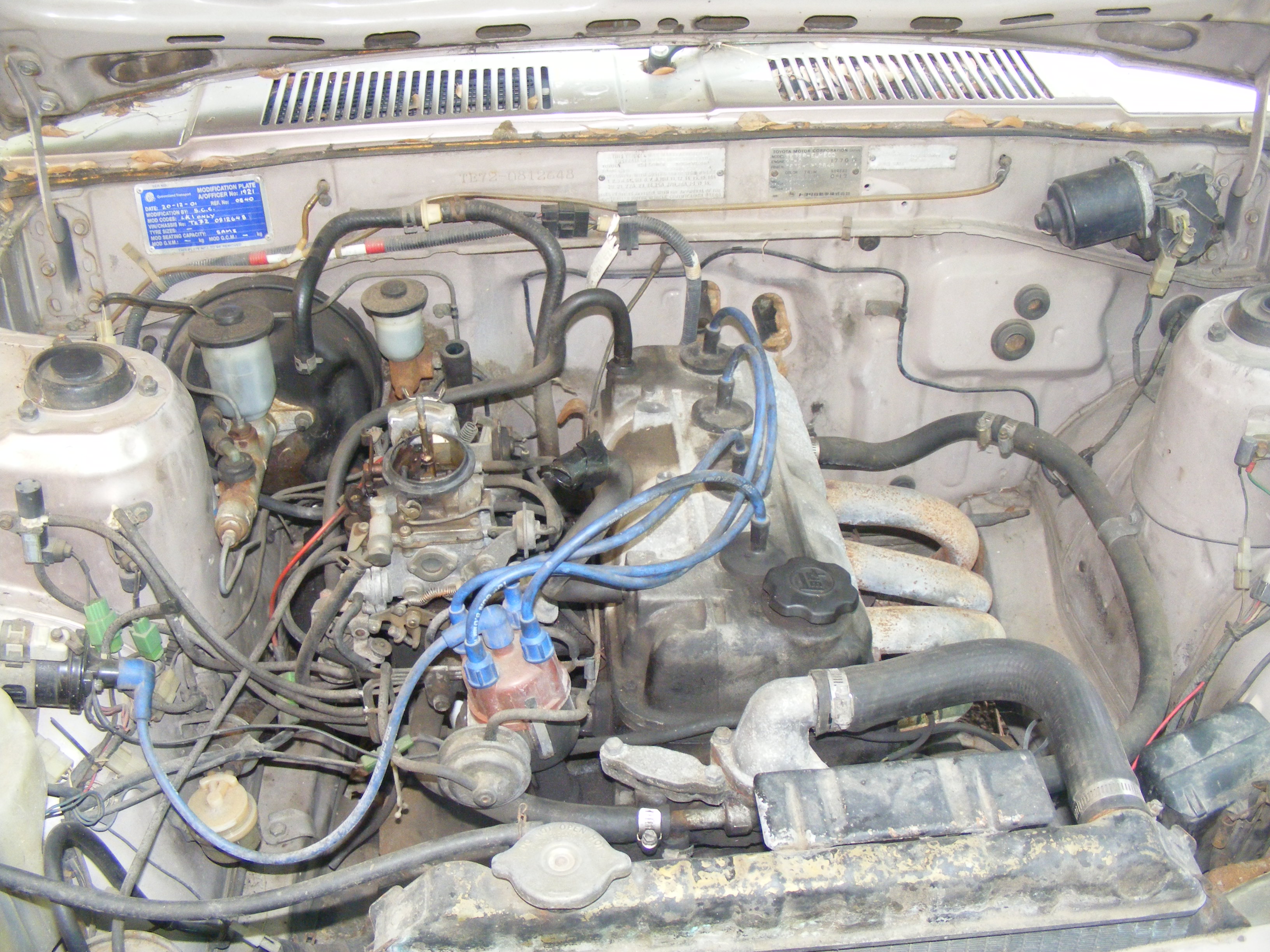

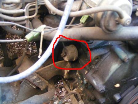

Heres the pictures you asked for... again, not very pretty the rear end has needed some personal attention as well :D lol and can someone tell me what all the things marks with red circles are, i have no f@$king idea. ;)
the thing in the 2nd picture, attached to your block, is your oil pressure sender. (either a guage or light in your dash, prolly just a light)
the other thing, I'm not sure, i had one on my old 4k, and unplugged it...and nothing changed.....its connected to the carby yeah?

if its a 5 speed, it has a switch on the box and opens one of those valves witch makes the engine run lean when cruising in 5th

that makes sense i guess... can i get rid of it all? and yeh it is all connected to the carby/manifold

mines plumbed under the battery so i could pass the roady LOL! i havent noticed a difference

can i just rip it out after i get the roady? or is it pointless removing it? also there is a red wire and black wire going to the carby, what are they for? i know i must soud like a dick right now but i honestly know f@$k all about carbys, just the basics of how they work.

the wire in your carby will prolly be the fuel solenoid, my understanding is that its an electric valve that stops fuel flow when car is turned off (controlled by ingnition). only some carbys have it, not all.
to be honest your engine bay is pretty good atm, i suggest giving it a huge clean (Degreaser, or steam cleaner) and then go from there. there is no real reason to start pulling stuff off for the sake of pulling stuff off. it could potentially create more dramas if you ever have to put it all back on again.
one thing you could do though, get your RWC as it is. then get a webber carburetta and a pair of extractors, then you can throw ALL those pipes and crap in the bin, as the webber needs hardly any pipes etc at all. and with the extractors any sort of exhuast gas circulation can be binned as well. edit: just noticed you have extractors alreay, so your half way there, just get a cheap webber and your set.
will make for a nice simple engine bay. and with the extractors/carby it will have a few extra horsepowers as well.

Thank you so much for your help that explains alot :D yeh i didnt think it was worth pulling them off, i just like the look of really tidy engine bays. what type of weber would be the best, side draft or just standard?
