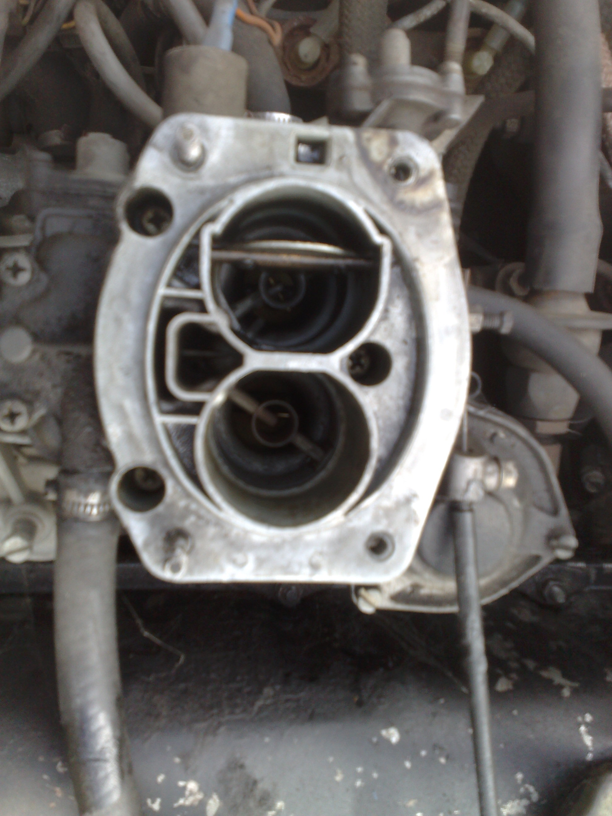

Evan G Posted August 21, 2010 Report Posted August 21, 2010 (edited) i was at the wreckers and spotted this in a lada nivas 4cyl looks like a weber, vac secondaries. made in the USSR? Edited August 21, 2010 by Evan G Quote
SLO-030 Posted August 21, 2010 Report Posted August 21, 2010 (edited) Not to sure on what it IS, but Weber Carbs are made in Bologna, Italy. Accelerator pump looks Weber style. not sure on the rest. Edited August 21, 2010 by SLO-030 Quote
B.L.Z.BUB Posted August 21, 2010 Report Posted August 21, 2010 (edited) Buy it! For the LOL's Edited August 21, 2010 by blzbub666 Quote
Evan G Posted August 21, 2010 Author Report Posted August 21, 2010 (edited) off this some info The Lada carburetor shares its footprint with the downdraft Weber family, which means that you can easily install the famous Weber on to your Niva. Although the Lada carb is not nearly as bad as many people make out, the Weber is a newer design of the carb and more importantly has bigger barreled throats (ie allows greater air-flow), so the upgrade is recommended by many for better power and drivability. Nivas also benefit from a larger bore exhaust, while it’s an expensive upgrade whenever your current exhaust needs replacement consider replacing it with a 2” system instead (don’t go any bigger though or you’ll likely loose useable power). A Weber will generally not drastically improve a Niva's mpg (depending on the Weber and how you drive it may even make it worse). A decent condition Weber will certainly improve on the mpg of a worn or badly tuned original carb, but one in poor condition or tune will not help. The Niva had two main types of carburetor fitted: a mechanical opening secondary or a vacuum operated secondary. Webers are virtually a direct swap onto Nivas originally fitted with mechanical secondary carbs. Nivas originally fitted with a vacuum secondary type carb may require a custom linkage lever for the Weber. Left-hand drive Nivas have different linkages I'm unfamiliar with, but I believe they are either easy to mod or a direct swap Edited August 21, 2010 by Evan G Quote
altezzaclub Posted August 21, 2010 Report Posted August 21, 2010 Get the choke diameter Evan- The Webers are often too large for 4Ks I reckon, and the Lada might be perfect. Quote
Evan G Posted August 21, 2010 Author Report Posted August 21, 2010 they swap 32/36 on them (1.6L) it looks kinda like a 32/36 Quote
roladude Posted August 21, 2010 Report Posted August 21, 2010 It looks like a 180 Holley, which is the smallest Holley you can get. I have had a few of them. Quote
Evan G Posted August 21, 2010 Author Report Posted August 21, 2010 suitable upgrade for a 4k? whats jetting like? set and forget? Quote
