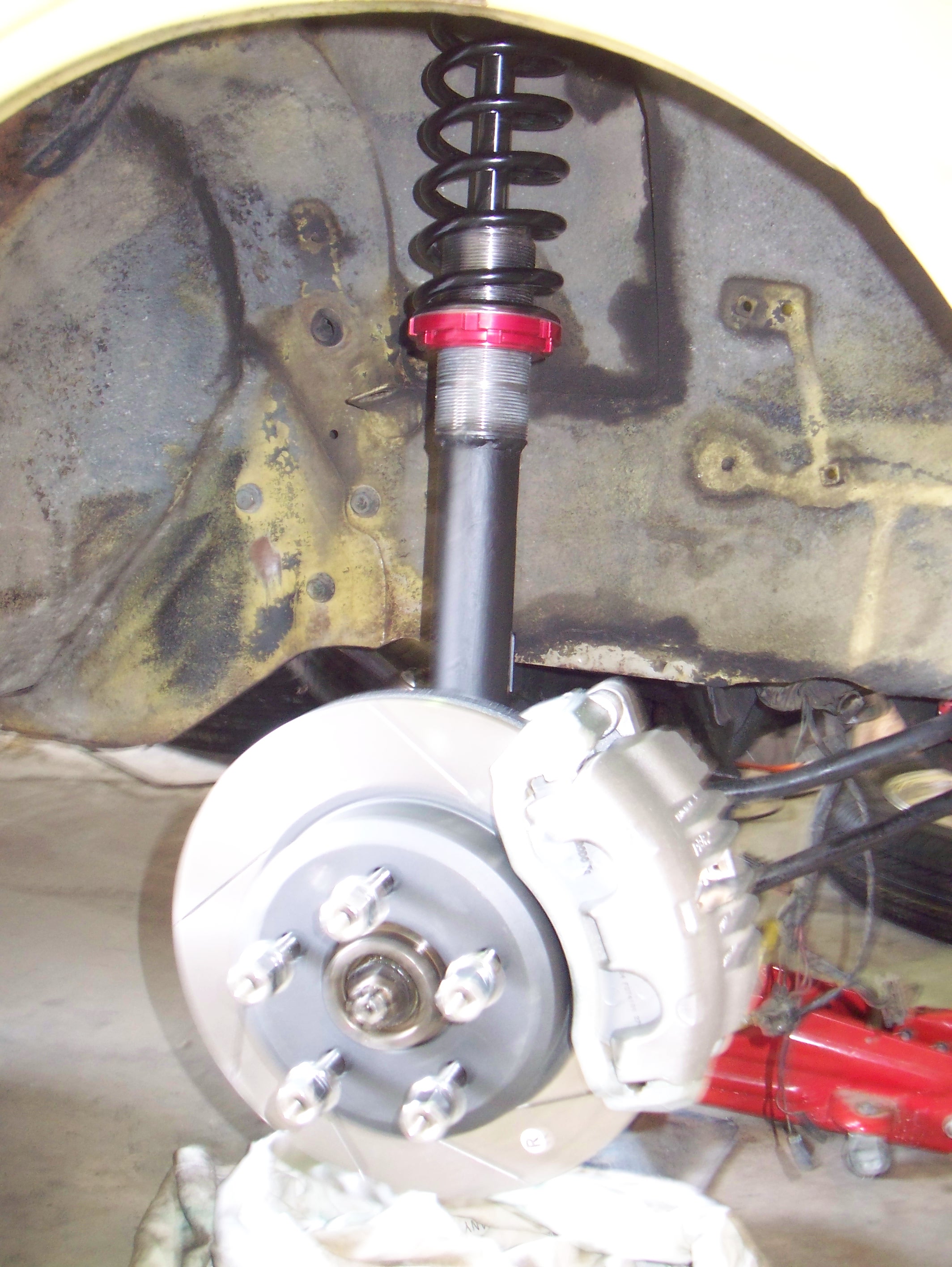

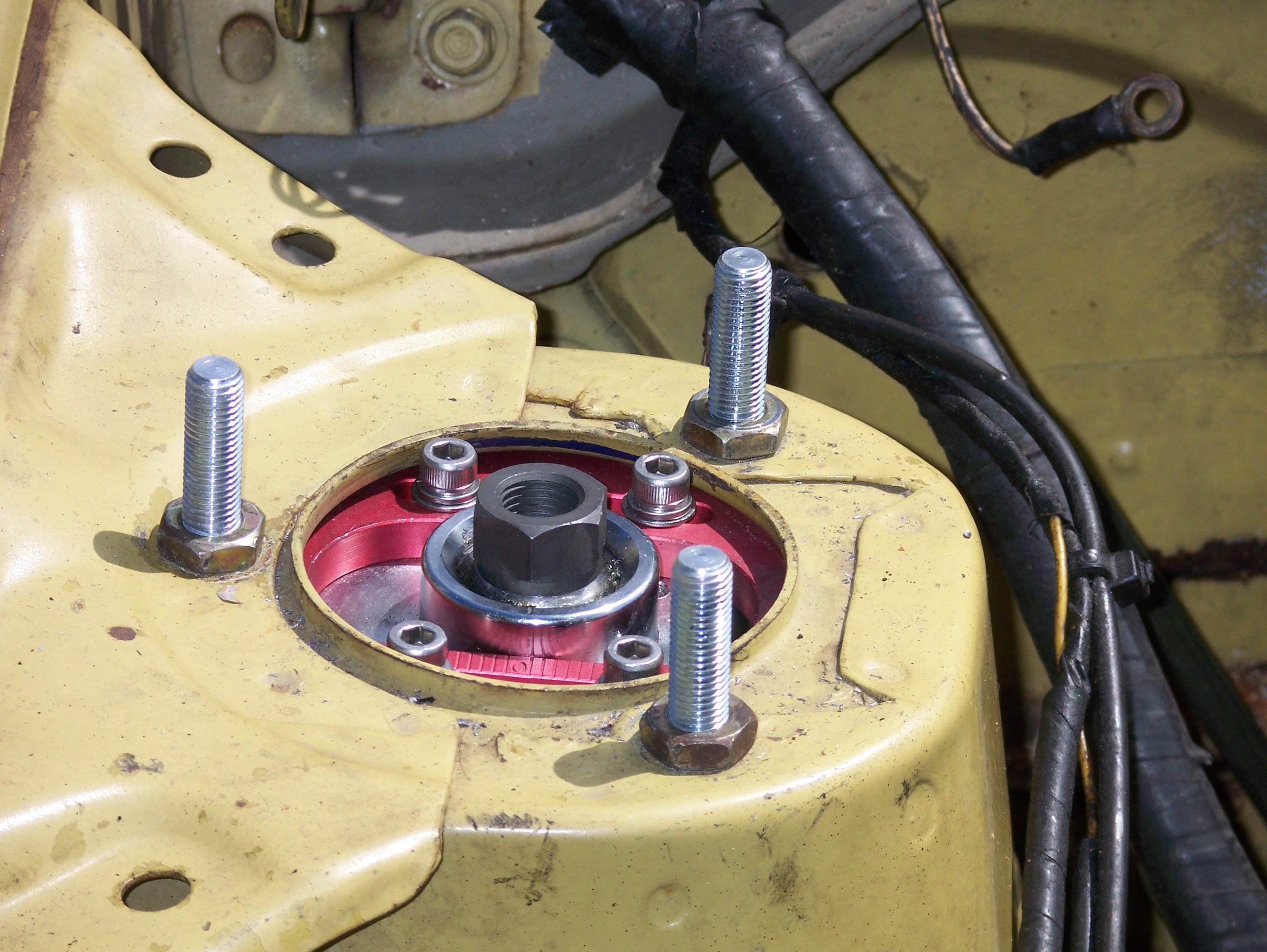

e70van Posted September 13, 2010 Report Share Posted September 13, 2010 1. when pedders list the strut, I'm almost certain that is not the actual strut body, stub axle, etc. it is only the cartridge insert. you need to either hunt the forums or search at wreckers to buy the complete struts. 2. the hsd sleeve kit needs to be welded onto your xt130 struts. you will need to grind off the old spring perch and cut some of the length off, then have the sleeve kit welded on. search youtube for more info as i remember seeing a tutorial video on there. (guy in usa working on ae86 struts) This will explain it to you better. xt130,ae86,ra60 etc struts are 51mm, so get that sleeve kit. pretty certain 36's are smaller, like the ke70s. (46mm maybe?) Coilover springs will be heaps better than using your ke36 or xt spring perch. if your lowering your car you will be able to have captive springs. (i.e "more" legal) You will also have a good selection of spring rates and you can adjust your ride height to basically whatever you feel! 3.those camber tops will let you adjust your camber definitely. you will have to drill the strut top pcd in them and press in the studs to suit.by looking at them you most likely will have to cut the top plate to size so it fits your 36. (they looks pretty huge) The camber tops are an extra 299 on top of the 299 for the sleeve kit to btw. I'm looking to order a sleeve kit this week from grant. heard only good things about them :) 1 Quote Link to comment Share on other sites More sharing options...
ke70dave Posted September 13, 2010 Report Share Posted September 13, 2010 (edited) i think i know what your on about, ive tried to answer your 3 points below: 1: i highly doubt you will be able to buy the STRUTS brand new from pedders as they are an OEM part. but definately buy new SHOCKS from pedders, don't waste your time with 2nd hand shocks. 2: i have only heard good things about the HSD kit, cheap too considering you get springs. plenty of people have used this kit with the xt130 struts. just need to confirm the diameter of the strut when you buy the kit. advantages over the ke36 spring seat is that the strut will be able to move inside your tower and combined with the camber plates you will actually have some adjustment available. other than that no real advantage other than the ability to get your heigh spot on. are you going to run short stroke shocks? unsure on those part numbers but you want to make sure your shocks are short enough to keep the coilover springs (ie short) captive. if you do use short stroke shocks you will prolly need to cut down the strut to suit, but you prolly already know this. 3: those camber plates look quite good, though i would highly recomend getting a machine shop to drill the holes in the top. you want to get that spot on. just take a standard strut top to a machinist (so he can get the bolt holes in the same spot) and say "drill these 2 camber plates like this". unless of course you have a drop drill and the proper sized drill. unsure how you determine the proper sized drill for that nurl on the studds (it will be an interference fit of some sort, which there are standards for), but it needs to be a very tight fit. edit: looks like e70van beat me to it!!! haha that will learn me for taking to long to post. Edited September 13, 2010 by ke70dave 1 Quote Link to comment Share on other sites More sharing options...

13bke26 Posted September 13, 2010 Report Share Posted September 13, 2010 i just finished putting the sleeve kit and camber tops onto my ke26 struts, pretty much done whats said above...origional spring seat cut off, and the new coilover threaded sleeve welded on..... just gotta trim the studs down now Quote Link to comment Share on other sites More sharing options...

KE26 Wagon Posted September 14, 2010 Report Share Posted September 14, 2010 Sikke20 used the Hopper Stoppers Kit. They are an expensive kit but worth it I think. One thing if you do go with the adjustable camber tops you will have to get them machined down to the strut tower diameter as the HSD kits are a universal and come way to big, but 10mins on a lathe and they fit. Quote Link to comment Share on other sites More sharing options...
