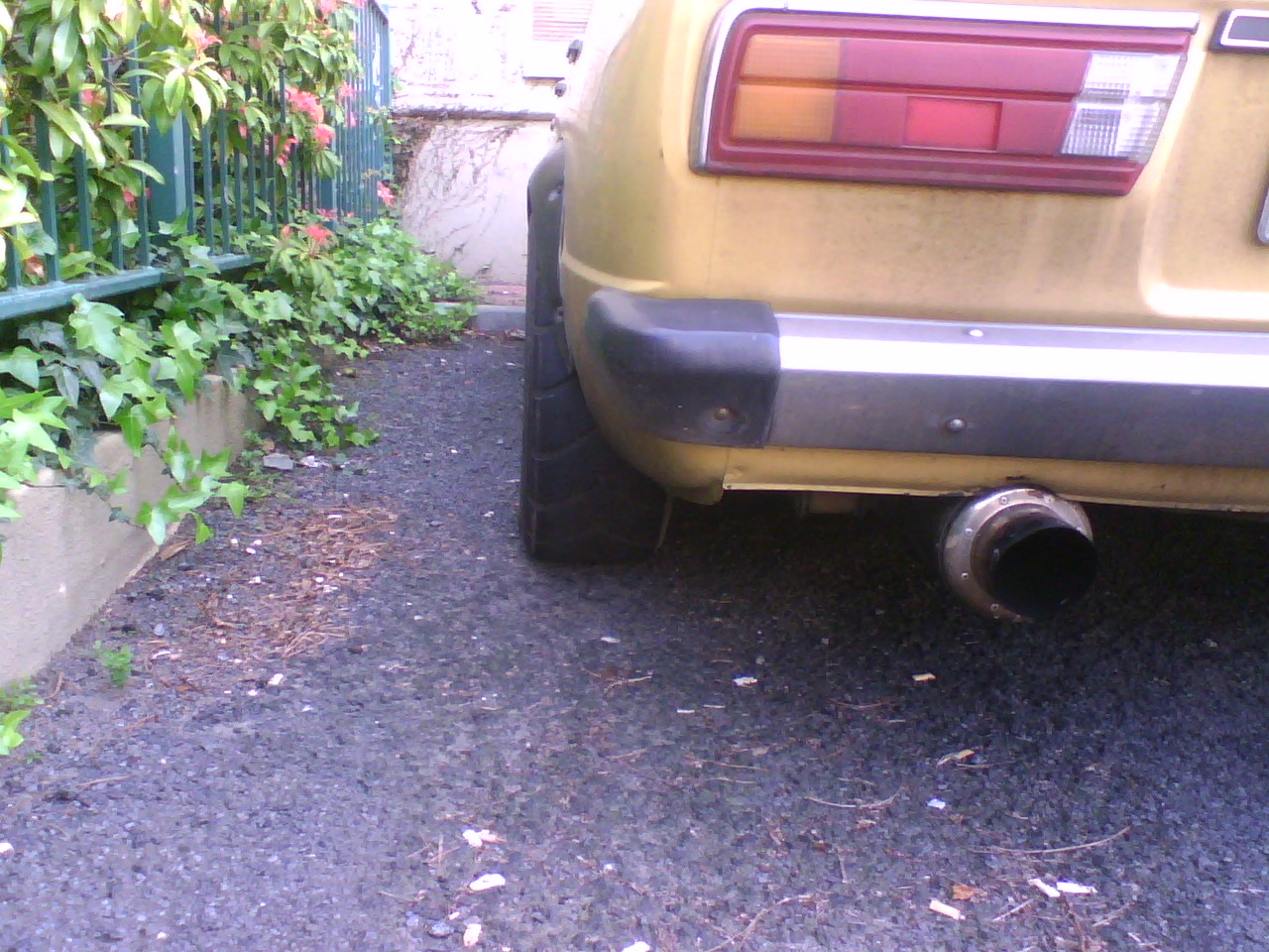

You don't really need to push the fronts out, it won't look too odd. The back however, if you're running +10 wheels then you'd probably want 25-30mm.
This is with 13x7 +10 wheels and a 27mm bolt on spacer.....

Mmm. I get the flares tomorrow so I'll have a good look then.
