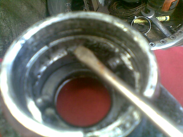

October 25, 201016 yr comment_477965 hello ladies and gents i have a quick question..... When you pull a ke70 gearshifter apart, and you have the bottom bit that bolts to the box, is there ment to be a rubber gasket or something rubber, inside where the shifter seats on the holder, if that makes sence In detail..... Shifter base, shifter stalk(where it goes into box and into gearknob), circlip,rubber surrounds, ........ I am asking inside the shifter base were it bolts onto the box, there is a circlip that holds the whole shifter stalk in place in the base, i need to know... inside the base is there ment to be like a rubber seal or 'spacer' i guess you could call it to hold the shifter against the sides and centre of the shifter base???? :hmm: Report
October 25, 201016 yr Author comment_477999 here is a picture of what i'm talking about i'm trying to point to what is missing It looks and feels like perished and missing rubber Report
October 25, 201016 yr comment_478126 yes there is. It's looks like a rubber cupped washer. This is for a T40-50, but you can see it. Report
October 28, 201016 yr comment_478804 Is it a K40 or K50. KE70 K50 and T50 shifter housings are interchangable so theoretically one of those AJPS T50 rebuild kits (for like $50) would fit the K50. :hmm: Report
October 29, 201016 yr Author comment_478848 :hmm: clever man yeah it's a k50 box i see well ajps it is then cheers lads Report
October 29, 201016 yr comment_478856 The key word in that previous post was theoretically..... ie I take no responsiblity if it doesn't fit. If it doesn't then its not the sort of thing you can't sell on anyways. Report
