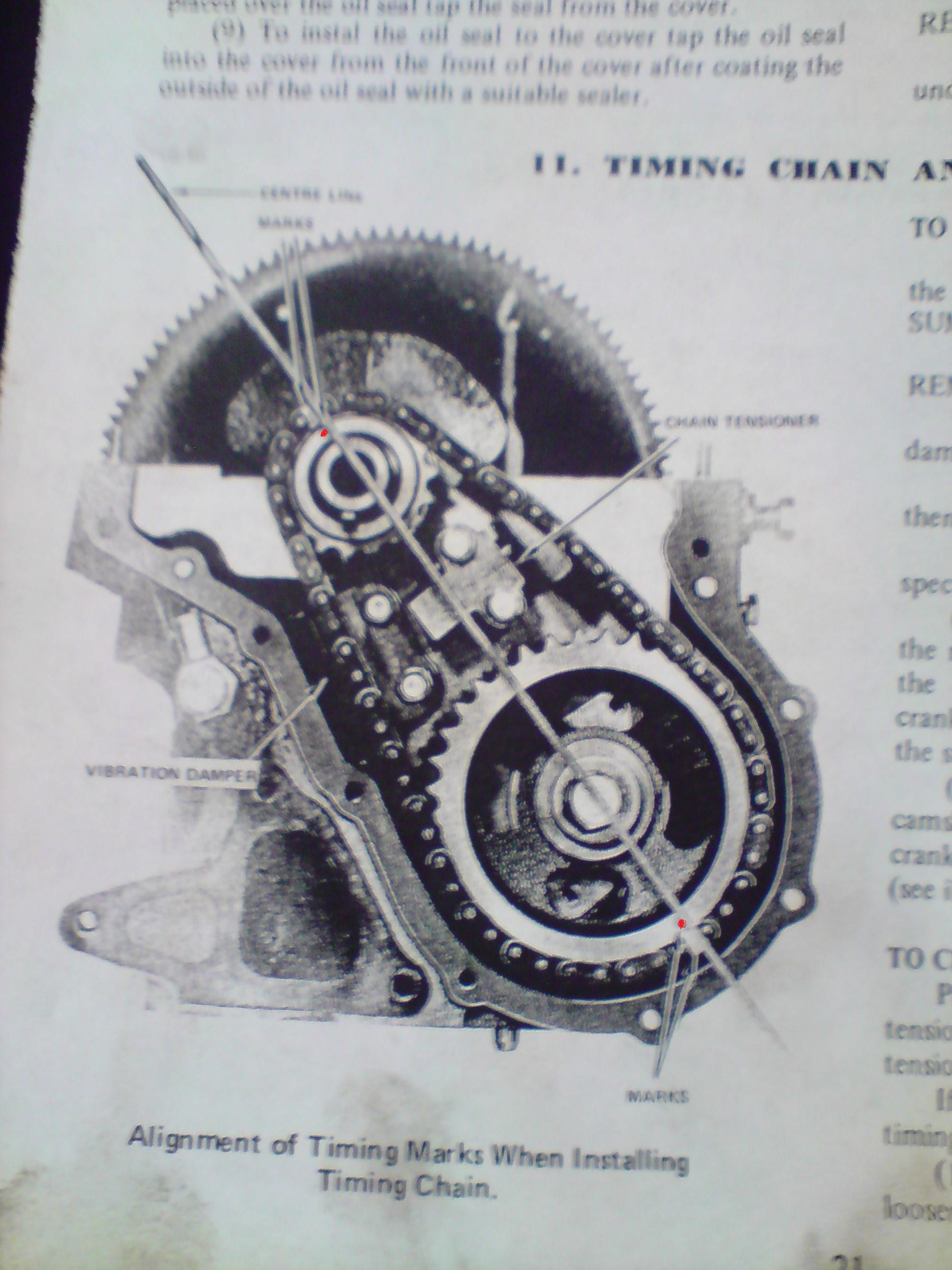

November 1, 201015 yr Author comment_479560 New progress, turns out the carby isnt sucking in the petrol it is blowing it out the top. RAA said the timing chain is out, but we lined it up like it said in the manual. Please help I'm stumped. Report
November 1, 201015 yr comment_479562 Did you align the markings (the two dots) opposite of each other..... the red dots indicate where the marks are on the crank and camshaft Report
November 1, 201015 yr Author comment_479589 we used the workshop manuel in the local library which is'nt as clear as the diagram you supplied. The cam is definatly in the same position as your diagram shows, But unsure of the dot on the crank. Report
