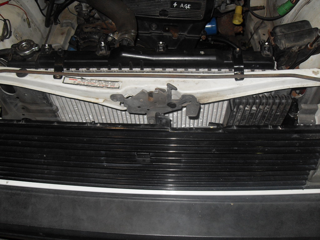

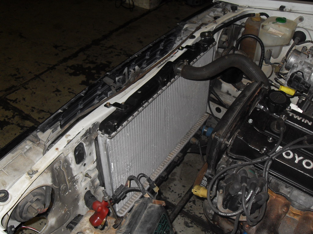

My New Ke70
radiator in.gettin there

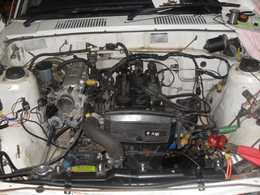

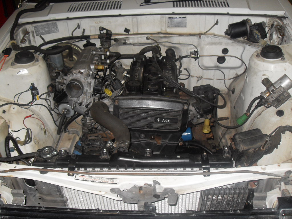

temporarily wired up computer today and had car running. got a few minor issues to sort out,tidy up and mount computer and wiring then it can go off for new exhaust and i'll hopefully be on the road again.
got her up n running today and she moved under her own power. so keen for a drive...
