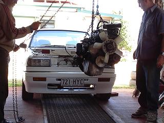

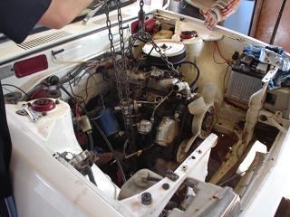

October 4, 200521 yr Author comment_74646 Well, all went well with the pulling out of the old engine - there was the odd bolt or two that had seized up in its hole but aside from that there were no problems... We took the 4k out and stripped her of the necessary pieces - Alternator, alternator bracket Starter motor Weber dgv 32/36 carb + adaptor plate Old 4spd gearbox - for now anyway Old radiator - till end of week We had trouble with the engine mount on the drivers side - as it was too small, so the old one was reused, the standard carb was ditched for the Weber and the old 4spd gearbox was mounted to the 5k. Other than the engine mount, the only other problems that had appeared were that the fan belt was WAY to big, so a smaller new one was fitted. also, when mounting the gearbox, the engine backing plate was getting in the way - so the old - chop, chop, hack, hack system was used to line everything up... :D Report

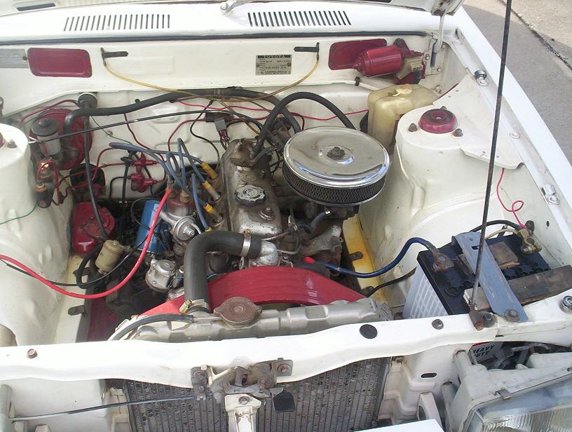

October 5, 200521 yr comment_74896 This is how it looked before we started the journey....! :D Report

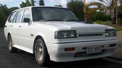

October 5, 200521 yr comment_74897 And for all those not playing along at home...... This is my Wagon....! :D Report

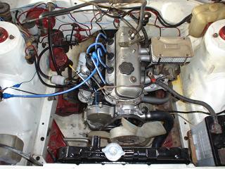

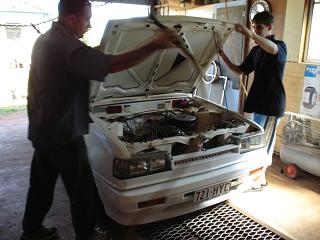

October 15, 200520 yr comment_76934 Hey guys, finally have pictures of the whole project from start to finish so here goes..... =) Here is the first day..... Report

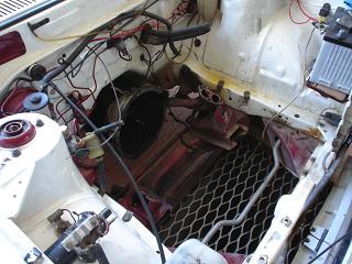

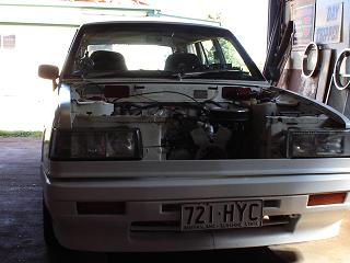

October 15, 200520 yr comment_76935 The removing of the front grille, radiator and support assembly..... Report
