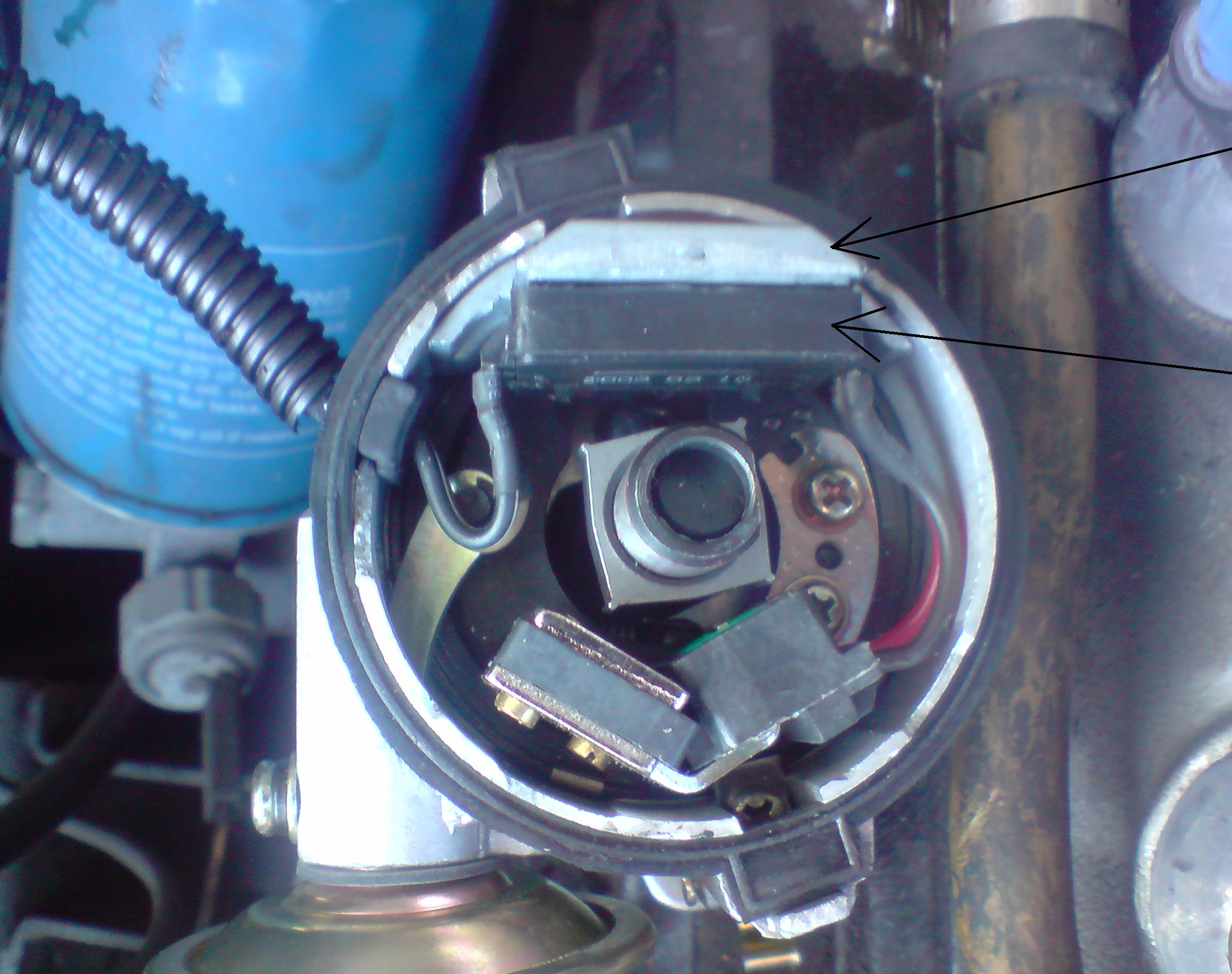

jono1986 Posted January 9, 2011 Report Share Posted January 9, 2011 Hey guys, I was having an intermittent misfire with my new dizzy in and now it's alot worse. Pulled it out and found the plastic cover to the ignitor part was loose and after pushing and what not it ran better but I reckon it needs replacing. I don't know what car it came off, I've pm'd the guy I bought it off but thought some people might know where I can get all new bits. Here's a pic of what I'm talking about: Cheers Quote Link to comment Share on other sites More sharing options...
Evan G Posted January 9, 2011 Report Share Posted January 9, 2011 http://cgi.ebay.com.au/TOYOTA-FORKLIFT-4Y-5K-SIGNAL-GENERATOR-PARTS-11-/310177431009?pt=LH_DefaultDomain_0&hash=item483803fde1 but at that price f@$k that! you should have a problem with a missing cover. just make sure no water gets in there Quote Link to comment Share on other sites More sharing options...
jono1986 Posted January 9, 2011 Author Report Share Posted January 9, 2011 Yeah not $120 can get another dizzy cheaper than that....I think.....It's not really a cover, it's two parts one holds the little pcb and the metal bit holds the power transistor to act as a heat sink. So i think the soldered joints have moved but it's been specially built (on the cheap though, most probable anyway) Quote Link to comment Share on other sites More sharing options...
Evan G Posted January 9, 2011 Report Share Posted January 9, 2011 (edited) wait wait wait. those 2 bolts holding the inductive pick up were loose? if they were loose this means your dwell was up the shit. (coil not energized enough to produce a good spark) tighten em up and check you dwell! Edited January 9, 2011 by Evan G Quote Link to comment Share on other sites More sharing options...
jono1986 Posted January 9, 2011 Author Report Share Posted January 9, 2011 (edited) OK ummm....the two arrows show what was loose, all the screws were tight. Edited January 9, 2011 by jono1986 Quote Link to comment Share on other sites More sharing options...
Evan G Posted January 9, 2011 Report Share Posted January 9, 2011 ohk gotcha! I'm pretty sure you can buy the special heatsink paste from motor traders and just glue it back on (beware that shit causes cancer BIGTIME!) Quote Link to comment Share on other sites More sharing options...
jono1986 Posted January 9, 2011 Author Report Share Posted January 9, 2011 I'm not sure that will do it, i might open it up and try and get a soldering iron in there. Quote Link to comment Share on other sites More sharing options...

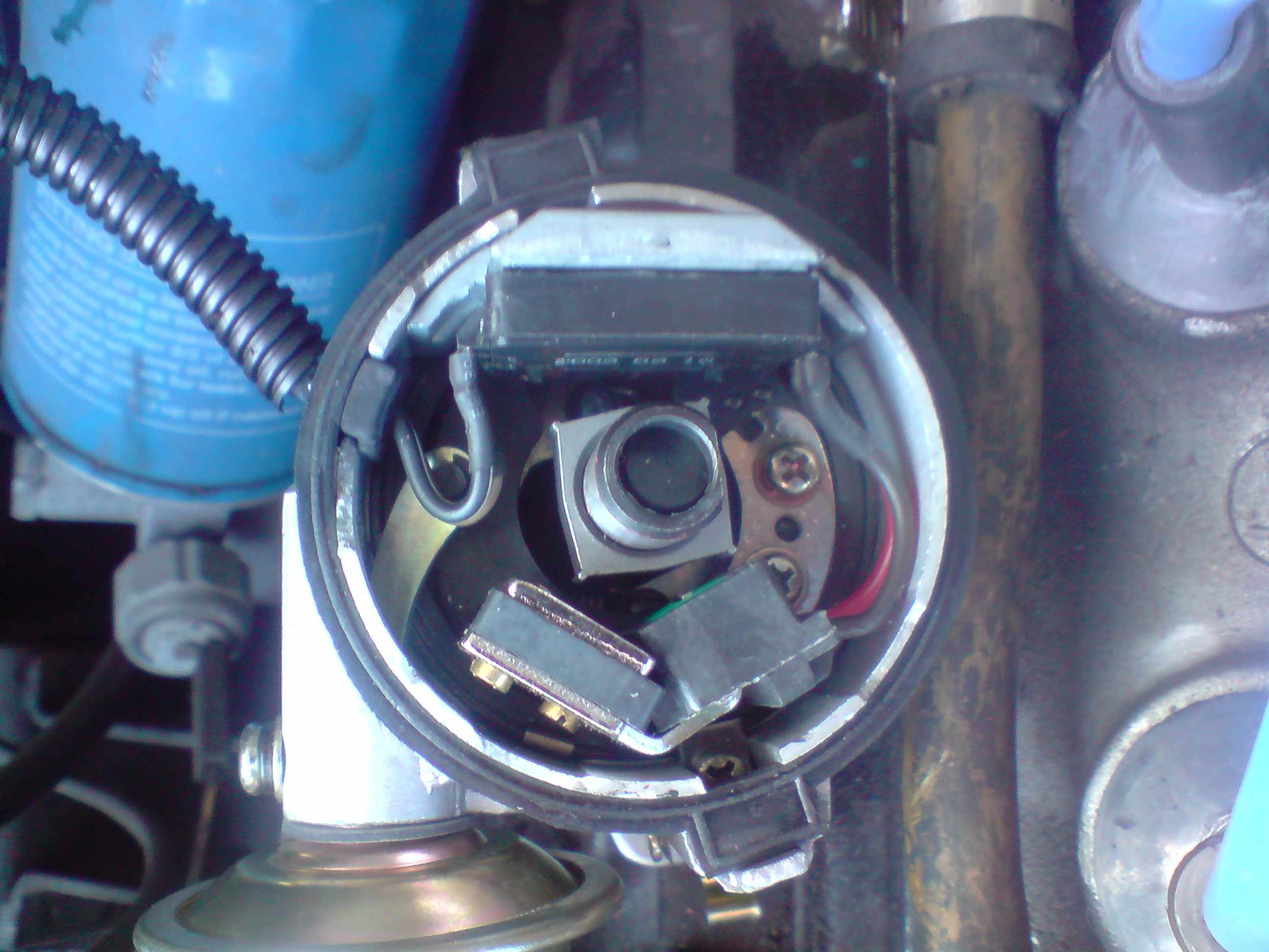

jono1986 Posted January 10, 2011 Author Report Share Posted January 10, 2011 Took the ignitior thing apart and resoldered everything, but I reckon it's long gone. Just put in the points distributor in for the next couple of weeks, and hopefully the points last that long...then again their only $8.25 for new ones so. I have a programmable ignition system that can work on a reluctor pickup, might try that just for the hell of it. Quote Link to comment Share on other sites More sharing options...
