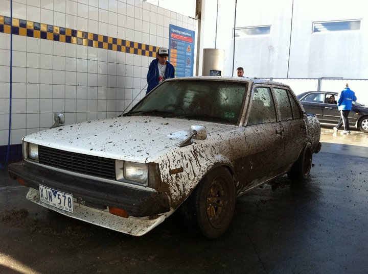

back on topic. opened up the thermostat and it was in 5 pieces no wonder it wasnt working lol. Chucked in the thermostat out of my old ke and it runs even better now that the engine gets up to temp. took it out sliding yesterday and it went really well(except the clutch is on its way out now :( ) going to order a hd exedy for it.

Cheers guys, and nice work xris :P Dirty lil Rolla
~Chris~
Bonnet still clean, werent trying hard enough :P
