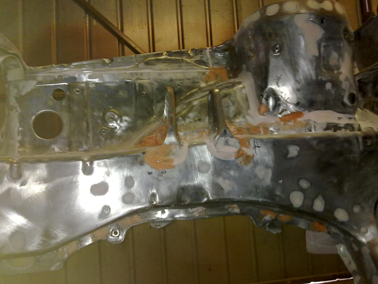

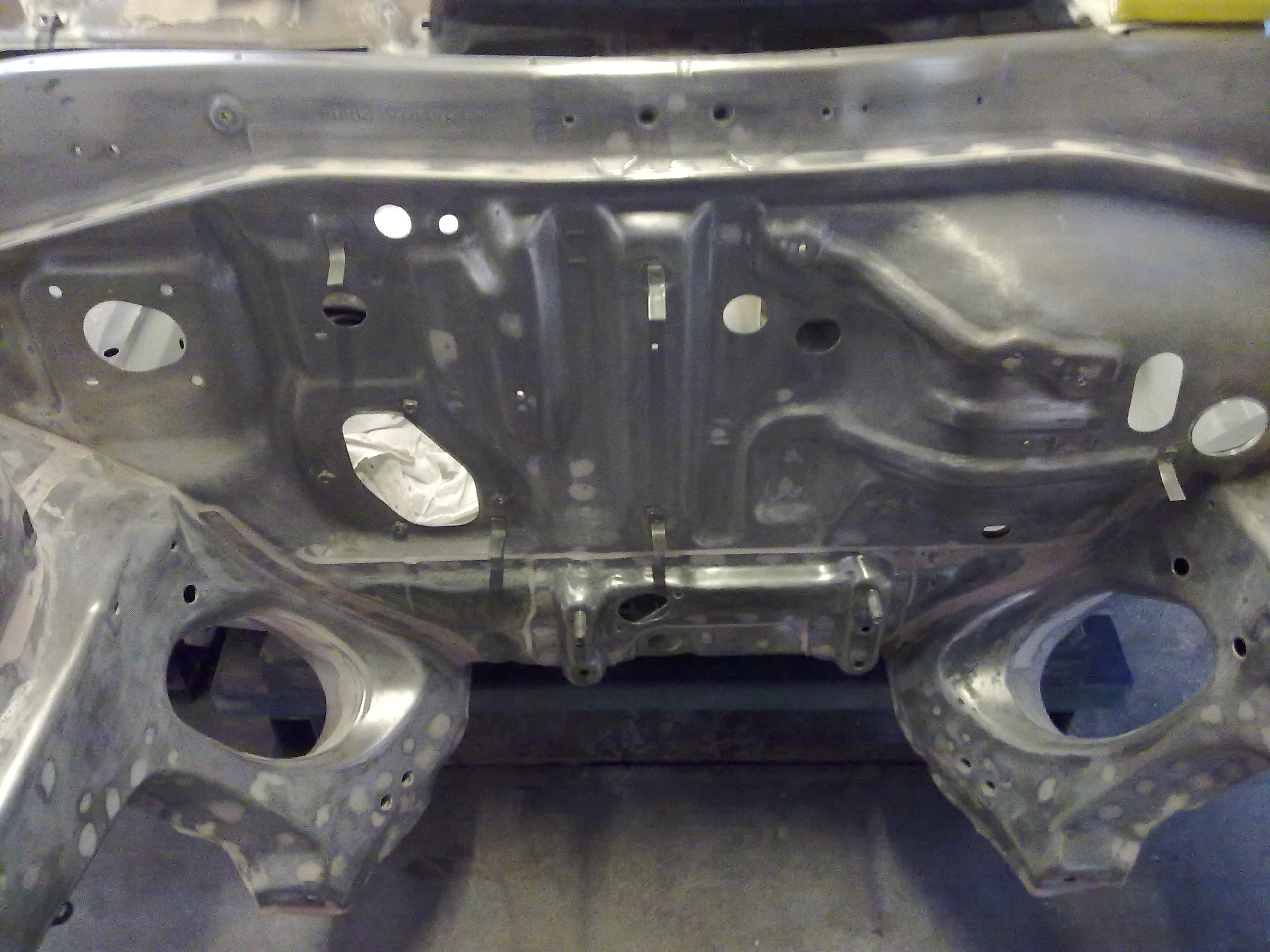

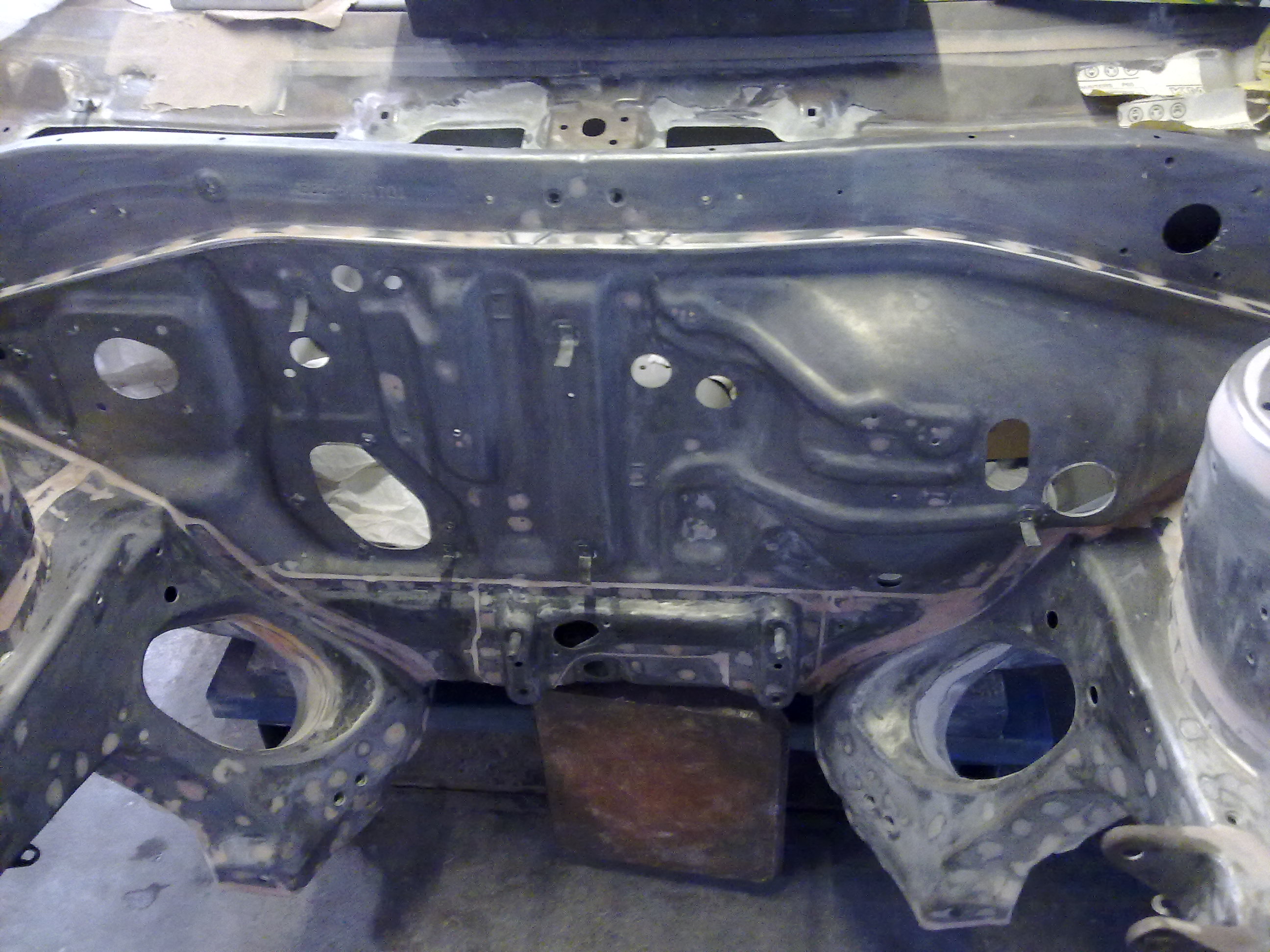

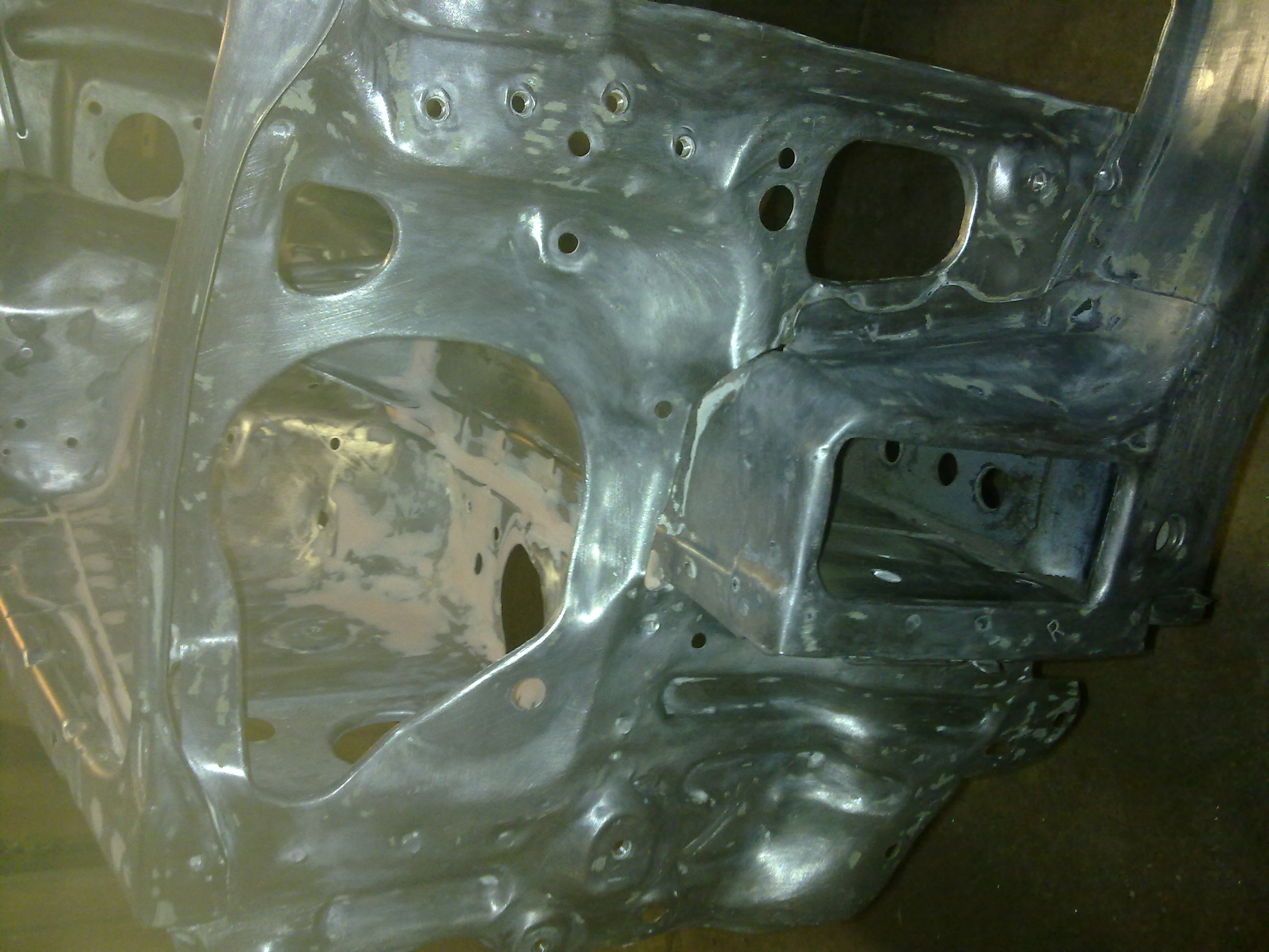

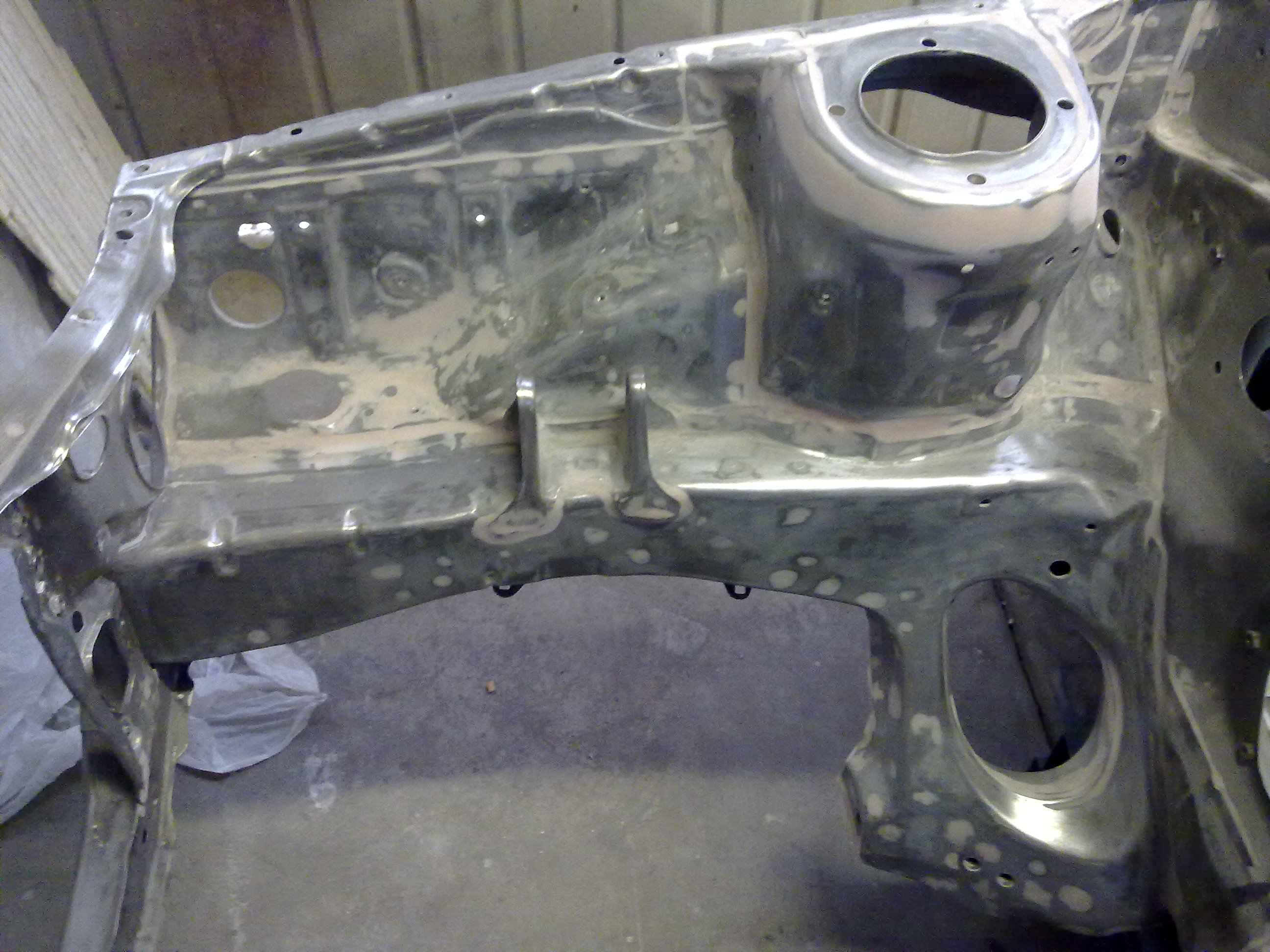

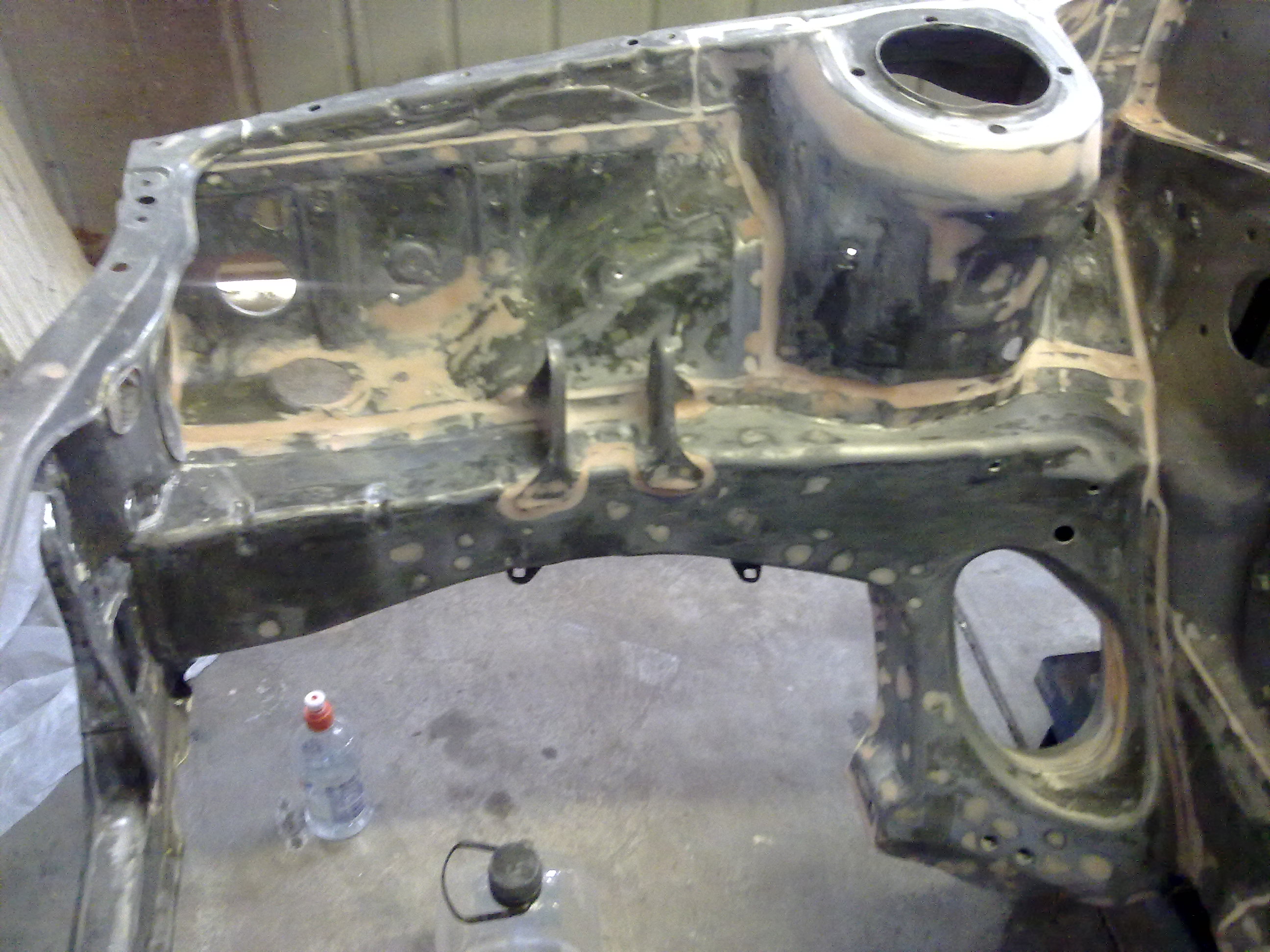

So I decided to concentrate my efforts on the front end of the car, from the firewall forward leaving the A pillars to be done after rust treatment. Speaking of which it was a hit of rust converter on all rust affected areas on the front of the car then back into sanding. The only thing I don't like about rust converter (aside from the smell) is the 3 stage wash process afterwards, with water rag, metho rag then dry rag. Its okay for small areas but when doing large areas its a time consuming affair!

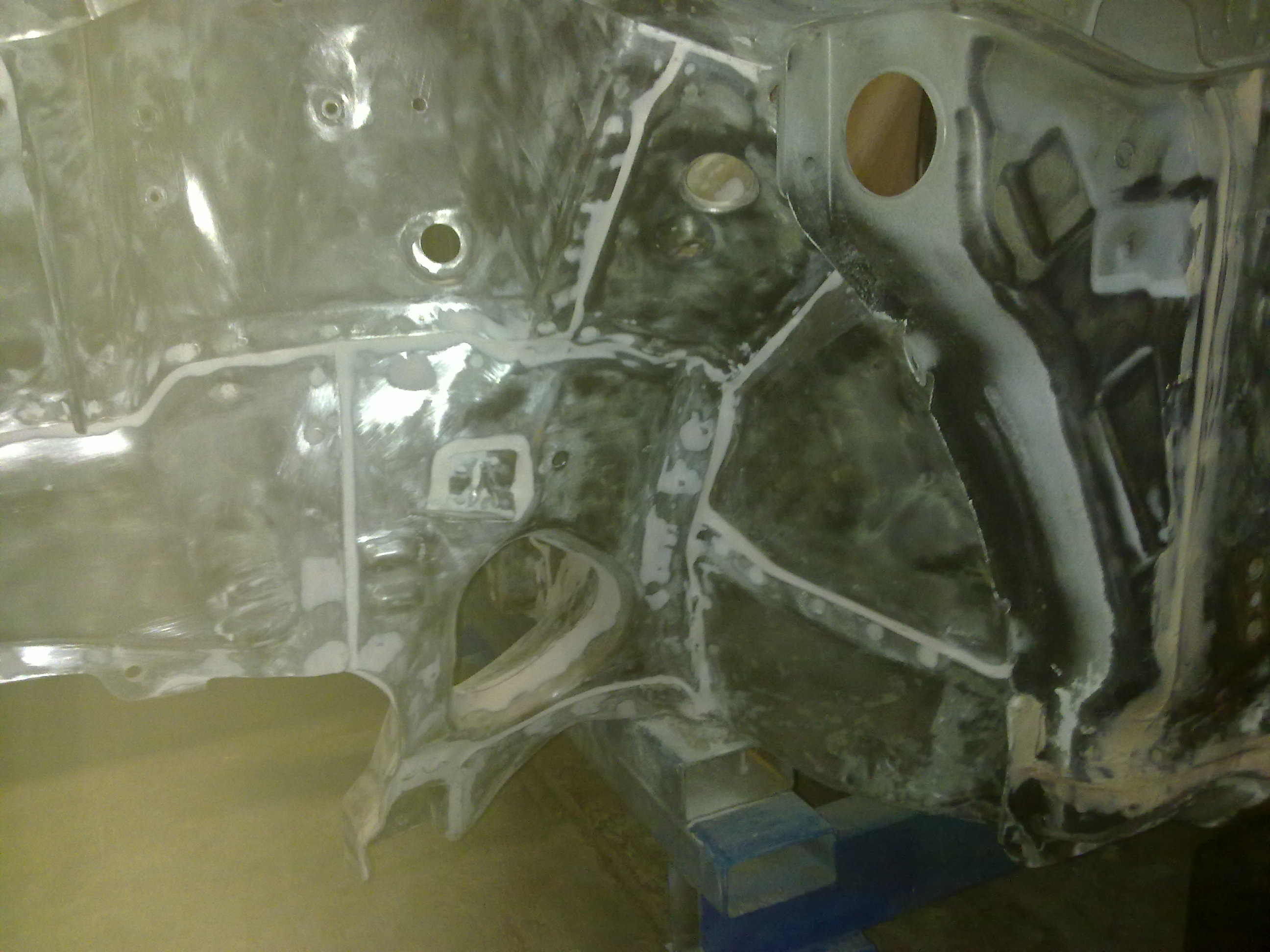

Applying more bog as needed.

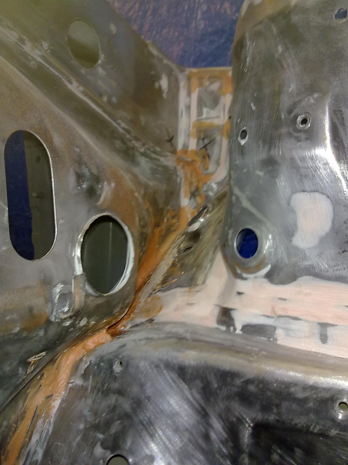

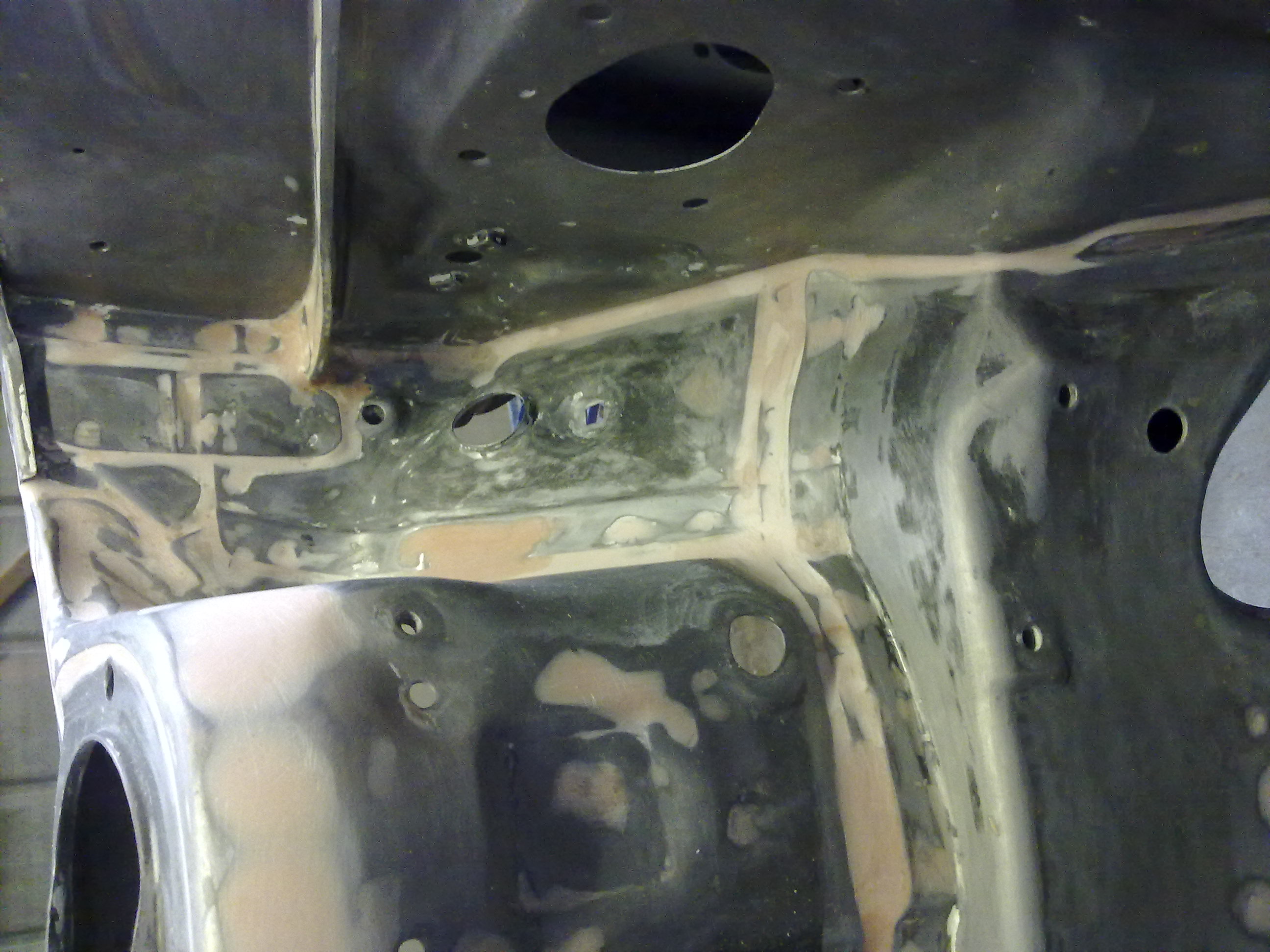

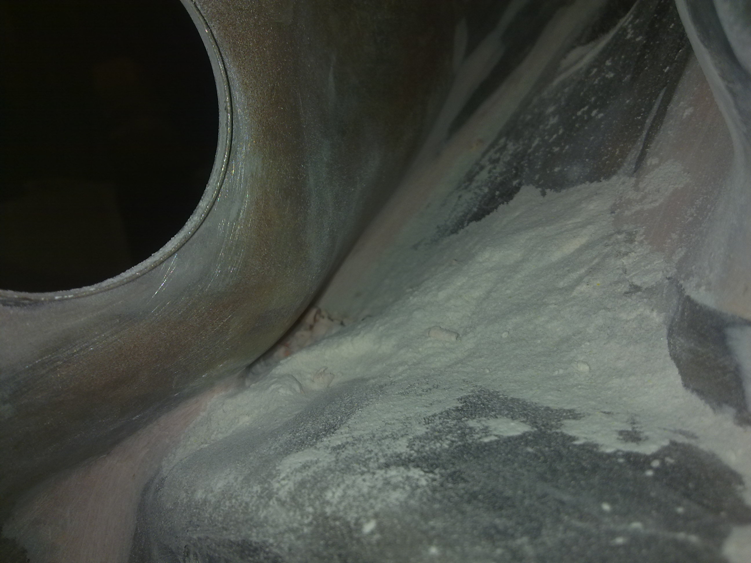

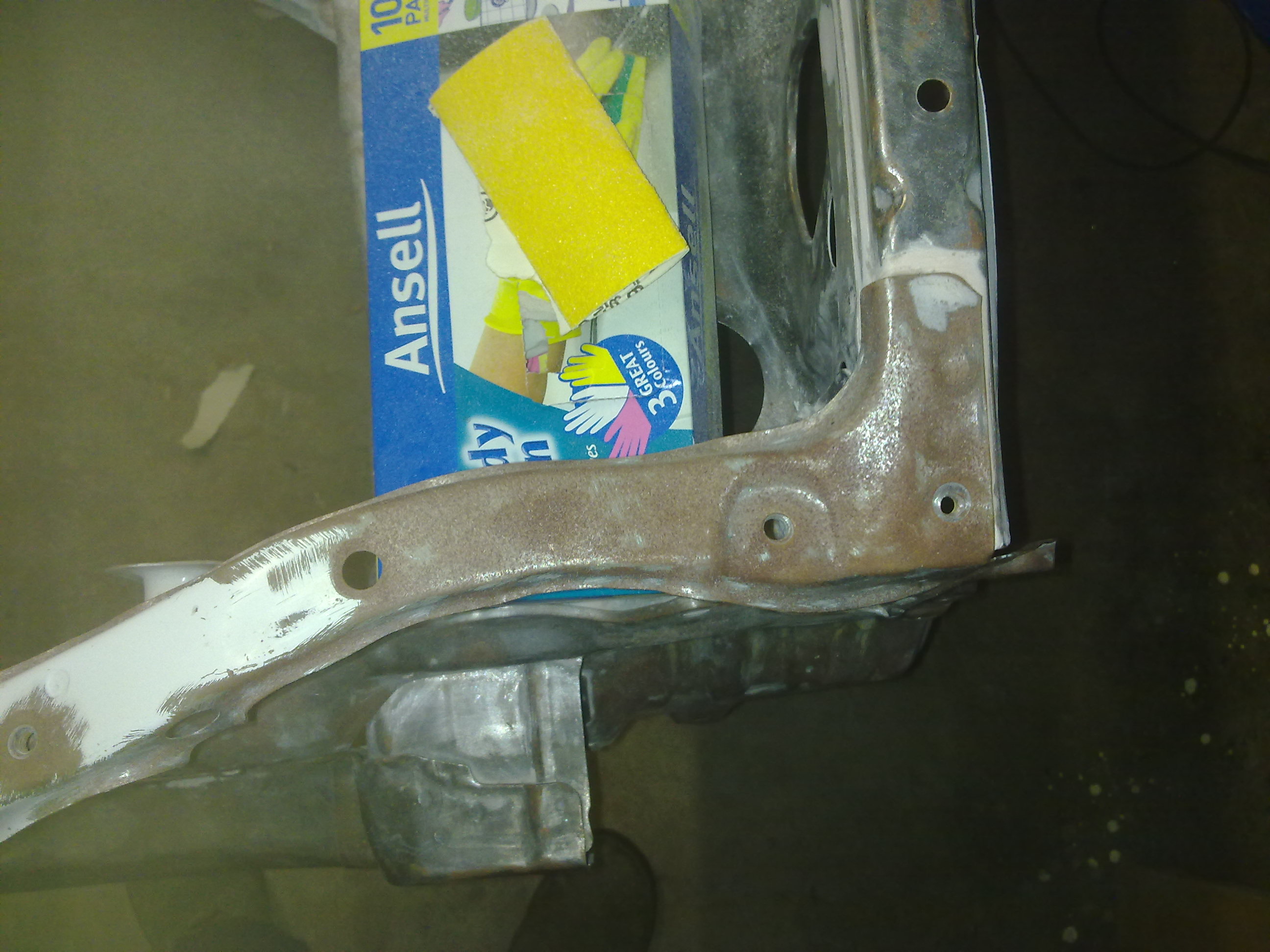

This area of the firewall near the main chassis rail was an absolute *insert nasty word here* to deal with, it bulges out like this to accomodate the heater/air-con unit. It was difficult to get to to grind, messy to bog & PAINFUL to sand (my fingers are too big). I was not going to have it as the only ugly spot in the engine bay. I picked up on a seam in the interior I had missed shortly before I was going to spray primer, thought about not doing it & realised I would probably see that seam every time I looked in the rear view mirror, it would annoy me, so it was bogged & sanded. :)
The black crosses were my reminder of where to do little spot fills , whether I'd under-bogged, over-sanded, missed a spot or had an air bubble. There were lots & lots of these & after staring at grey metal for hours on end, they can be very easily missed & yet ANOTHER mix of bog has to be made! :laff:

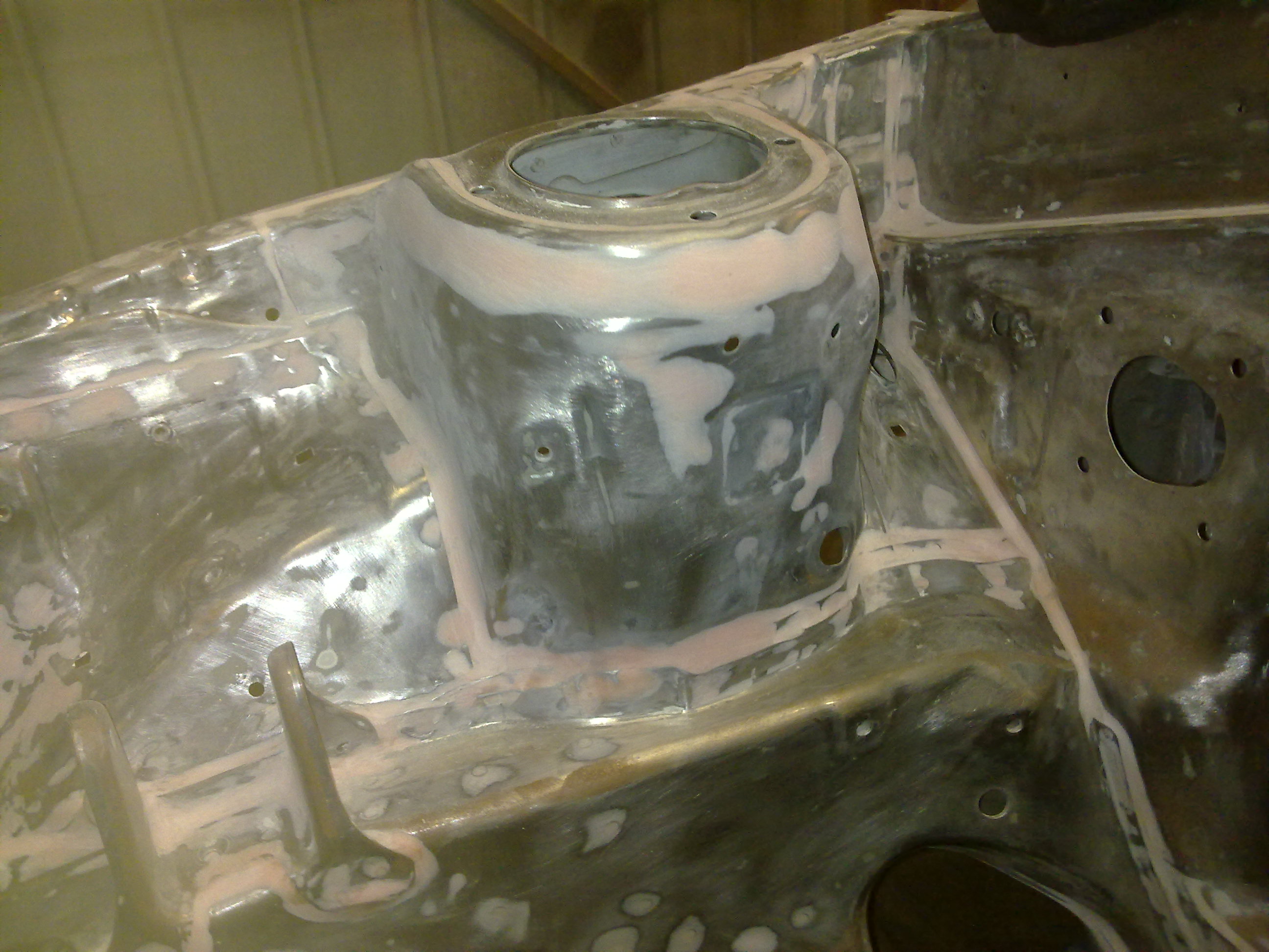

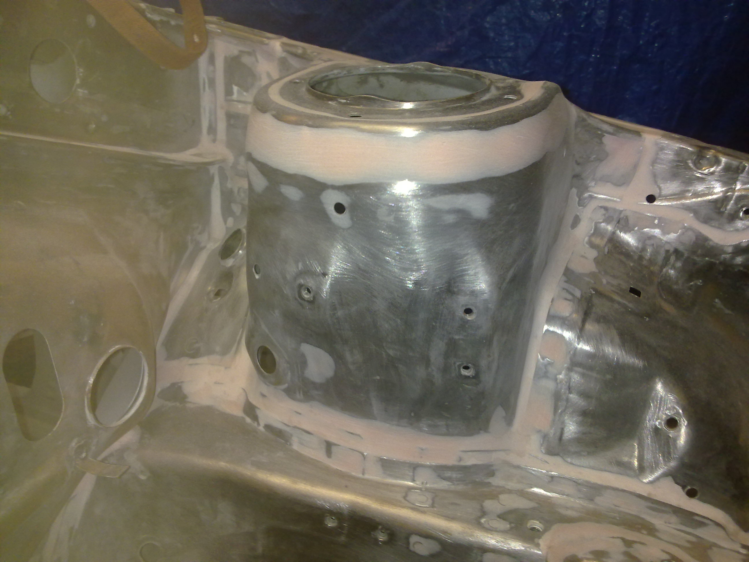

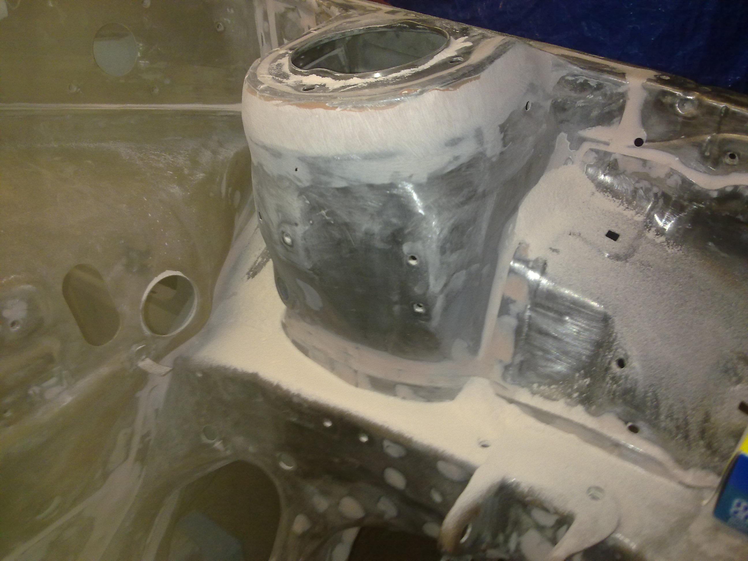

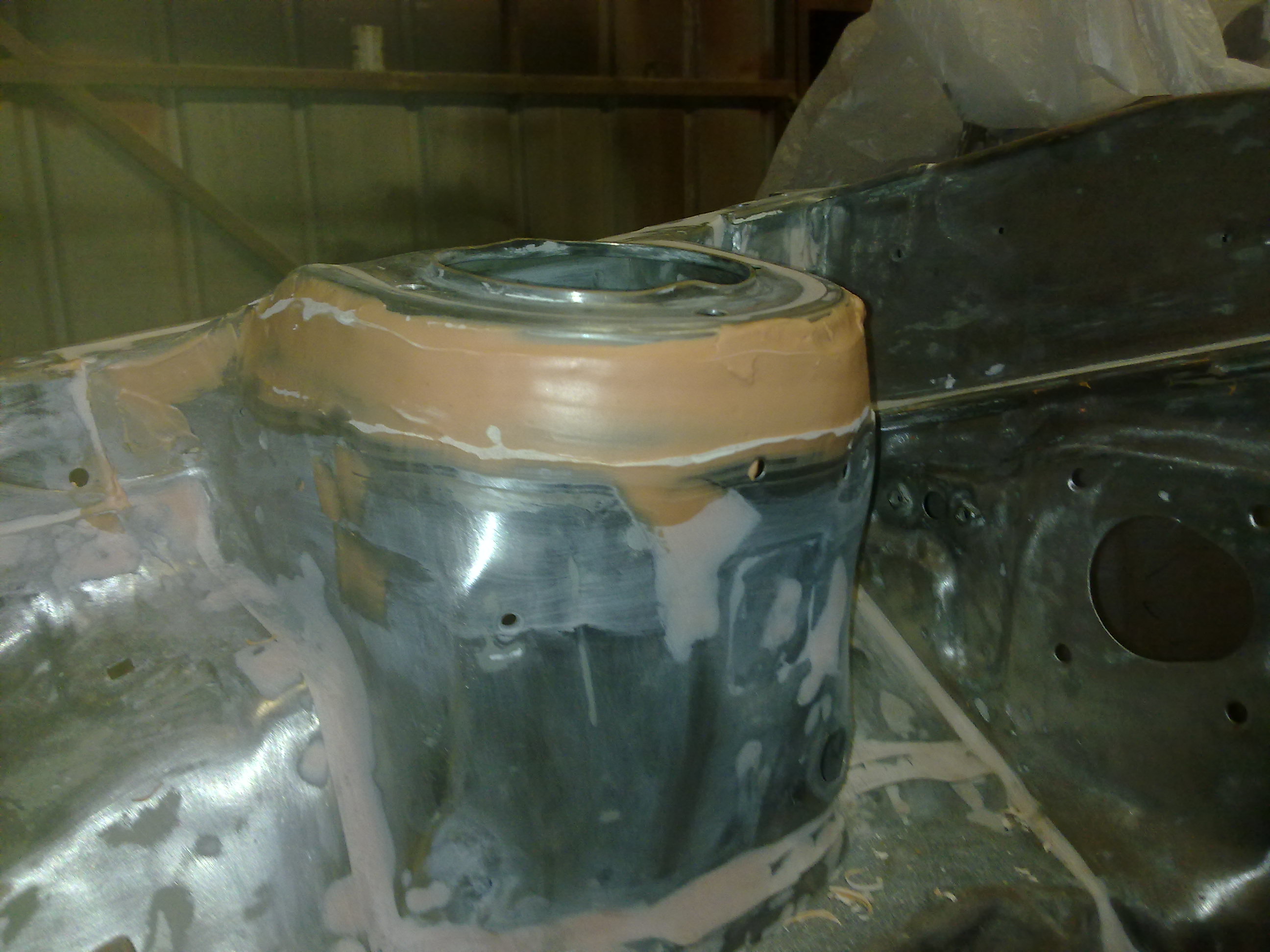

The strut towers hadnt come up as smooth as I'd like, so yet another hit of bog.

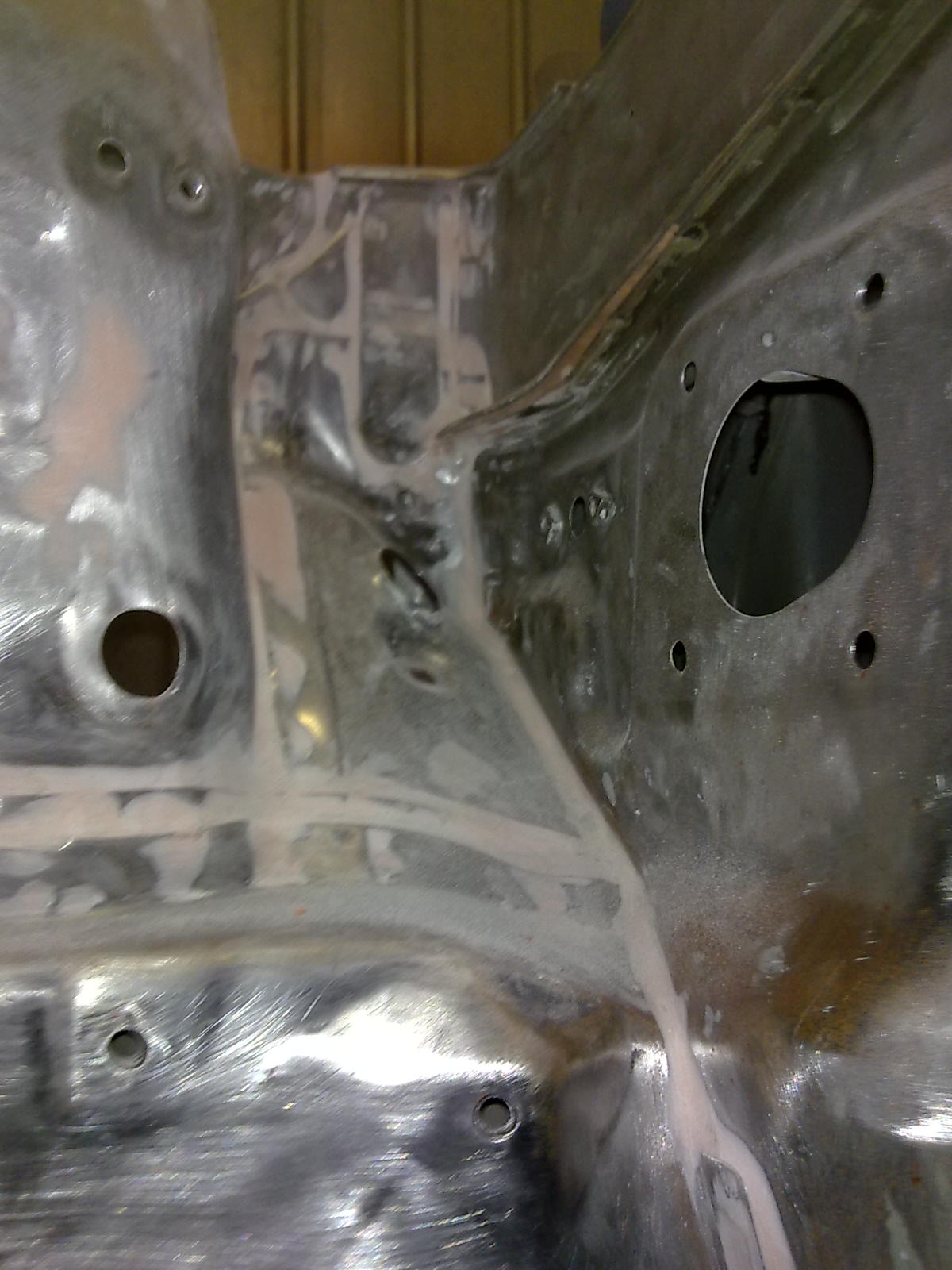

A close up of the pain in the rear section of the firewall I mentioned a little earlier.

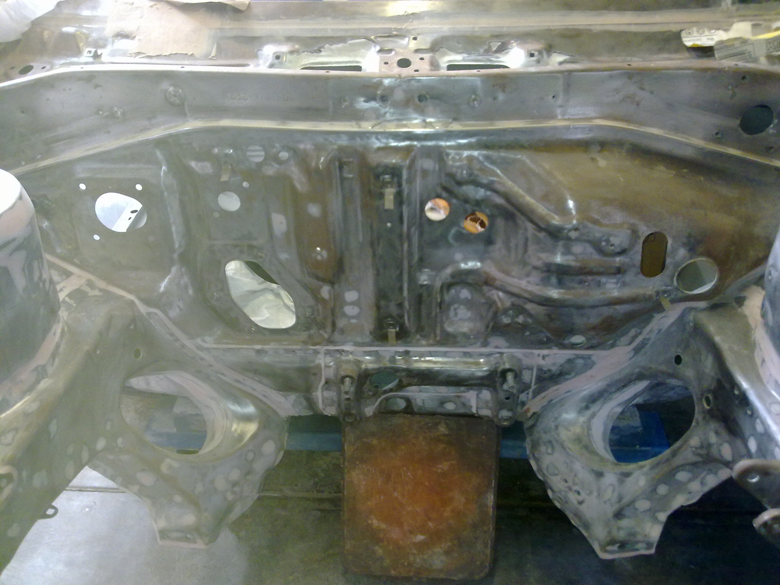

Firewall.

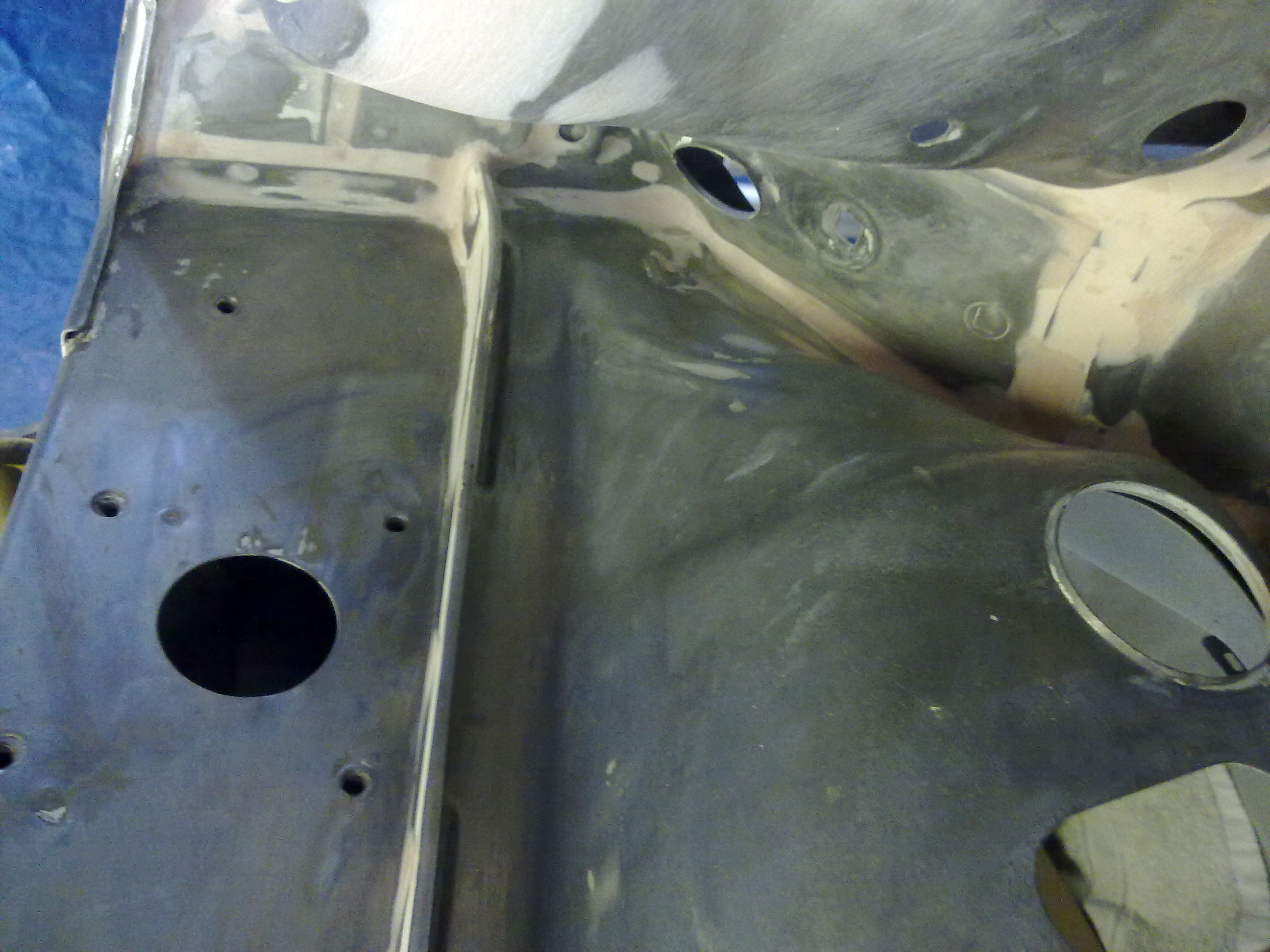

After the hit of rust converter & the wash off, it was a quick rub over everywhere with finer grit paper just to scuff up the surface nice & fresh for primer.

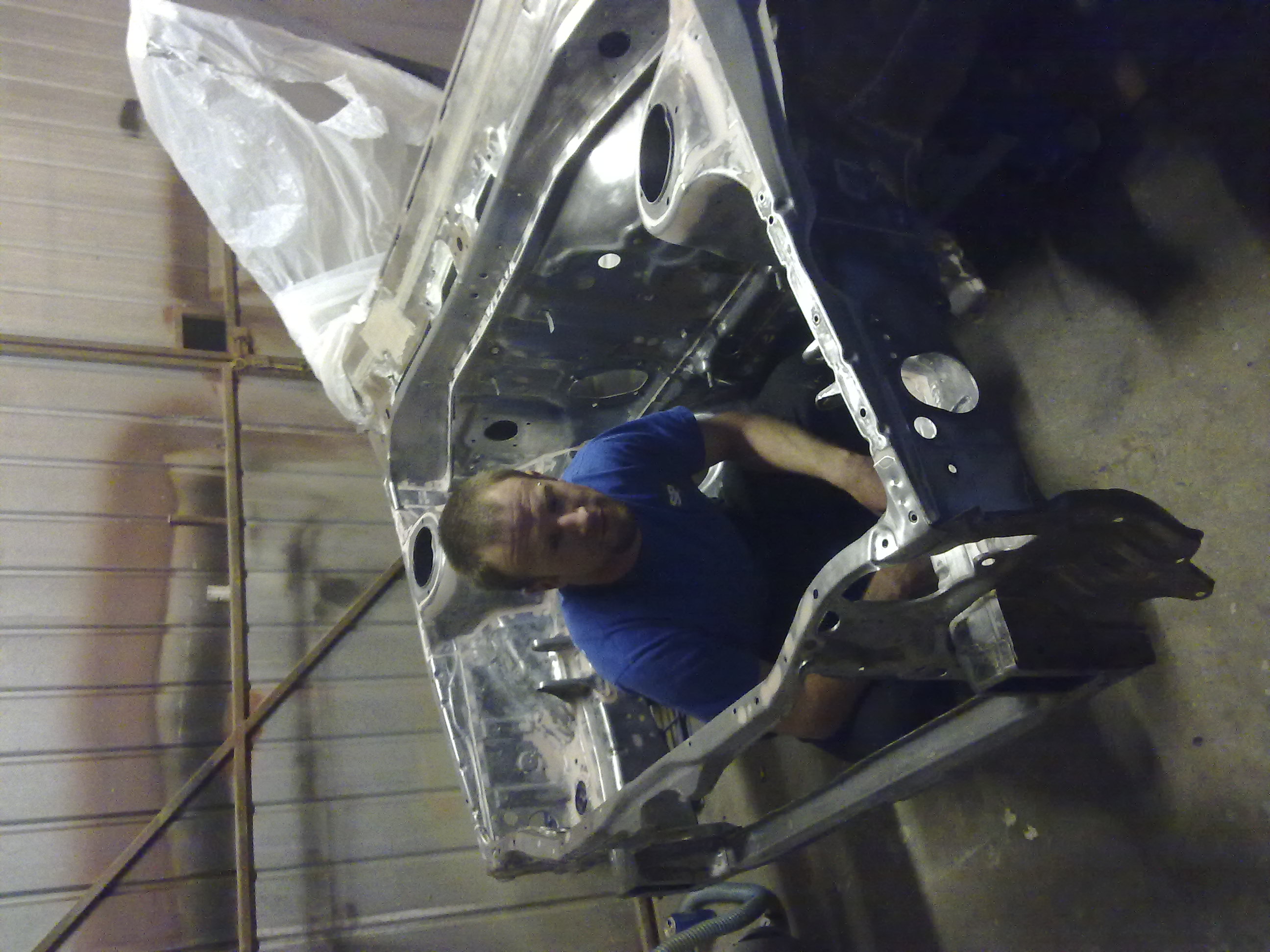

Had to get a shot of me in the engine bay, have been inside this thing for what seems like forever & am glad to soon be out of it!

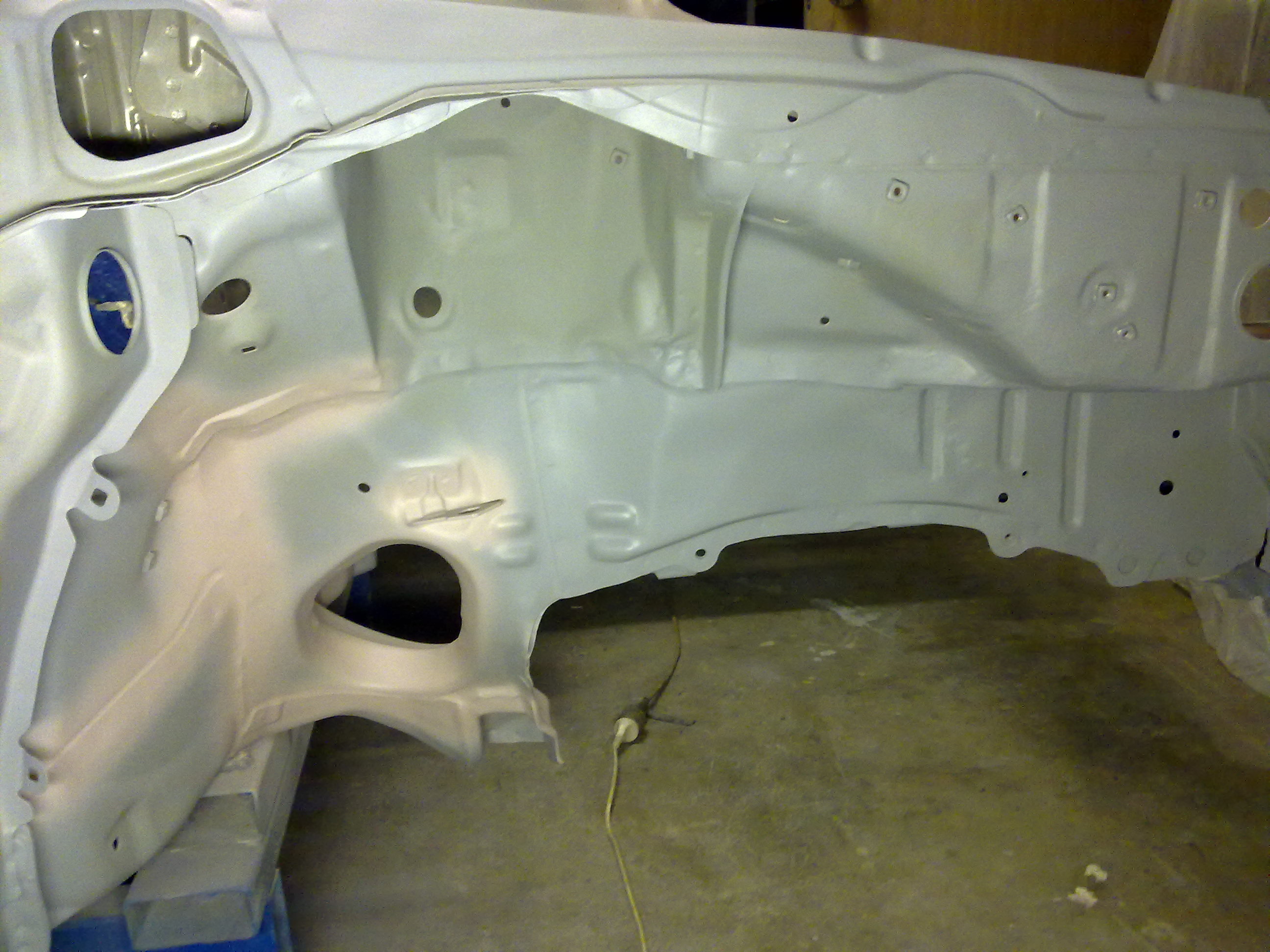

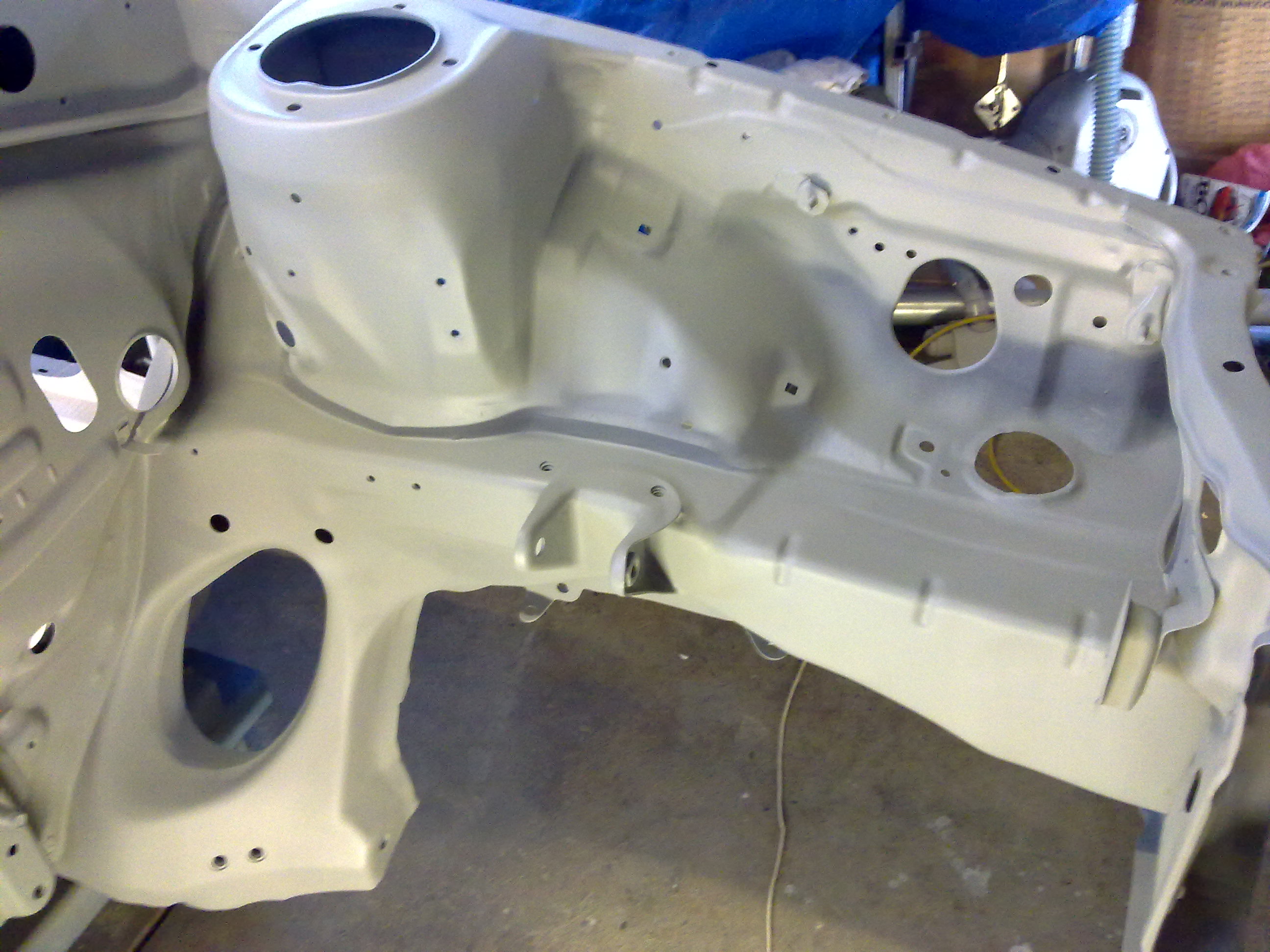

Front end passenger side.
Front end drivers side.

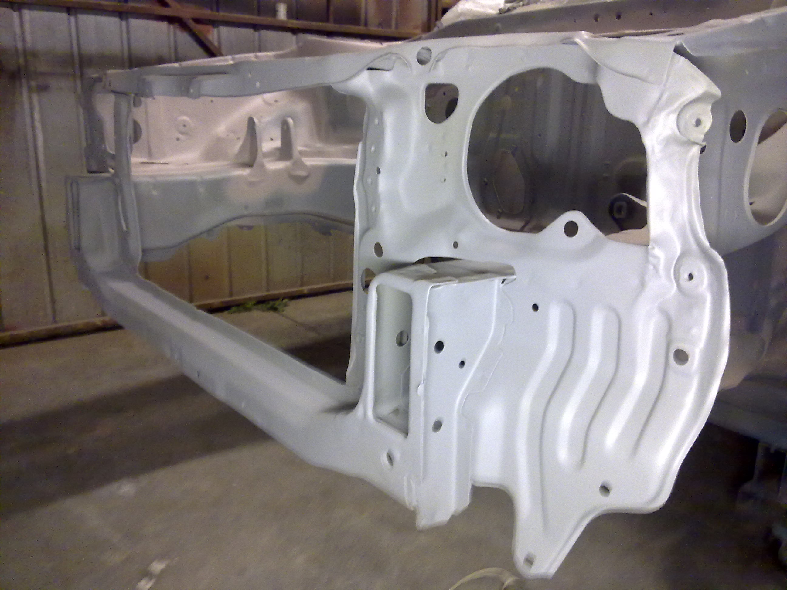

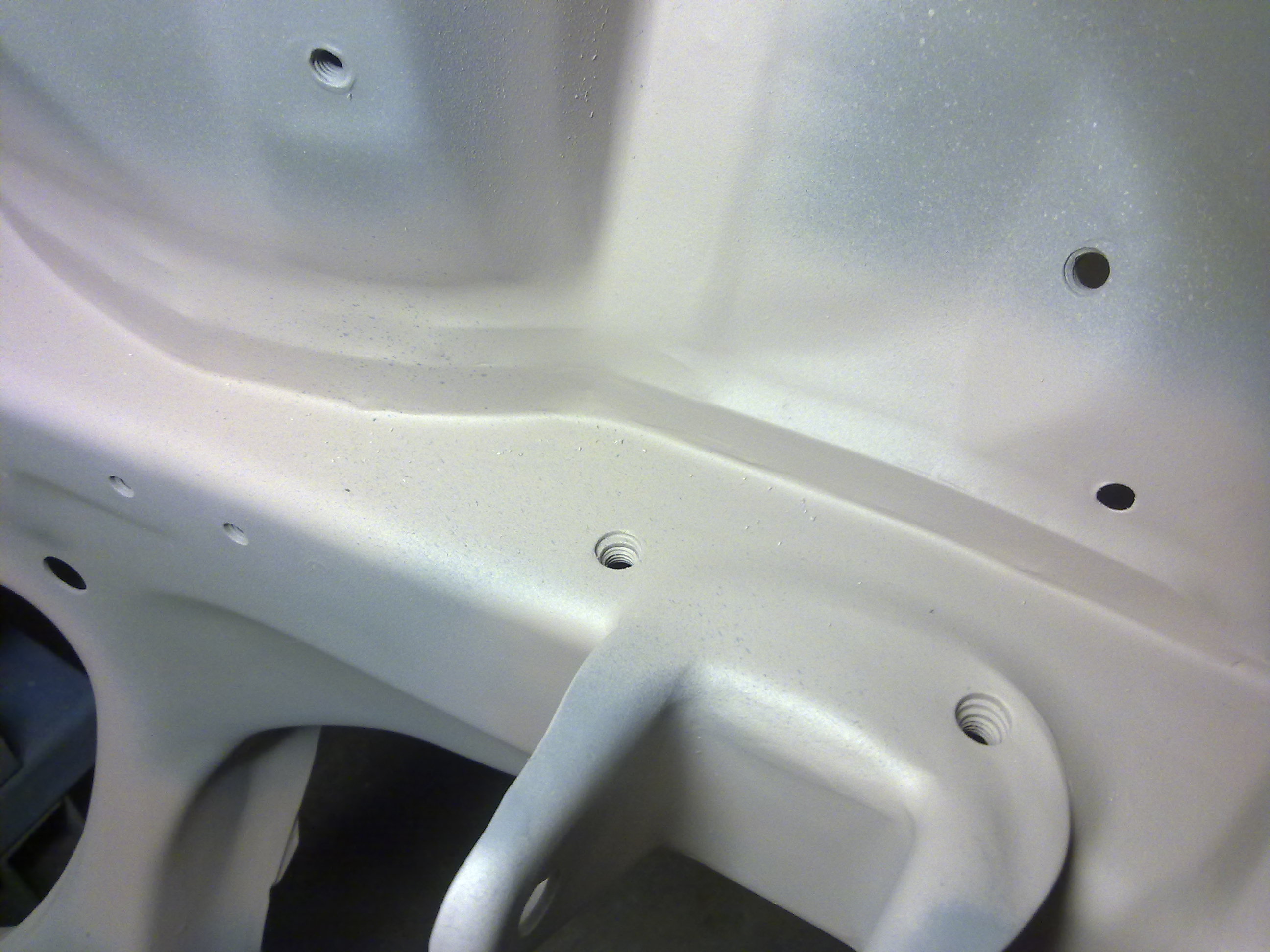

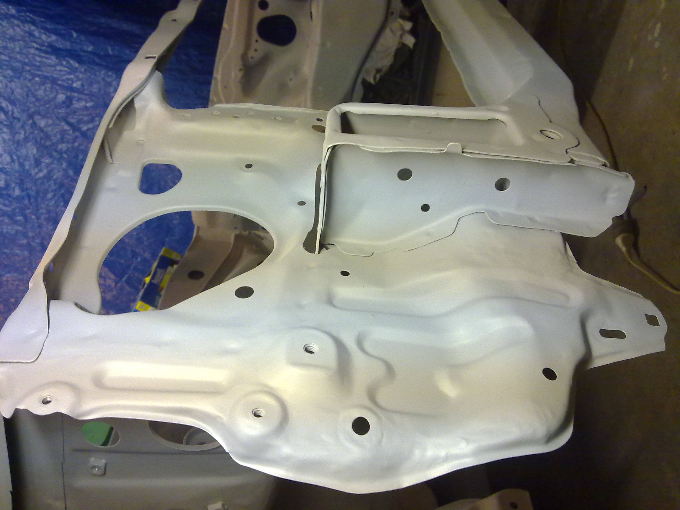

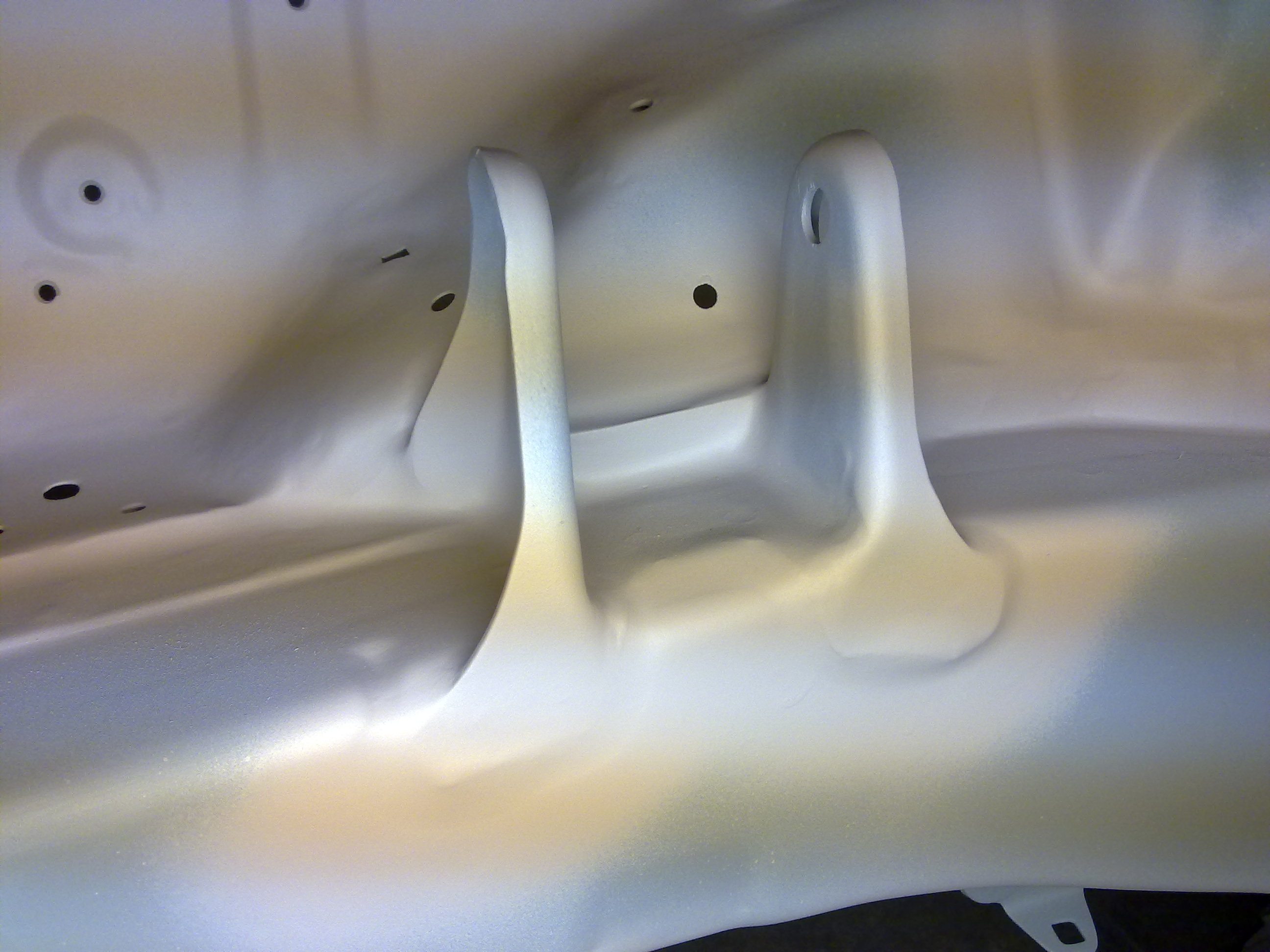

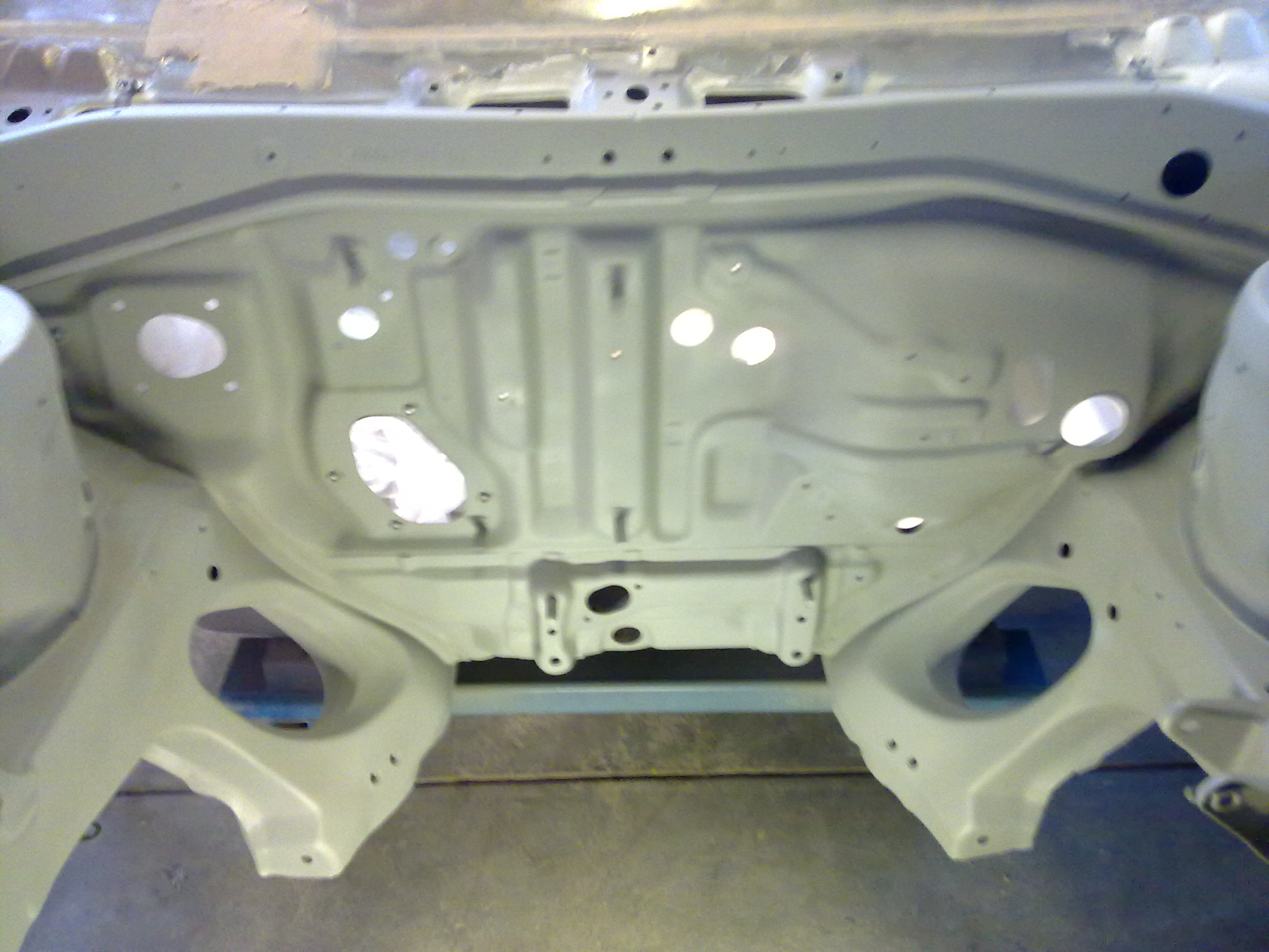

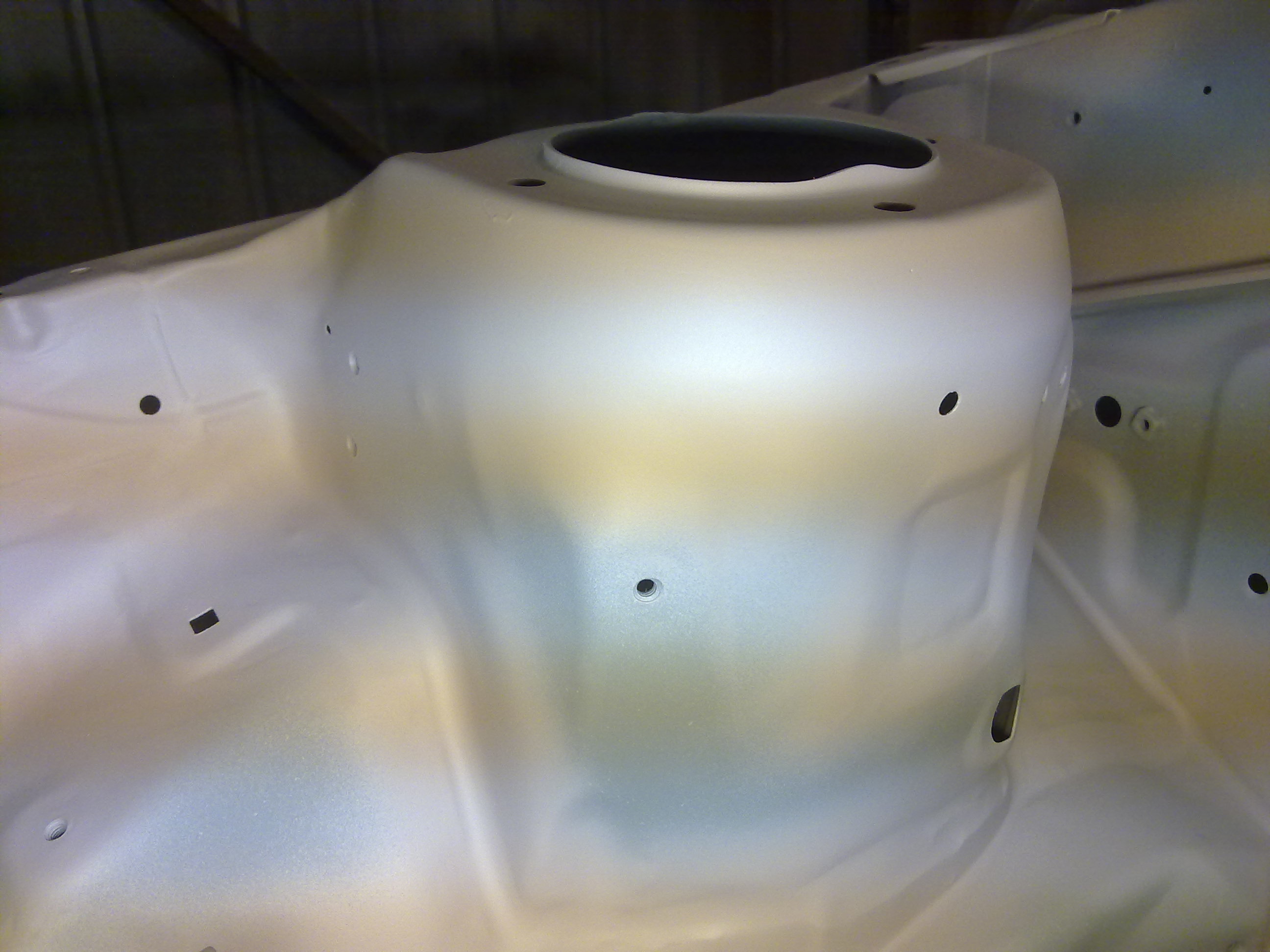

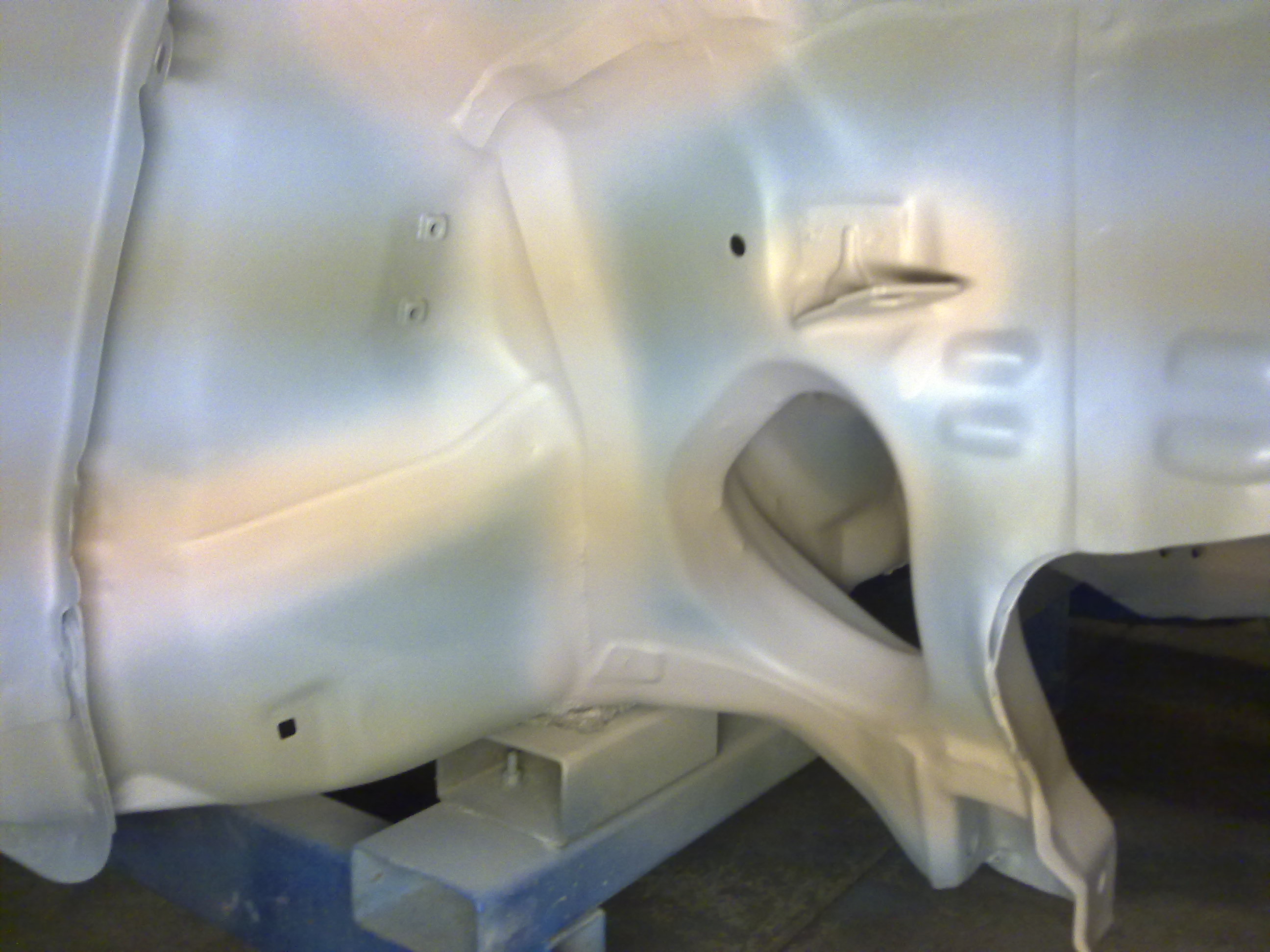

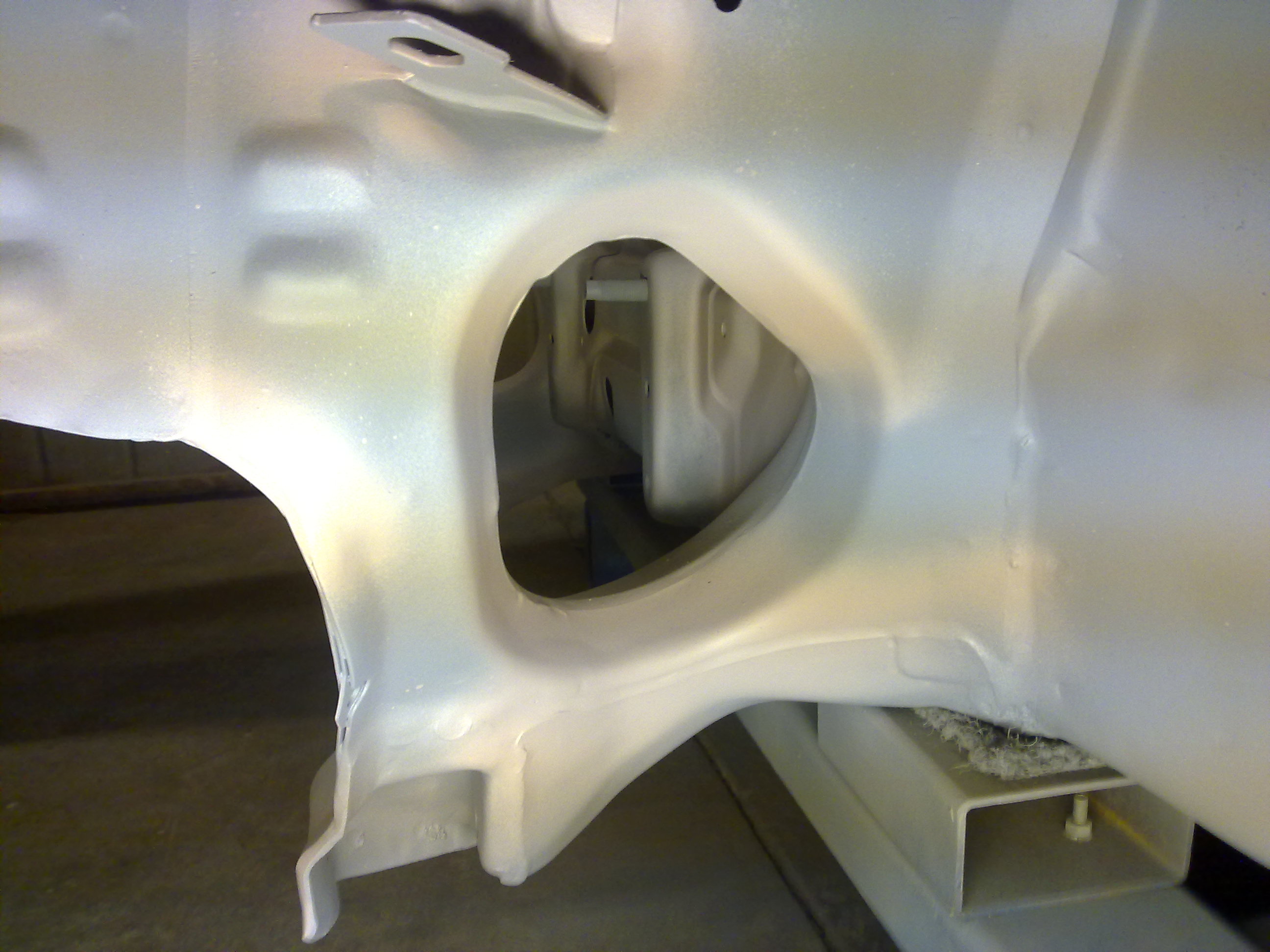

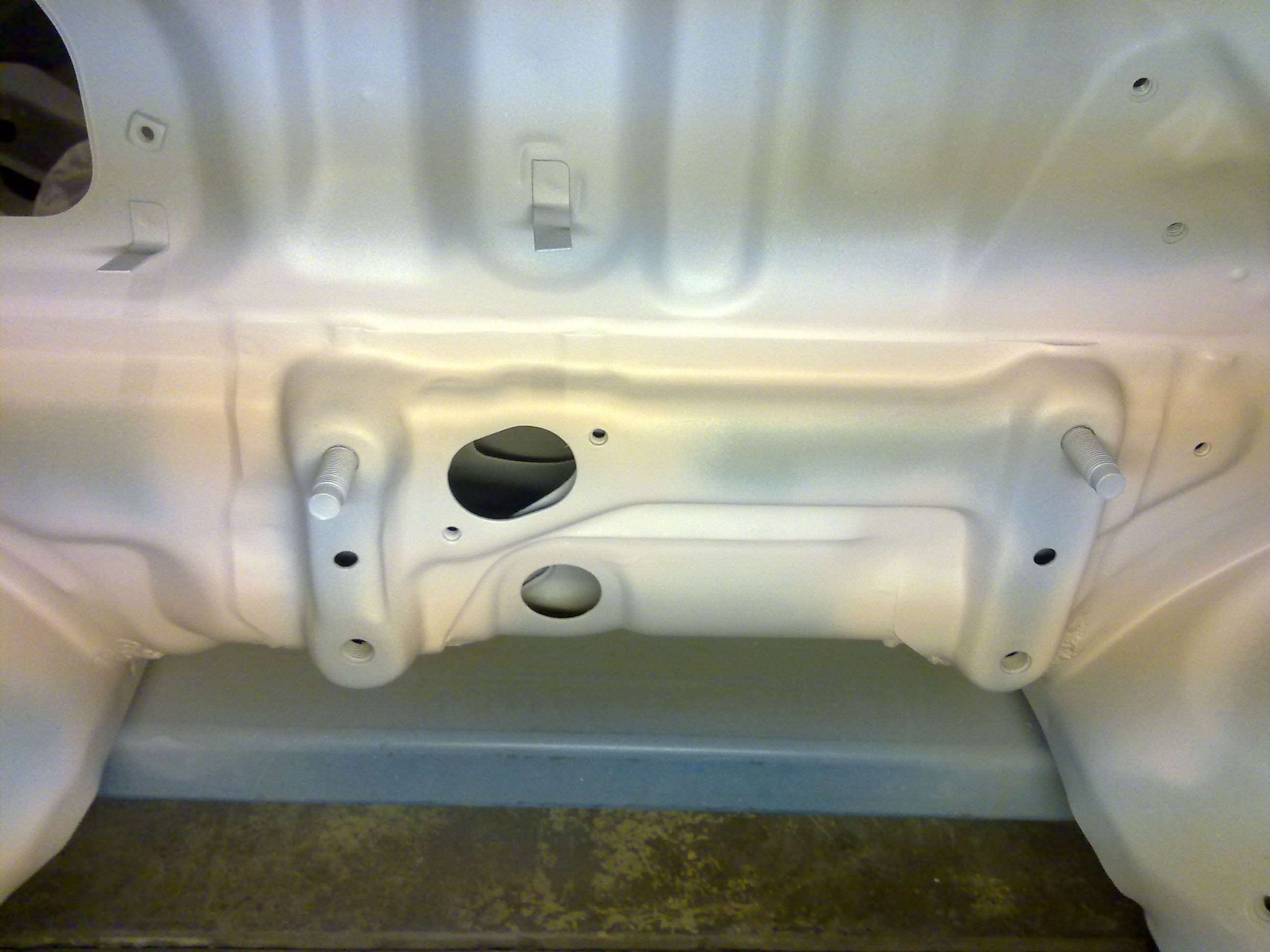

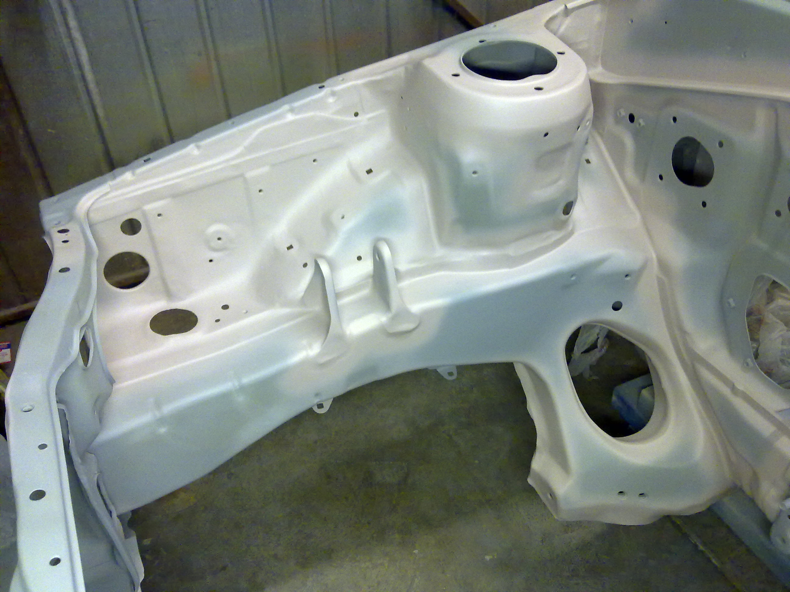

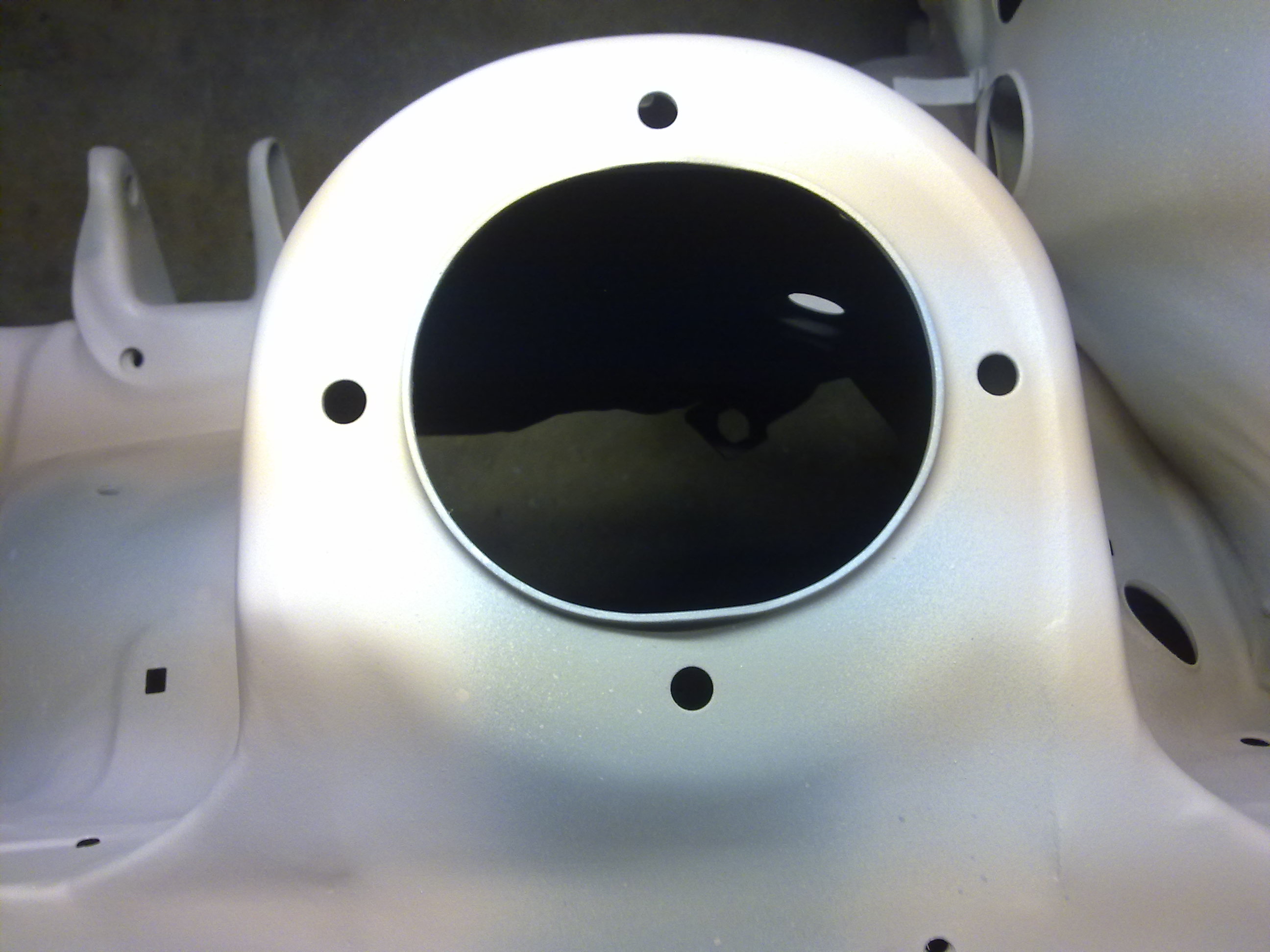

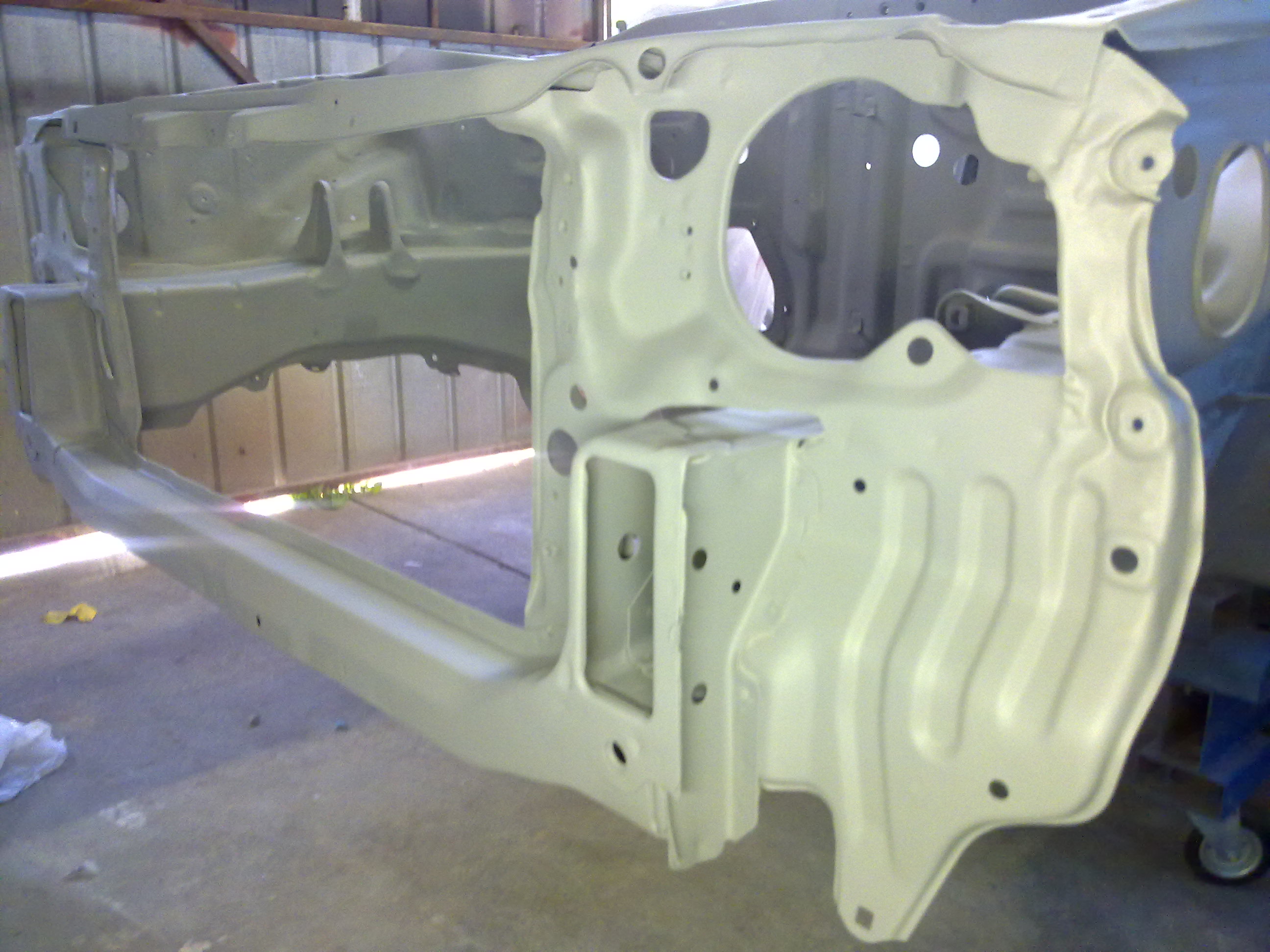

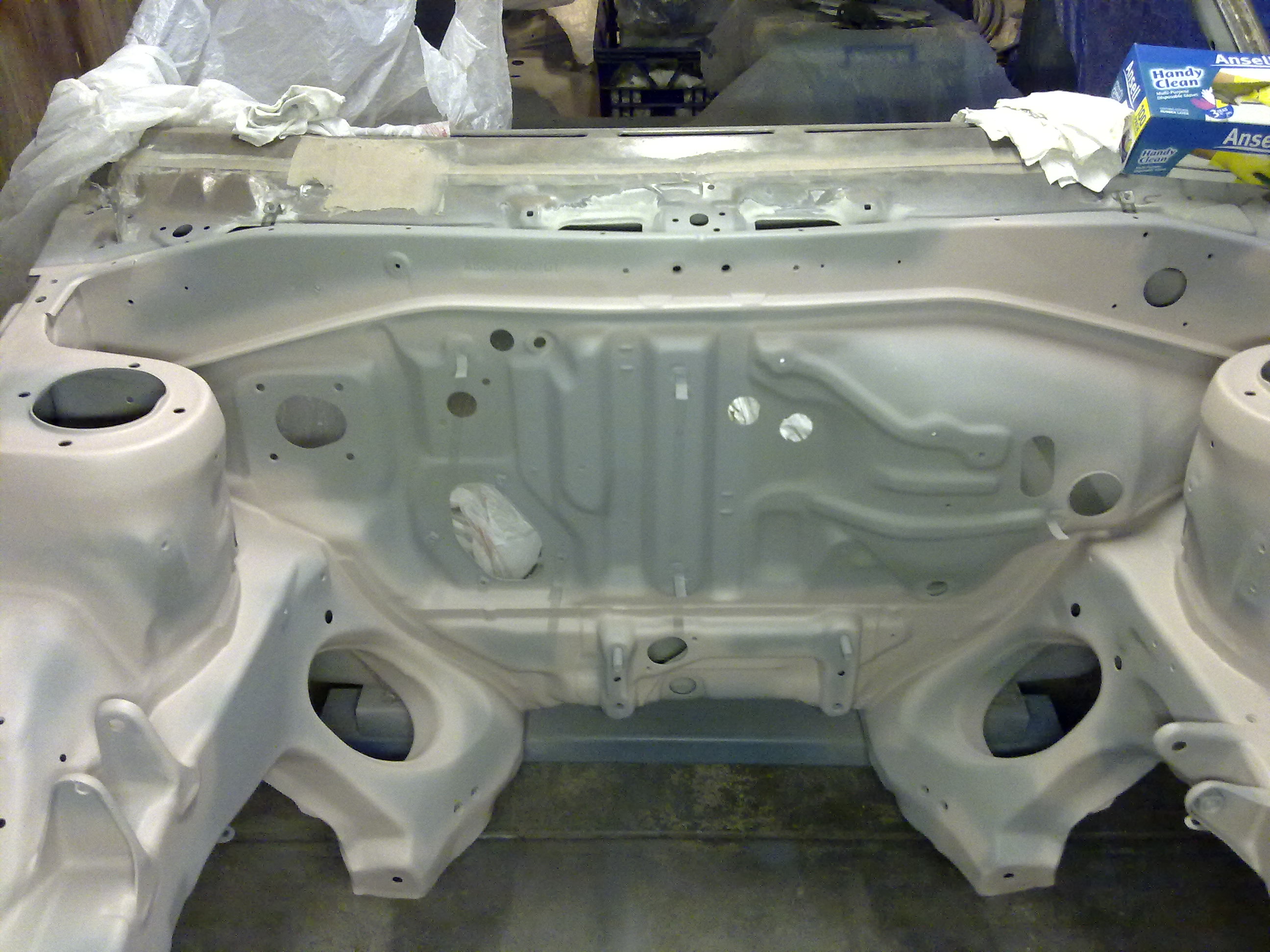

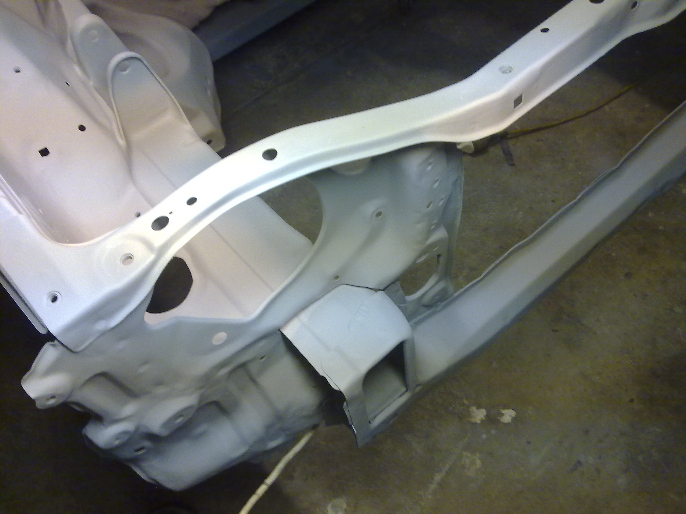

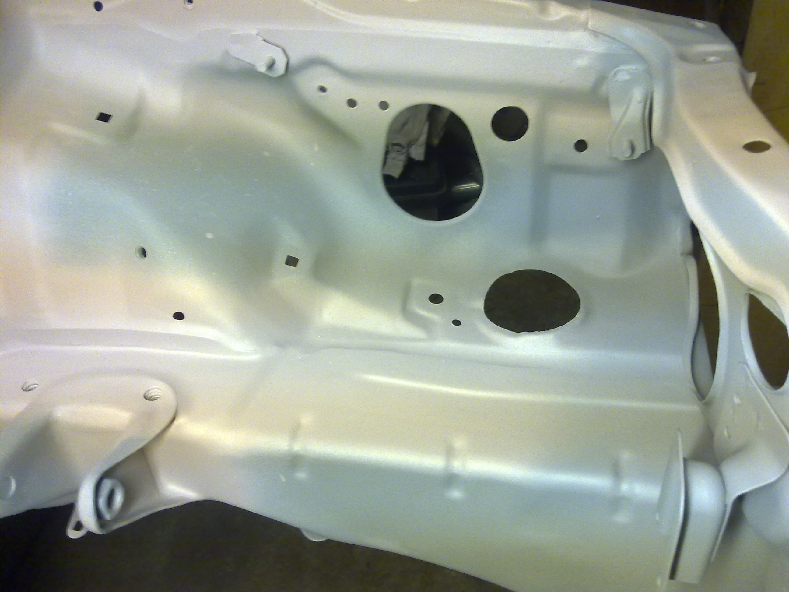

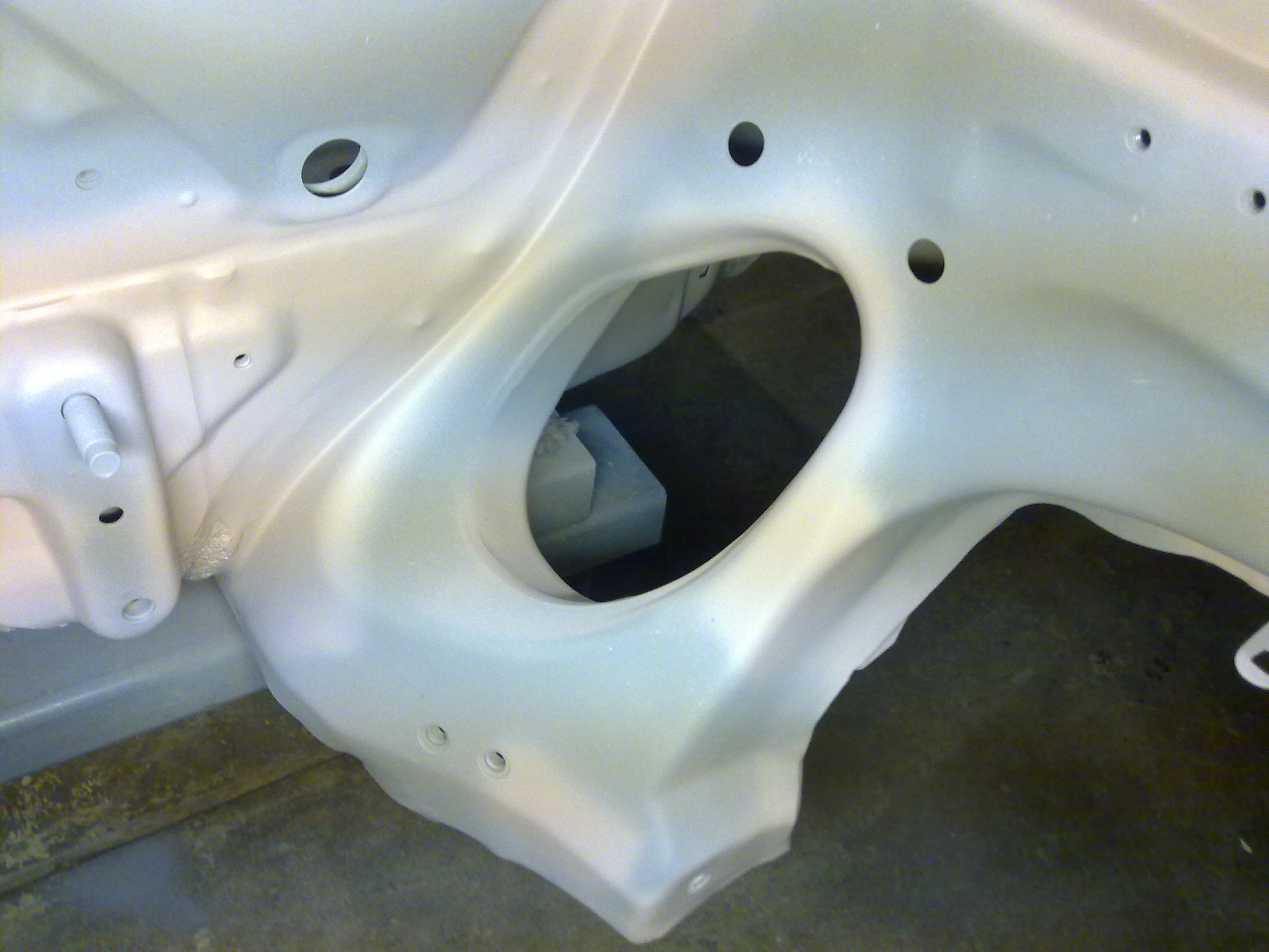

So here comes the good bits, I now have primer on the front end!!! :dance: :dance:

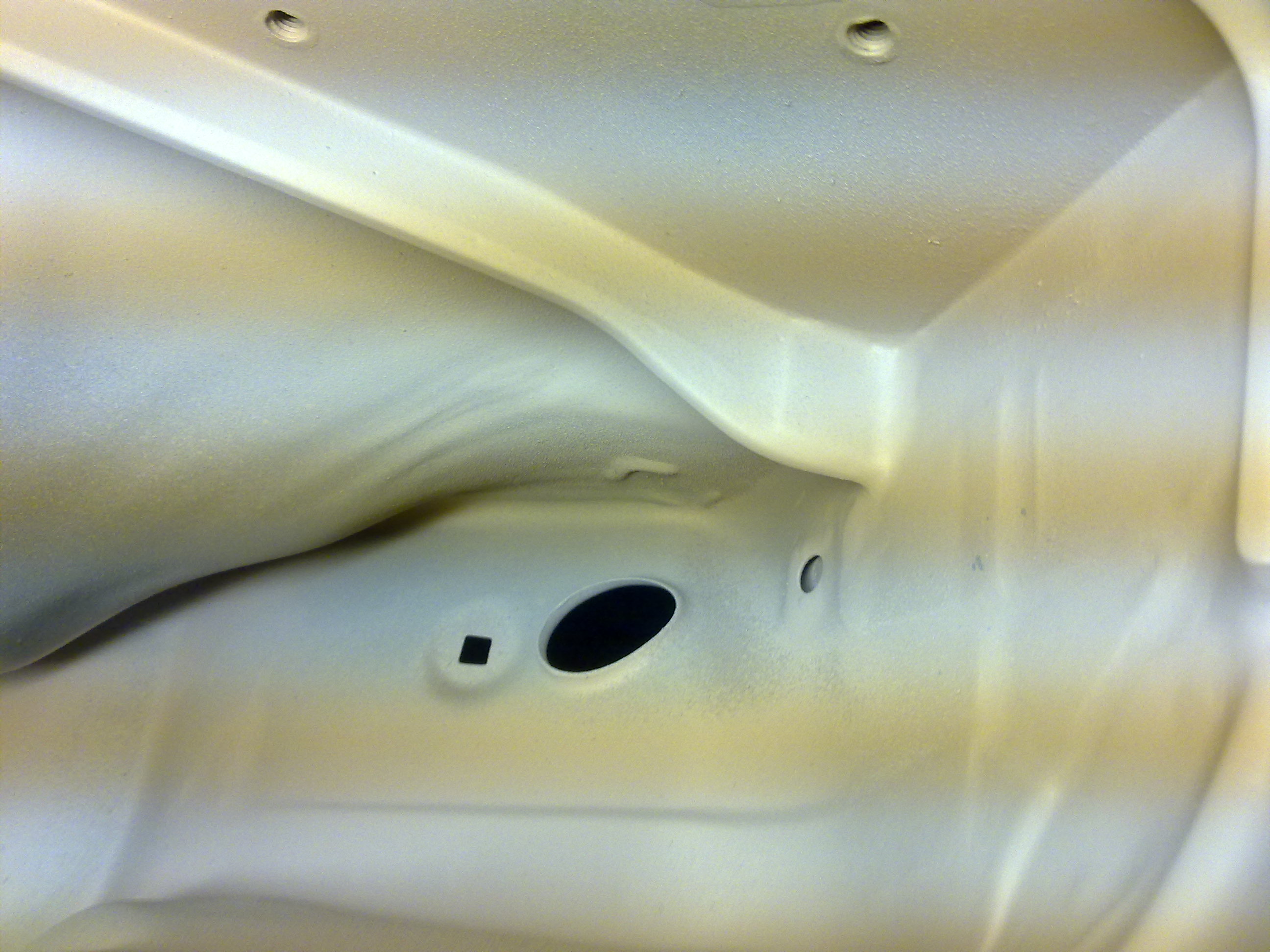

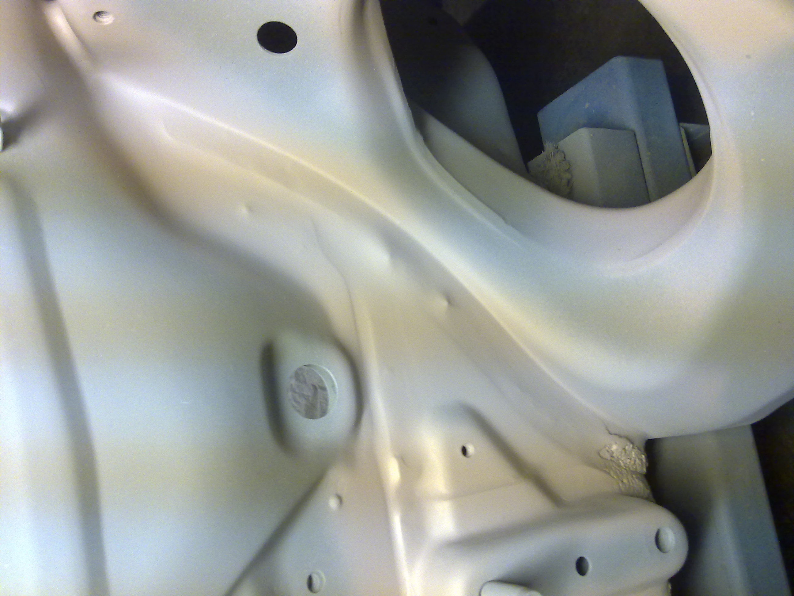

Upon closer inspection with a bright light the next day I had discovered that I had missed a few bits that were near impossible to get to with the spray gun I was using. :( So I spent the whole day scuffing up all these areas plus a few other areas I wasnt happy with, dusted it all off, washed it down & set about doing touch ups with both pressure pack primer & spray putty for the bits I felt needed a bit more meat.
Apologies for the strange appearance of these shots, the light I was using was flickering like a mofo!

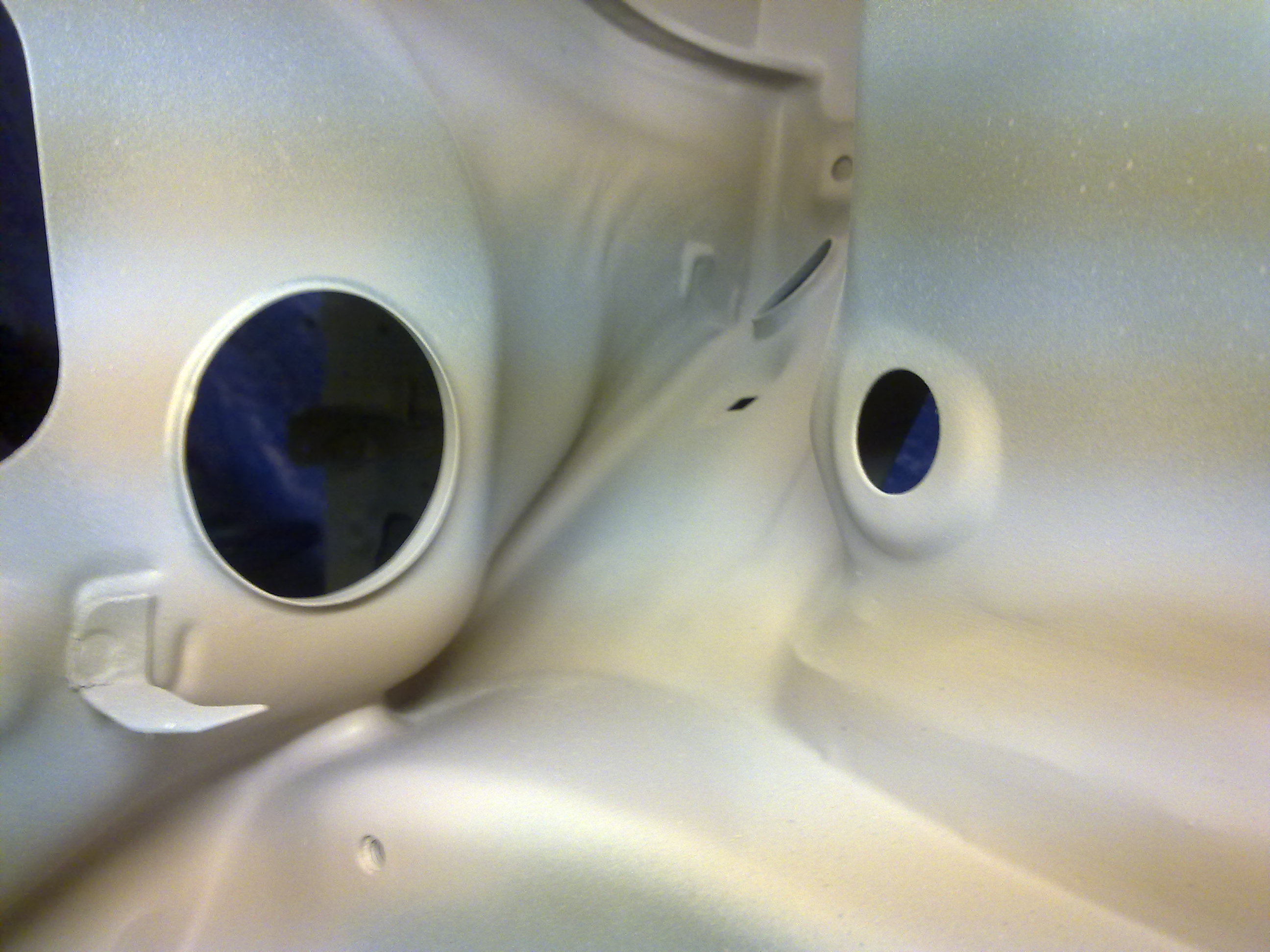

Ran out of upload space in the last post, continuing on here. By the by the greeny-grey is the orginal primer I sprayed, the grey stuff is the pressure pack primer for touch ups & the pink stuff is spray putty.

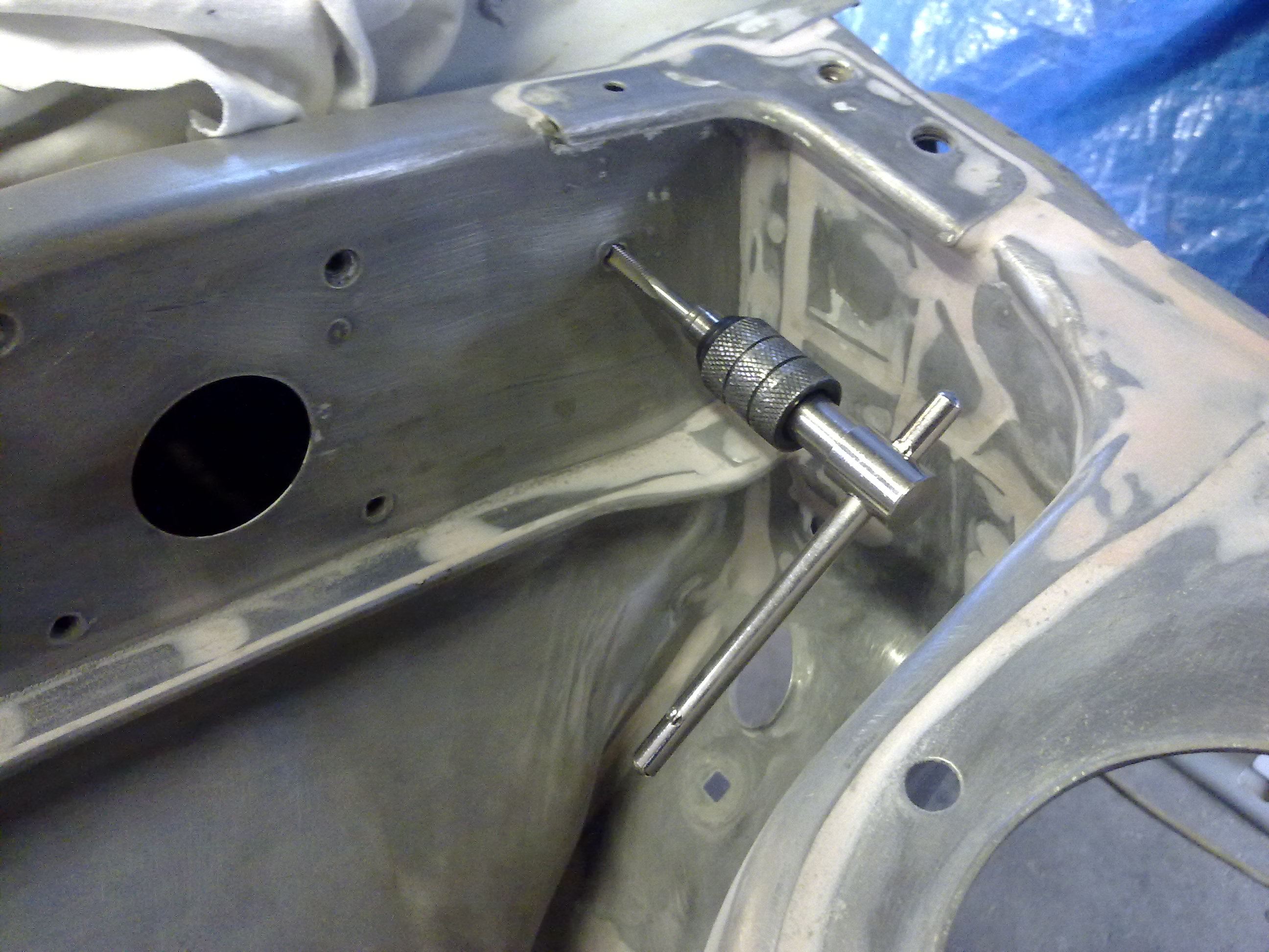

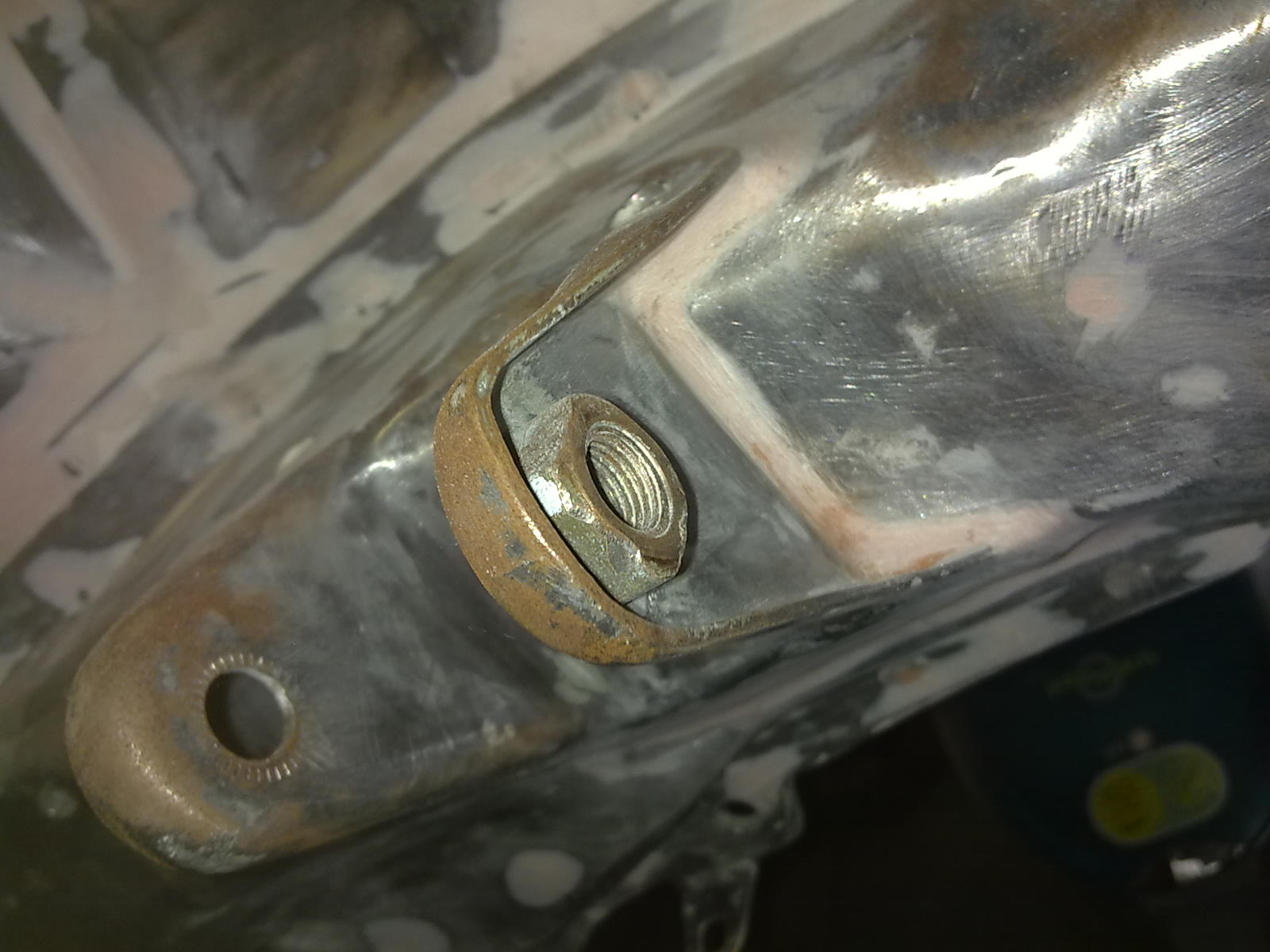

Oh yes can't forget, the time consuming job of running a tap through all the threads in the front end prior to primer. Using a small brush to solvent wash them out was fun too!

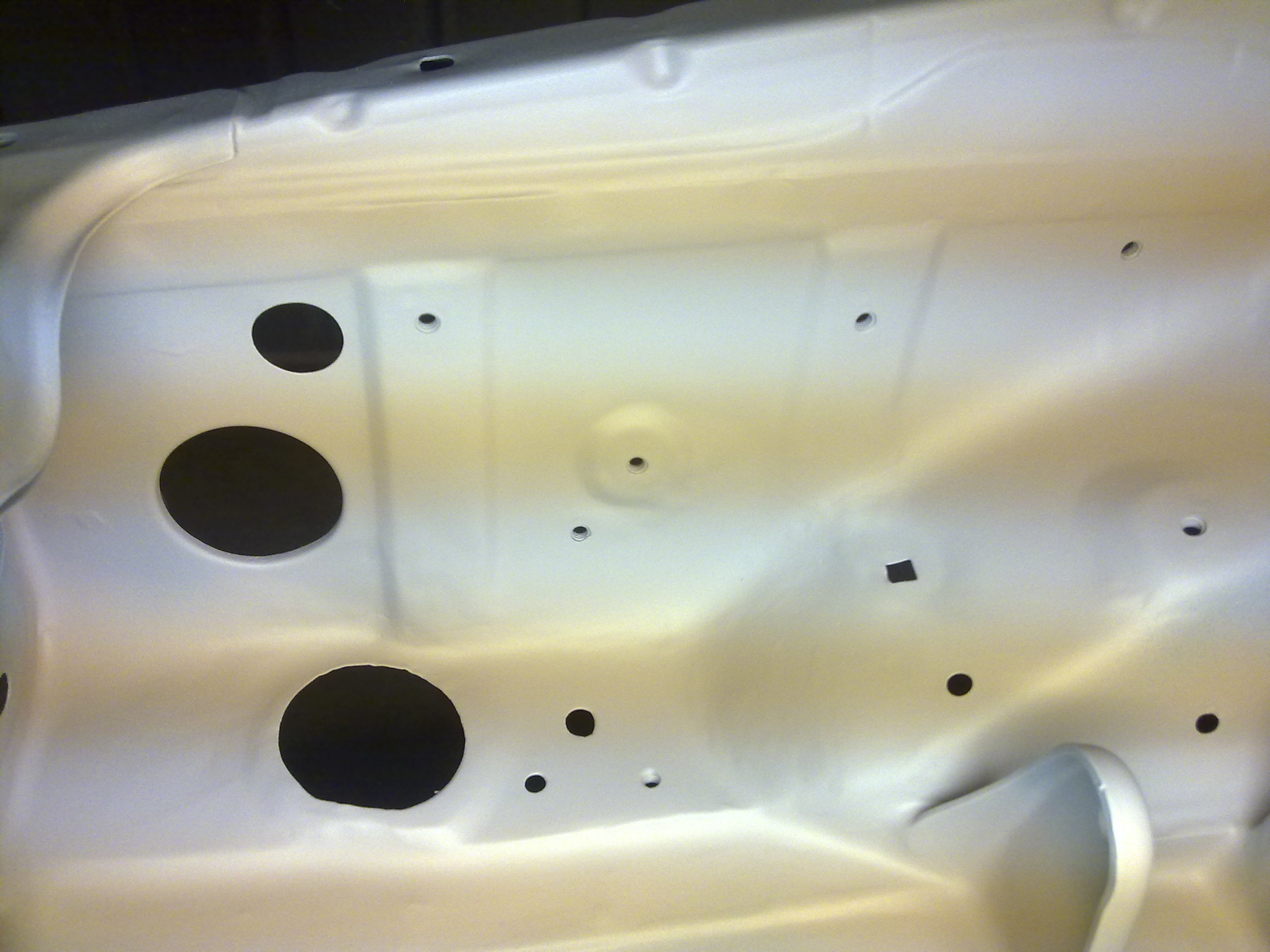

I figured that I was gonna be doing a lot of staring at the engine bay in the near future so I may as well make it pretty... :lolcry:
