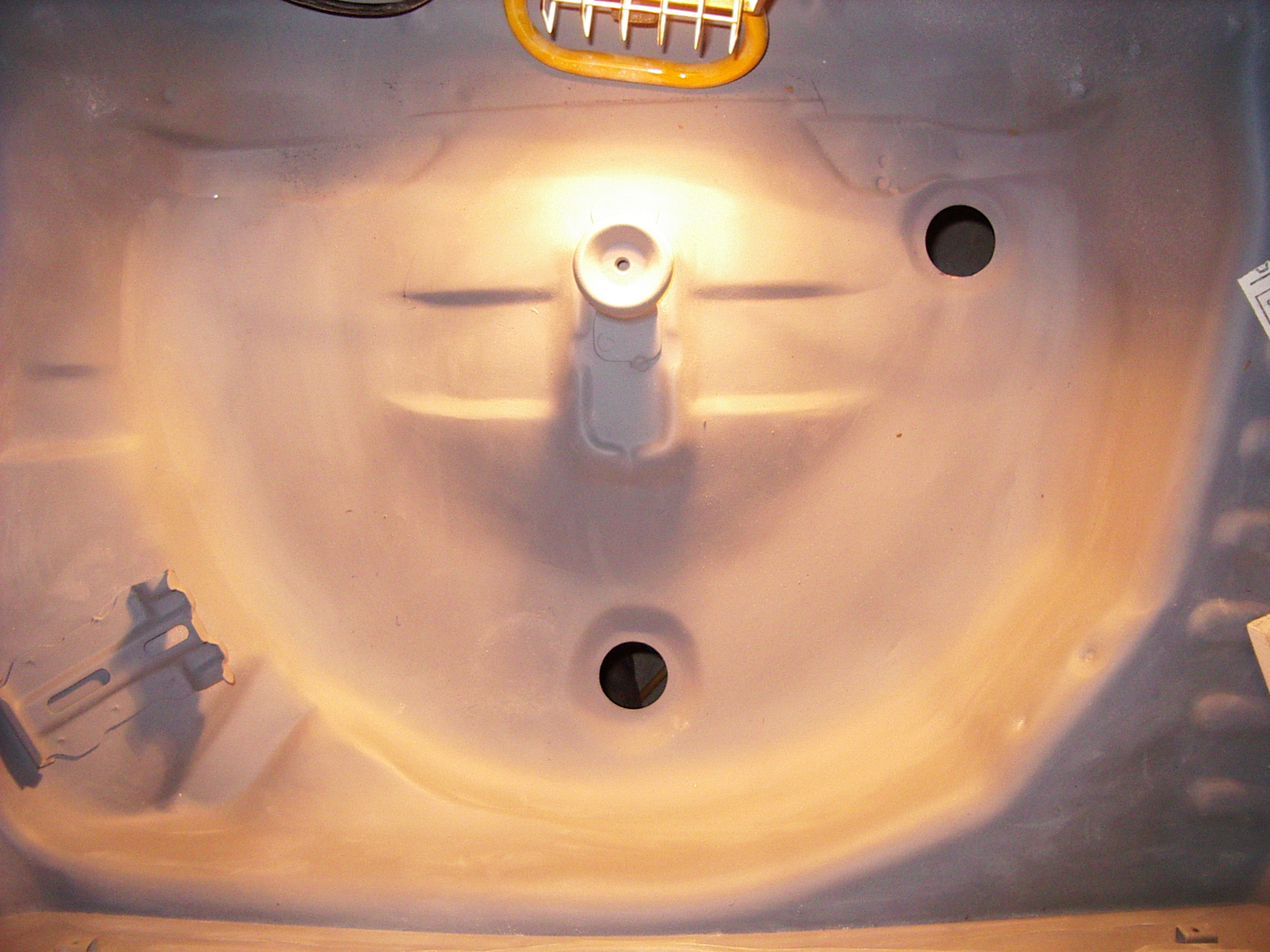

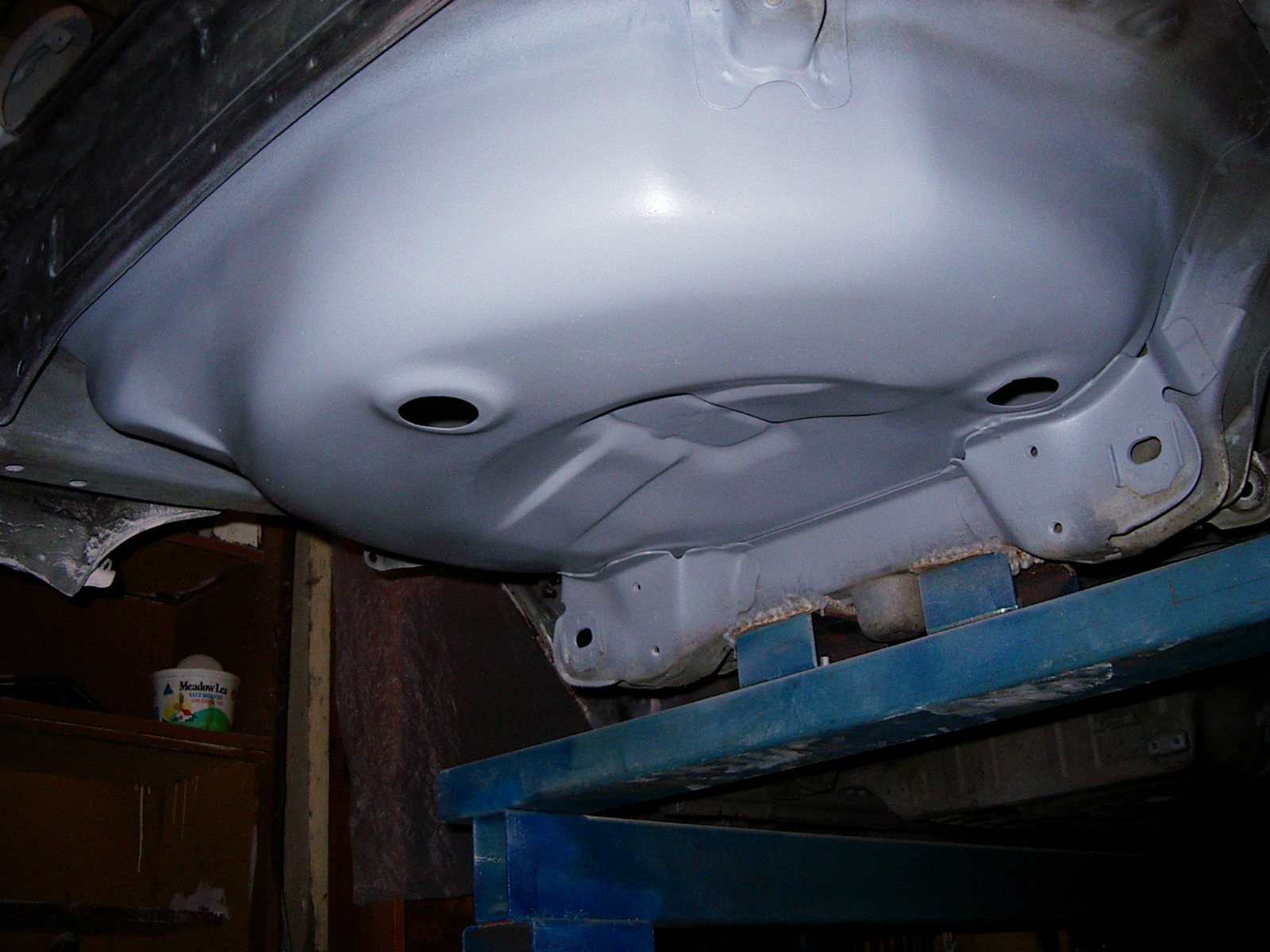

So I got into the shed, unrolled the faithful camping mat to keep the body happy, slapped on the dustmask/goggles & went-a-sanding...
I wasnt happy with the shape/feel of it, so I roughed up all the unsanded spots & bogged again :(
Backs to sanding again.
I <3 bog dust :no2:
After the first round of shaping, it was looking like this :)
After the next lot of sanding to smooth things out a bit, it looked like this.
Then after a dust off/wash down & one coat of primer, it looks like this.
Finally after another two coats, it looks like this :yes:
Wow... that looks absolutely perfect! Pity no one really looks at wheel wells, I'll try and remember to if I ever get to see your car :lol:
When it's in the water only the fishes will see it, but that didnt stop me painting my boat in the image of Darth Mauls (Star Wars) face :lol: Thanks man! :y: If it were to be inspected for RWC & there was this big, ugly, mangled-looking repaired section questions might be asked. If it looks like nothing ever happened here, mission objective completed :wink:
A few pinholes to fill here & there but all good otherwise. Think of this as my practice for the sunroof section :yes:

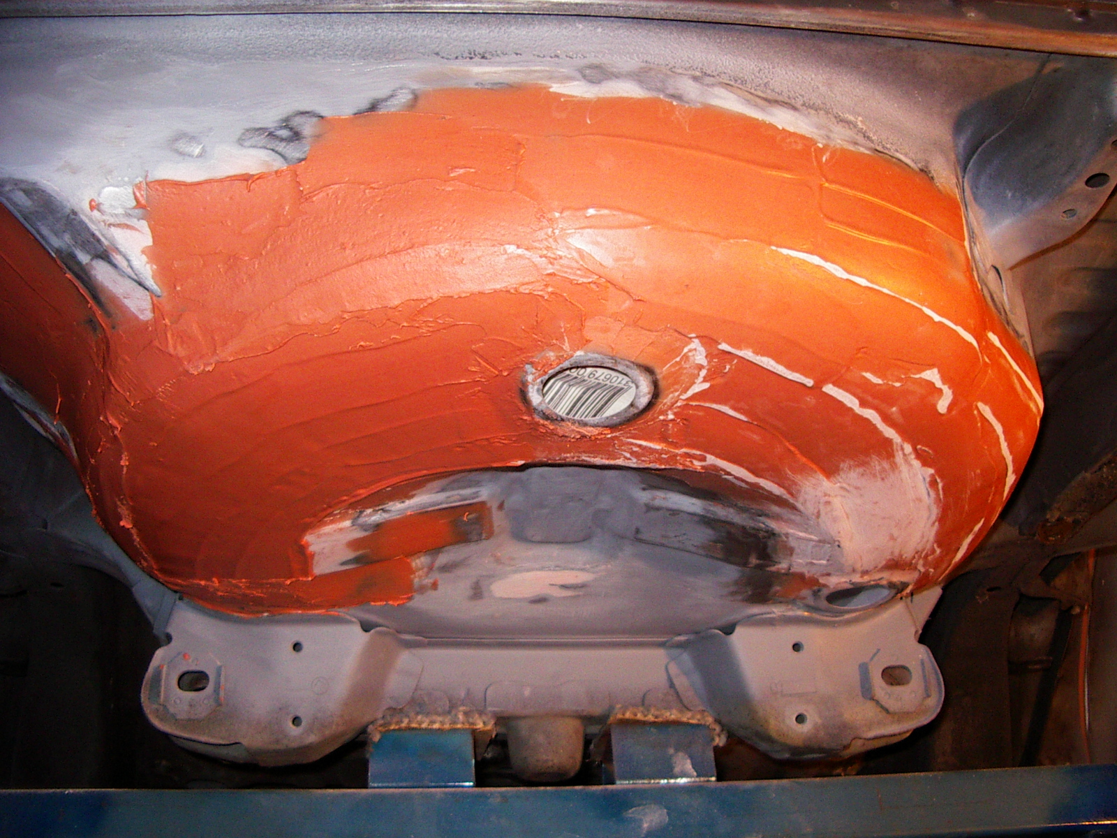

Okay, I know it's a wheel tub, but... I wasnt happy with how the flat sections going from the centre to the sides looked in the light/shadows :( It gave away that the shape wasnt quite right.
Also wasnt happy with the feel of the curve from horizontal to vertical at the rear, so gave that a sand too.
Determined I didnt like the rest of it either :wink:
Please excuse my scribblings if you notice small pencil marks, they were my notes on what was needed & where.
Previously mentioned pinholes, darn air entrapment!
Some primer to cover bare metal.
Then some spray putty where needed.
I had intentions of doing some minor bog work, however it was late & not to sound soft but, F-ING COLD last night :( The little electric heater I had did virtually nothing so gave up when I realised I couldnt feel my hands or feet.

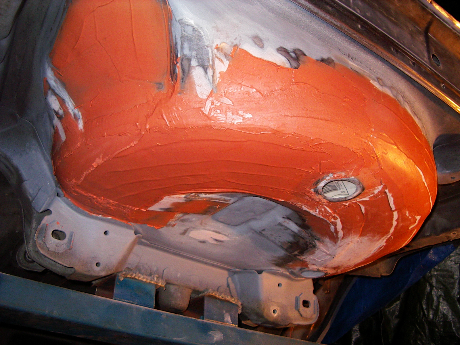

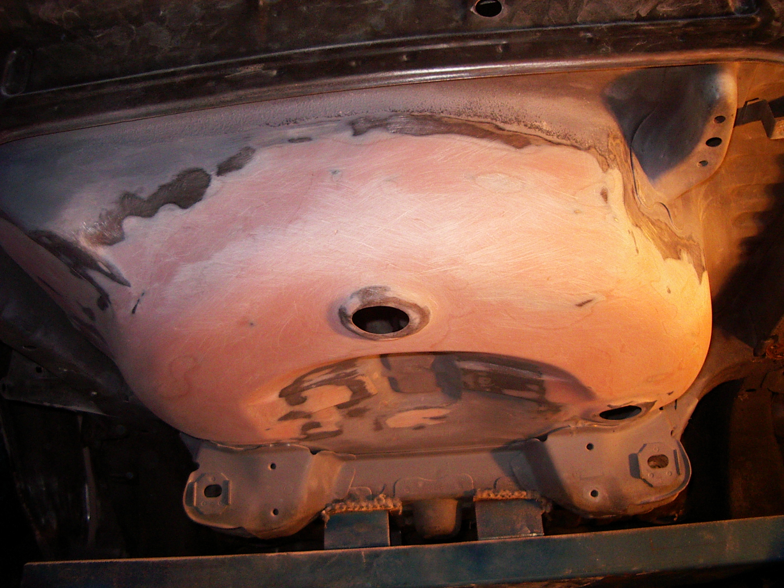

Back in the wheel tub I did me a 'lil sanding...didnt like the feel of it all :hmm:
(same shot, just with/without flash, differences in lighting can help show up what I'm chasing after)
Somebody hide the damn filler can! :lol: *Note the spot welds left un-bogged* :wink:
This kinda looks like my welding :laff:
Shaping, without & with flash.
Dusted off, washed down & gave the bare metal a shot of primer & some spray putty where needed. I had some bubbling of the primer near the rear, possibly contamination, possibly vapour bubbles from me spraying too much primer at once. Fixed now either way :yes:
With/without flash.
It was late, it was cold, I'd had enough for the night. :P
