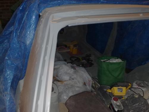

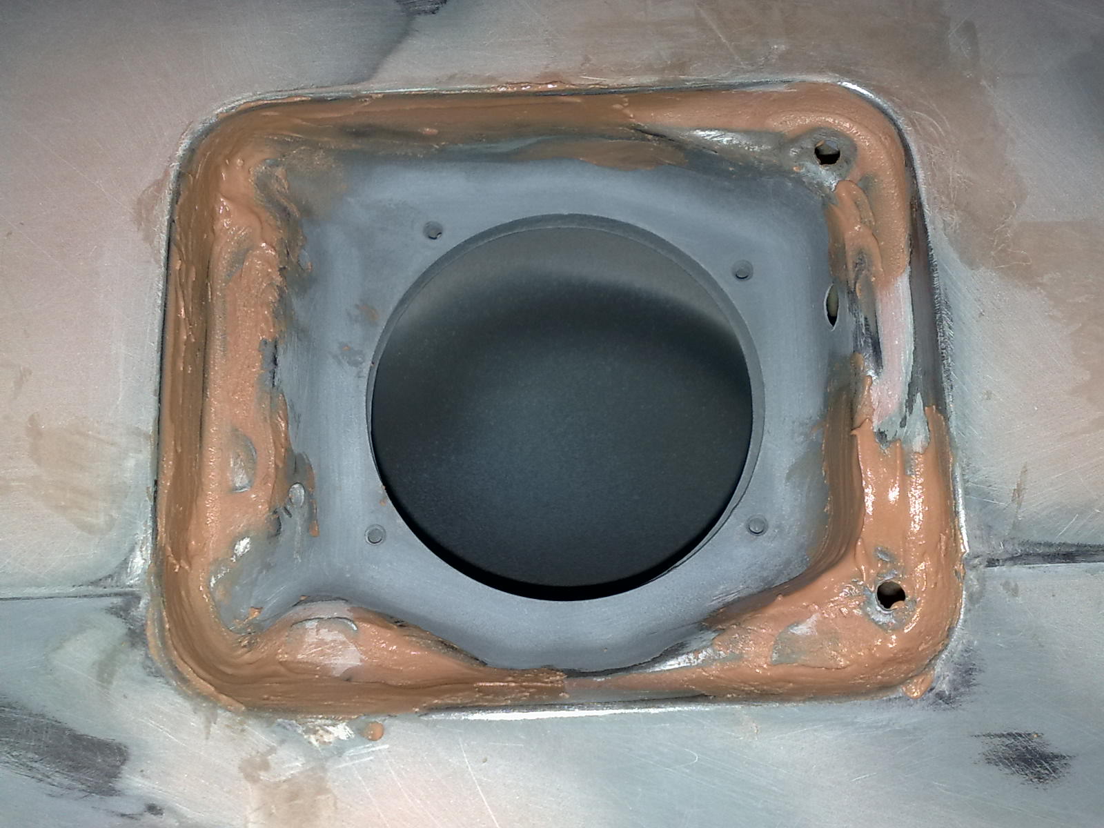

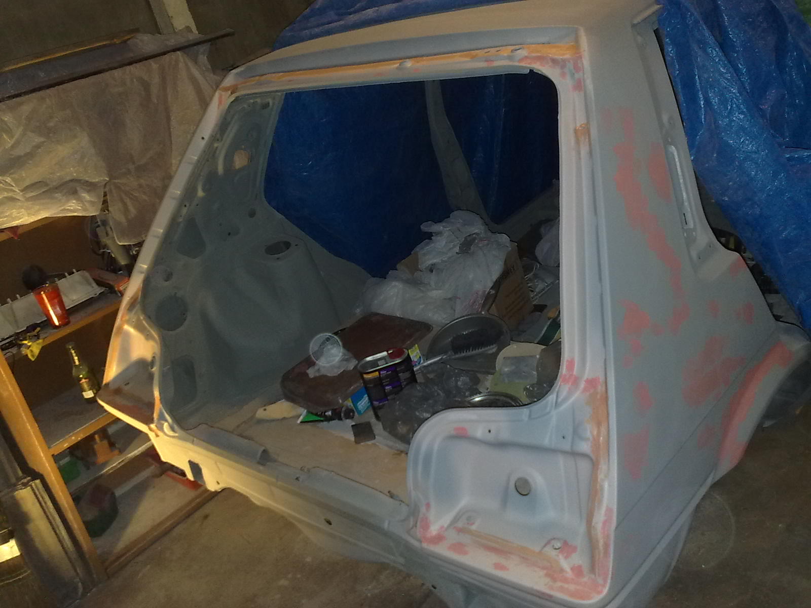

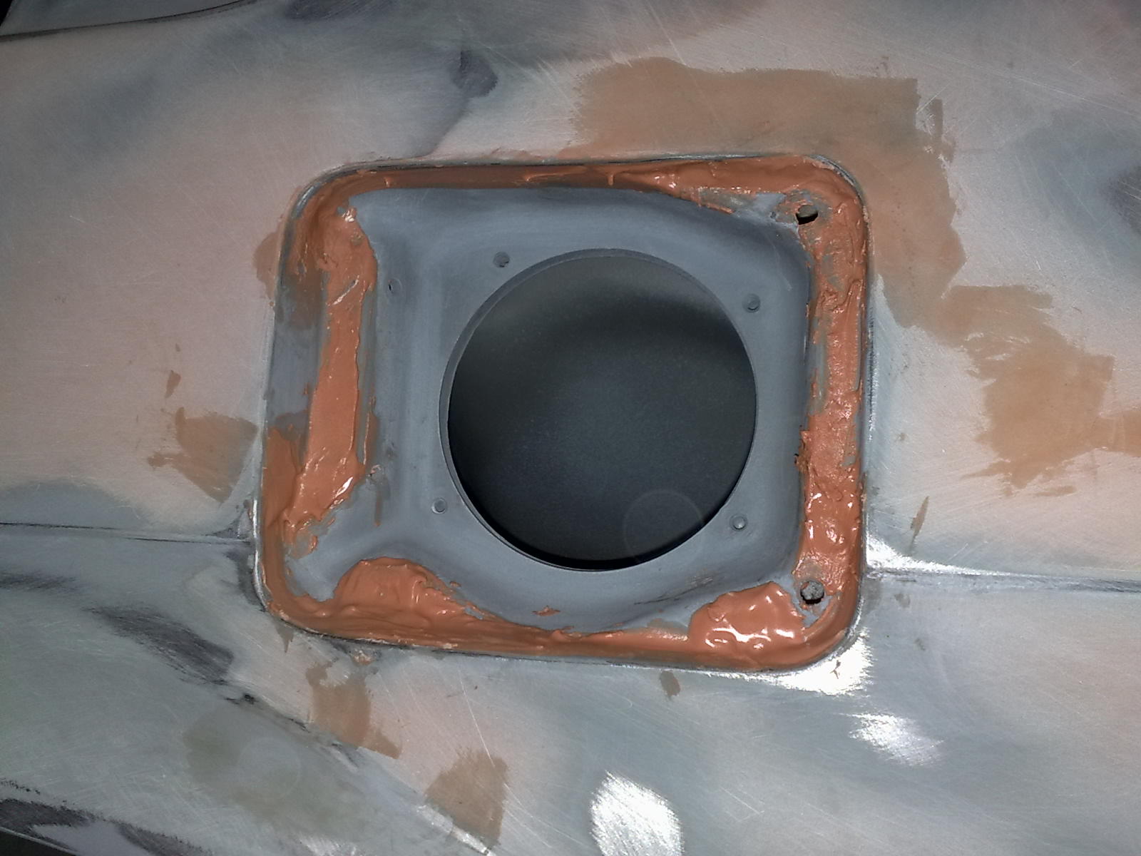

Wasnt happy with how things turned out with the hatch area, so some sanding & washing took place. Then some bogging took place, a combination of bog & blade putty (seperatly of course!).

All sanded, bloody sore hands again! If this is bad, arthritis must be a real bitch! :(
All primered.
Some spray putty in areas as well for good measure.
Started sanding the passenger side quarter panel.
Change sandpaper grit.
Finer grit again.

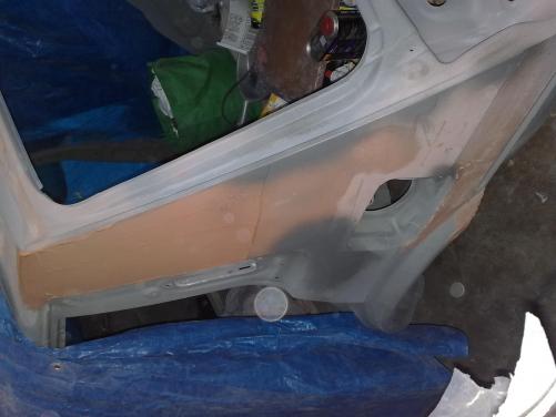

Get to this point.....& I'm not happy with it...

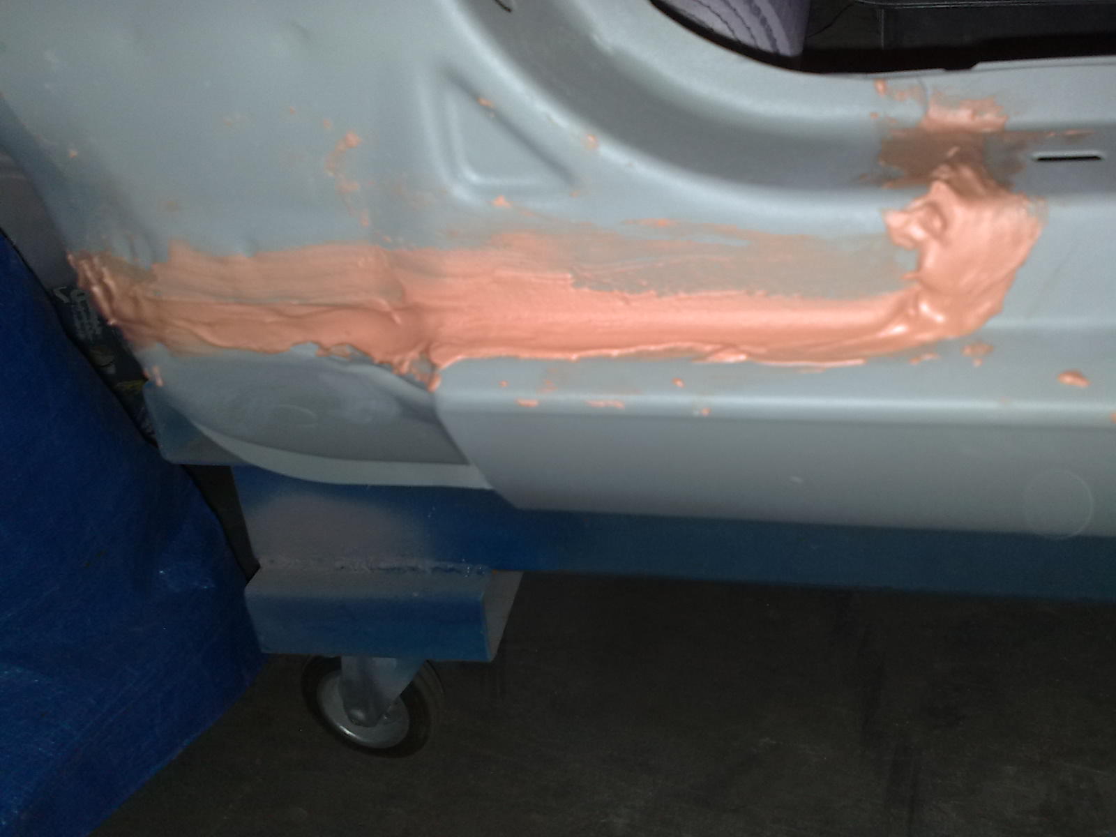

So bog this much again & hit the bare metal patches with primer.
Drive to Ballarat, drop some parts off, drive back, scuff up the shiny bits & finish bog work. :)
Blocked back all the spot-fills on the drivers side.
Sand all of back, dust, wash & a hit of primer.
Then some spray putty to make sure I havent left scratches behind unfilled.
I don't mind doing this section-by-section style, it allows me to still make progress by doing what I happen to have the time to do on the day. :)

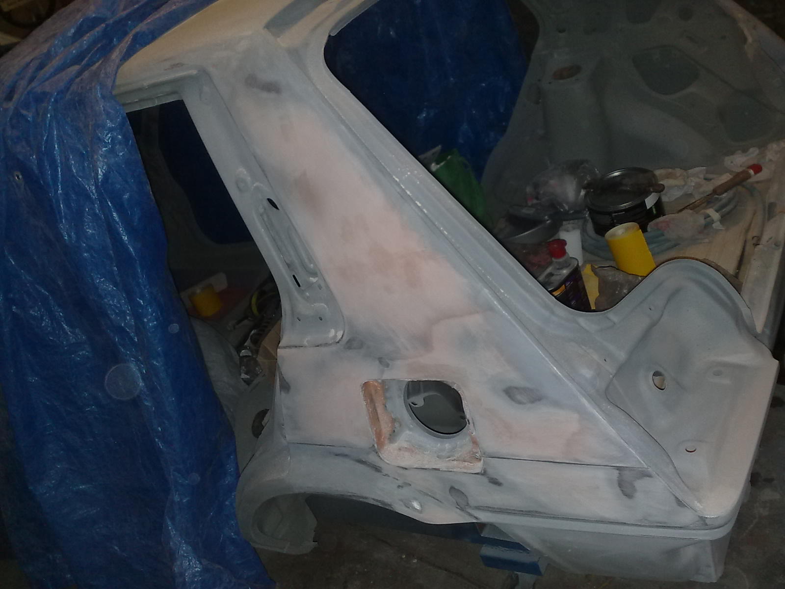

Yesterdays efforts, started sanding passenger side.
Still sanding.
Switch grit, keep sanding.
More sanding.
Nearly forgot about this bit here... :lol:
Dusted off, washed down, no time to finish it last night. :(
So I just hit the bare metal bits with primer to look after themn until I can get back to finish it.

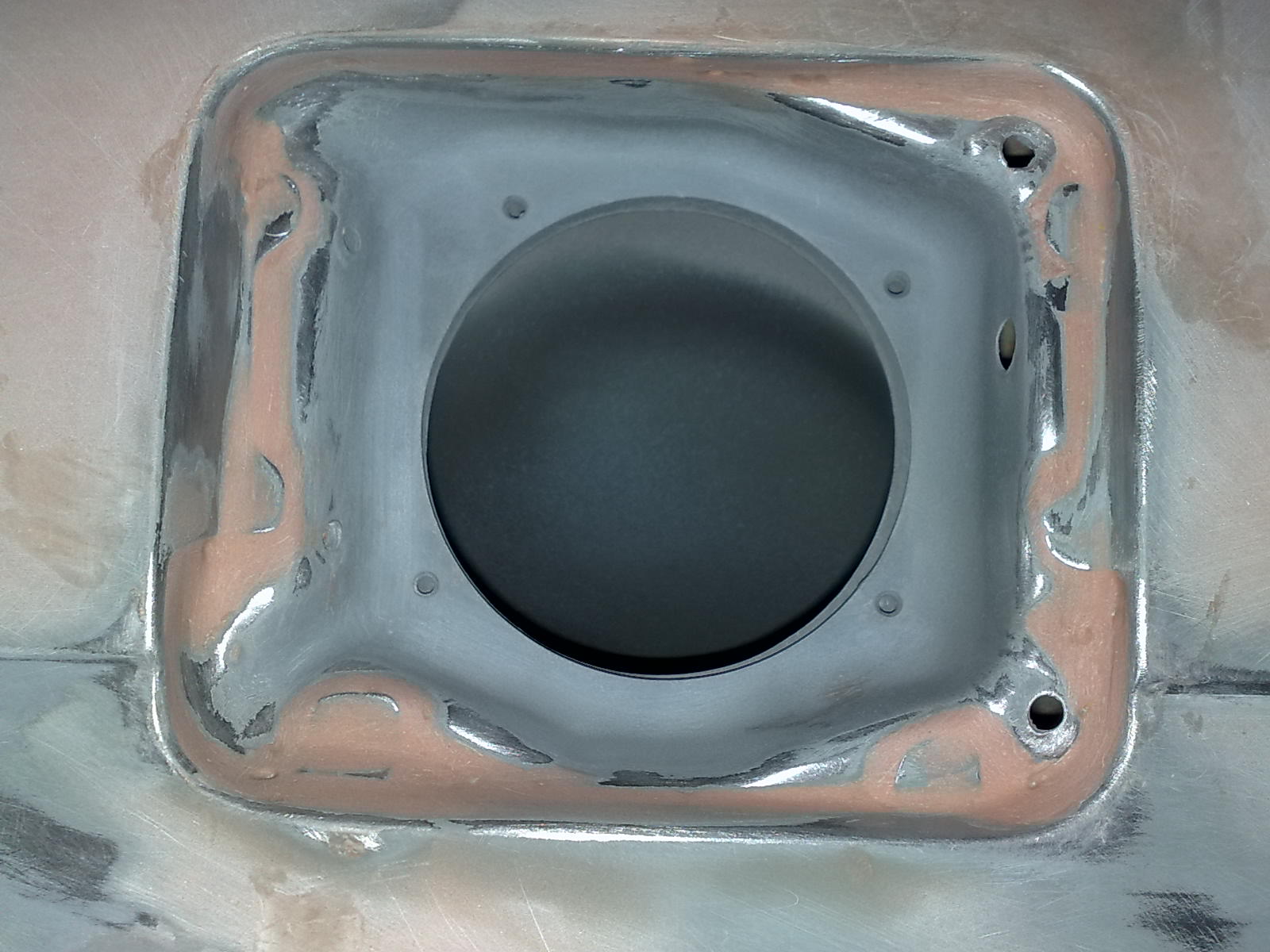

No idea how I managed to get the time to do this but, progress! :yes:
Sand it back so I was happy with it.
Spotfill & *ahem* "neaten up". :blush:
Sanded.
Spotfilled.

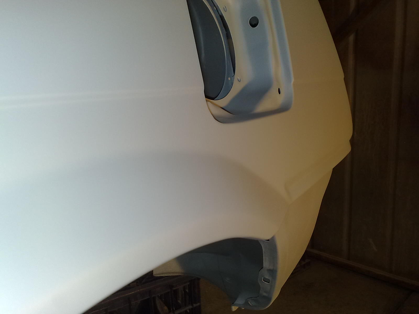

All sanded.
Dusted off, washed & ready to roll.
Primer! :)
And a little bit of spray putty...
Okay, a lot of spray putty! :laff:

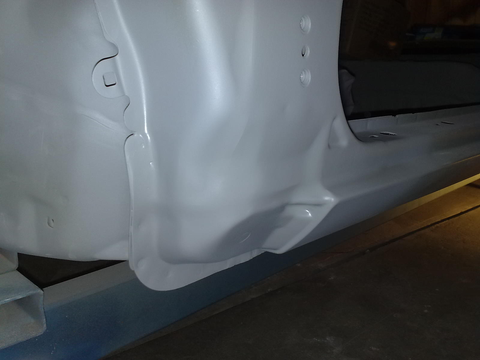

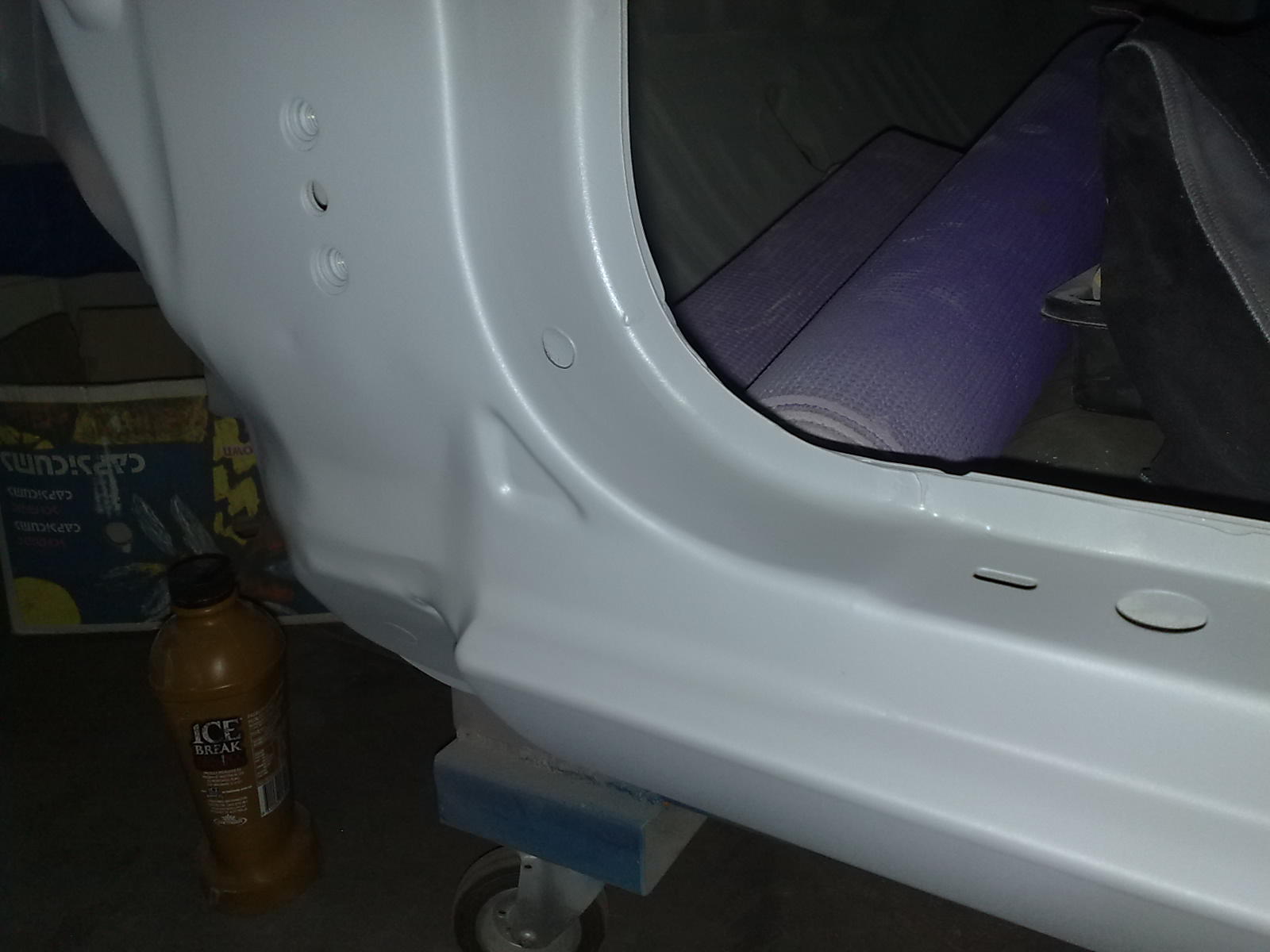

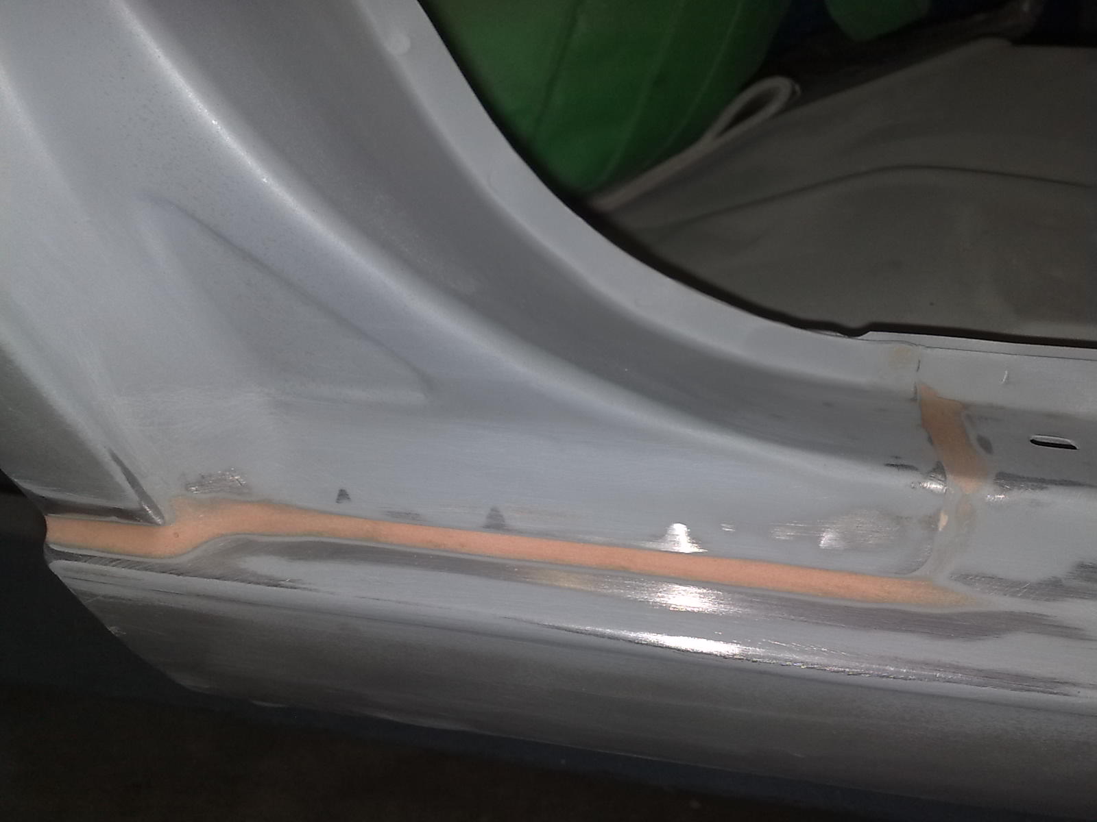

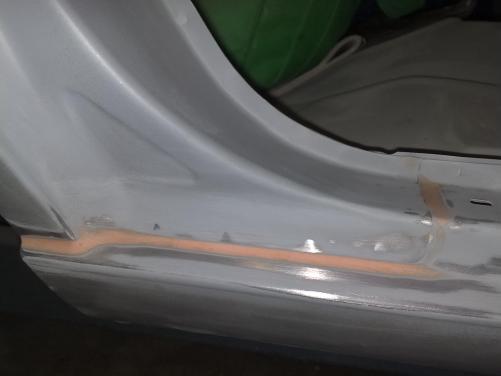

Anyways, back to the car... Got the passenger side lower door sill detailing sanded & spot filled.
All sanded & washed.
Edited by carbonboy
Now coated in a primer-like substance. :D
Complete with spray putty for the bogged bits.
Have to go back & touch up the drivers side of this, as I've compared the two & I've done a better job of the passenger side... :bash: :laff:
Then the upper areas & the bailey channels...possibly! :lol:
