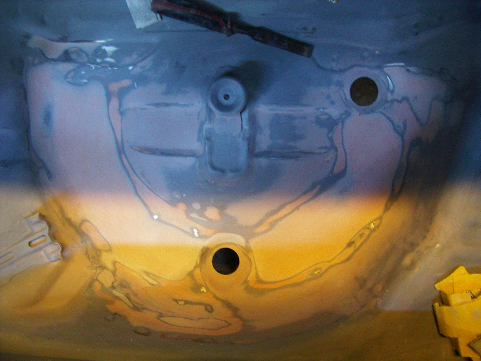

So I decided I wasnt happy with the section that needed some lovin'...mind you this was just as I was just about to dust off/wash down for primer :lol: Talk about your moments!
So I bogged it :)
After sanding for a bit, I bogged it again :D
Then bogged some more after the bit near it gave me the $h1ts :lolcry:

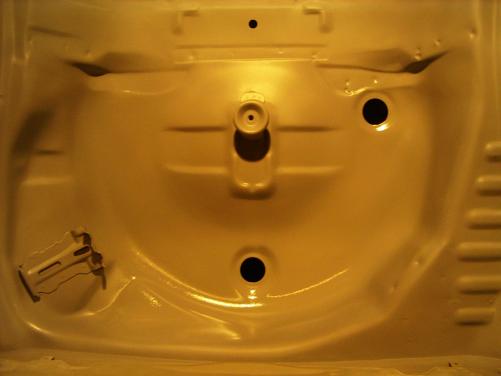

All dusted, washed with w&gr & ready for primer.
First coat of primer.
Fully primed.
So after this, it will be a quick sand, a shot of spray putty or some blade putty to fill some scratches/pinholes, sand that back then a final coat of primer to seal it all. Then I can move on! :yes:

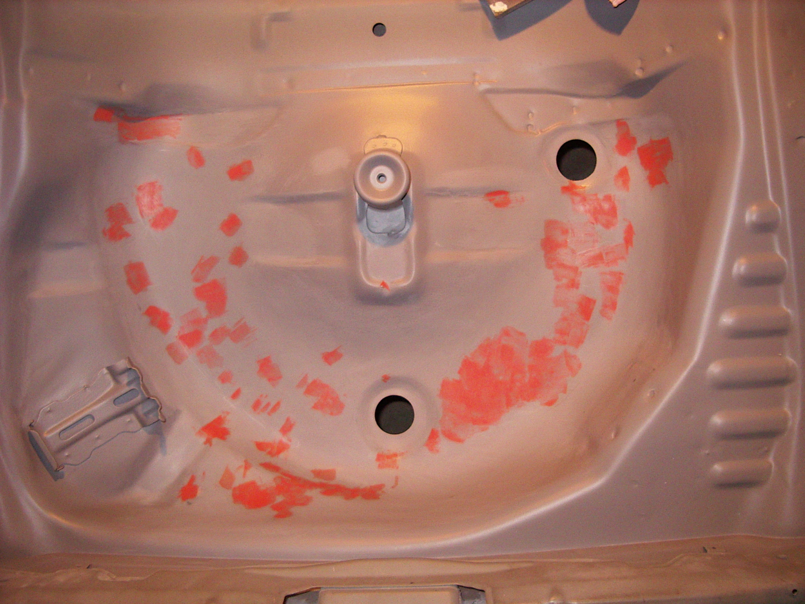

Sand back places that needed it.

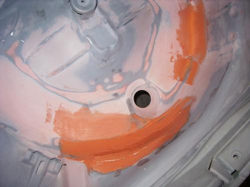

Apply blade putty.
Add spray putty for good measure.

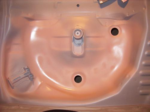

Go shopping, eat dinner, come back & sand, dust off & wash with w&gr.
Primer!! :D
