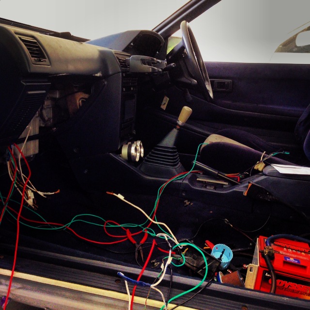

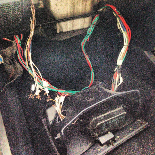

  2. No i haven't sorted it yet Tom, nor do i have many ideas. Every wire i extended checked out alright continuity wise. I didn't touch anything else. It'll be something simple i've overlooked, just get the time with a fresh young fella. You know how it is. Its the original car loom, not the engine loom. I moved the engine bay fuse box to the glovebox.

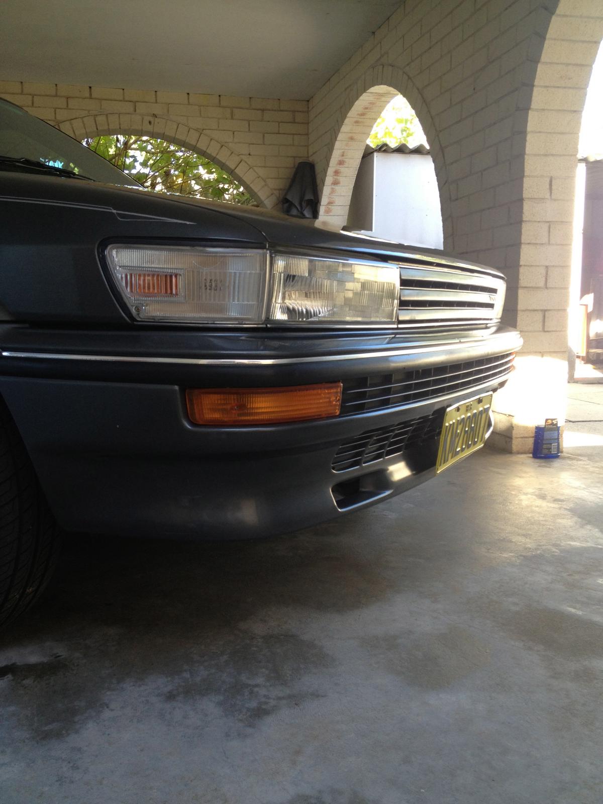

  3. Man. How you still have an undercarriage at all… If i was rocking half the width of an iPhone as a ride height, I would have been Fred Flintstone-ing years ago. Well played mate. I love it.
  4. Lads, are there any websites you know of that have a good array of wiring diagrams and possibly pin-outs?? I've messed something up and need some diagrams. Any advice appreciated. cheers.
  5. Anybody got any links to websites for toyota wiring diagrams and pin-outs and the like. I'm specifically looking for the passenger side kick panel fuses of my EL31. In spite of my best efforts to mark everything while moving the engine bay fuse box, i've missed something and now the car won't start. I've got the whole dash out now so nice and visible, any help from the electrical boffins out there would be greatly appreciated. Cheers. Andrew

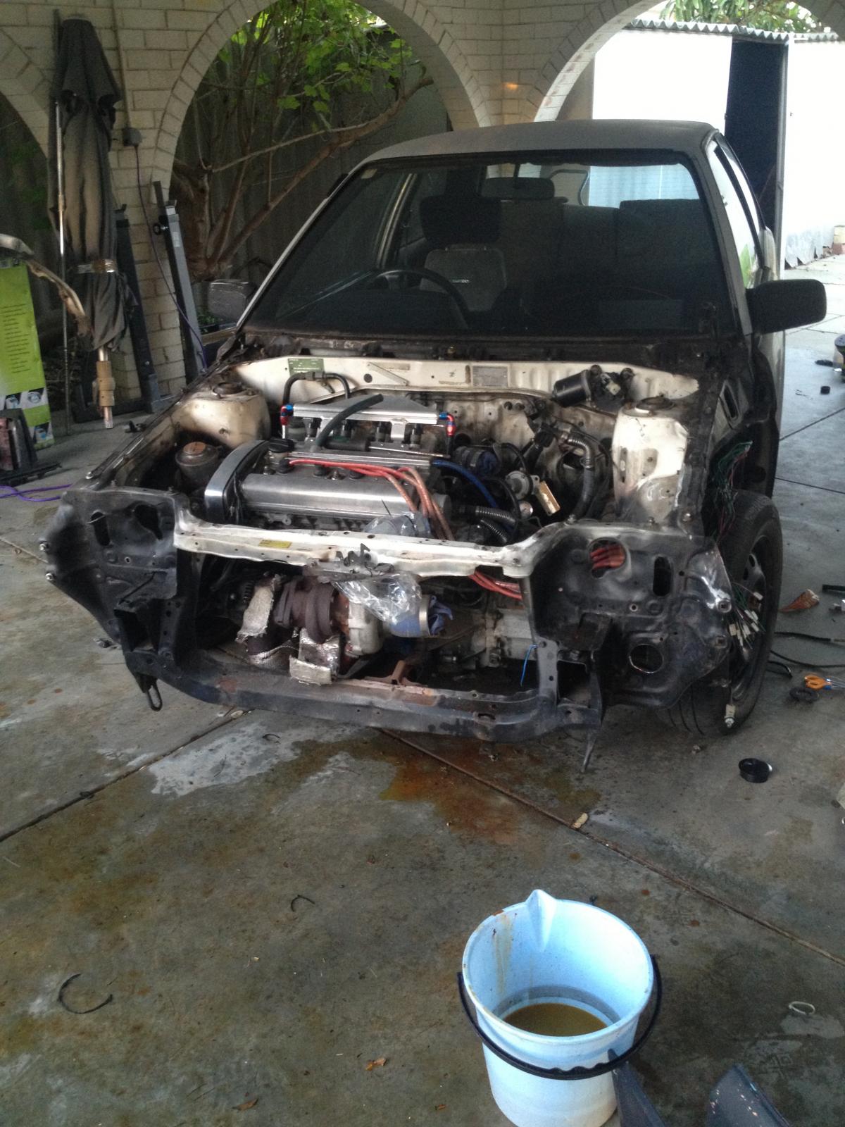

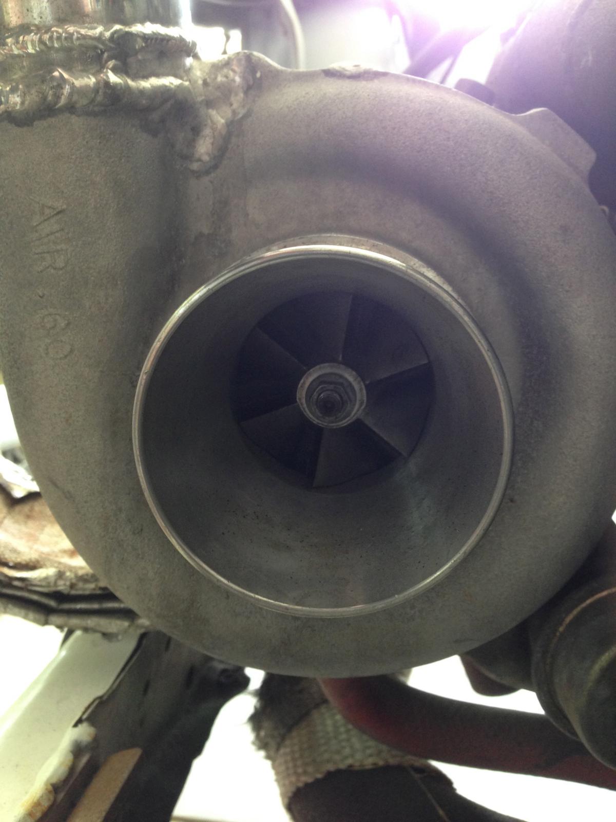

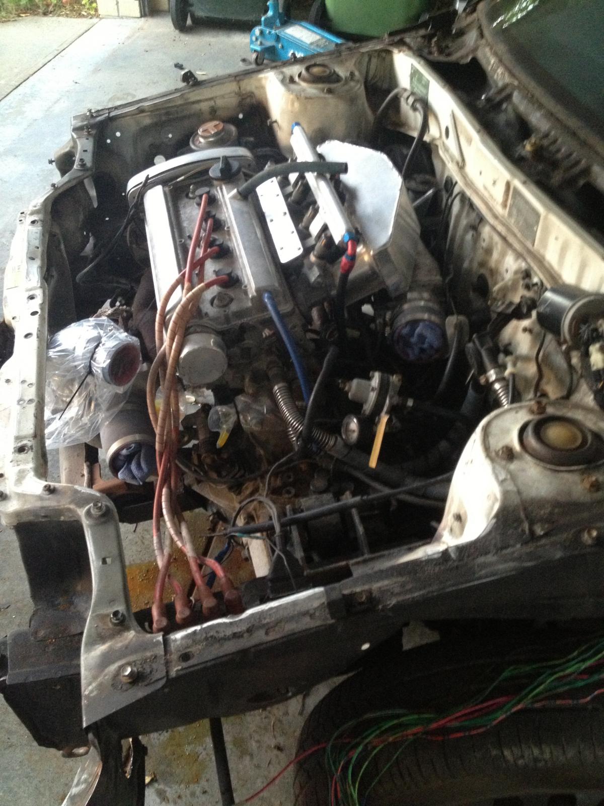

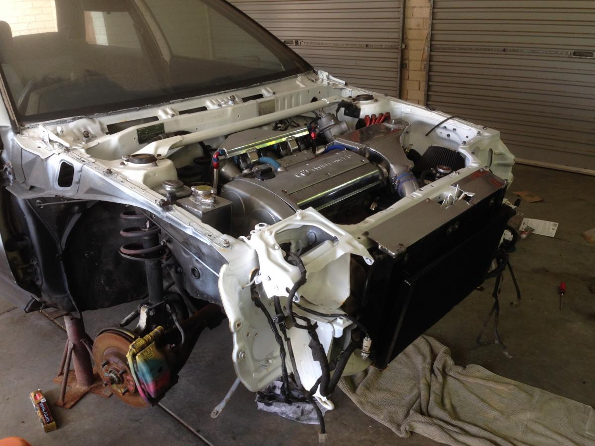

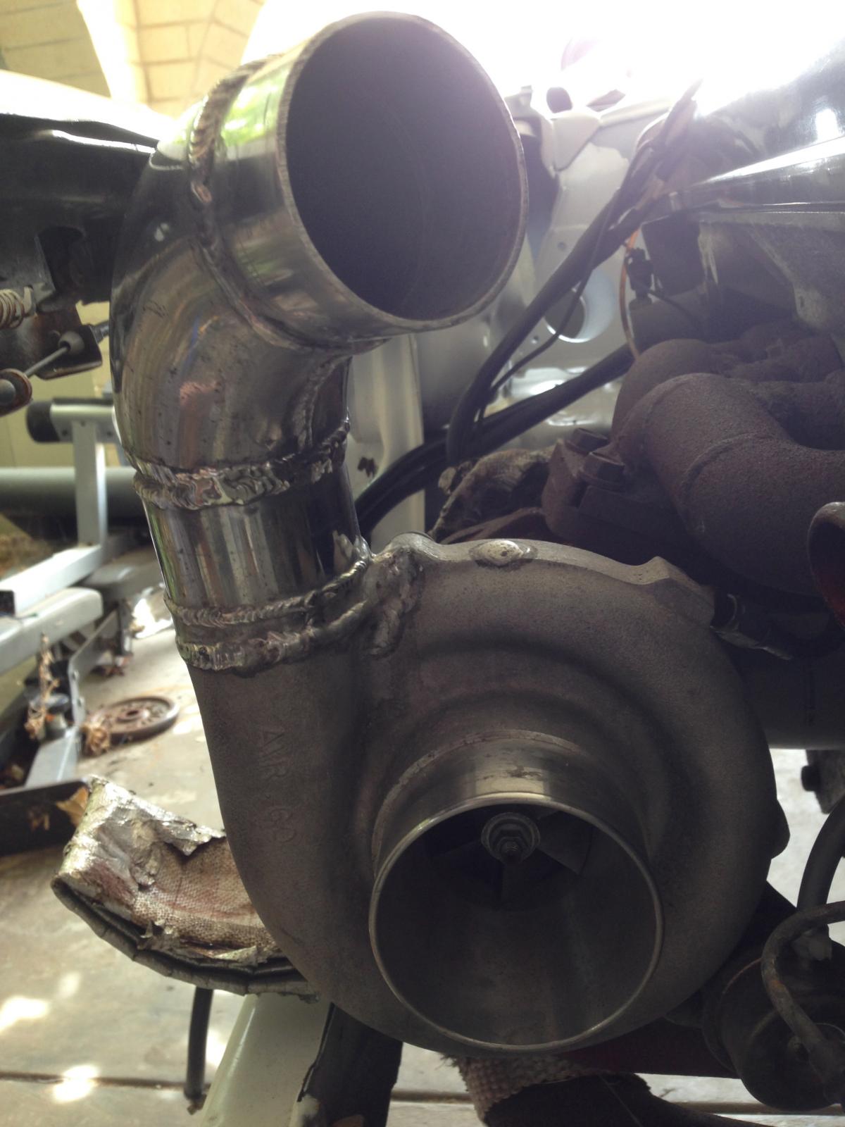

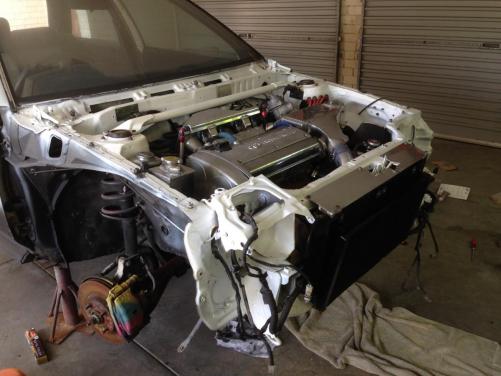

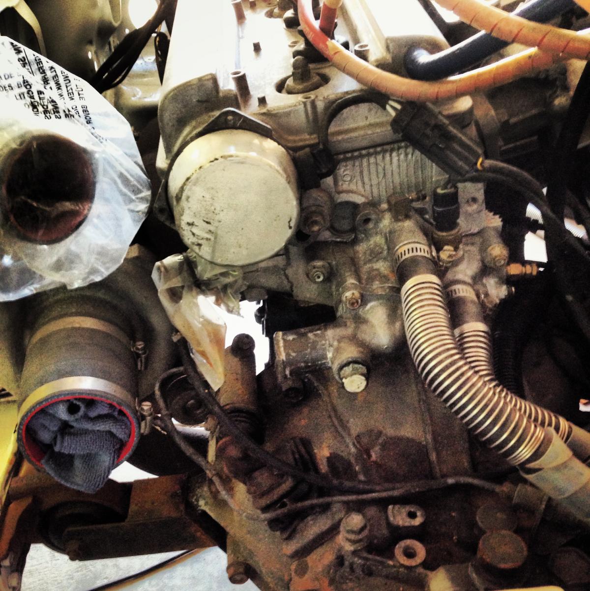

  7. gave the turbo a once over, according to the exhaust housing, it's made by precision turbos. All back together and clean. The radiators look impressive with a coat of black and the intercooler polished up well. Made specifically for this car, but man, is it hard to get in there. no room to move at all. so more wiring to do now before it bursts into life. Battery positioning and such. have to change two CV boots and a power steering boot, an exhaust with mufflers, rear shocks and springs, and some tires. that should be it hopefully. needs to be done before i go back to work. might be moving to Cairns.

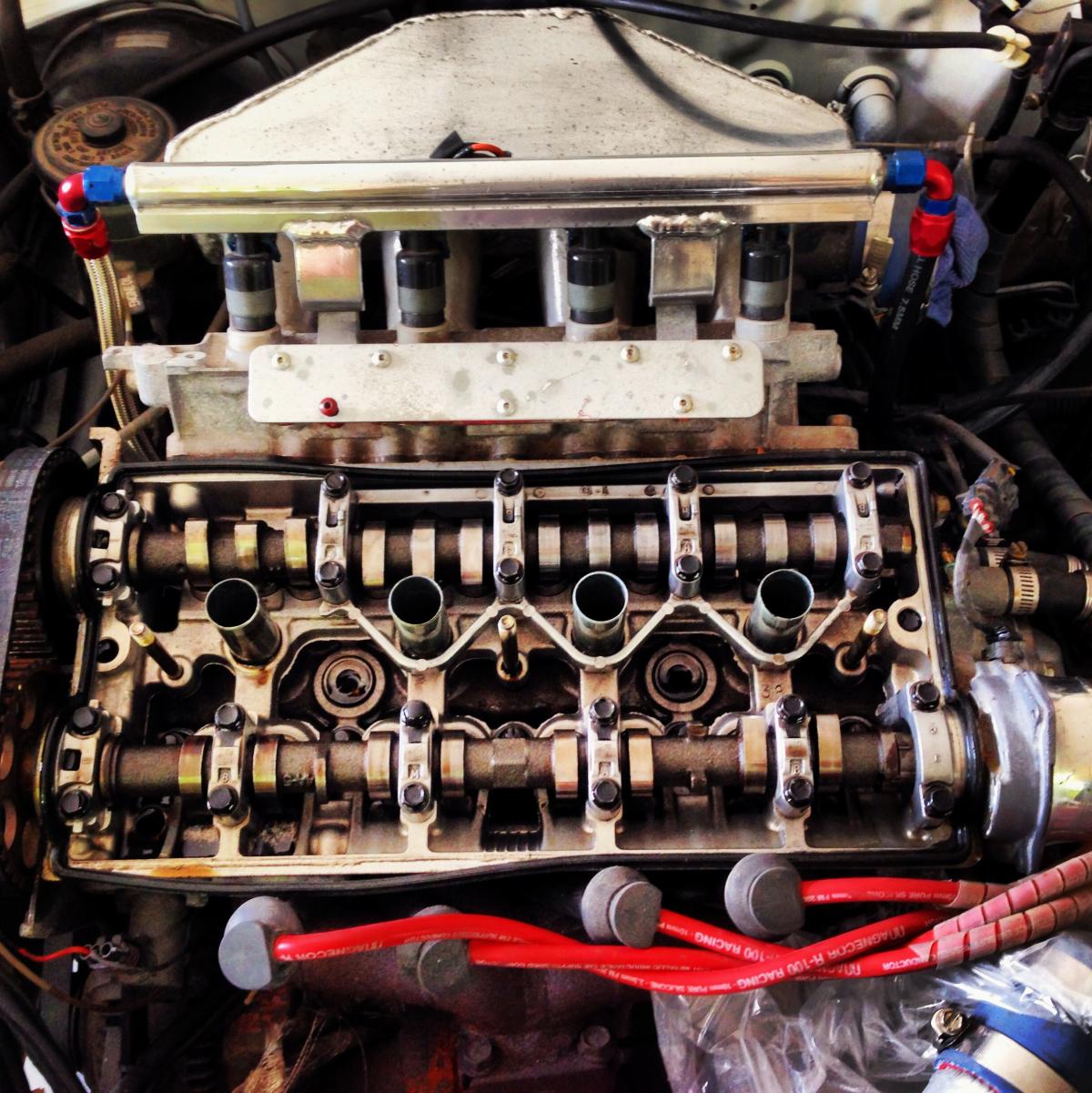

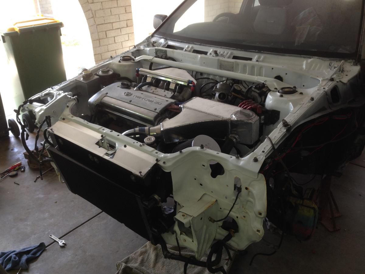

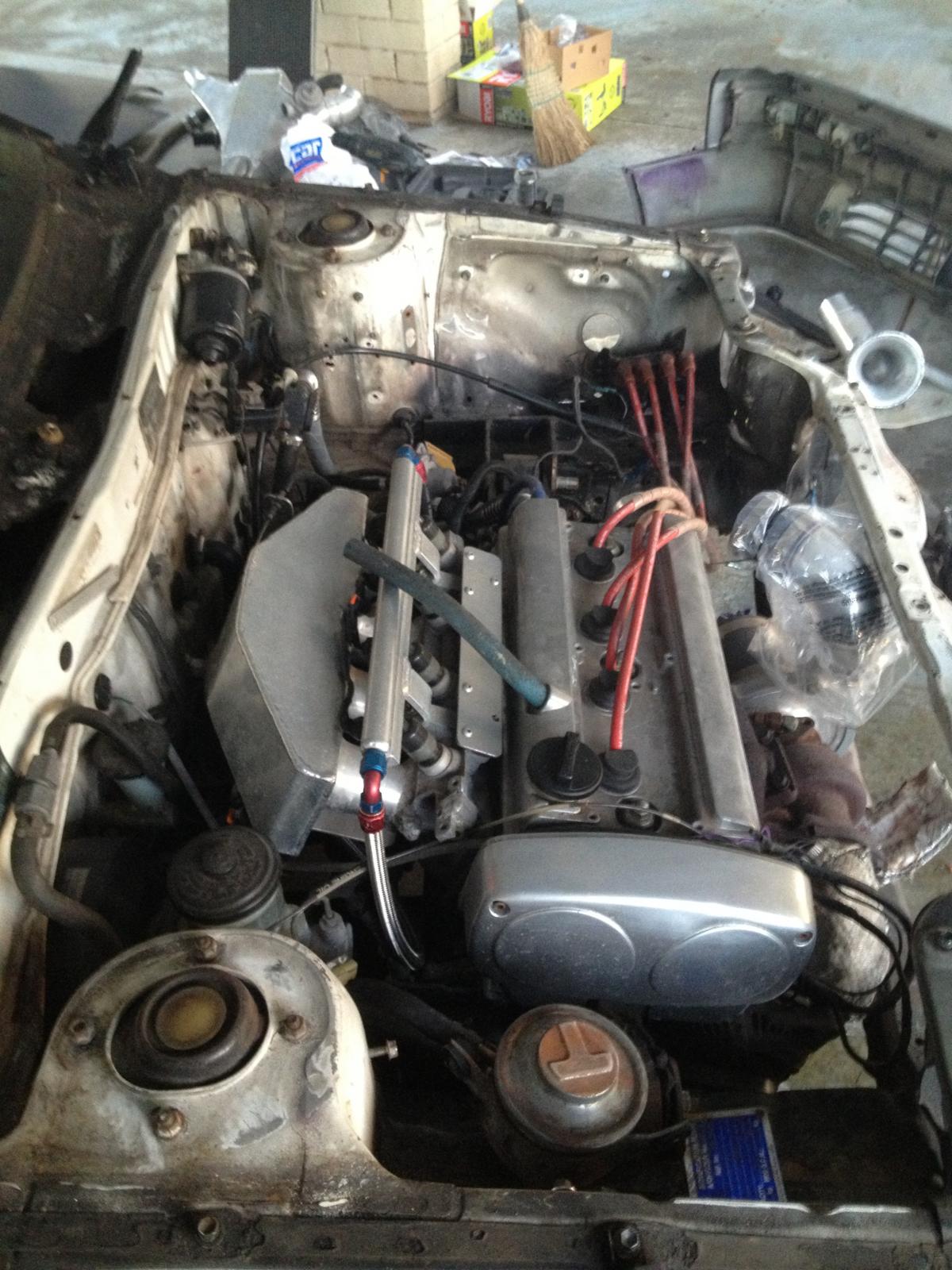

  8. On 4 weeks leave over christmas so might actually get some work done on this thing. Haven't really touched it in 6 months but feeling motivated to dust the cobwebs off and get things moving. Repaired the rear of the thermostat/heater hose housing. A previous owner has drilled a large threaded hole for an autometer temp gauge. They must have changed temp sensors in the last few years as the one i bought recently would have easily fitted in one of the threaded holes provided by toyota. Took the rocker cover off for a bit of a once over with some autosol. Pretty sexual head if you ask me. Good to see its been serviced regularly, nice and clean. resprayed the radiators black and polished the water to air intercooler. Hopefully get it all in tomorrow. Fun times.

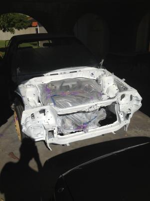

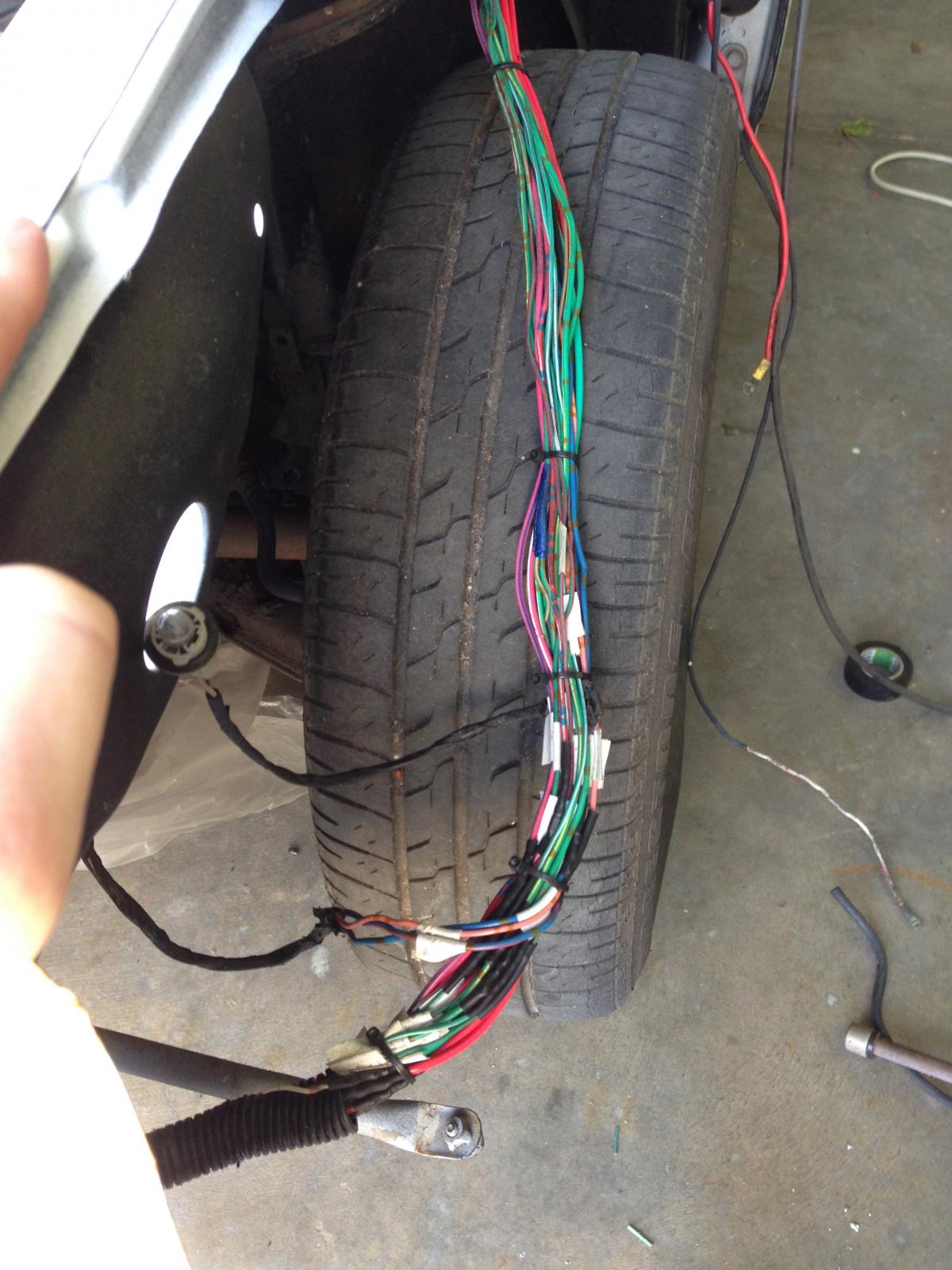

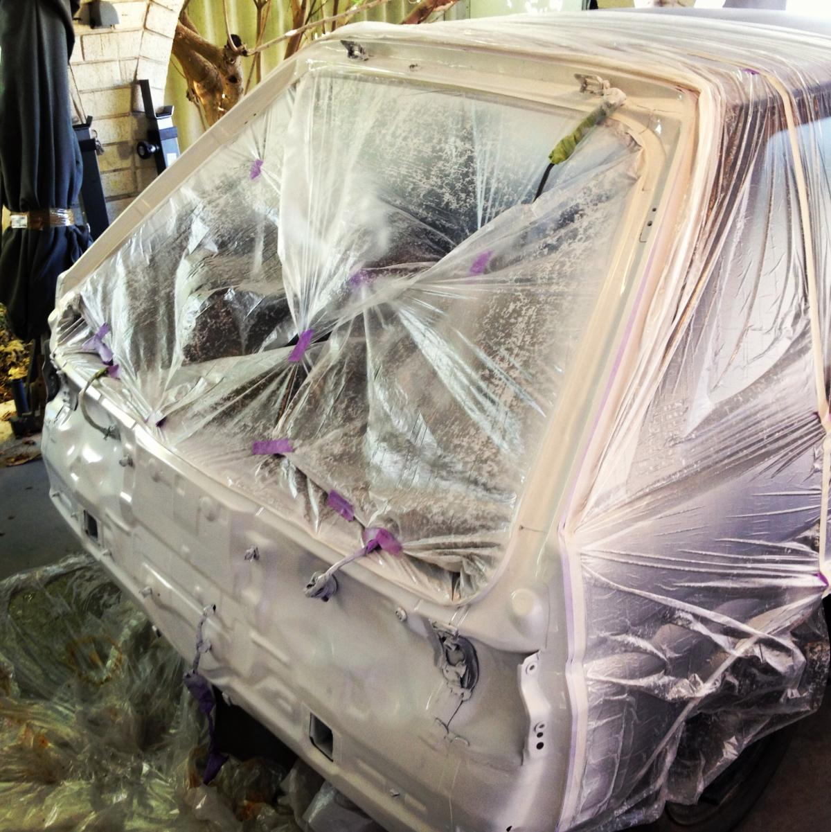

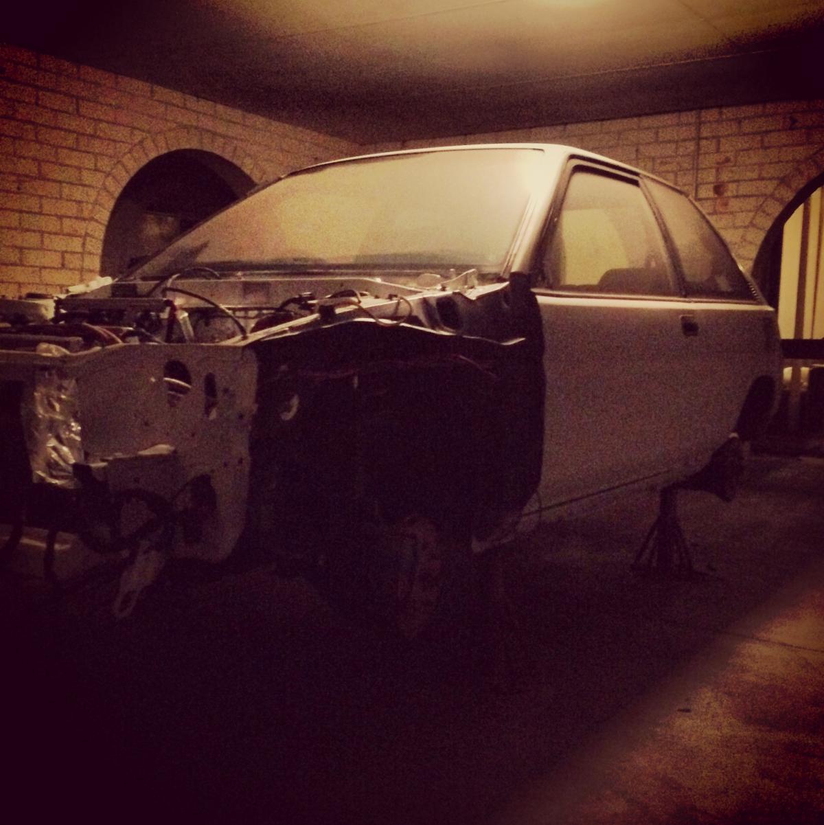

  10. Still 'plugging' away at this wiring. Inside getting close to sorted. got 8 more wires to solder. hopefully i haven't just created one massive electrical gremlin. every wire tested ok, i guess only time will tell.

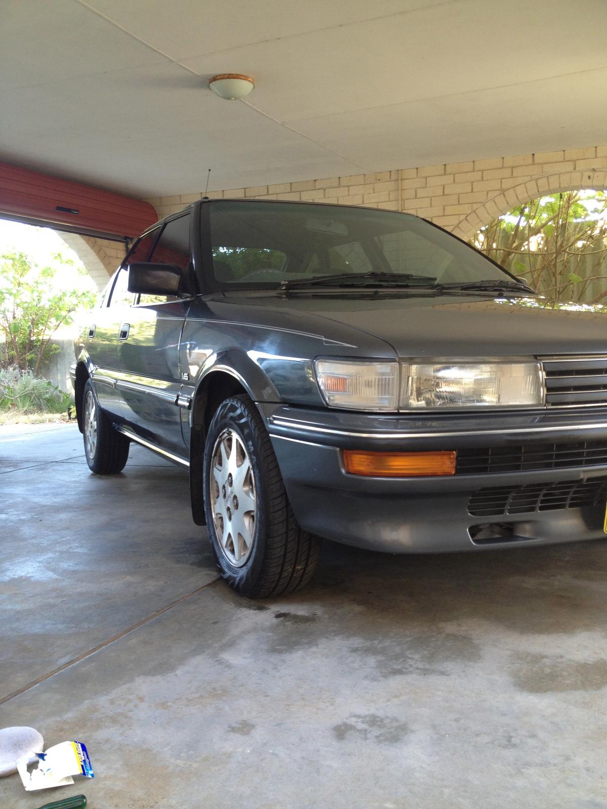

  11. just some updates of recent progress. Some primer, paint and wiring work done. Will do some more soldering tomorrow and get the fuse box functional in the glove box, making some room for a widow washer bottle and an oil catch can. The wife is about ready to pop with our first child so who knows when i'll get another chance to work on this. I have been lucky enough to score 4 weeks off over christmas, so hopefully then. this is my wife's new daily that I picked up for 900 bucks. Not bad, minimal repairs needed, bit of a polish, came up alright.

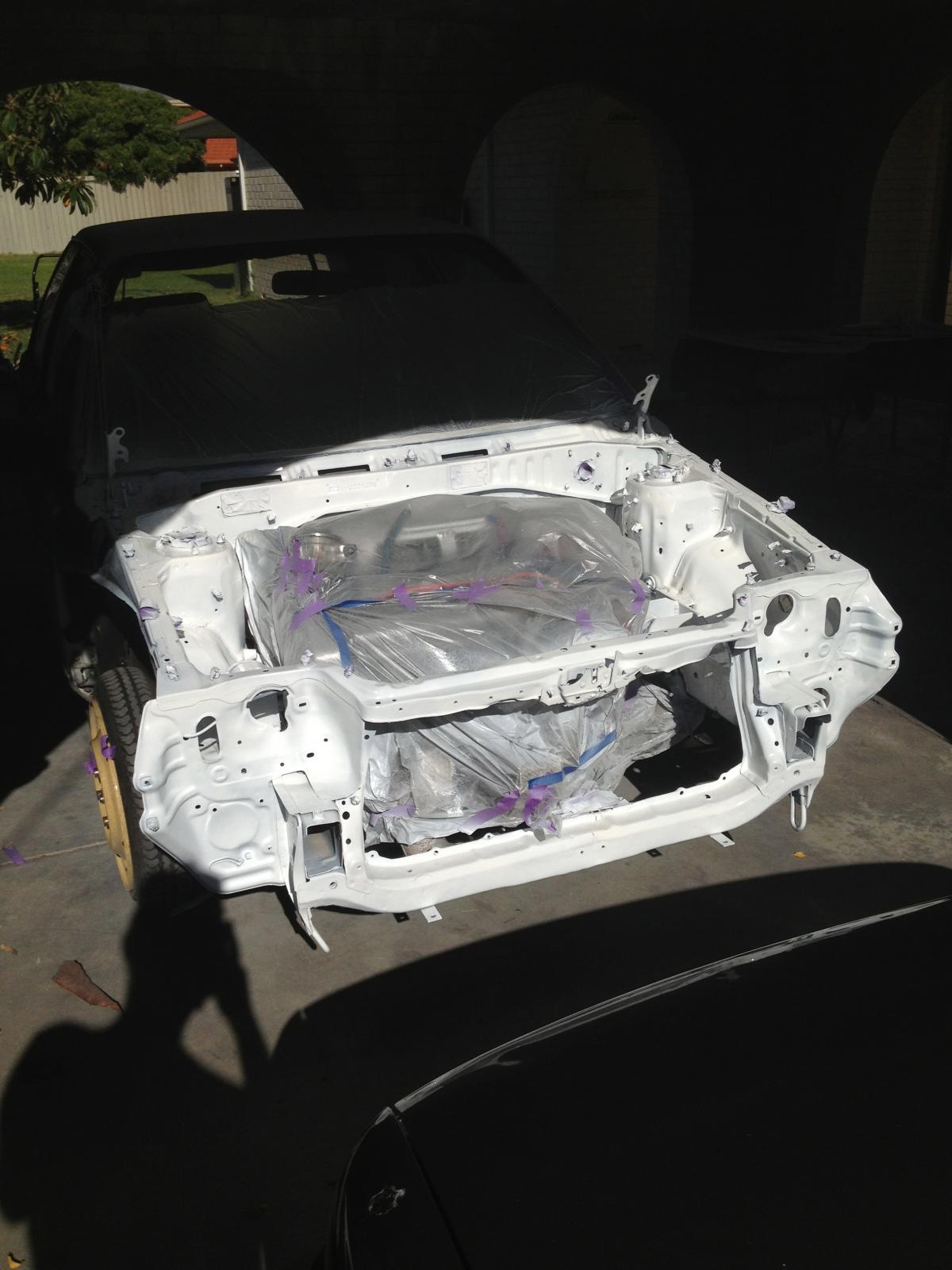

  12. i had one of these as my first car in 1999 in Brisbane. Was rare even then. Mine looked the same as the green one on here, but I did a 4age conversion. Loved it dearly. Well played sir. Well played.

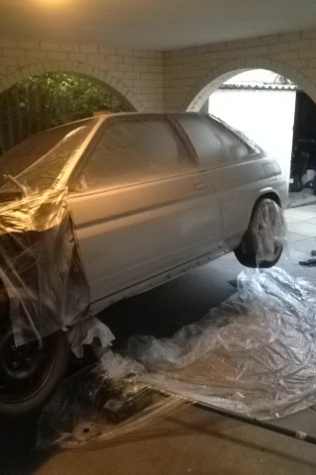

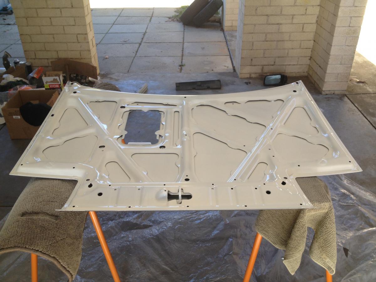

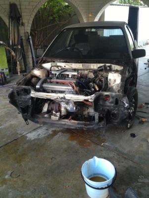

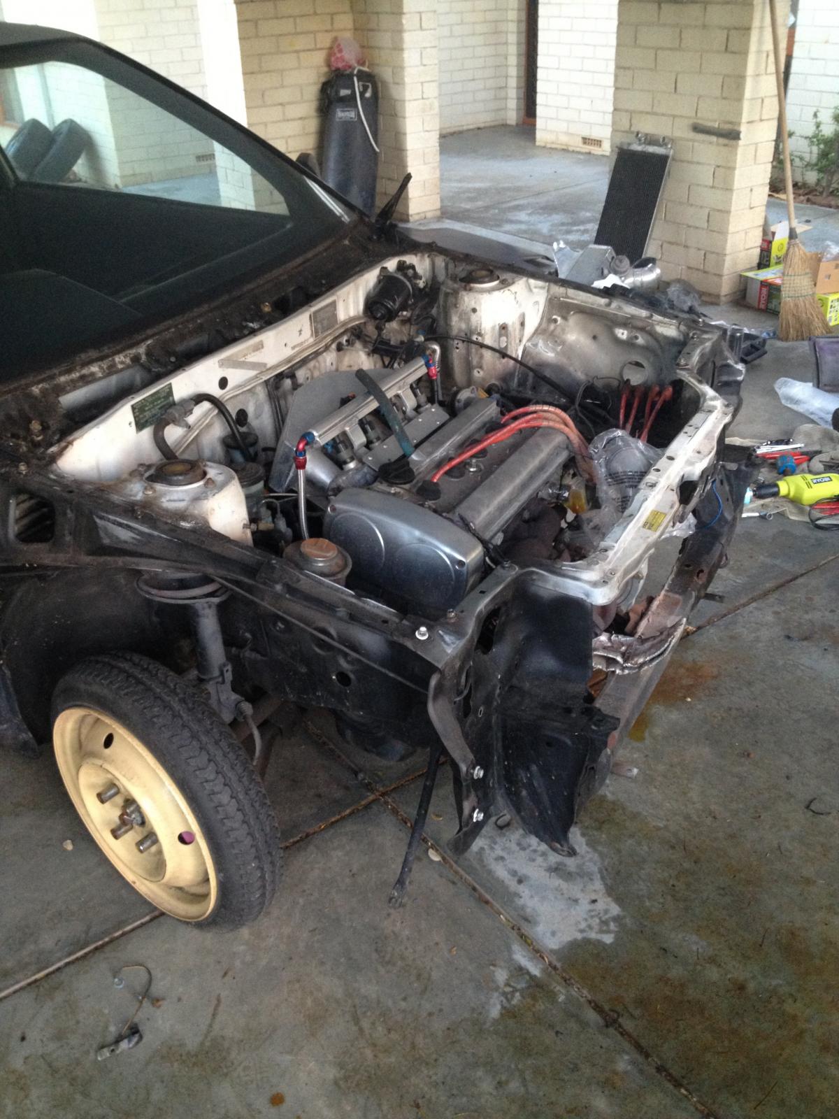

  13. hi mate, i have one of these also. a little differently set up to yours, but none the less the same car. EP71 and EP82 starlet front struts are the same as ours. EP82 strut tops are slightly different, unsure about EP71. If you look through my thread or Tom's, theres a few details on a company that does coil overs out of NZ. fairly affordable too. Chuck 'el31' into the search on here. I see you're in perth. When i pull my finger out and get mine registered, we'll have to get a drink and compare notes. Not many of these left these days. best of luck.
