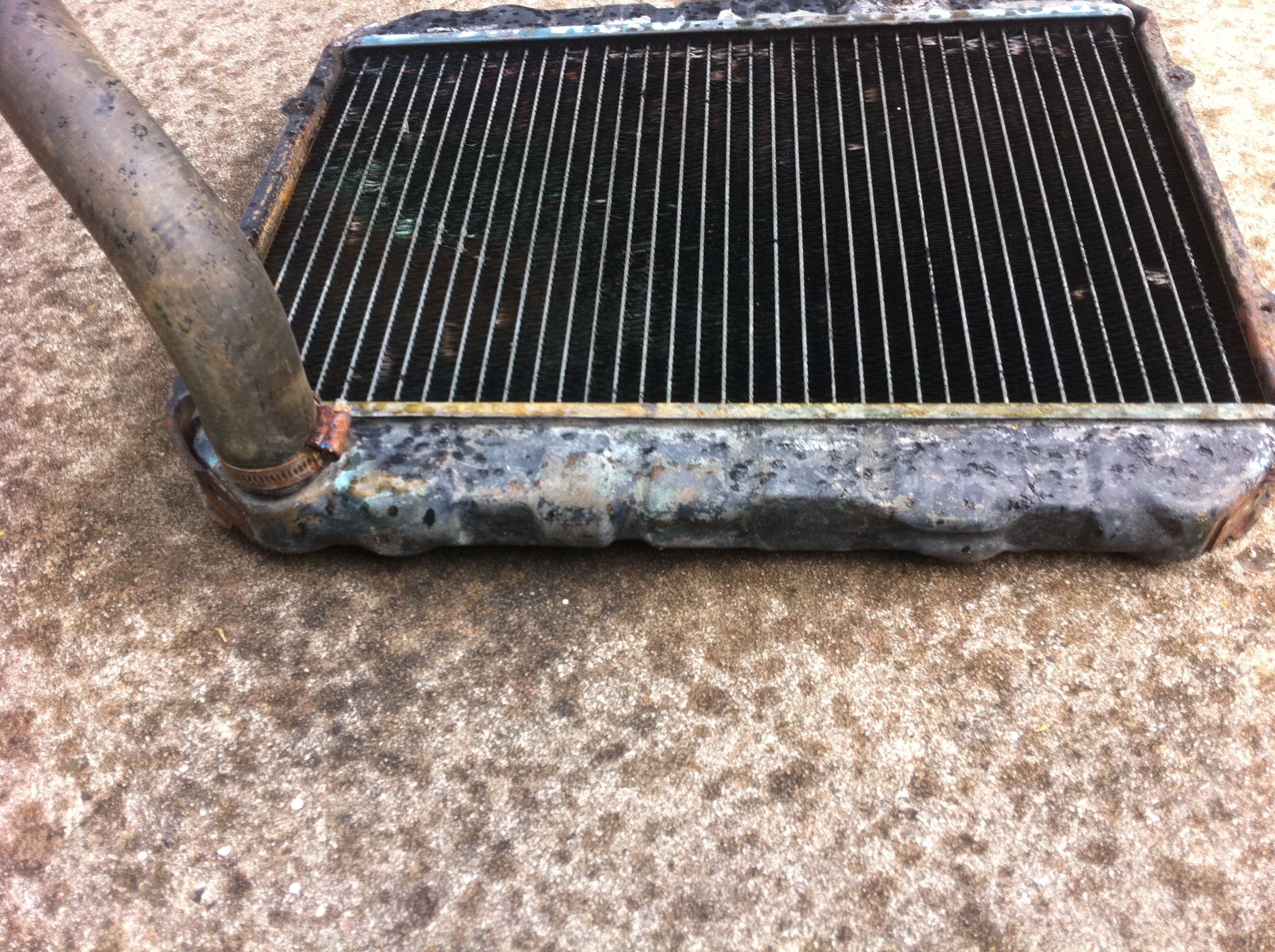

FOOMAN Posted March 20, 2011 Report Posted March 20, 2011 Hey guys, I'm replacing my radiator with a new one, but upon taking the old one out I realised that underneath it, it has 2 hoses going off somewhere yet the other one doesn't. Just wondering what they are for, if i need them and if the other radiator isnt actually for ke30's. Here's the old one and the new one: Cheers Quote
Evan G Posted March 20, 2011 Report Posted March 20, 2011 those are for your transmission cooler (radiator from a auto) if the cars a manual don't need to hook it up Quote
FOOMAN Posted March 20, 2011 Author Report Posted March 20, 2011 Cheers! So pretty much I can't use the other one unless I convert it to manual first. Oh well, just means the old one will have to stay for a little bit longer. Quote

SLO-030 Posted March 20, 2011 Report Posted March 20, 2011 You could pick up a small trans cooler off egay or wreckers for peanuts. Place it in front of the radiator (with thermofan zippy clamps) would work a million times better than the factory setup. Quote
