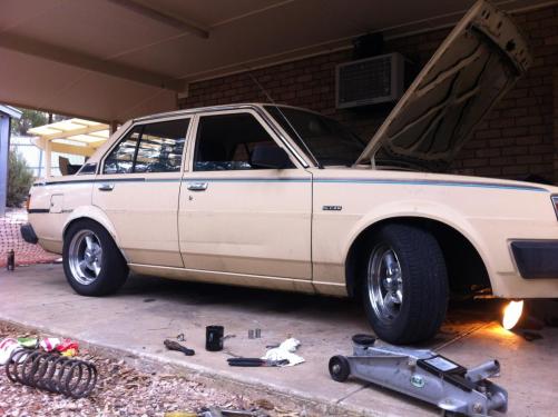

  7. FOOMAN replied to FOOMAN's topic in Rollaclub Rides
    Front coilies are in, wheel aligned and full brake bleed. Stops like a boss now. Adjusted the rear perches but not happy with them, gonna find different springs. I'm finding it quite understeery since putting in the AE86 Strut/coilovers + JDM Brakes + Powersteering arms + Adj. camber tops. Need to do something about my rear fenders, full of rust. Have some ebay special plastic fenders on their way, if they fit I'll bolt them on and cut the rest of the fender off.
  8. FOOMAN replied to FOOMAN's topic in Rollaclub Rides
    Rear's lowered, need to raise it a touch though. Adjustable spring seats help :) Fronts getting lowered this week wooo.

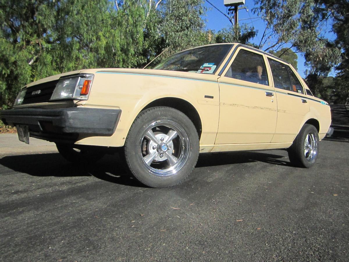

  9. FOOMAN replied to FOOMAN's topic in Rollaclub Rides
    Haven't noticed any change in kickback or noise. But my suspension is in dire need of a refreshment. Only thing I could say is noticeably different is the heaviness of turning (a touch heavier but nothing to complain about) and the handling of the car. Because my suspension is so buggered with the thinner 13's it was quite rolly and all over the road. The wider 14's hold better around corners. But it's still crap. I had 13x5 175/70/13 and changed to 14x6 195/60/14. My reasoning for 14's instead of 15's is I still wanted to be able to get decent tyres cheap, want it to still have a nice sidewall for when I get stiffer suspension and because I like the look of 14's on ke70s. Yeah, decided against welding the diff. Might just keep my eye out for a LSD if one ever comes up cheap.
  10. FOOMAN replied to FOOMAN's topic in Rollaclub Rides
    So far ripped the door mouldings off, tossing up if I should remove the pinstriping too? New black seat covers, ripped the old factory radio out as it was buggered. Thinking of putting some small gauges in instead. Got some 14x6" Dragway splats. I believe the offset to be +22, whatever it is, sits perfectly, will need a slight roll when lowered though :)
