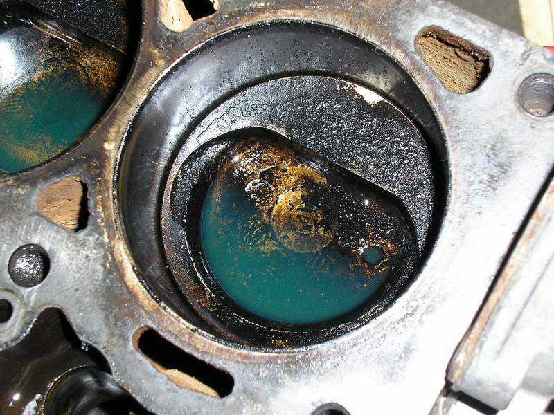

TRD ke70 Posted October 26, 2005 Report Posted October 26, 2005 all engines (k/3k/4k) have the same bore size (75mm) apart from a 5k and 7k(both 80.5mm), which have dished pistons. if you bolt a k/3k/4k head on a 5k (7k has extra headbolts and isn't interchangable) you will lose compression. there is 5K engines with flat top(very small dish) pistons out there, how you tell them is under number 1 spark plug hole there's no alloy lump sticking out, that's the best way of knowing what piston you have without pulling the head off it. if you put a 4k head on to one of these engines you'll end up with a healthy compression ratio. i think the 5k engine i gave nick had flat tops in it. Quote
rjenman Posted October 26, 2005 Author Report Posted October 26, 2005 5K block, flat top pistons and 4K head is my current plan :D Quote
TRD ke70 Posted October 26, 2005 Report Posted October 26, 2005 5K block, flat top pistons and 4K head is my current plan :D good plan, i had the same in my starlet in NZ with twin carbs, lightened flywheel, exhaust, and cam and it use to shit on rotaries. new flat top pistons can be brought in Aus for around $150 a set with sizes up to 1mm oversize. if you do bore it to 1mm oversize make sure you have a good cooling system as there is a increase in temp. the 4k head is a good idea as you can shape the chamber better. good luck with the engine. Quote
