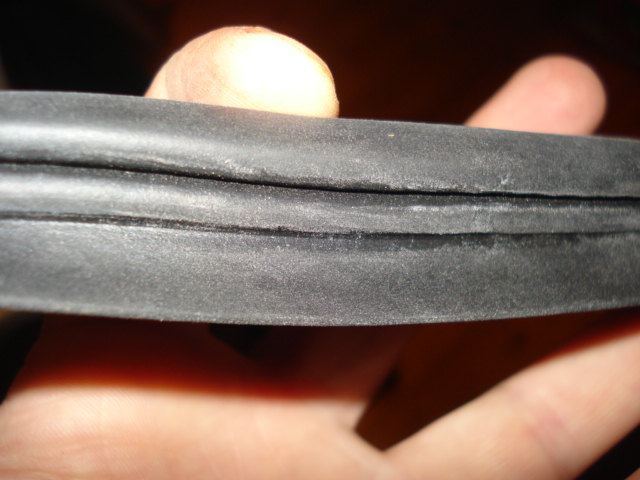

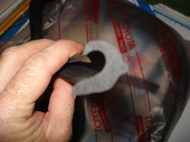

This boot seal has been an interesting case in point. I bought a "Toyota General Parts" seal off Gira7777 for the KE15. It arrived in a bag with KE10, KE20 etc written on it. At the same time, I managed to locate a genuine KE25 seal elsewhere and bought that for my KE25.
The difference when compared side to side is stark. The thai version is cut from a roll so you need to join it. I expected that. The real problem with it, is that whilst the cross sectional shape approximates that of the genuine seal, the genuine seal is far more complex. The genuine seal includes a recess enabling it to be fitted to the flange around the boot thus locating it. It also includes a molded pillow, in other words an air filled cushion which compresses when the boot lid closes on it. Finally it incorporates a pliable lip further improving its sealing ability.
The aftermarket seal has none of these things and is essentially a lump of extruded rubber that roughly approximates the general shape of the genuine seal. Basically it is unusable.
At some point I will compare some door seals as I have these in both genuine and aftermarket also.
But the problem as always remains, genuine seals are very difficult to source.
Whether the Scott's etc items are any better I cannot say with respect to complexity of manufacture.
Below is the aftermarket item followed by the genuine (in detail showing the locating slit only rather than cross section)
