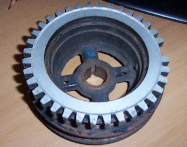

Any body got any recommendation for were I can get this wheel attached to the pulley, also any place for a cut and shut manifold?
why don't you bolt it on and slot it as well then you can adjust it if need be.

i just thought that it would be easier to bolt it on, that way there's no heat to damage the balancer and you could adjust it, i reckon 3x8M bolts would do the job.

ok ill do that, thanks :jamie:
would there be anything i would have to be carfull of when drilling into the pully?
yeah, you'd need to be fairly accurate so you don't put the pulley out of balance. i'd be paying a fabricator or machine shop to do it for you
