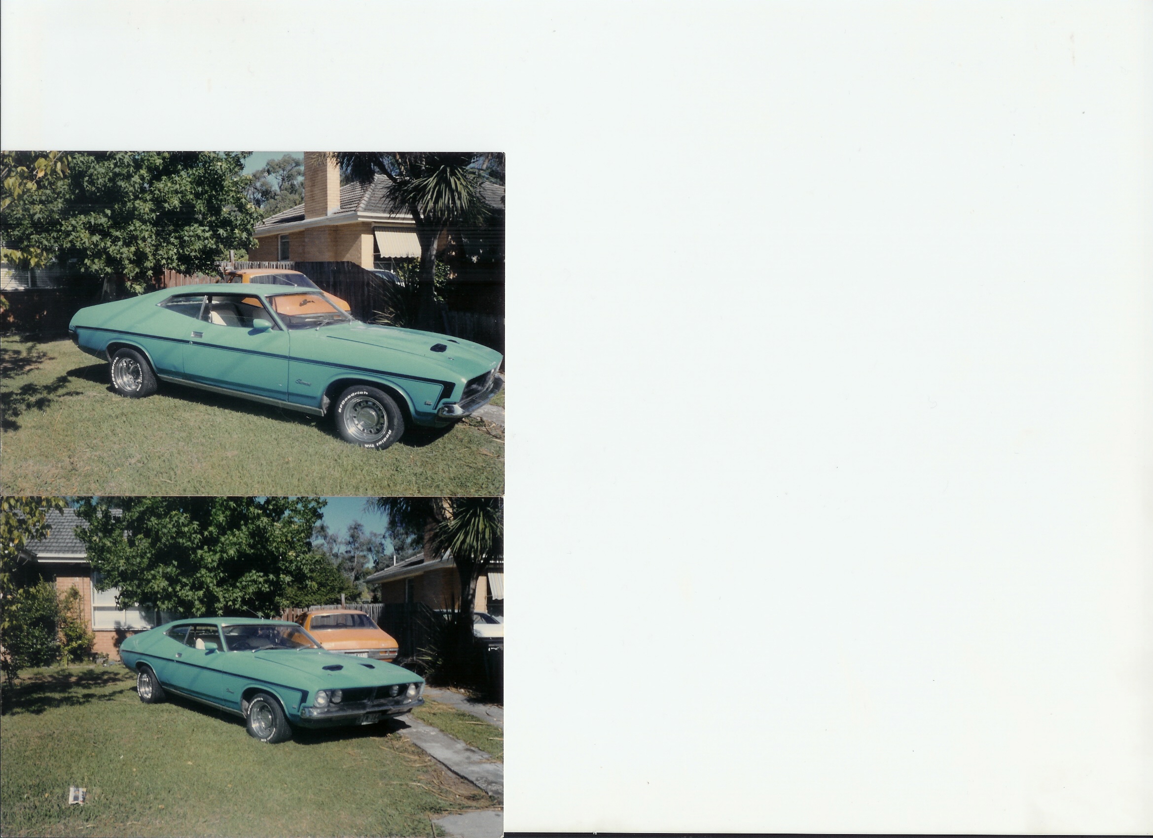

  17. My XB GS 351. It had major work done to it.(Piad for but not done by me) It had some wild cam,Shelby cobra heads and god knows what else. It started with a standard c10 tranny, then a celica 5spd,then back to the c10 with full manual valve bodies. Tried a number of carbies, Holly 950dbl pump,Quad Delauto's but worked best with Holly 850dbl pump. Extractors and 2"twin stainless exhaust Tyre's front 14x60 265 rear 14x50x355 Ran mid 12sec. Best time was by someone else so it doesn't count
