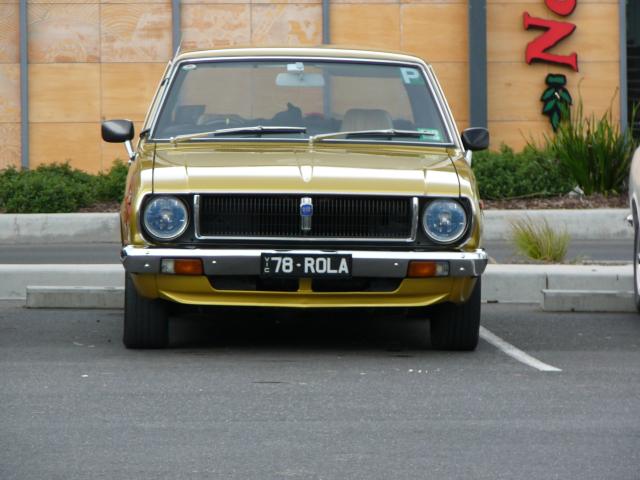

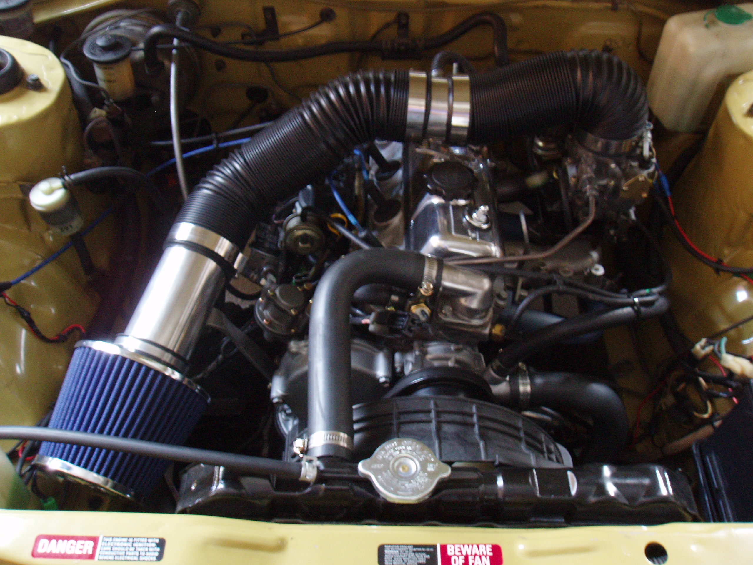

Hey guys, finally decided to post my car after all this time. Partly because it's almost done (although they never are) and I wanted to kill some time. Without further ado, here are the specs/mods/pics.
Matt.
EDIT: All specs updated and more details at end of thread :)

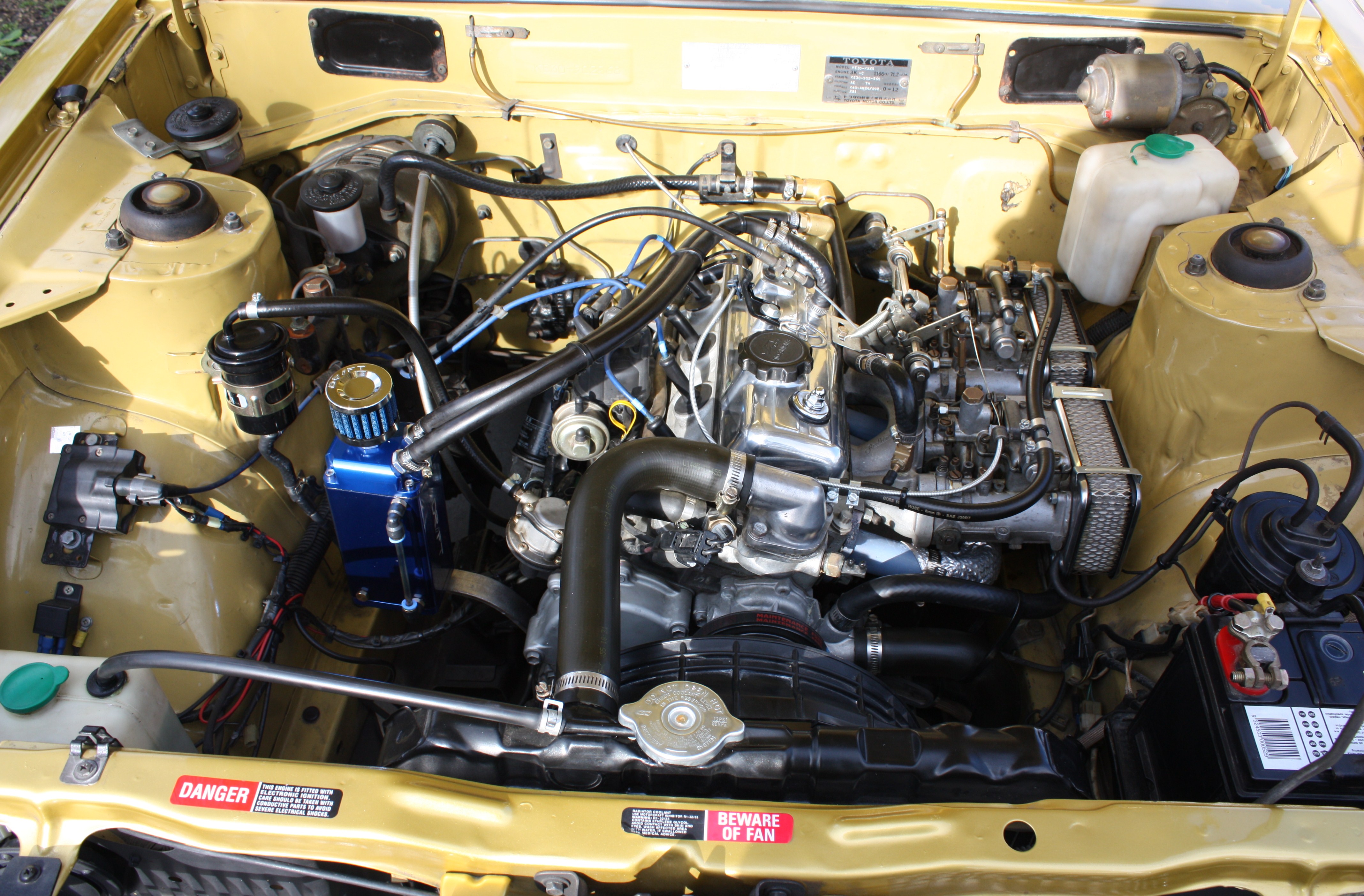

Specs:
- 7K conversion
- W56 5 speed townace 'box
- R31 rear end (including discs) with 3.9's and LSD
- Extractors to full system
- Twin dellortos
- Electronic ignition
- Thermo fan conversion
- Brass core radiator
- Various chromed and polished shiny bits
- Custom made lower and harder front springs with lowered monroe gt gas shocks
- Rear leafs re-set with extra leaf added
- Various Nolathane and whiteline gear/bushes
- Resprayed in Aurion Aurora Gold (deleted side badges)
- Original 'as new' interior
- 15 x 7 superlites with Bridgestone Adrenaline's
That's about it for now so enjoy the pics.

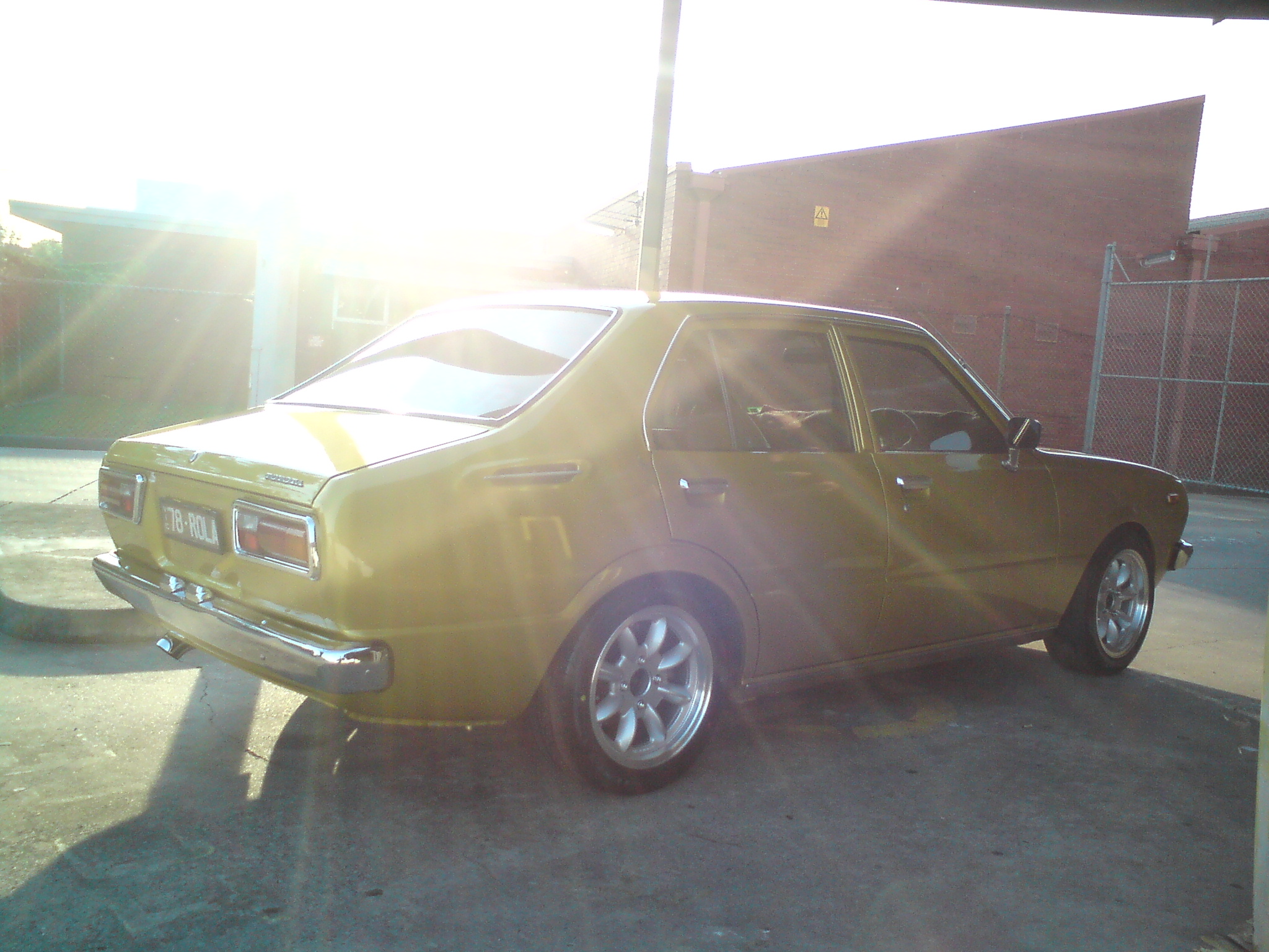

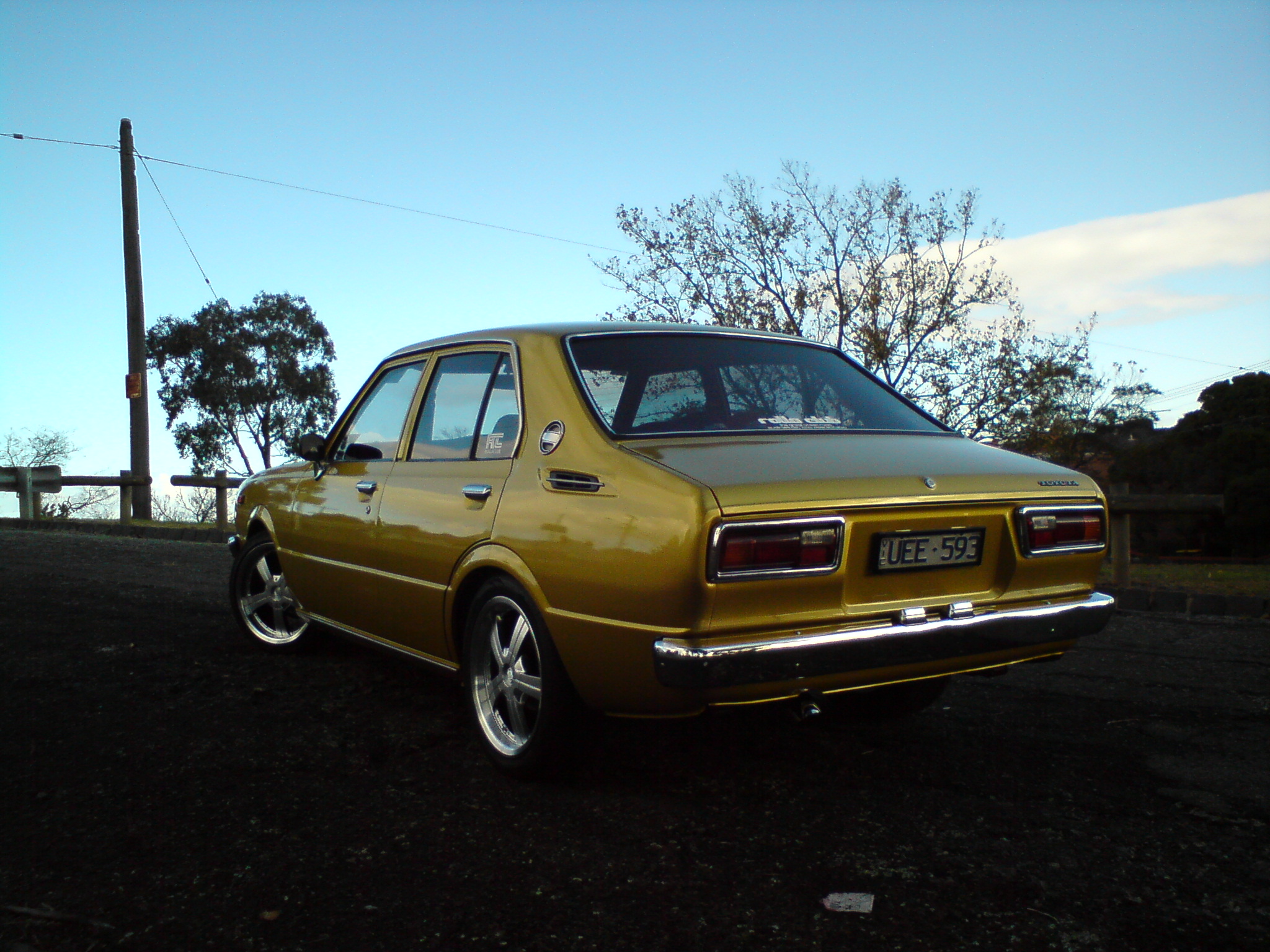

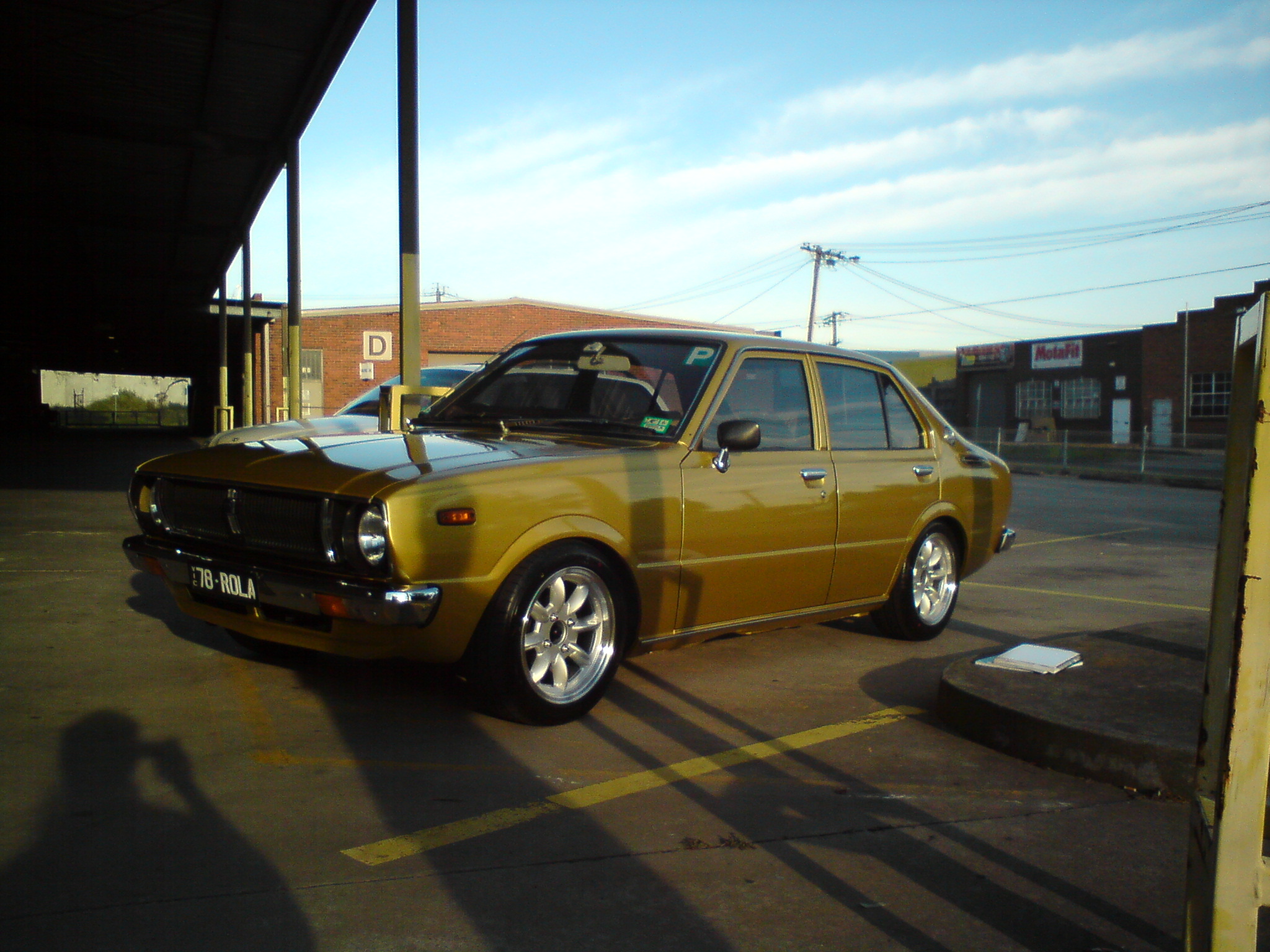

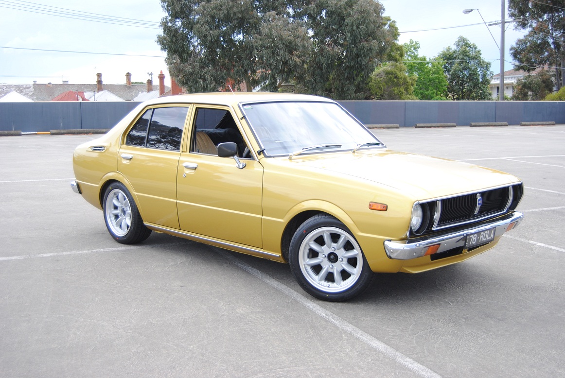

  • Unsure of offset but in a 15 x 7 they only make two offsets and they are the datto offset.   Here are some pics from today.

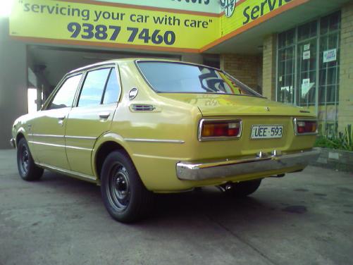

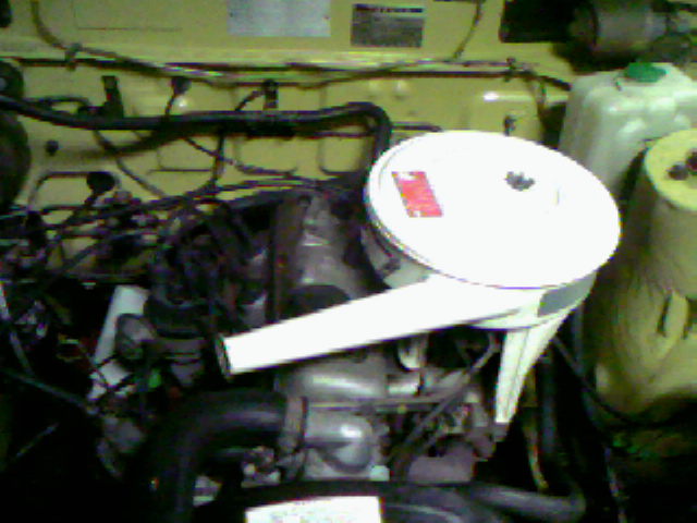

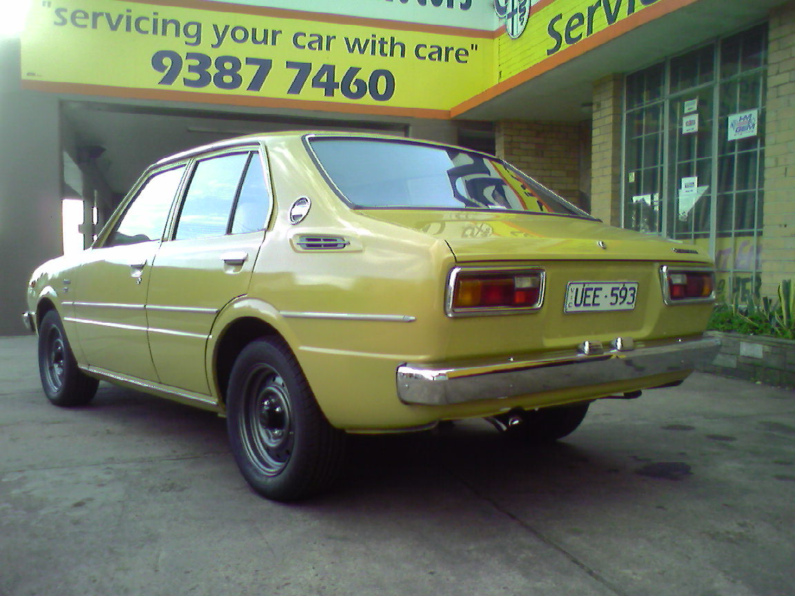

7k when first installed (original single carb)

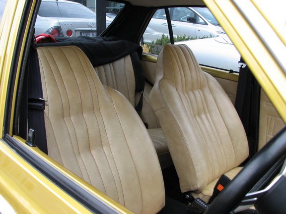

Interior

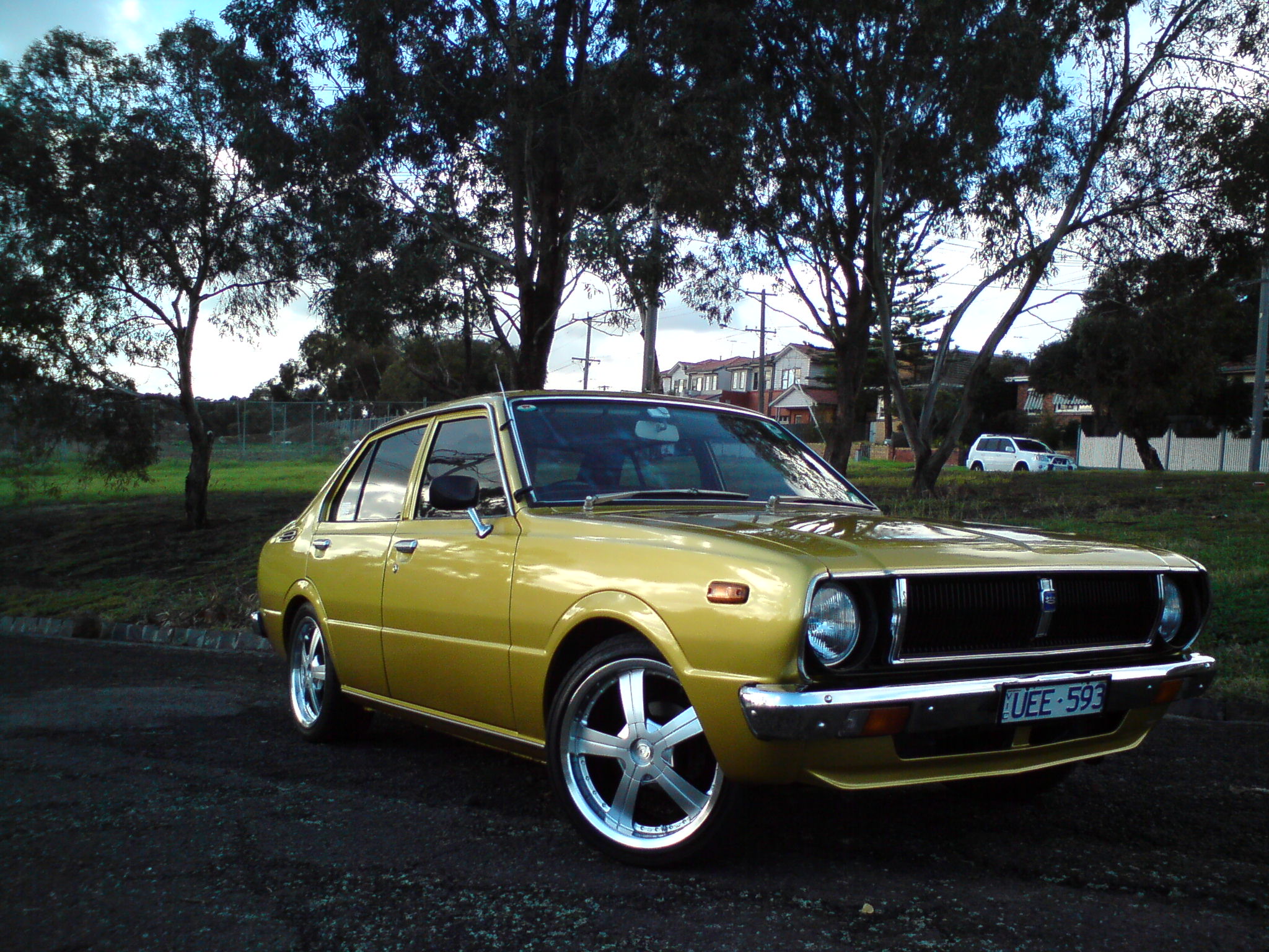

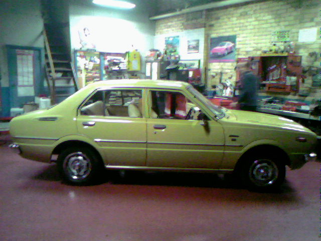

Pics from just before the second k box gave way, superlites and custom plates.
Edited by 78_7kRolla
New Plates and wheels :)
